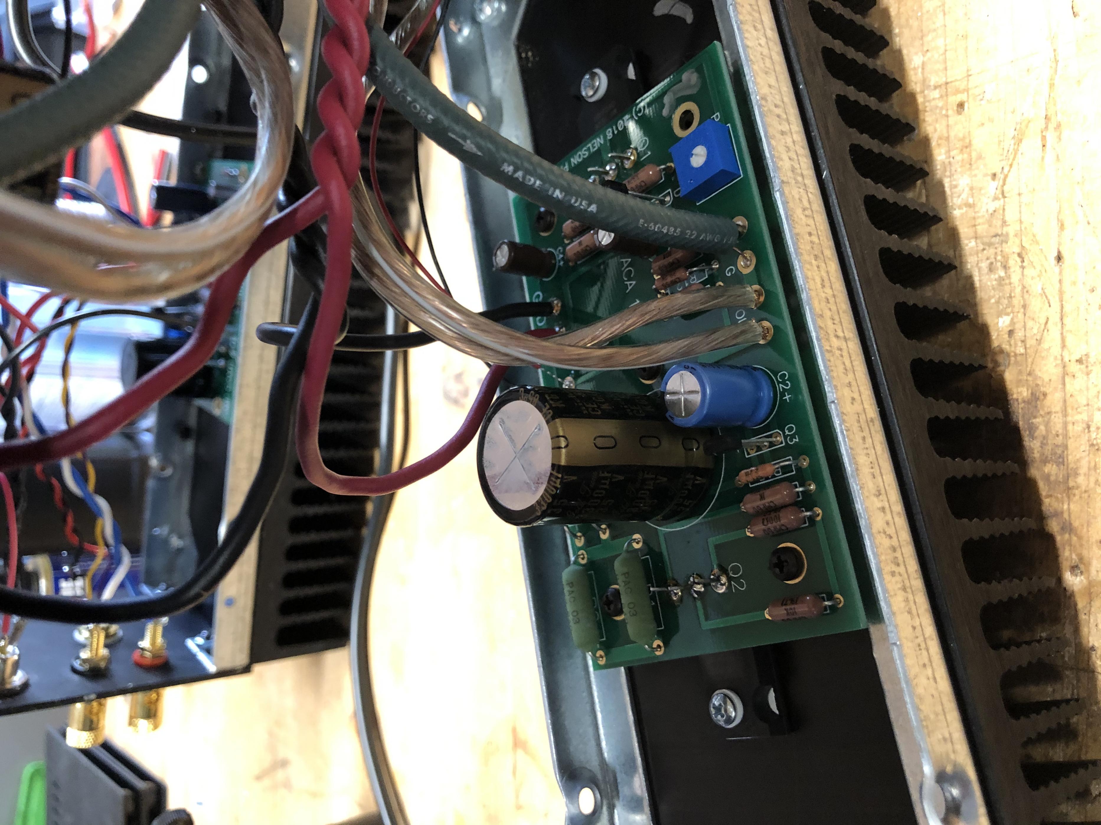

I’ve built a few of these ACA’s and have had no problems. With this last one I wasn’t patient for the kit, and procured every part separately myself. I did my best, but honestly I hardly know what I’m buying. I think the small resistors are fine, but I’m concerned about the power resistors, and the capacitors. I just matched the specs and bought the more expensive of the options. Additionally, I got creative with my choice of wires in a fun attempt for consistency of input and output wires. Maybe that was a mistake. Ultimately, there is sound, but very low volume. I followed the troubleshooting pics in the build guide and all check good in the powered up mode. However in the non powered mode the numbers don’t match well. They kinda bounce around. Any thoughts?

Resistors and caps 'look' ok. As long as you chose the same value and voltage rating for the caps they should be fine.
Not sure I understand the ''kinda bounce around'' in the above statement.
Did you put 'insulators' under Q1 and Q2? Do both Q1 and Q2 get hot? Can you adjust the 'bias' to 12 volts?

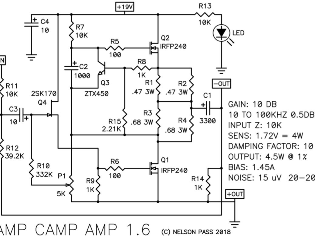

If yes to the above - Have you checked the resistance from the Red to Black output terminals? It should be about 1K ohms. If it is very low, you have the outputs shorted. Make sure their metal parts do not /cannot touch the chassis.

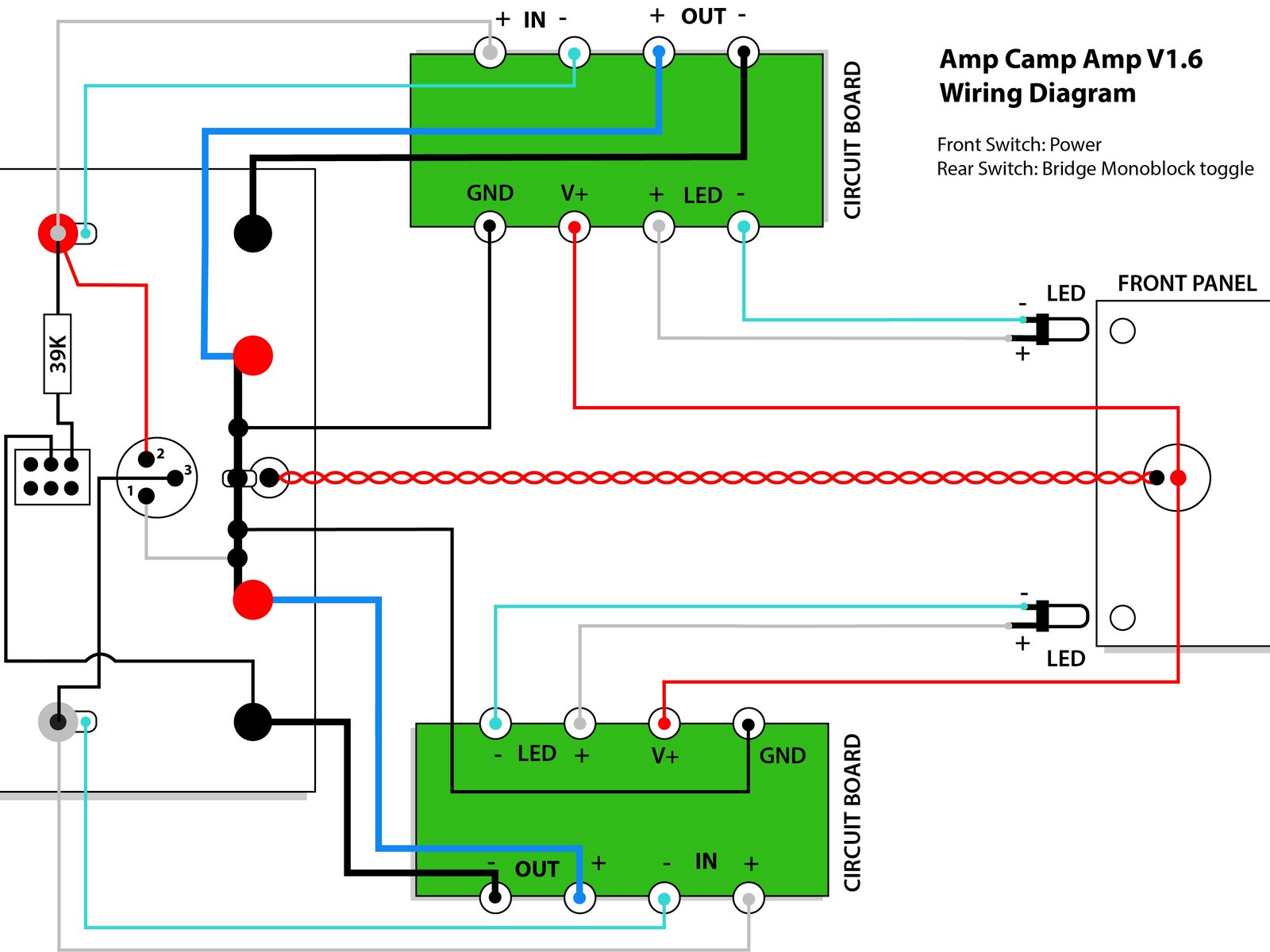

Remember, if you are following the build guide, the Black terminal is Not connected to the GND / 0volt. The + OUT from the board is the GND / 0 volt line and connects to the Red terminal. (Have a look at the circuit diagram in post #661.)

Also check for cracked/cold solder joints and reflow them. Its hard to tell from your picture, but that is something I've had happen a few times when building these with my kids (or my first one). In particular, the pins on the MOSFETs are thicker and need a little more heat in my experience, and that is a common place where I've found the obvious non-shiny finish to the joints. A simple reflow and you're in business.

Just to stem any confusion - because I had to think twice about the statement below about the +OUT connected to the red (positive) speaker terminal) as I'd forgotten the circuit inverts, so you do use the actual negative/return as the positive speaker output (correctly marked +OUT on the board), and the actual positive as -OUT (again correctly marked on the board). The boards are marked and consistent with the build guide here:
ACA illustrated build guide
Take a look and make sure you have wired things this way.
Keep in mind that wiring the output either way shouldn't have anything to do with your drop out issue you mention (unless there is some cold solder joint/etc... on those points); in this case you will just have inverted output if wired backwards but there should be no intermittent dropping of the output signal.

Hi Tom, you are correct that the amp inverts, hence the red speaker terminal going to 0 volts / GND. That causes some confusion...
But your statement, ''that wiring the output either way shouldn't have anything to do with your drop out issue you mention'', is only true for the original 1.0 builds.
The OP has built a couple of ACAs before and I suspect he is using the current Build Guide (1.6 here Amp Camp Amp V1.6 Build Guide - diyAudio Guides) not the one you referenced. The 0 volt and speaker connection are different from 1.0 builds to 1.6 builds... I've attached a later layout to show the problem.
If the OP has connected the -ve OUT from the board to the 0 volt / GND input connection, then the output is shorted. (On the boards themselves the GND track connects to the +ve OUT terminal.) The test in my first reply about measuring the 1k resistance between the speaker terminals will soon tell him if that is a problem or not. There are many possible reasons of course, poor solder joints and possible fake parts etc. But with the limited information - one step at a time.

I did put insulators under Q1 and Q2, however they are small and thin compared to the Keratherm. Q1 and Q2 get hot and I was able to set at 12V. The resistance on the black and red speaker posts is .4 ohms. So very low. (On another build it did run up to 1k ohms, so I know I’m checking correctly, but that was a previous version of the board). I checked the solder and ensured nothing was touching the chasis. Visually it looks fine. I followed the build guide and ran the + as marked on the board to the red post, and the - to the black post. I’m assuming that’s correct, but am I to reverse those? If so, on the pcb, or on the speaker posts?

It does not matter which version of the board you have, the resistance between the speaker sockets has to be about 1K. Less than an ohm is a short somewhere.
Start by taking both 'speaker wires' off one of the boards and measure the resistance from +OUT to -OUT on the board. That should be about 1K. If it is, then the short is in the wiring or sockets. If it is the 0.4 ohms figure, the short is something on the board.
Check the negative power input connector, outer ring, does go to the Red speaker sockets?
Then, need to see more pictures now of how you have wired the speaker connections etc.

It’s the speaker sockets. Looks like they need to be isolated from the metal chasis. I nutted on the back with the metal lock washer and thus the whole back plate became the short. Thanks so much!!! Generous of you, and others on this site, to be so helpful.
