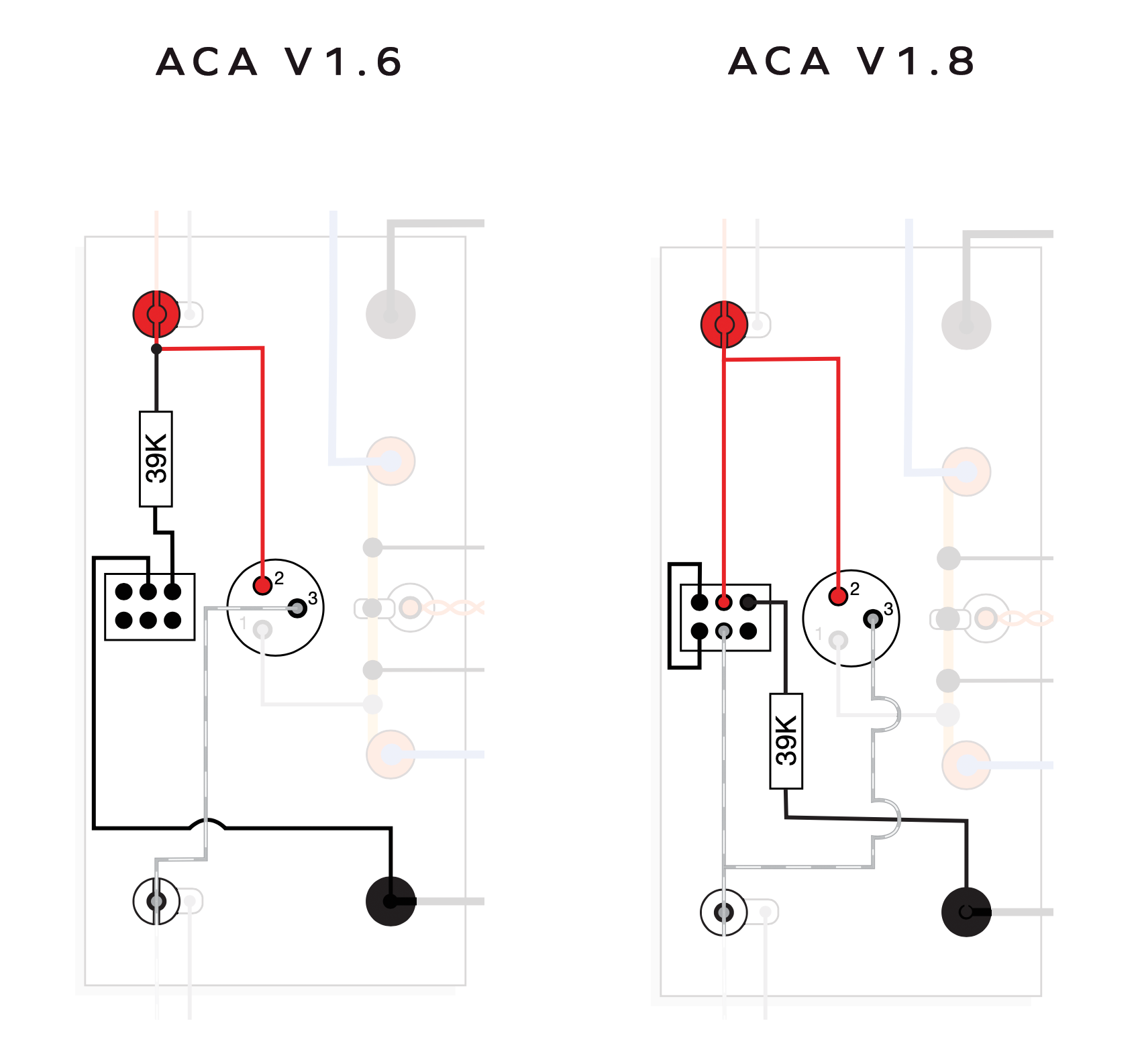

For those building the V1.8 using V1.6 instructions, attached is a direct comparison that clearly shows the differences.
As the differences are very slight, I will rename this thread "V1.6 / V1.8".
I guess I was a little anxious to build the amp, so I just did the v1.6 wiring on the 3-way switch and ignored the back panel. Even though I doubt I'll ever use the options, I think I'll go ahead and rewire it to match the v1.8 intent.
