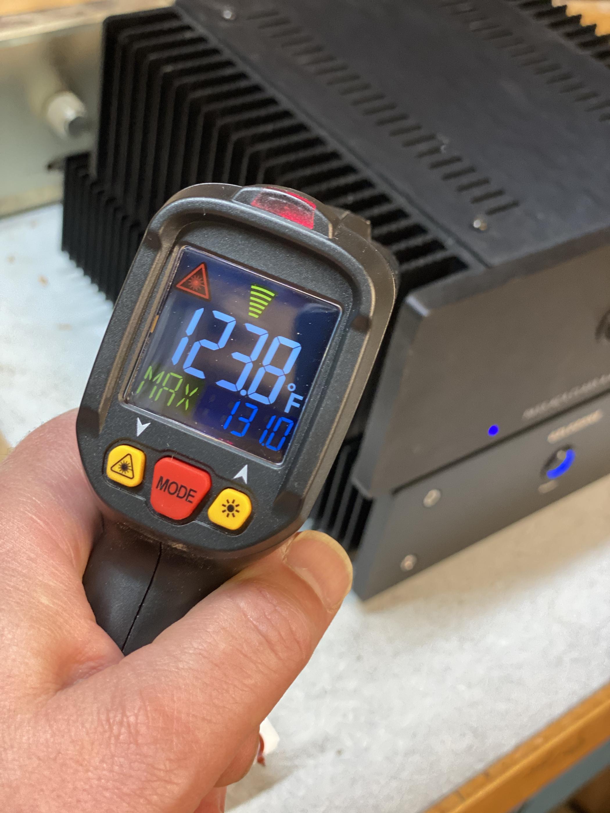

Hi, new to the board and returning to hobby electronics after maybe 30 years. I just finished building the ACA 1.8 (it took me two full days) and I've been listening to it in my system for the past couple hours. I'm very impressed by the stereo separation and sound stage in comparison to my Rega Brio. One question- the entire chassis is hot to the point that I can only touch any part of it for less than a second (faceplate, top plate, heatsink fins). I'm using the Meanwell 24V power supply and my input is not at full volume. Is this amount of heat normal?
Heat is very subjective but yes, its normal for it to run HOT. This is assuming you have used the recommended case and heatsink (the full kit).
Each channel dissipates over 35 watts (so 70+ watts in total).
The amp will actually run cooler the louder you play it, although with normal music you probably wouldn't notice, but that's the way it is... welcome to Class A 🙂

The heatsink metal right at the transistor's edge is measuring 45C.
That's after 10 minutes warm up with an infrared gun.
I think I'm okay with these smaller heatsinks.
Dan
Dan
I found a meat thermometer works good too. At ten seconds you’re probably around 60C -140F. If this is at the transistor itself I would say you’re running at what most people do in the forum.
Keep in mind that although most of the heatsink will be at the same temperature, the transistor case is noticeable hotter since the interface with the heatsink has poor conductivity even with paste and mica which are quite a bit better than silicone pads. And then the transistor die itself would be even hotter because it’s conductivity to the base plate is also not great.
150C is the maximum temperature of the die. If you look in the data sheet you’ll see a chart of the maximum casing allowable temperature per current being drained. You see that the hotter the die is, the cooler the casing must be kept at. That’s because heat takes time to transfer and the die is hotter than the case.
You'll probably get a more reliable read after an hour (of course with the lid on). I wouldn't be surprised if the temp increased 5 °C (or so) from the measurement you're reporting.
You need to consider the room temperature. Right now in NZ winter and poorly insulated NZ house the surrounding air is pretty cool and the whole setup feels much cooler than it did in the summer. One of those USB powered fans to get the air moving in summer is a consideration.

10 minutes is not long enough for this test. Leave it on for an hour, then measure your temps again. You need to get to the point where the heatsinks get to their maximum stable temperature. If you are going to fit a bottom and a lid that will increase the temperature too.The heatsink metal right at the transistor's edge is measuring 45C.

One question- the entire chassis is hot to the point that I can only touch any part of it for less than a second (faceplate, top plate, heatsink fins).....Is this amount of heat normal?
So that seems a bit hotter than I'm used to seeing. Of course I lived in SF, not further south where it could be quite a bit hotter. People tend to forget that ambient temps vary CONSIDERABLY throughout the world.Think of the guy from Mumbai who wrote once..
My experience was with a friend who hosted the original Amp Camp in Santa Rosa. It gets pretty hot there at that time but the completed amps being tested in the shade weren't excessively so. However the host had his ACA in a bookshelf that had a back and was about 24" wide. the shelves were about 12" apart vertically. His amp was BLAZING hot! So please don't put your ACA(s) on a shelf with sides and top and a back panel if you are in a warm climate. It makes a huge difference
I just built a v1.6 ACA a couple of weekends ago and this is what I measured at the heat sinks after an hour of sitting idle on the bench. This is within a few degrees or so of what the other 2 pairs I've built. The exception is the earliest version which used less current so dissipated a bit less. The headline here is that these idle pretty hot but are still well within the 'linear' region of the devices. If you are uncomfortable with this, do what Papa Pass has always said along the lines of, "you can never have enough head sink." and add more. 🙂
