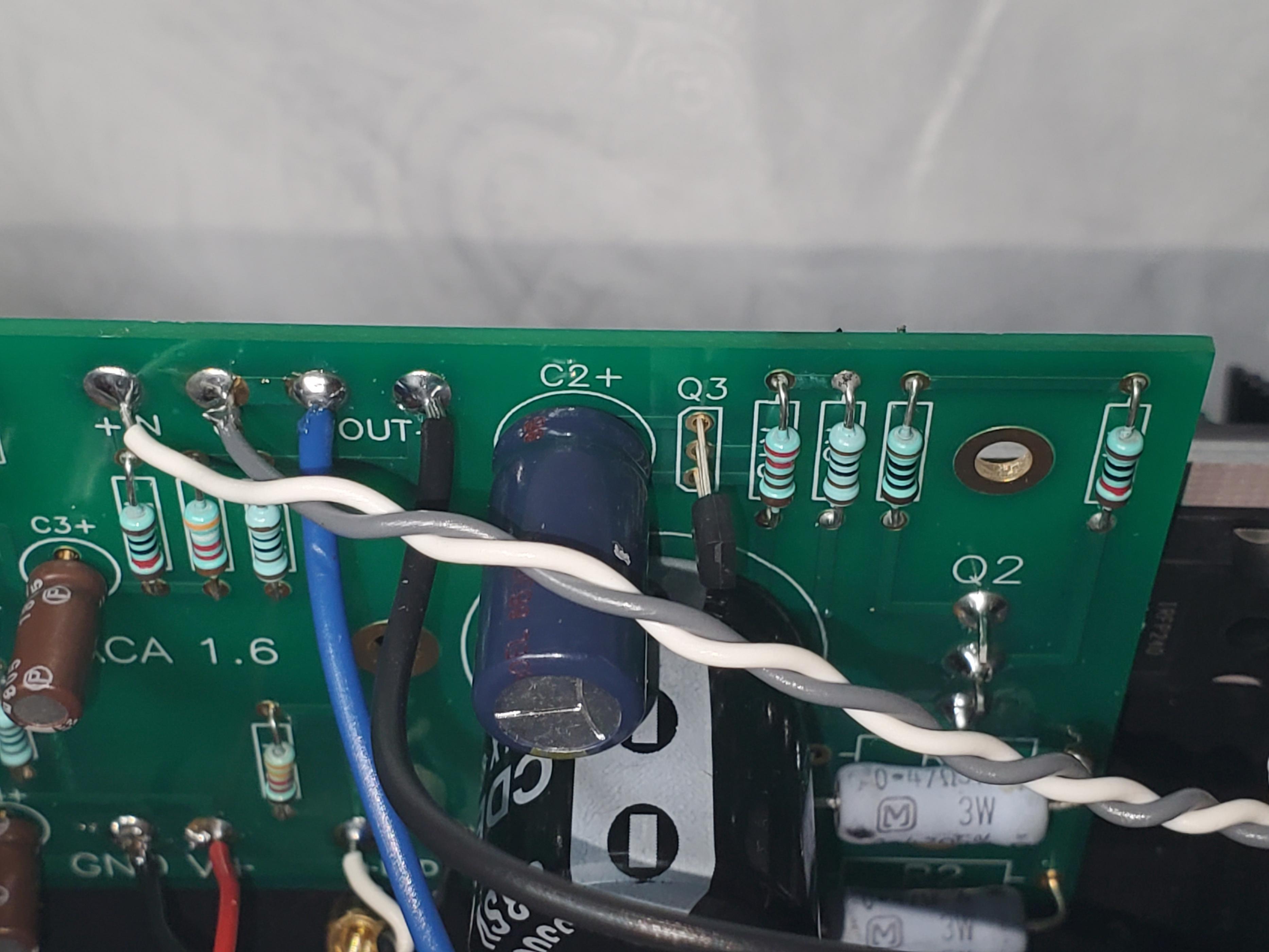

I built a pair of v1.6's and tested each one in stereo while waiting for a set of XLR cables from Blue Jeans Cable. They sounded good in stereo on my MJK OB's with H-frames. As expected, I had turn up the volume on the OPPO BD-105 to get the sound, it was amazing.
As monoblocks they really sing. Thank you to NP and all the others that continue to make this happening happen. Bill

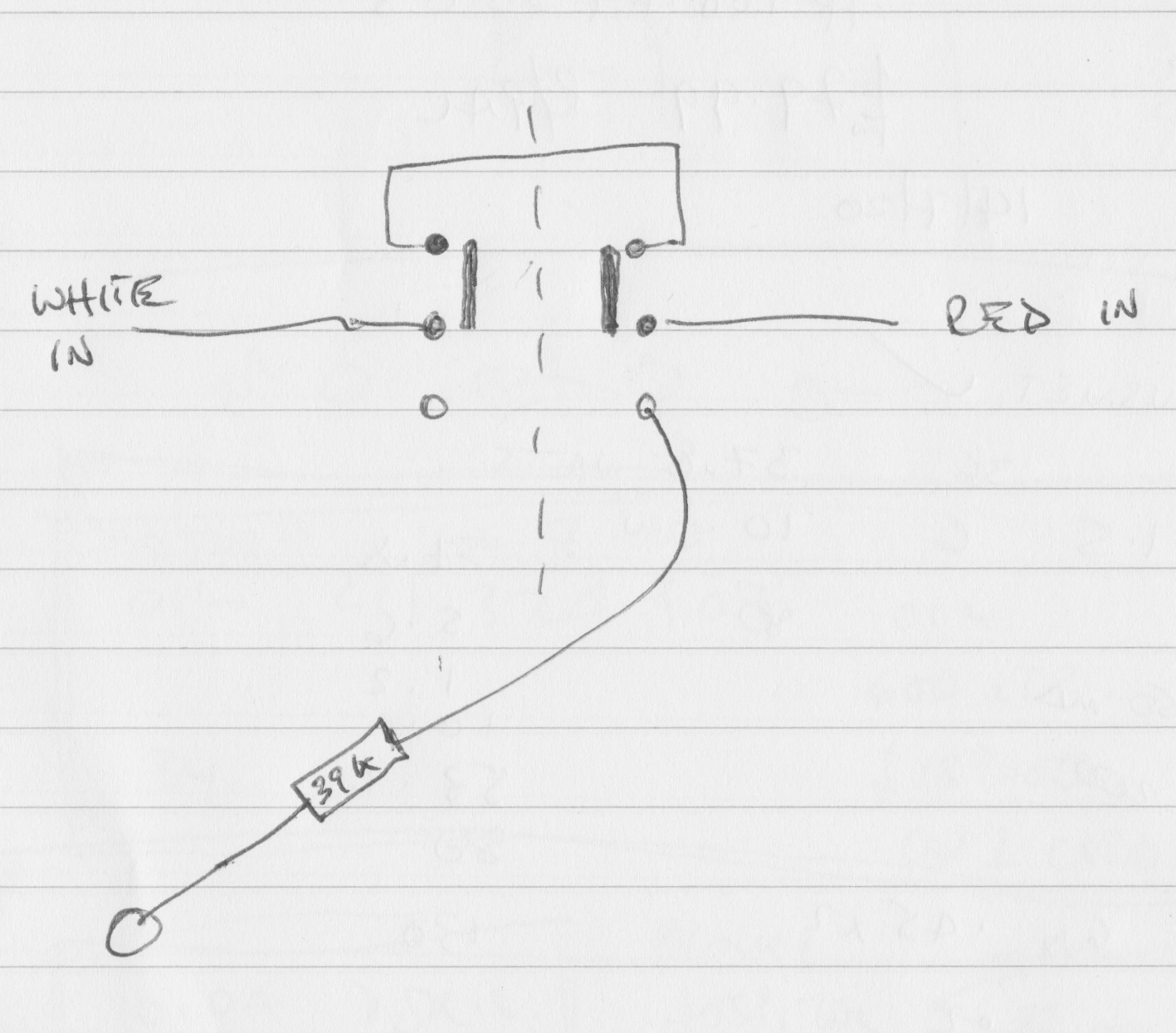

I Jason, My questions is about the top of the DPDT Switch, from the V1.8 wiring guide are the two top terminals supposed to be tied together? Or are they not connected to anything?
Thanks for your Future support
Mark
For the rear switch, almost any on-off-on DPDT switch will do.
For those building the V1.8 using V1.6 instructions, attached is a direct comparison that clearly shows the differences.
As the differences are very slight, I will rename this thread "V1.6 / V1.8".
Mark
Yes they are supposed to be 'tied'. This is for parallel mode.
When the switch toggle is down the White and Red inputs are joined together via the link.
See the diagram.
Likewise when the switch toggle is in the central position there are no connection. Stereo mode.
When the switch toggle is in the up position, the right half of the switch connects the 39K resistor (from the speaker terminal) to the Red input socket. Bridge mode.
Hope that helps?
See the diagram.
Hope that helps?

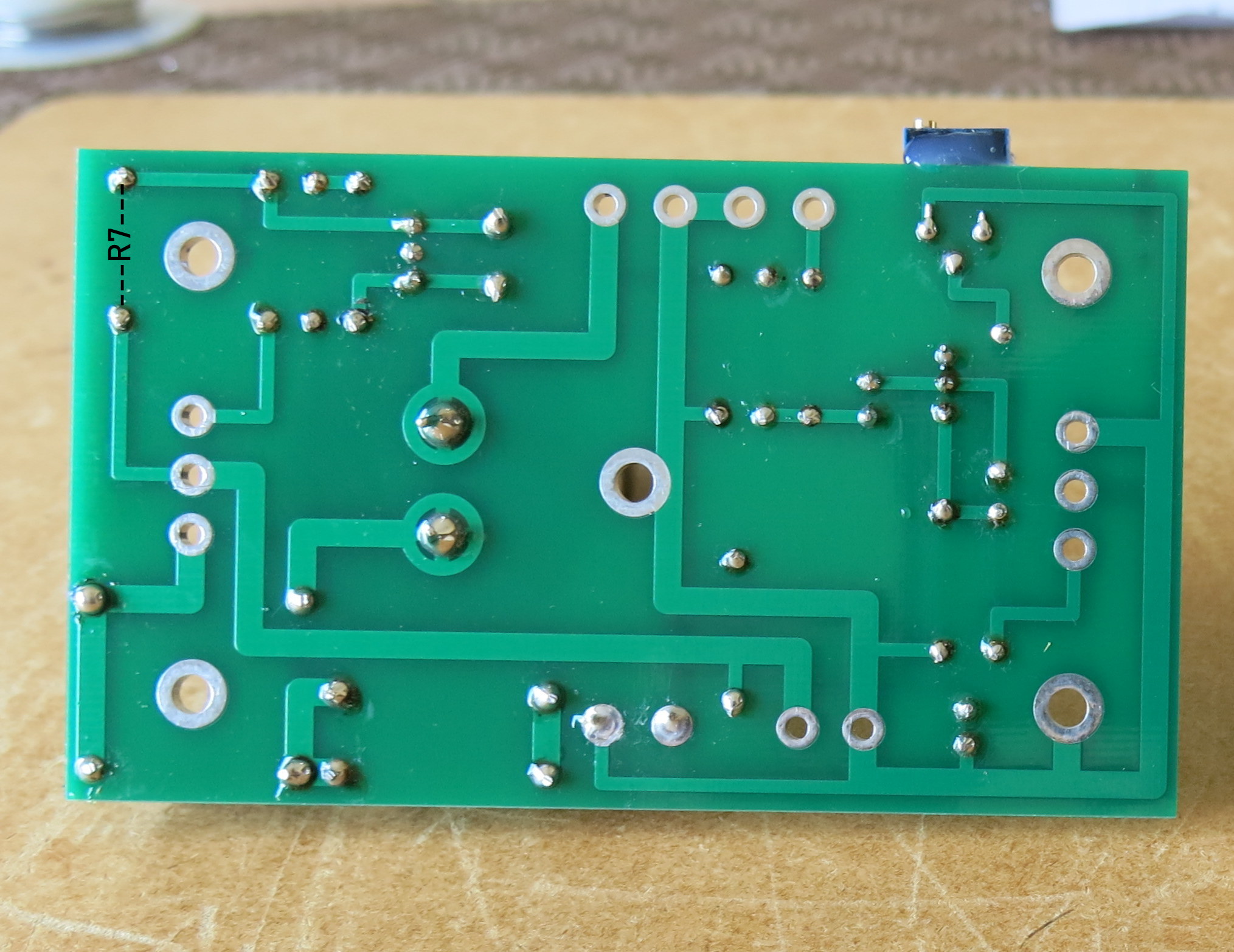

Can anyone share an image of the backside of the 1.8 board?
Tracking back my problem I have only 5.8 volts to R7. I have nearly 24 at Q2 drain and Q4 drain... somethings not quite right on my left channel..
Here is a picture of the rear of the board. Not sure it helps.

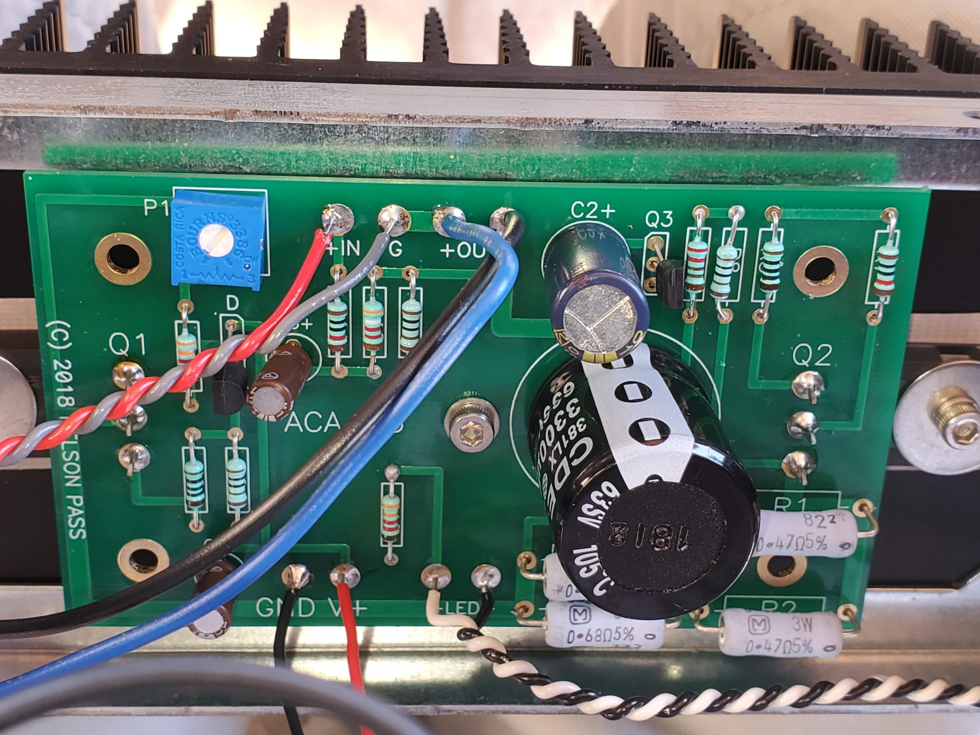

Bummer !
Q3 is correct (So is Q4 lol)
C2 has the p towards the positive
R7 measured damn near 10K ohms...
Attached is the problem child...
How can I check a transistor while in a circuit ?
Have near zero ohms from the legs of Q3 to any other points,
so its soldered well enough...
Time for bed.. the Am comes way too fast these days... and thanks again for your help...
EDIT--
I uploaded the wrong pic... The first is my right channel, working
the next two are my left channel and the problem one
EDIT--

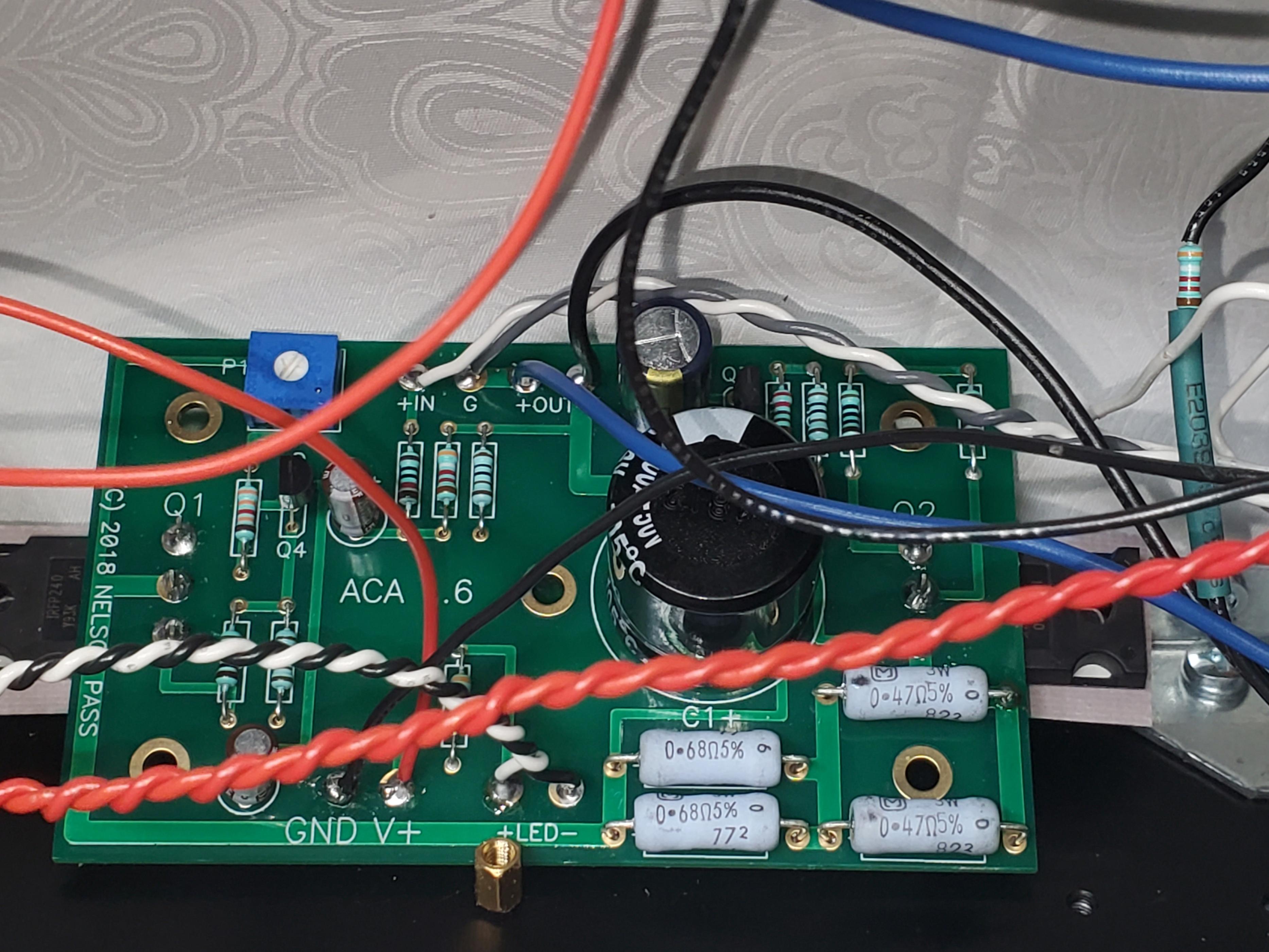

No solder coming through the board around the Q3 holes or the others, stick a bit more on from the side you can see in the photo if its still all bolted down to the heatsink.
Ok, will try.... but..
I tested the resistance from every pin i could to the next connection in the board and have pretty much zero ohms, there was one connection that gave me .6 or so ohms, i buttered that up and am reasonably sure its not the issue (i really ish it was)..
Willing to try anything, hopefully can wake up a few hours early tomorrow...
Every thing looks in the right place.
Your soldering is a little 'shallow'. Ideally the solder should show on the front (component) side of the board as well. Best to resolder all the joints now it is off the heat sink.
Going back to your initial post #771, did you notice if both Q1 and Q2 were both getting hot?
I wonder if Q1 D was shorted to the chassis. Maybe a blob of solder got stuck in the kerotherm pad? Have a careful look. The Drain is also the metal tab.
So resolder the board, remount the assembly back on the chassis. Check the Drain of Q1 and Q2 are not shorted to the chassis / GND connection. Try again.
Do Not be tempted to switch on with the assembly off the chassis.

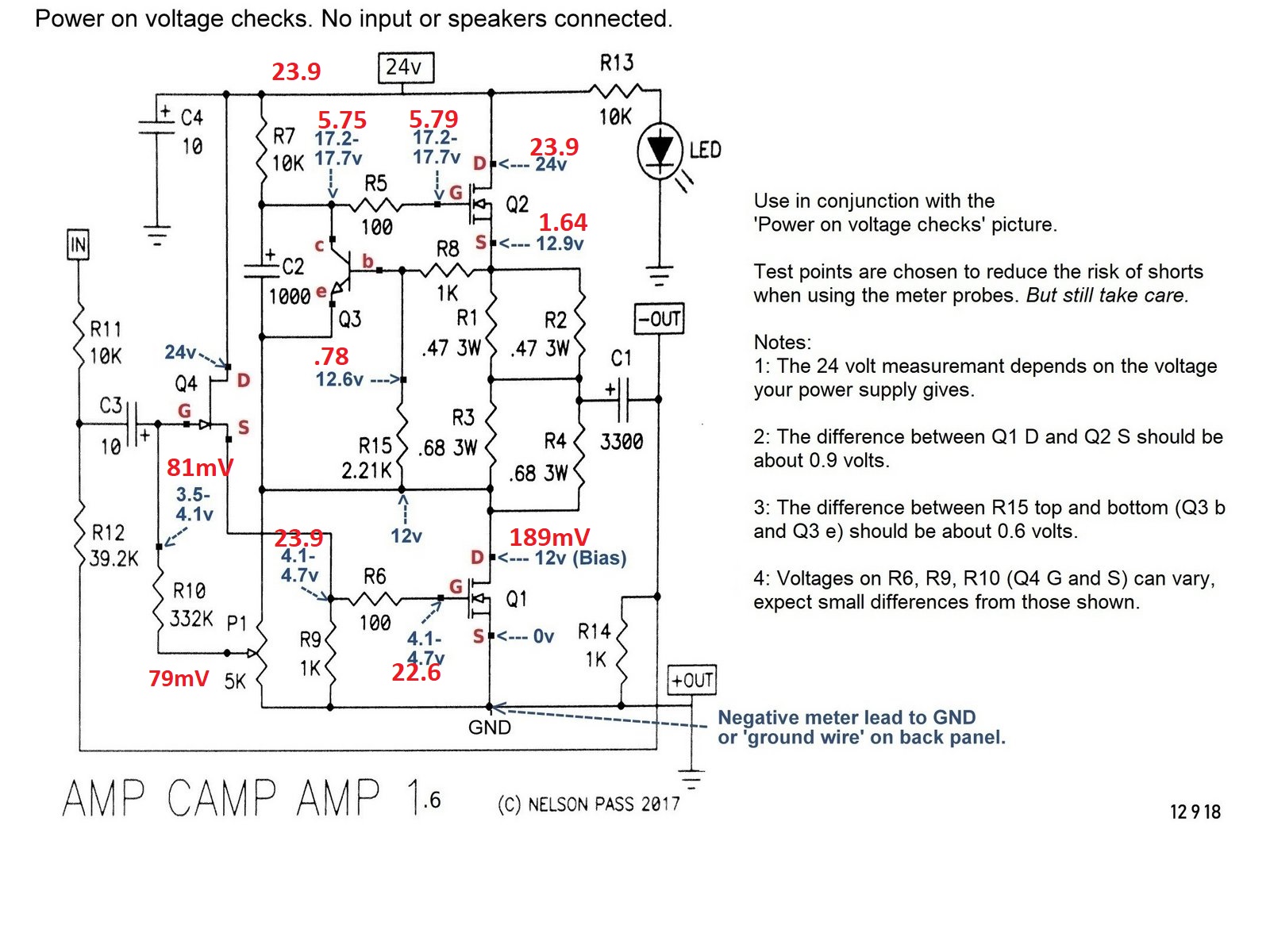

The only thing I can think of that could cause this... no voltage at the midrail and 5.8 volts on R7 (I assume the other end does have +24 present) would be Q3.
Make sure the device is marked as per the one in the good channel.
Check it in circuit initially and using the diode range range on your meter. Be careful to observe polarity of the meter leads when measuring and compare it to Q3 in the good channel.
Does it read similar or does it read either 'low' in any directions or more unusually, does it read 'opposite' in results to the good channel with regard to lead polarity.
Trying to see if I can order 1 channel, pcb and all components...
Attached is my last ditch effort and probably great fodder for anyone who loves troubleshooting this stuff.. I have a very basic knowledge of electronics, and this is well over my head....
The values in red are all in volts unless specified.
What strikes me as a lead is the source of Q4 is 23.9V and R6 drops it to 22.6V to the gate of Q1 (If im reading it correctly....)
I didnt see a bridge across the D&S of Q4, could it be bad ?
