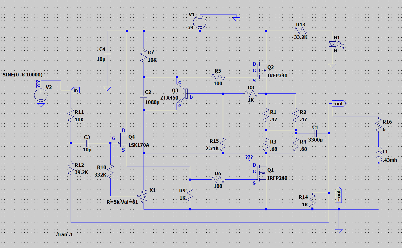

Your voltages show Q1 with 24 volts on the gate. That can only occur if Q4 was fully conducting and putting the supply voltage on that point.
That condition would give the voltages you are reporting and also cause Q2 to run hot as it is dropping all the supply voltage but still passing around 1 amp current.
So yes, based on the evidence Q4 looks 'bad' but before condemning it be sure to check that the gate is connected correctly (not floating) and that the input coupling cap is correctly polarised.
If you remove Q4 then the midpoint voltage should be at around 18 or 19 volts and both FET's should be cold.

What strikes me as a lead is the source of Q4 is 23.9V and R6 drops it to 22.6V to the gate of Q1 (If im reading it correctly....)
The FET is pulling the voltage down a little because the Gate-Source voltage is a little over the limit for the FET and so the G-S junction may be breaking down (almost certainly non destructively as there isn't enough current to damage it)

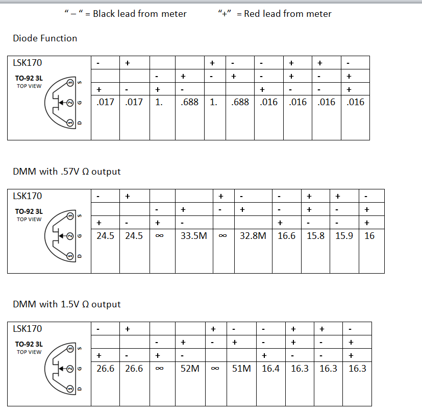

Anyhow, I tested what was left of the LSK170. As I have never tested a transistor, I hit you tube... Thought I had it, but the 2nd video went over JFET and had me a tad confused.. A few more videos later and I am more unsure of what I thought I understood.
Figured Id measure and keep track of my results... Than I hear about DMM's measuring ohms may not have enough voltage, than I see "Use a Diode Meter"
SO, now I have 3 sets of results that I can make little to no sense of... I thought a PNP JFET will conduct from the drain and source IF the gate has a negative voltage ? If that's correct, than I "think" the part is blown, but I look again at the results and may be think its ok. I cant make heads or tails of this...

It's not easy checking FET's if you are not used to doing so. They are such high impedance devices that the floating gate can pick up charge and turn the thing on making it look like it is short circuit.
The JFET is an N channel (we don't call them NPN or PNP) but confusingly for N channel FET's the arrow points inward, and outward for P channel.
If you have an ordinary NPN small signal transistor (like the BC547 etc) then I think that would work as a test to prove the rest of the amp was OK.
Collector would go to the supply and the emitter to R6 and R9. Base to where the gate was. If you try this then just tag it lightly to the board, don't fit it as permanent.
The bias preset would need to be turned nearly to one end but I think it would bias up OK and all work.

Wifey left for her sisters Had a day of learning LTSpice...
Drew up the 1.6 board, Ill be dipped in flux, it works lol..
Now to break things until I find out exactly what went wrong with my channel...
Since this is literally day 1 using LTSpice (Or any circuit design software), I think I made good progress.. I had to create a pot, and added the txt ext so I could upload here...

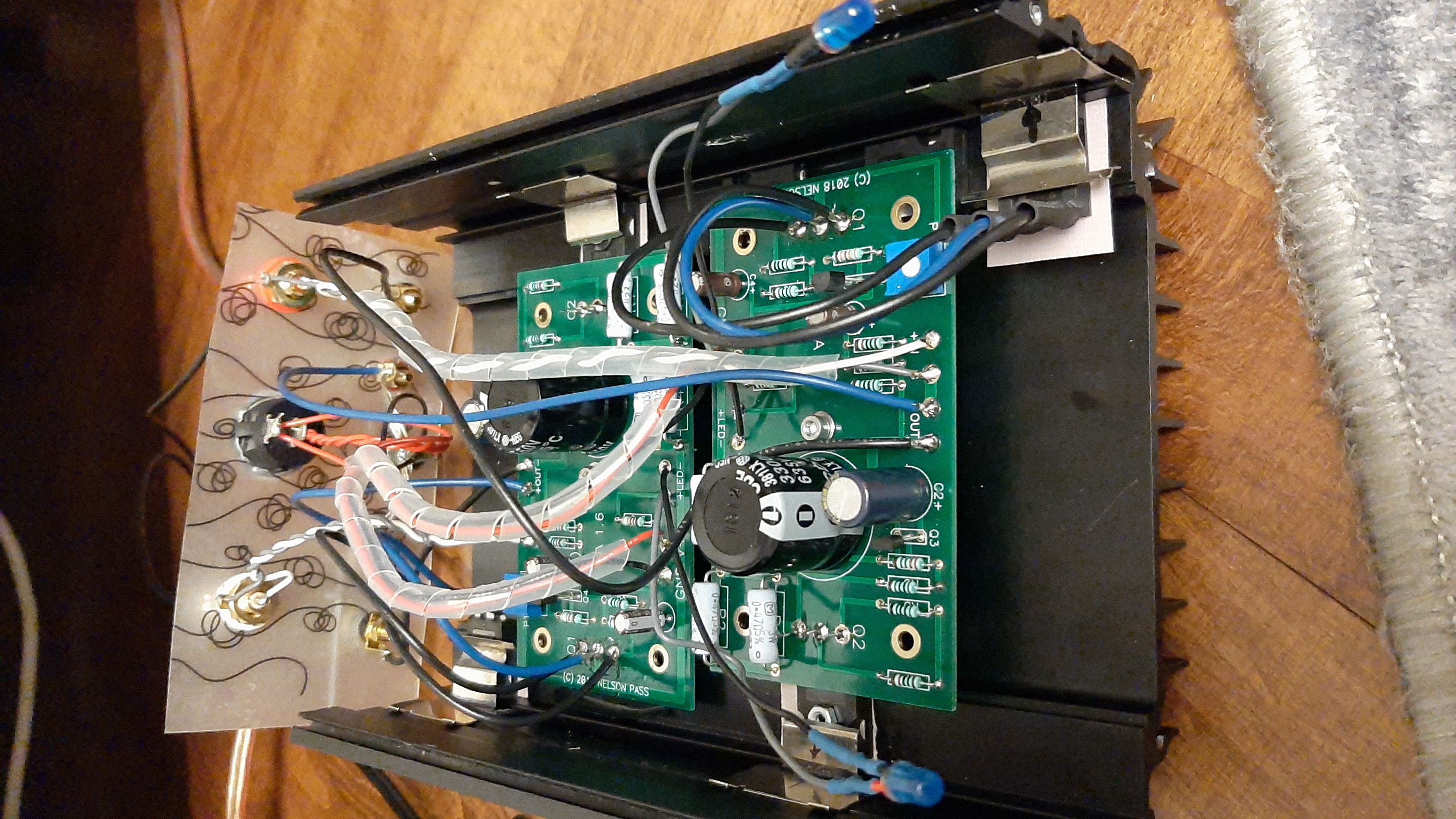

Hello to all. ACA V1.8 was my first diy build and want to share some incidents I had.. I ordered the kit and the power supply from the store but not the chassis. I had some issues at Turkish customs, as expected, so it was the right choice not to order the chassis (invoice from US, payment to US, chassis shipped from Italy, will be a mess in customs ) Also given the fact that I had flied to Bologna IT couple of times per month before Covid, and Hifi 2000 is in Bologna, I postponed the beautiful Hifi chassis for a while..
I found a Bose auto amp chassis from my friend for the task.. Stuffing/soldering the pcb went pretty well by the help of the build guide (thanks for that again). It would be great if the chassis were 1 inch wider because I realised that I had to reposition one of the mosfets So I decided to install one of them under the board and that gave me a big headache at the end.. I bolted one of the mosfets into the bottom of the chassis, then put the pcb onto it and soldered pins from the top..but with my "clever" ! positioning pins 1 & 3 were inverted! I realised this during dc balance since there was no voltage change when I turned the pot I desoldered the mosfets and installed them to a remote location and connected them to the pcb with wires.. and walla, the amp worked dispite my torture on mosfets! I was worried they were fried with the wrong connection..

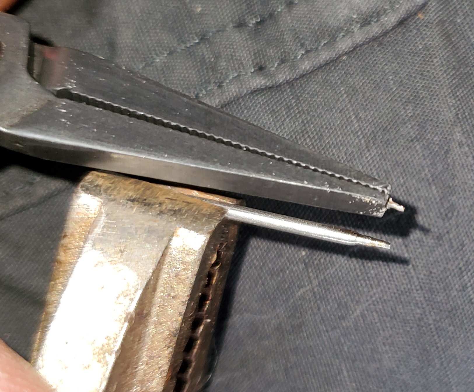

Managed to get the stuck pin out... Took a brad, cut the head off, chucked it in my drill and filed it down... 1 Vise grip later, and heating it was able to easily push the broken leg out enough to get a grip with pliers, some more heat and boom...
Going to save that make shift tool
