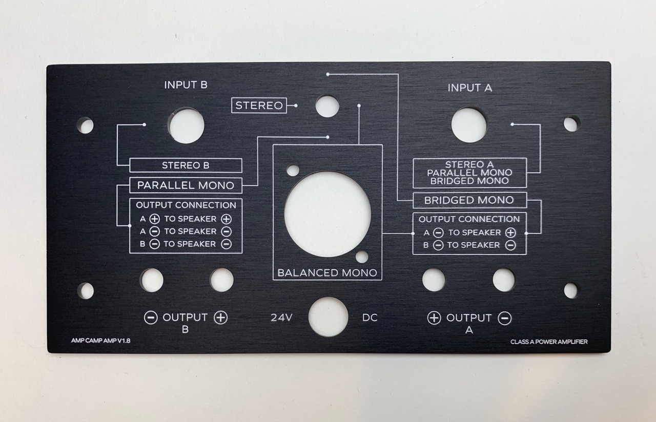

My suggestion is to try both parallel and bridged and balanced if you have a balanced preamp, (or even back to the single chassis stereo) and see which you prefer. That’s the advantage of the switching in V1.8 you can quickly change a speaker cable or 2 and flip the switch and so can compare the options. Speakers are a complex load, so one can’t say for sure

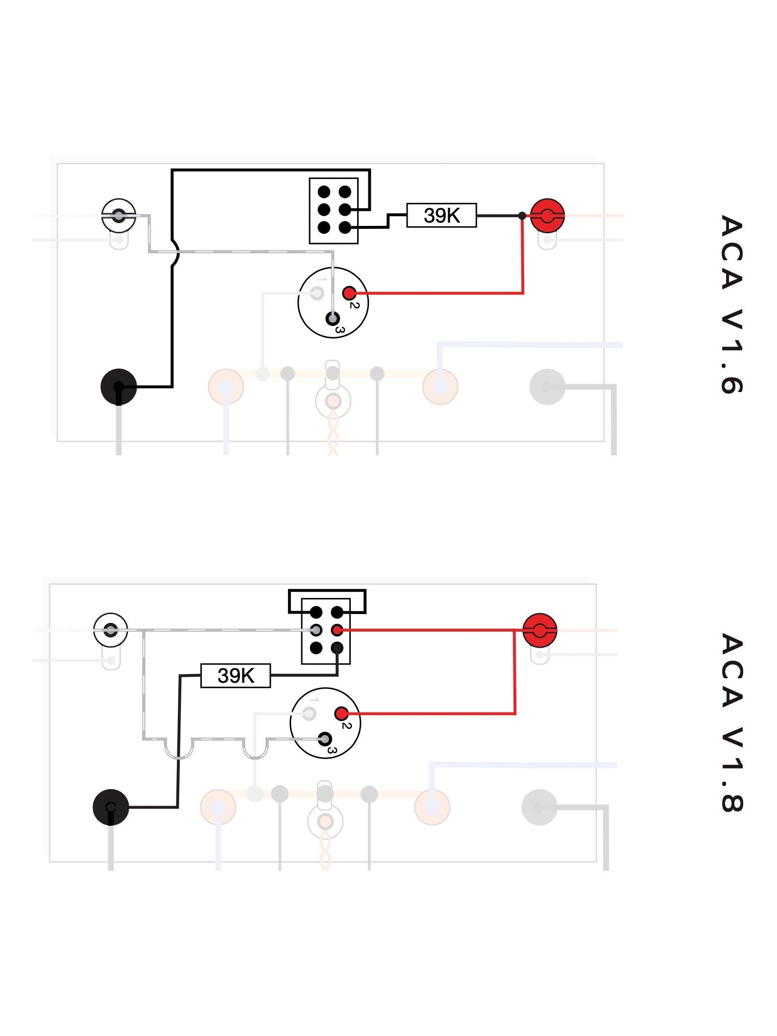

in conclusion, with new switch , may i know the position for stereo, bridge and parallel?
down : stereo & balance
center : off for both (???)
up : bridge rca
is this right? sorry for stupid question.
up : bridge rca
If you have wired the 3 position switch as the v1.8 diagram,
Switch UP = Bridged Mono. Using the White RCA input and output from the Black speaker sockets.
Switch Centre = Normal Stereo mode using the 2 RCA inputs, or Balanced Bridged Mono using the XLR input.
Switch Down = Parallel Mono mode. (Remember link the Black speaker connections together too.) In this mode you can use either RCA input and either pair of Red and Black output sockets.
Another suggestion that I often do simply to not make simple mistakes after a long build session. When in doubt, convince yourself of the switch positions by determining which ones are enabled at which position by getting out your DVM on Ohm mode and testing across the leads of the switch.
