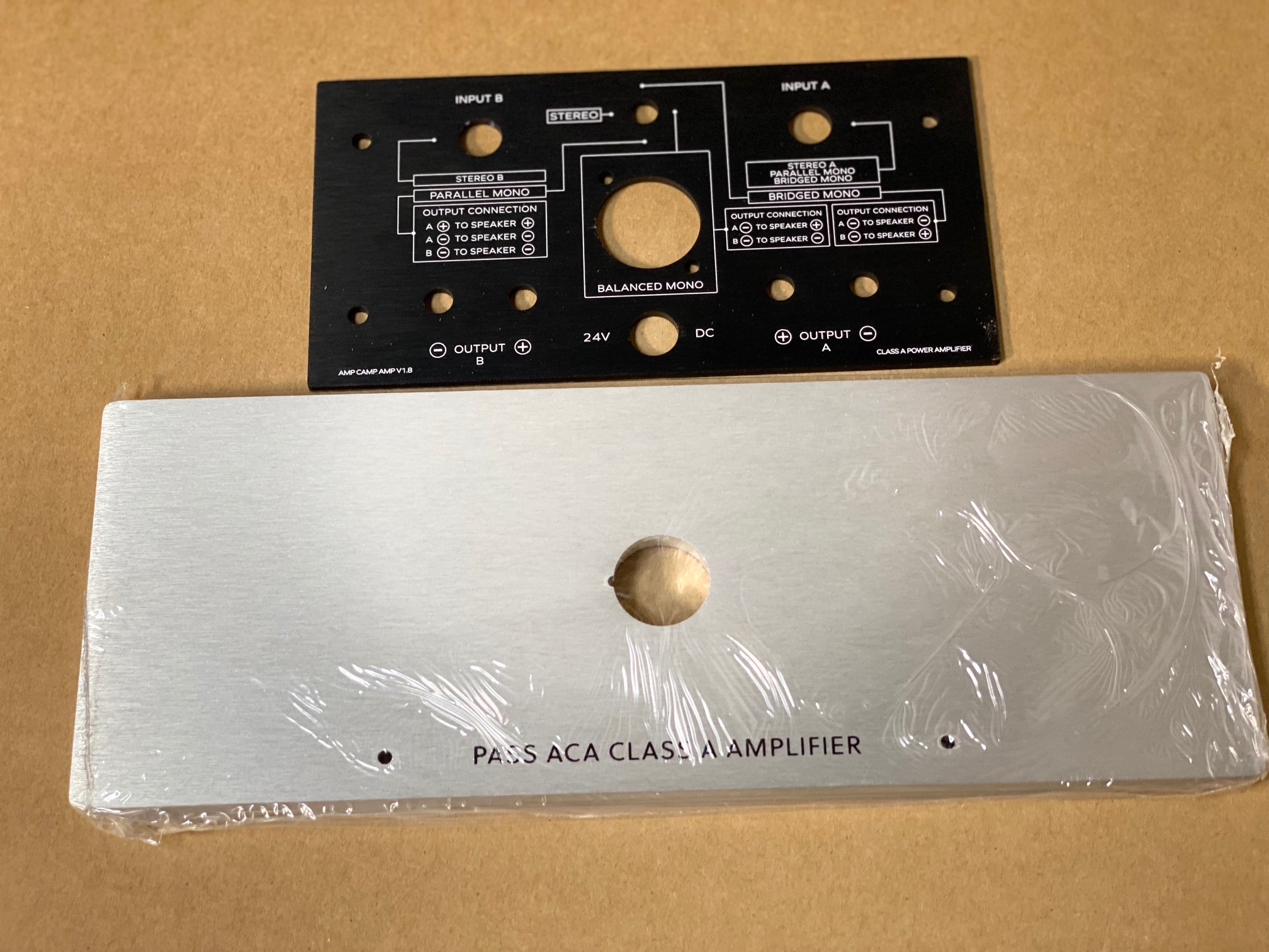

looking at the wiring picture... don't understand where the two, black, twisted wires go from center of ground bus :-/

both ACAs are now down at work 🙂
connected as Balanced monos:
