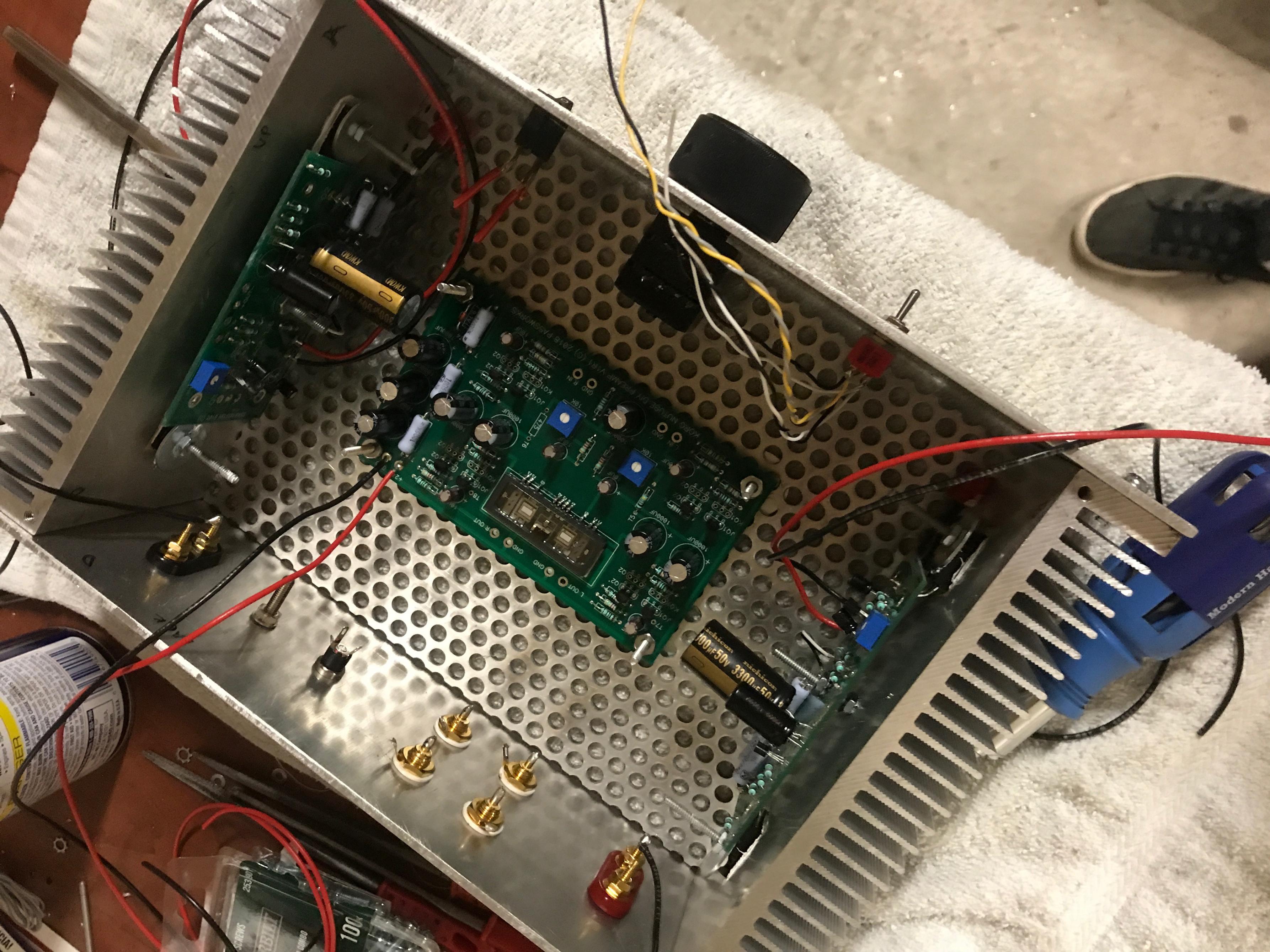

I built my initial ACA 1.8 for a friend to use in her system and it has been working very well for her. I was impressed with the sound myself and decided to build two more so I can use it in balanced mode. I made some minor substitutions of parts as detailed in the ACA Amp with Premium Parts and the build went well and in testing the voltages everything looked okay. However, I am running into some problems with the operation which I will detail below:
1. Stereo Mode: Adequate sound is only achieved from the right channel. Very low output can be heard from the left channel and increasing volume brings distortion pretty quickly. This occurs regardless of the position of the toggle switch. If I swap the speaker cables the opposite occurs, so I know the left channel is capable of producing adequate sound, just not when everything is hooked up correctly.
2. Monoblock operation, unbalanced connections: With the toggle switch set to the middle (stereo/balanced mono) or top (bridged) position the left channel produces sound but it is distorted and the right channel has low output. If the switch is in the bottom (parallel) position everything is fine. Speaker cables (outer posts of each amp) and interconnect cables (Chanel A input of each amp) are connected per the 1.6 build guide.
3. Monoblock operation, balanced connections: This one is a little stranger as I get buzz regardless of the position of the toggle switch. Due to balanced operation I have to use a different preamp here so that may be the issue. When the toggle switch is in the up (bridged) or middle (stereo/balanced mono) positions everything sounds is fine. In the bottom (parallel) position no sound at all.
I went back and checked over the wiring which looked okay, I did re-solder the wire to the input jacks and speaker terminals more out or precaution than anything else. I am stumped though so any help would be appreciated.

Is it one ACA with the problem or two ACAs both with the same issue?
Low power and distortion sound is normally a shorted output. Check the resistance between the red and black terminals, should be 500 to 1000 ohms.
Do the same for the inputs too. You should get about 50k ohms from the RCA outer ring to the centre pin.

Check you haven't stuffed one of the plastic insulators that isolate the speaker terminals from the chassis - same for the RCA connectors. Cost me a few hundred dollars to have a professional diagnose I'd stuffed my valve amp up with a tiny metal bur when I opened up binding post holes to fit new ones. Both the pro and I went all over the soldered joints checking for continuity before it got tracked down. To a tiny metal spike shorting a terminal.
@Alan 4411 - Thanks for the suggestion, here are the measurements:
Amp 1: Channel A and Channel B inputs = 111k ohms. Speaker output Channel A = 0 ohms, speaker output Channel B = 1k ohmns.
Amp 2: Chanel A input = 111k ohms, Channel B input = 45k ohms. Speaker output Channel A = 0 ohms, speaker output Channel B = 1k ohms.
@Steve Luck - I should note I am not using the stock binding posts. I put in Cardas binding posts that required me to drill the hole a bit bigger. I will remove the Channel A binding posts on both amps and clean things up a bit. I have a surplus of the Cardas posts so I will put another set in.
I will try and post pictures later if I can't get things going. Any other suggestions are welcome.
Amp 2: Chanel A input = 111k ohms, Channel B input = 45k ohms. Speaker output Channel A = 0 ohms, speaker output Channel B = 1k ohms..
The Channel As 0 ohms is one fault, you have a 'short' there somewhere. First make sure you have the speaker OUT + and - wires in the correct locations at the board. (Do not forget the + OUT is ground / 0 volts).
If they are correct, unsolder the wire from the - OUT on the board. Measure the resistance from OUT - and + at the board. It should now be 1k ohms. If not there is a problem at the board. If it is correct, the black output socket is shorted to the chassis or there is a wiring problem...
Not sure why you have different input resistances? They should all be the same. Standard build ACAs measure about 50k. If you have altered the values of R11 and R12 the figure should be the addition of those two values.
Alan
@Alan4411 - speaker wires are connected correctly per 1.8 wiring diagram. Unsoldered the minus output wire at the board and measured to plus wire and got 1k ohms on both amps.
In my setup R11 (20k) and R12 (91k) are why I get 111k ohms. I rechecked and this time everything was 111k so I guess I am good there.
I will focus on the output terminals on the left channel.
As an update one of the amps is now working. I ended up going back to the stock binding posts and now it plays both channels in stereo and the correct channel in bridged mono. This is with an unbalanced RCA connection. I haven't tried the balanced XLR input yet as I wanted to wait until the other amp was up and running. Unfortunately after replacing the binding posts in the second amp the left channel would still not produce any sound. In addition, while the input and output measurements were within the specified range, on the board I could only get the voltage to go up to about 8V DC, and after checking the other test points, only Q2 D was within range. All other values were off by a good amount.
