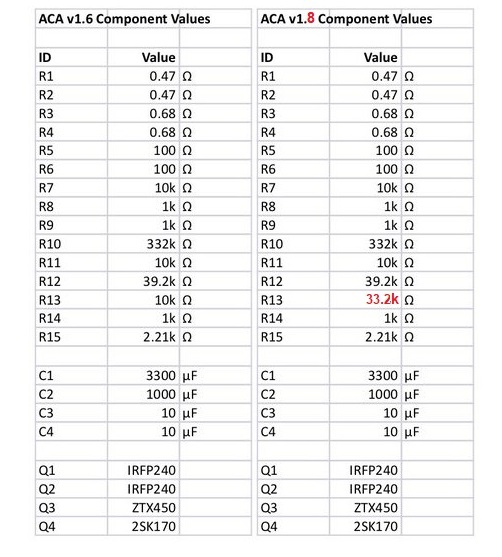

Building V1.8 (on V1.6 board) - available resistors are 33.2, but diagram calls for 100. What's the correct value to be used please?

Are you building from the kit or from your own parts?
Which resistors are you questioning?
Use the diagram or screen print on the board and let us know.

I’m building from the kit and feel like a dunce for not mentioning I was worried about R6 on the PCB. It became unnecessarily complicated because I’m short 4 resistors on the kit count. I need to buy replacements but started to doubt which ones I’m missing.

No problem - do not feel like a dunce. Best to measure all the resistors and match them to the list before starting...
R6 needs to be 100 ohms.
The 33.2k resistors fit in the R13 location. They replace 2 x 10k resistors in the V1.8 kits. (They make the LEDs less bright.) Everything else is the same.
Here is an updated parts list:-

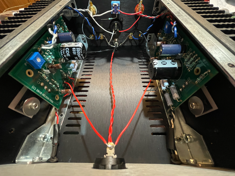

Hi guys looking for some advice have built 2 ACA amps and both have same problem it sounds like the output stage isnt working as all 4 boards are the same its obviously something i have done wrong i get a low level sound output that fades in and out. Have removed one of the pcb to test.Have done a resistence check as per fault finding info and everything is in spec.Output transistors dont get warm and there is no switch on thump so pretty sure its the output stage.

Umm, not getting warm is odd.
Do the leds 'pulse' on and off with the 'sound output'?
Could you set the 'bias' voltage to 12 volts?
Have you checked the voltages as per the troubleshooting section of the build guide?
Have you got the transistors in the right places and the right way round? Have you got the capacitors in the right way round?
Best post some good pictures of your build.
