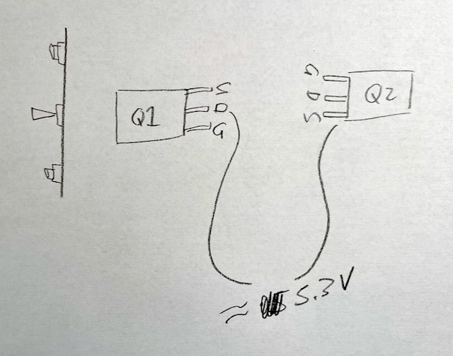

Sorry for posting so much. I just learned about misfit gate, drain and source and how to test them.
It seems like the voltage between Q1 Drain and Q2 Source is only about 5.3V

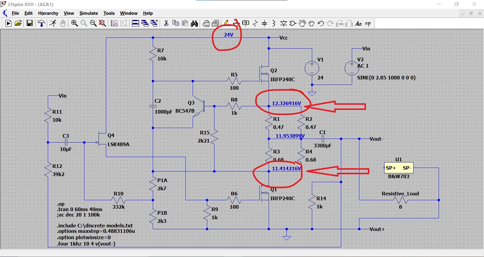

The voltage between Q1 Drain and Q2 Source should be around 900 millivolts. That voltage appears across the 0.47 and 0.68 ohm resistors and allows us to calculate the current.
Connect your meter to the two arrowed points and you should read about 0.9 volts.

Sorry again for so many posts. I'm going to try and attach a diagram of how i tested the mosfets. Thanks again for your help!

If you have never had heatsinks attached then I would say that it probably would have worked correctly had they been.
I think you should replace the FET's now tbh as they may well be impaired or damaged due to excess heat. They got even when bolted to the heatsink.
You mentioned you had around 5 volts between Drain and Source of the two FET's. If so then that suggests the the 0.47 and 0.68 ohm resistors are high in value... again damage that could have occurred due to running the FET's without heatsinks.
Check those resistors are OK.

0.83 volts sounds OK. That means a current of 1.44 amps is flowing (assuming those resistors are OK) and that is correct.
So working with it as it stands now you should also have approx 12 volts between ground and the midpoint (the output coupling cap... see my diagram above).
If all that is OK then it should all be working.
