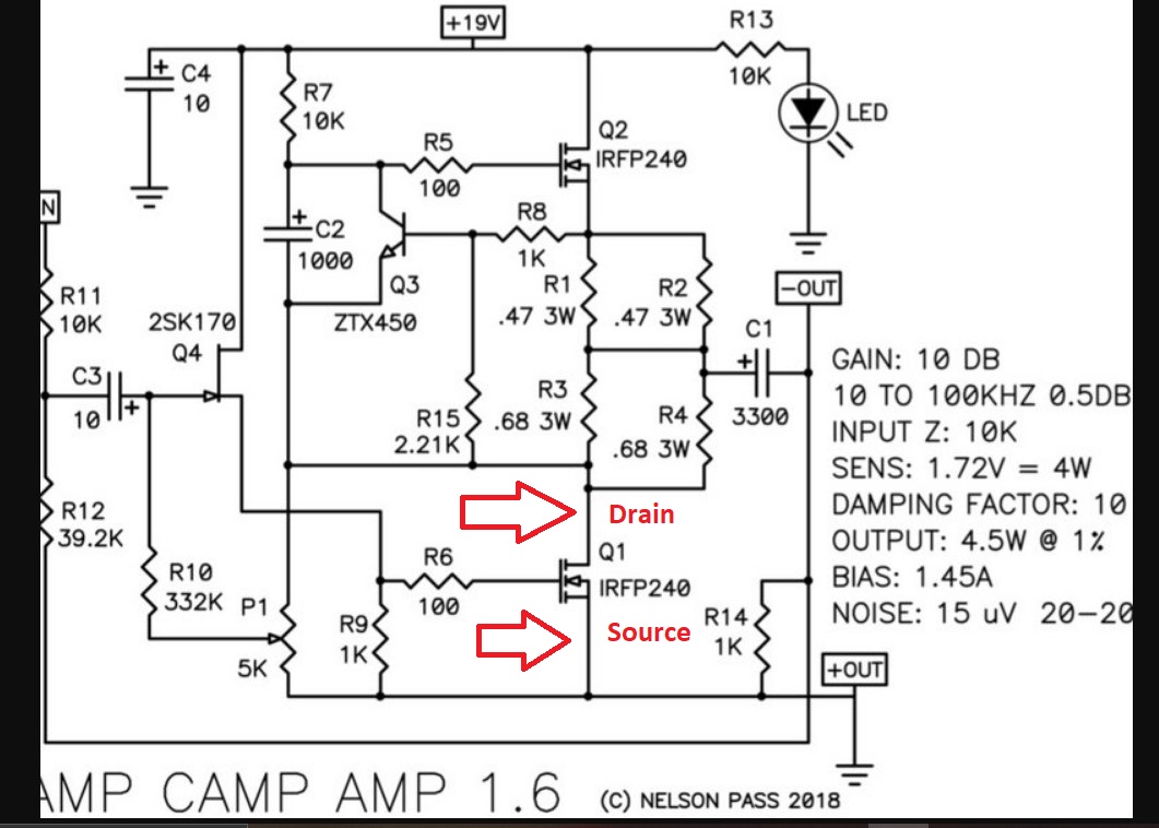

Hi Mooly
I checked all connections for input and speakers and I had them wired correctly but I went ahead and reflowed it all to be sure. Also I found minor solder spatter between S & D of Q1 ( where S read 11v instead of 0v) it didn’t look even close to bridging the two but I scraped everything clean prior to powering up.
Let it warm, adjusted voltage and rechecked S on Q1, now it reads 9v instead of 0v. What would cause that?

Just to confirm: there is no thump on startup of the ACA, only those charging caps sounds. Depending on your setup (stereo, balanced, bridged, etc.), there is a power off thump, but very minimal.

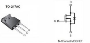

Q1 is the lower FET and the source should go to ground (zero volt line). I think you are mixing up the terminology here 🙂 That point should always be zero volts, even if you have a fault or a short anywhere else.
The middle lead of Q1 is the drain and that should be adjustable to either +9 or +12 volts depending on whether you are using an 18 or 24 volt power supply.
If it will not adjust then first question has to be whether the input FET (Q4, the 2SK170) is a genuine part.
If you can not achieve that 'half supply voltage' setting on the middle pin of Q1 then you have an issue, either Q4 is suspect if not genuine or you have a component error.

The middle lead of Q1 is where I adjusted voltage. The lead marked S on the Q1troubleshooting photo indicates 0v. This is the lead that shows 9v not 0v on my white board. Am I still confused? Yes I am😉

Before you do anything else, make sure the rear switch is in the 'Central' position. If it is in either of the other positions you will have parallel connections between the 2 inputs...
And the middle lead is the Drain. You should be able to adjust this point above and below one half of the supply voltage you are using.
I'm not familiar with that picture but yes, Q1 Source is definitely ground and 0 volts would be correct.
If you have 9 volts on that point then either you are measuring the wrong point of the connection is open circuit from FET to ground.
