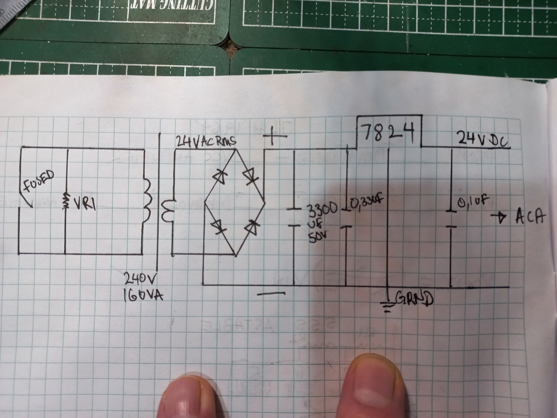

So the new plan is a 7824 regulator and I just bought
a 160VA Torroid transformer.. Actually I bought 2 after realizing another project of mine is underpowered in the same fashion.
Attached is a rough drawing of the PSU.

The SMPS is by far the best approach for the ACA on technical grounds.

That will never power an ACA, not even 1 channel.
The ACA is probably the most unsuitable amp you could choose based on your requirements 🙂 It has to be said... just so you know.
A bridged chip amp would deliver many times more power and have next to nothing quiescent current draw.

I'm say the SMPS is the best PSU for the job here. It wins on cost, size and performance.
You need to look at the PSRR of an ACA before deciding to go down the linear route. Yes, a linear supply can offer excellent performance but its no small task to end up with a result that will be a as quiet as the SMPS.
If you want to learn about design then that is to be applauded but do make sure you understand all the pros and cons of each PSU approach first.

What he is saying is that the PSU you have drawn will add noise to the ACA. That is the worst thing to do to that amplifier circuit and will have an impact on the sound quality of a wonderful design.

I did read it. Many moons ago. Please show the ripple you have calculated for your power supply. Without those calculations all your words are just some noise. Please feel free to build your supply and test it. This is just audio nothing more. To learn more about the ACA and the modifications that have been successful, look for the thread titled "ACA with premium parts".
