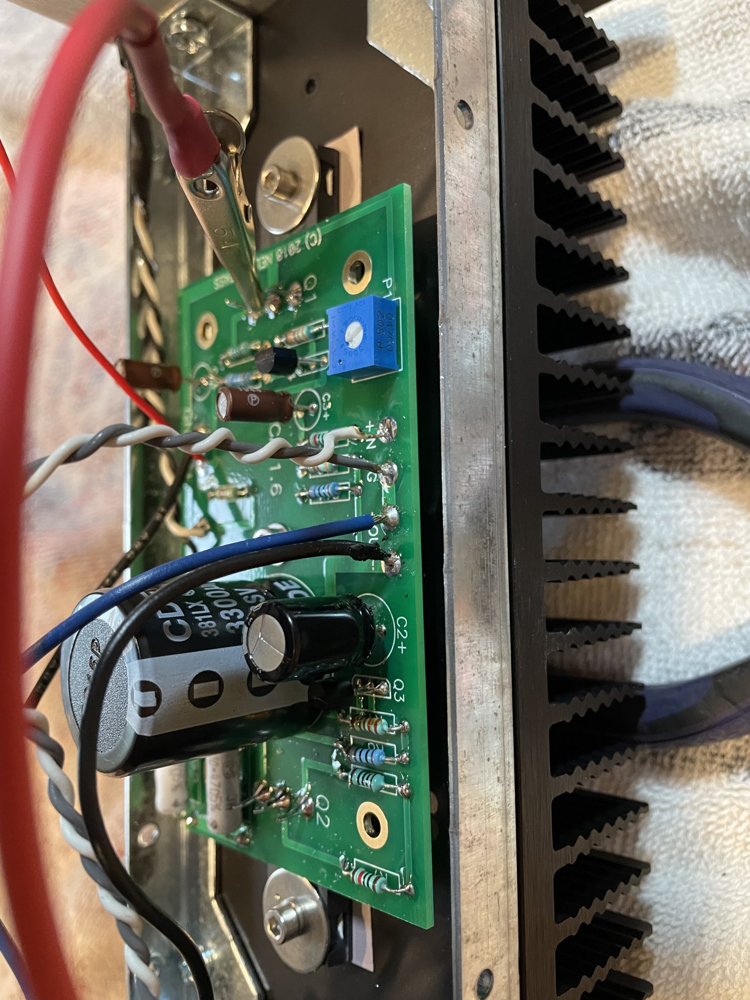

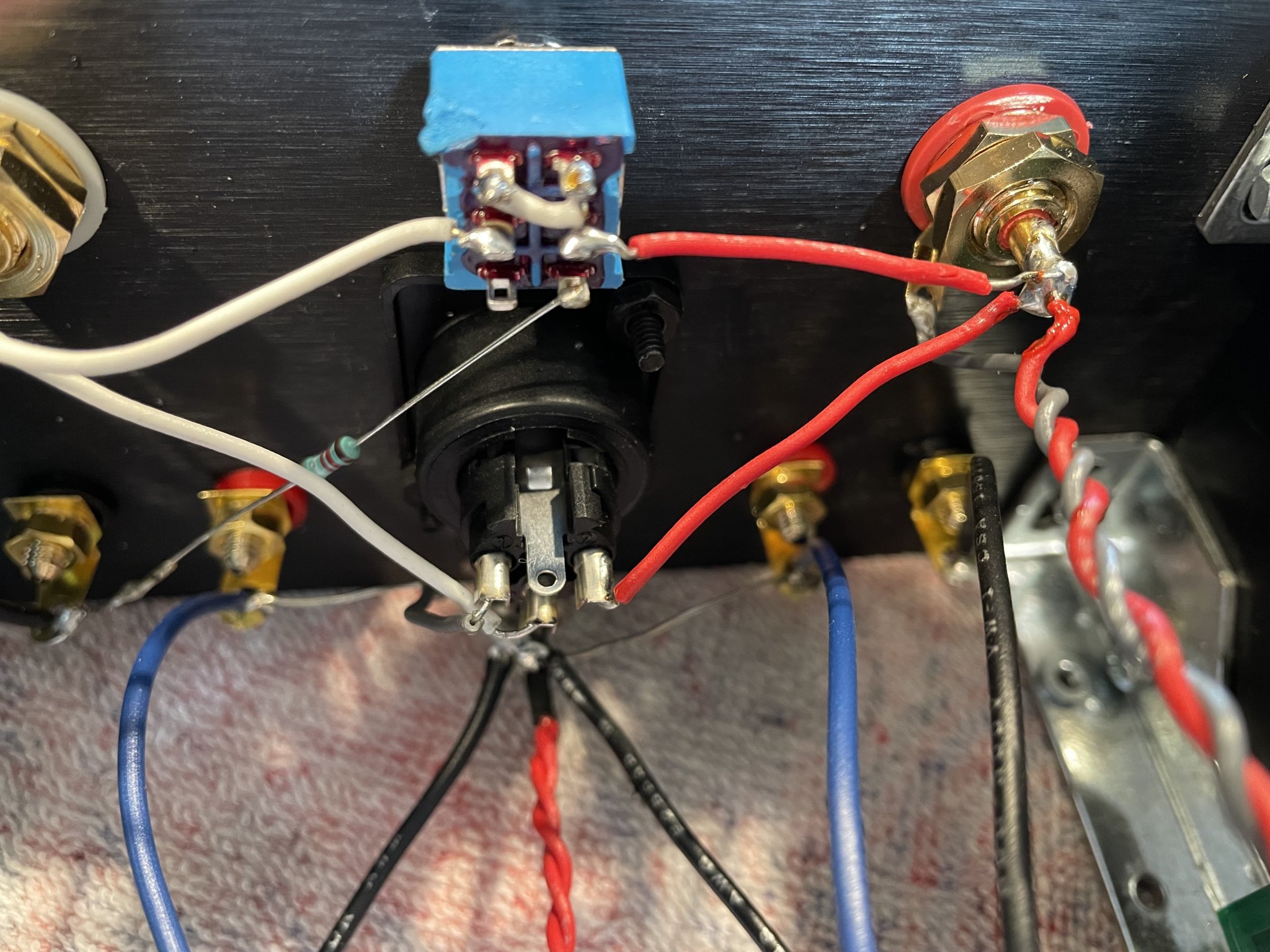

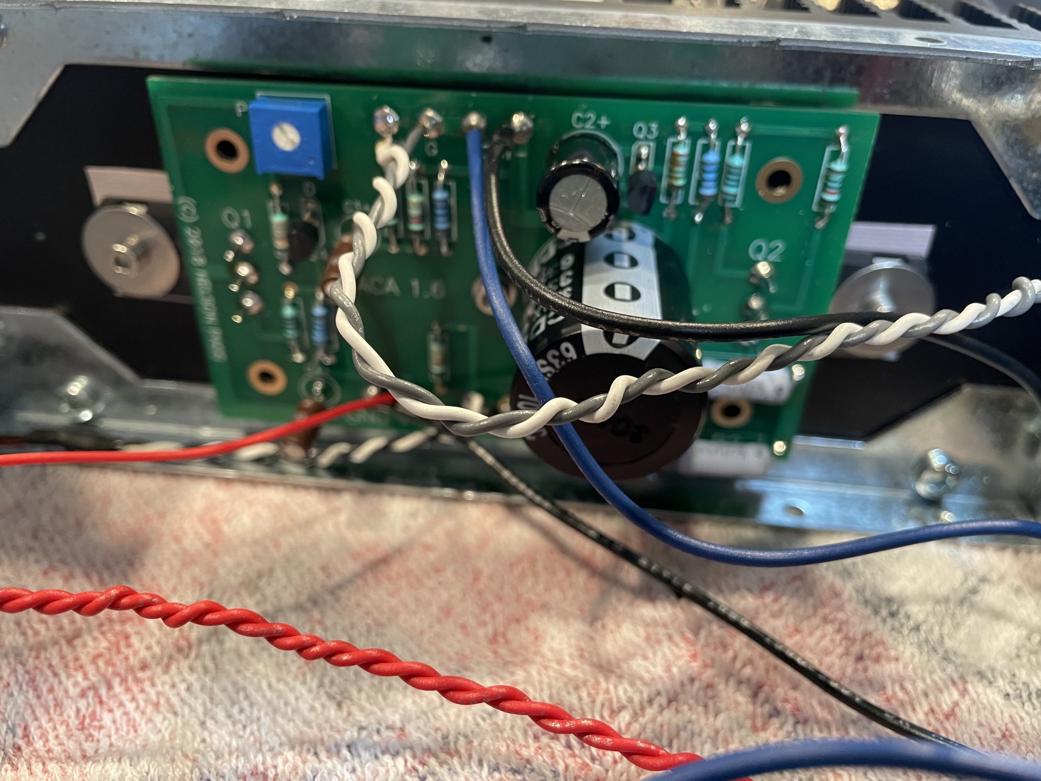

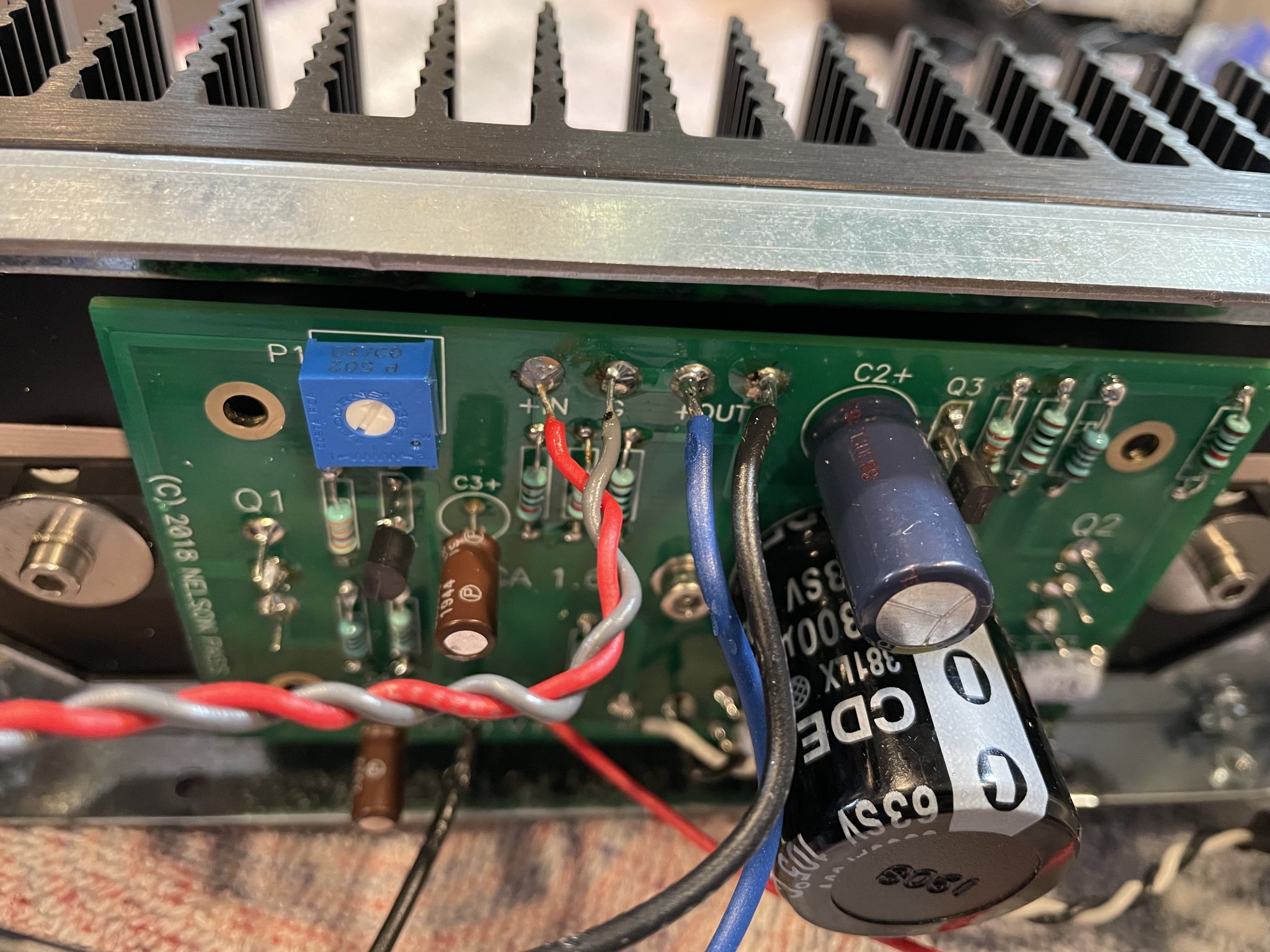

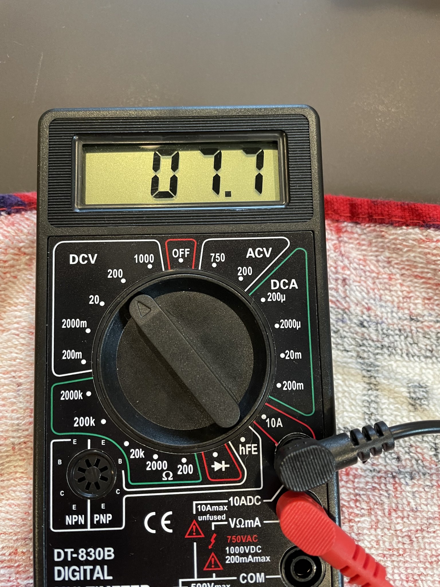

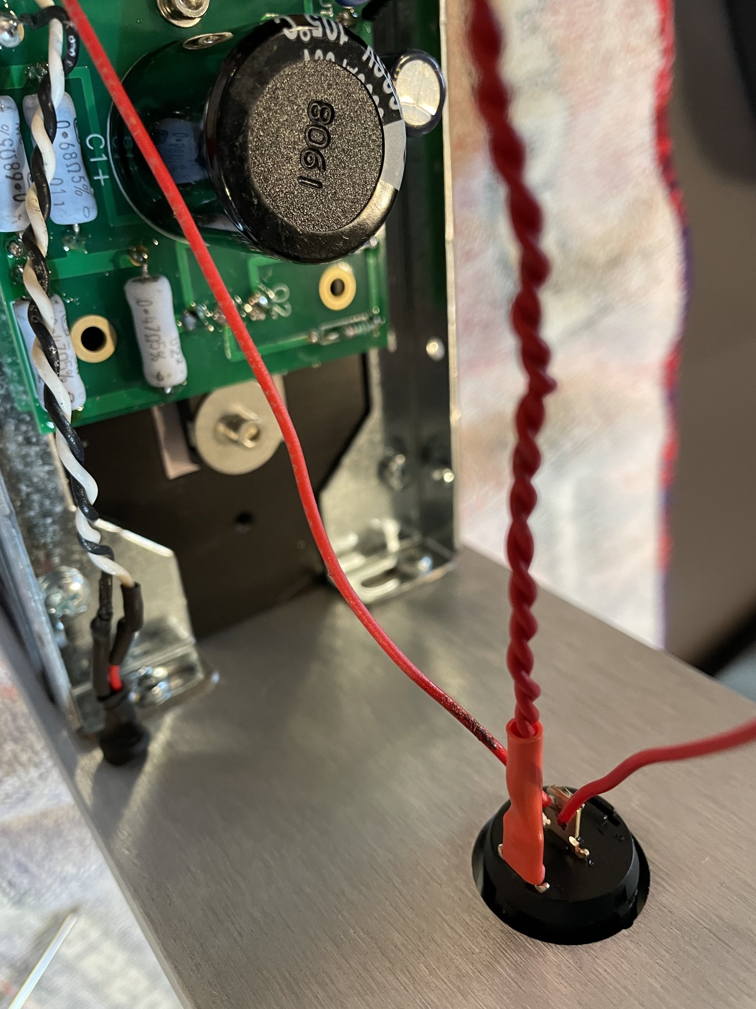

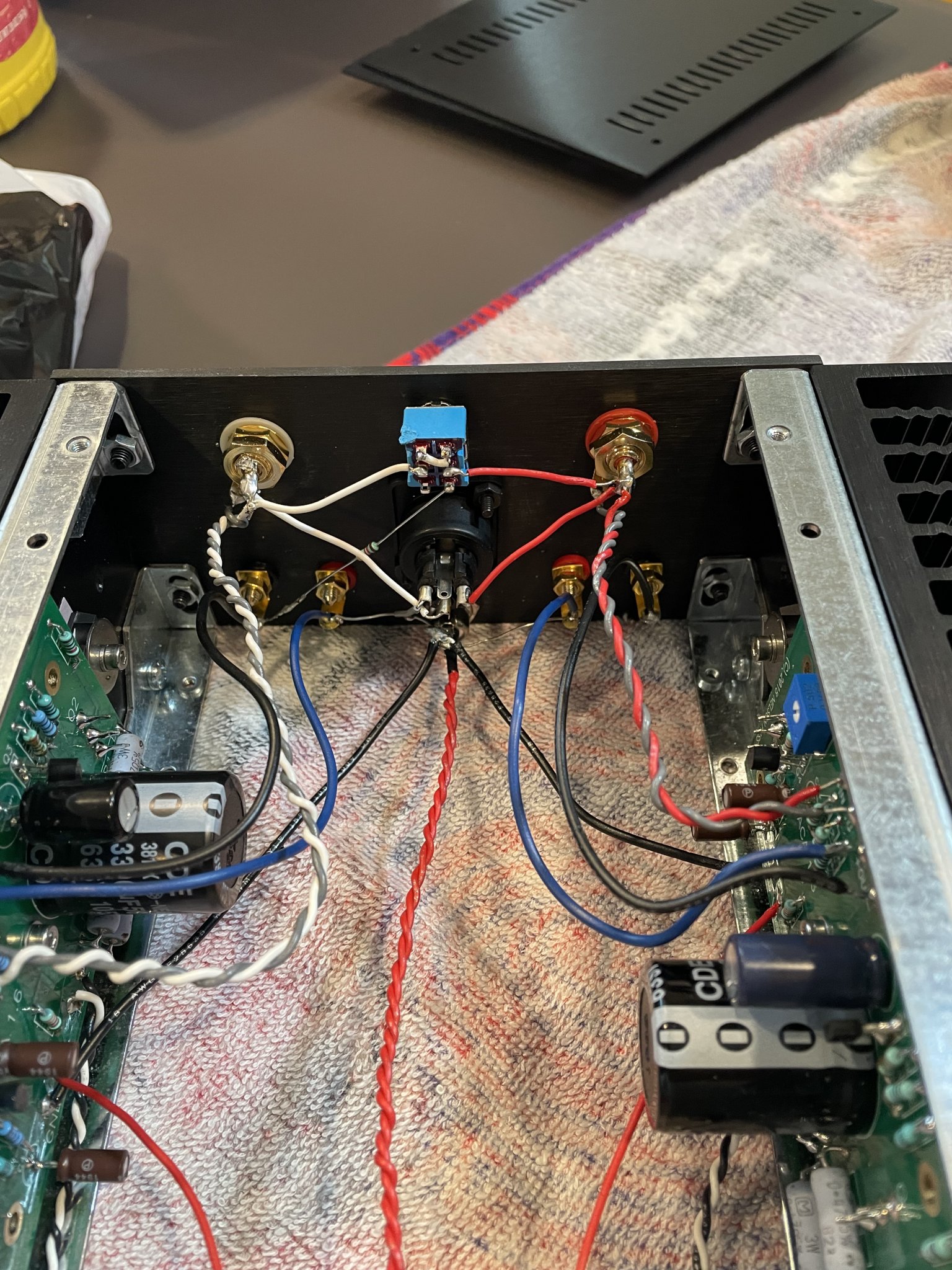

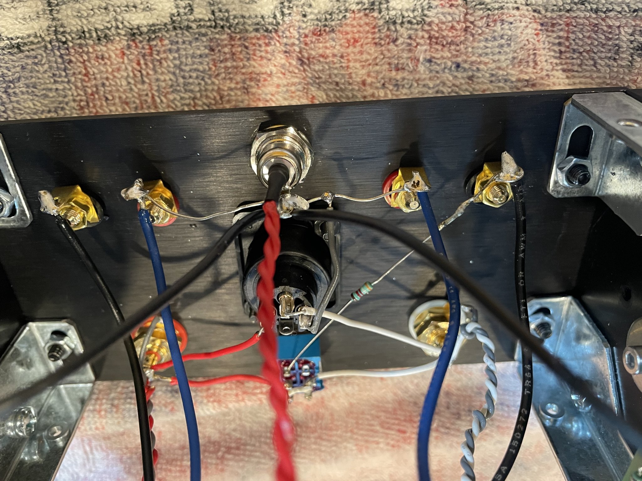

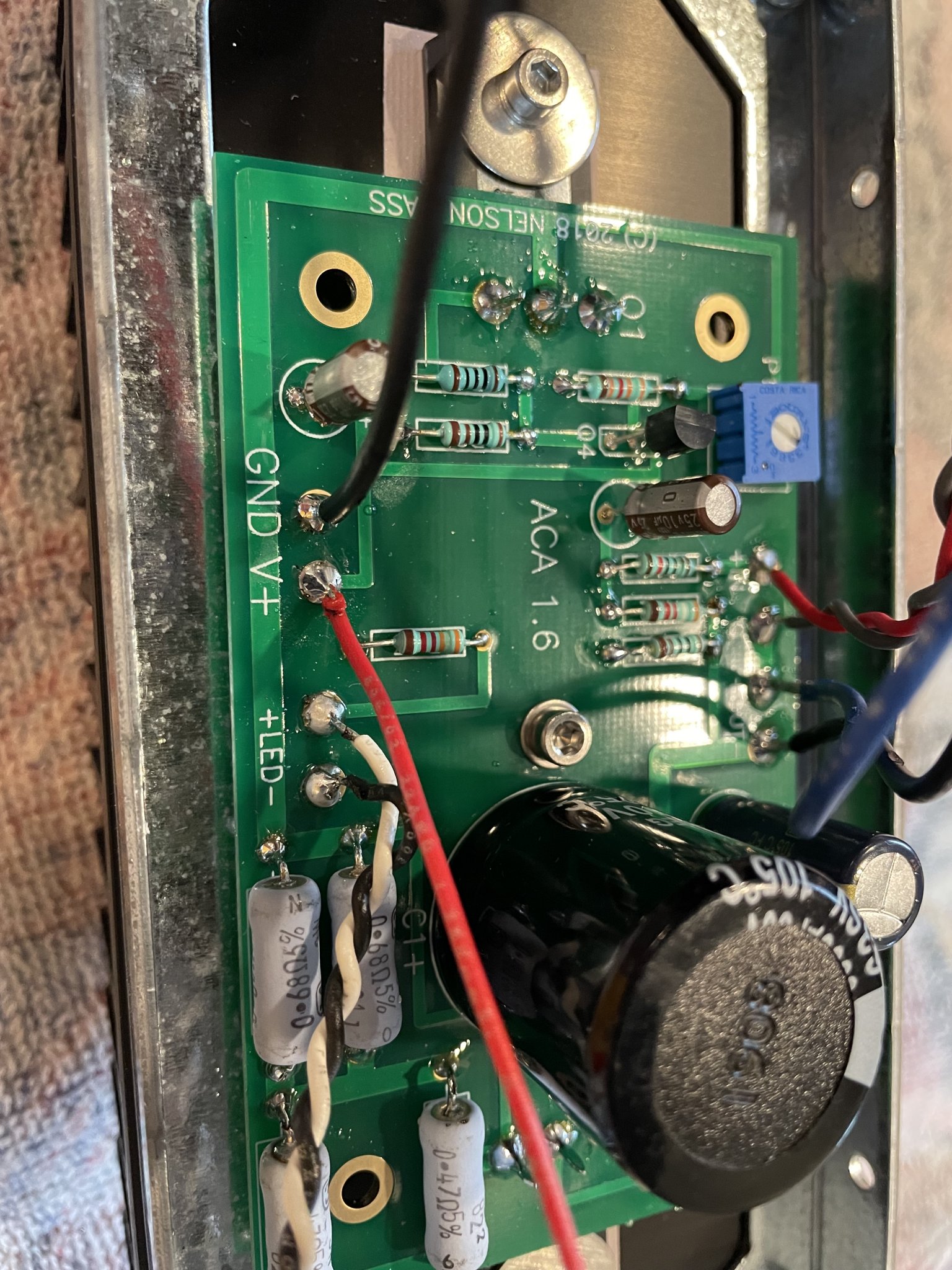

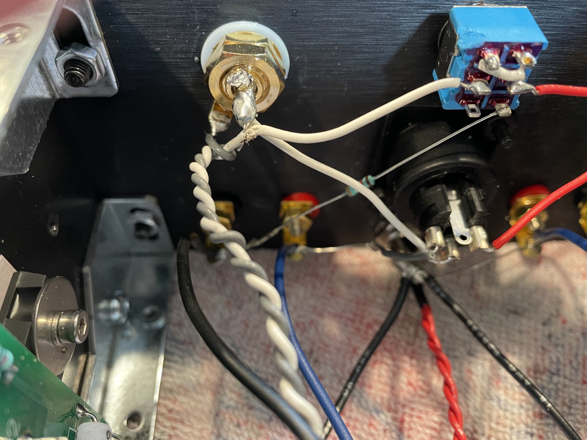

I need some help. I built two ACA's with the intention of using them as monoblocks. Neither is working. The first one registers when I try to set the potentiometer on one channel and the other is only reading 7.x Volts at max. I went back and resoldered the boards adding more solder to areas that looked like they may need a better connection. I traced all the wiring, and it looks correct. As this is my first project like this, I am unsure how to proceed. The lights do iluminate on both units, but i cannot get sound out of either.
I am hoping I did something obvious. Can someone please guide me how to troubleshoot.
Pics attached.
Pics attached.

watch youtube videos
with probes connected as ampermeter, you're making shorts in amp, with probes ....... irrelevant which function is chosen on multiimeter
yes, but it's still unclear what you are measuring
first thing, confirm that you're getting proper PSU voltage to each pcb
I am unclear what you are asking. I am measuring Volts at q1 center pin. Red on center pin black on ground
black probe to GND
red probe to V+ on each board
that to confirm that you have proper voltage coming to pcbs
then attach here your referent schm so we can proceed methodically
