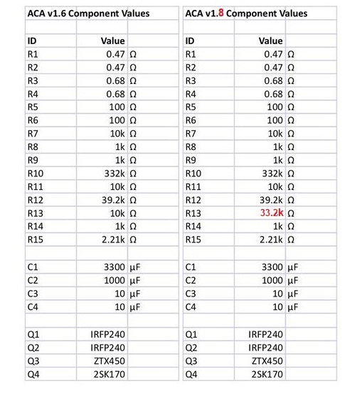

Lars,Hi,
I was checking the resistors and I have two left which are not on the list. 33,20k Ohm.
They have not a color stripe on the tape either.
What to do with them.
they are alternatives for the 10kΩ R13. They reduce the light level of the very bright blue LEDs.

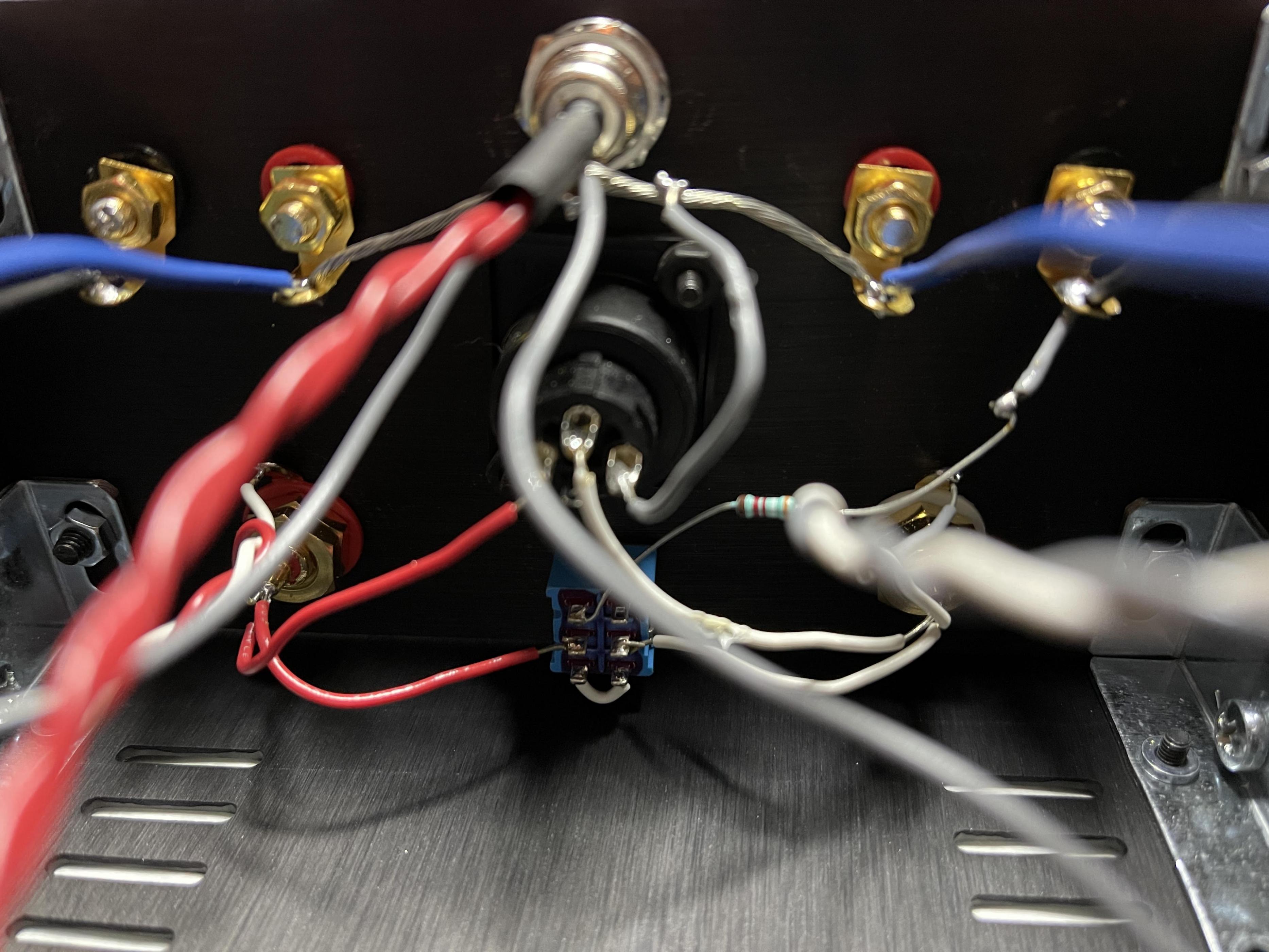

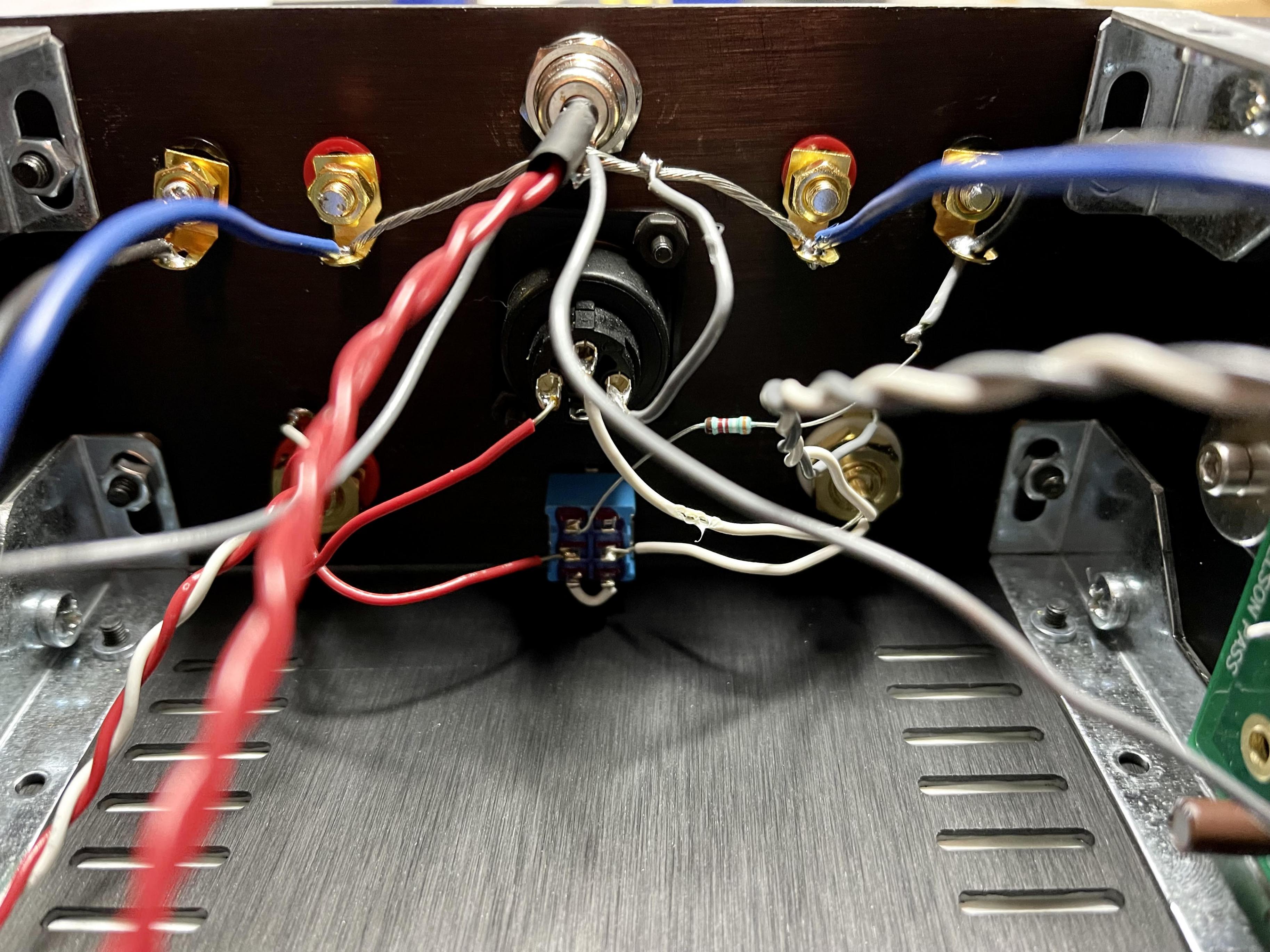

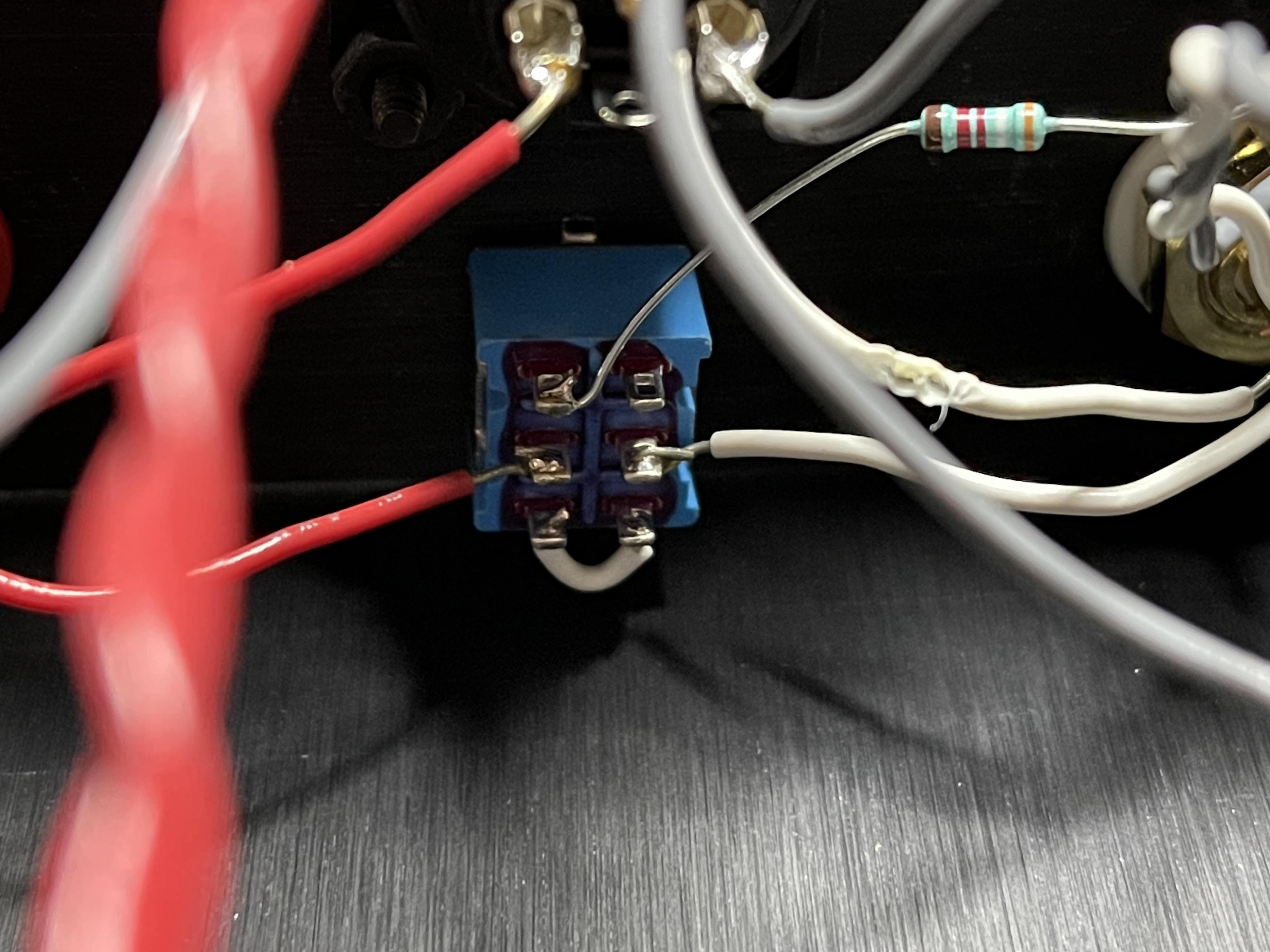

Mono RCA Bridged connections reversed
I don’t know if I did something wrong, but my Mono RCA Bridged connections only work correctly (no hum, music plays) when I’m connecting my RCA in to Input B, not Input A on the back panel. And this is with the center switch in the UP position for Bridged. Any ideas why that might be? I should also point out that I've got the speaker cable red plugged into Output A (black) and speaker cable black into Output B (black). Is it ok for me to be backwards? I kinda live that way anyway...... 🙄 See attached photos of my back panel wiring.
Your wiring looks fine compared to the build guide.
I would post your question in the Amp Camp - ACA thread as you'll get more traffic: Amp Camp Amp - ACA
As Kevin says, the back panel wiring appears correct.
Would you please post some shots of the PCBs? Thanks!
Re: Speaker wiring, it doesnt matter if you have the speakers cables hooked up ‘backwards’, just be consistent with both amps.

I bought and built a ACA 1.6 in early '20. This winter I bought a 1.8 back plate upgrading it to 1.8, and bought a 1.8 ACA to complement my 1st, bi-amp and play with the modes. I used the blue LED's on the 1st and will with the new one.
I understand changing the resistor value to dim the LED's in the kit, but I want to match the brightness of my 1st amp.
Are the blue LED's in the 1.8 kit different and in fact brighter than the ones in my earlier 1.6 kit? If not I'll use 10k resistors, instead of the 33.2k resistors supplied.

just increase series resistor until point where you're happy
rule of thumb - 1K of resistance to each volt where LED is connected
so, with 24Vdc rail, start with 22K to 24K
regular 0207 MF resistor is OK, power wise
Yes, the newer LED are probably brighter… LED technology and fabrication is in constant flux and improvement, and more brightness for a given current is something all the manufacturers are going to regard as beneficial for all users.
So as Zen Mod says, you are going to need experiment a little and adjust the resistor to taste. More ohms = dimmer.
