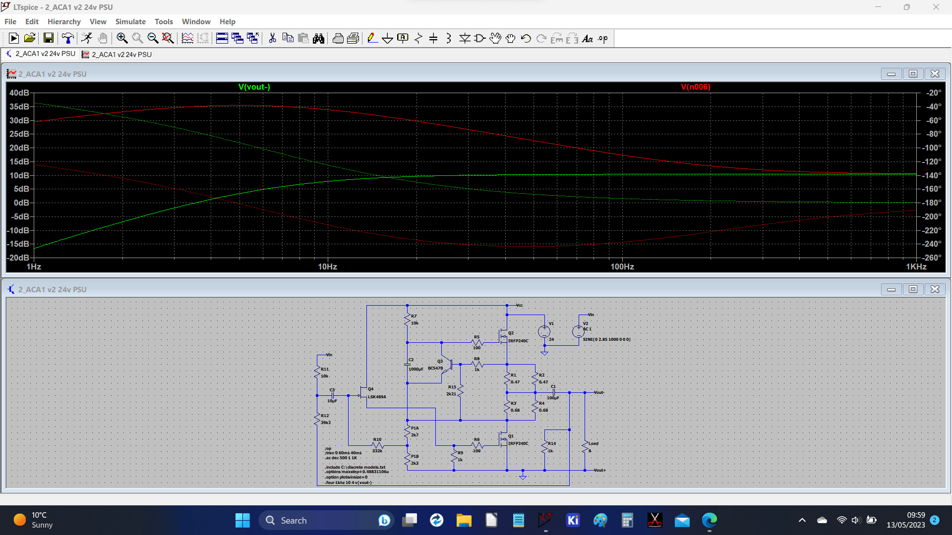

To expand on that, the ACA will try and maintain output despite the lower value coupling cap. In practice this means that the output level before the cap increase as frequency falls, the result is that the amp clips way before it should at lower frequency.
This shows the output into 8 ohms with a 100uF cap before and after the cap. The solid green trace shows that output is maintained down to 10 Hz but look how much more output is needed (solid red trace) to achieve that. The result is clipping as frequency falls.
