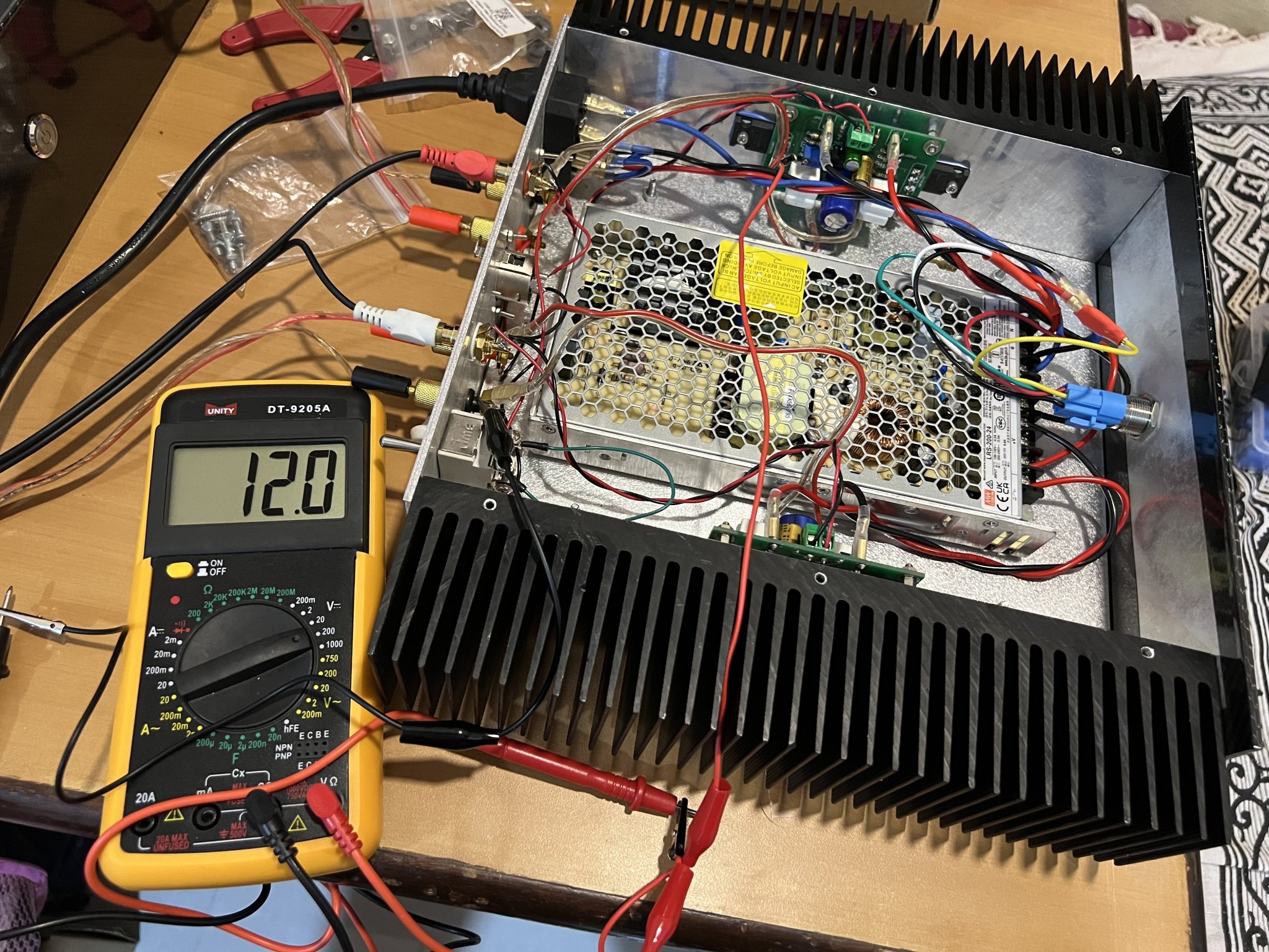

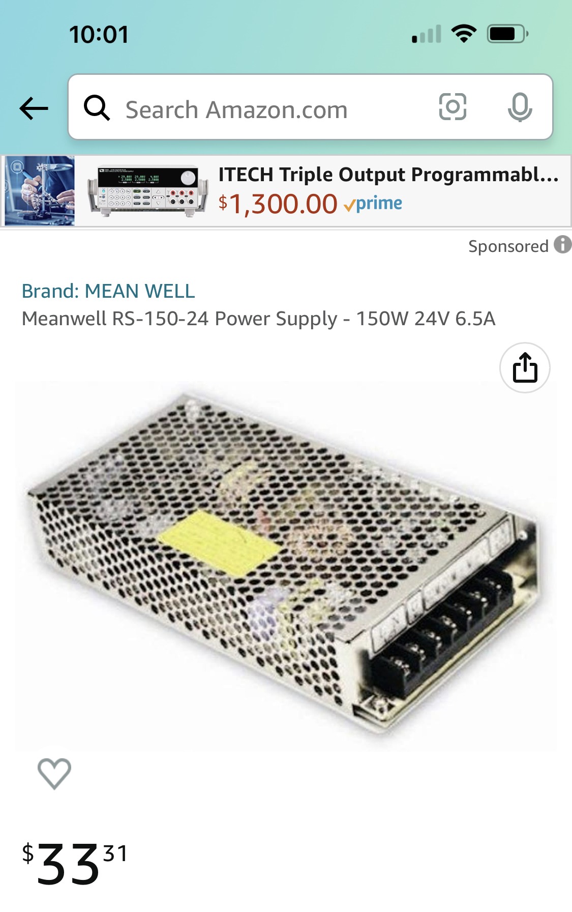

That particular chassis mount SMPS wouldn't necessarily be an upgrade over the ACA kit brick style on its own. What you do with the rest of your build could be an upgrade. The bricks were well chosen for this task.
Those chassis mount SMPS can take some external capacitance on their output. You could try a simple CRC or CLC filter. There is a potential to improve power delivery. A lot has been written on this topic in the DIY VFET amp, part 2. You might hear a startup noise due to the supply hiccup feature for starting into larger capacitance. Whether there is an overall improvement with this configuration is up to you.

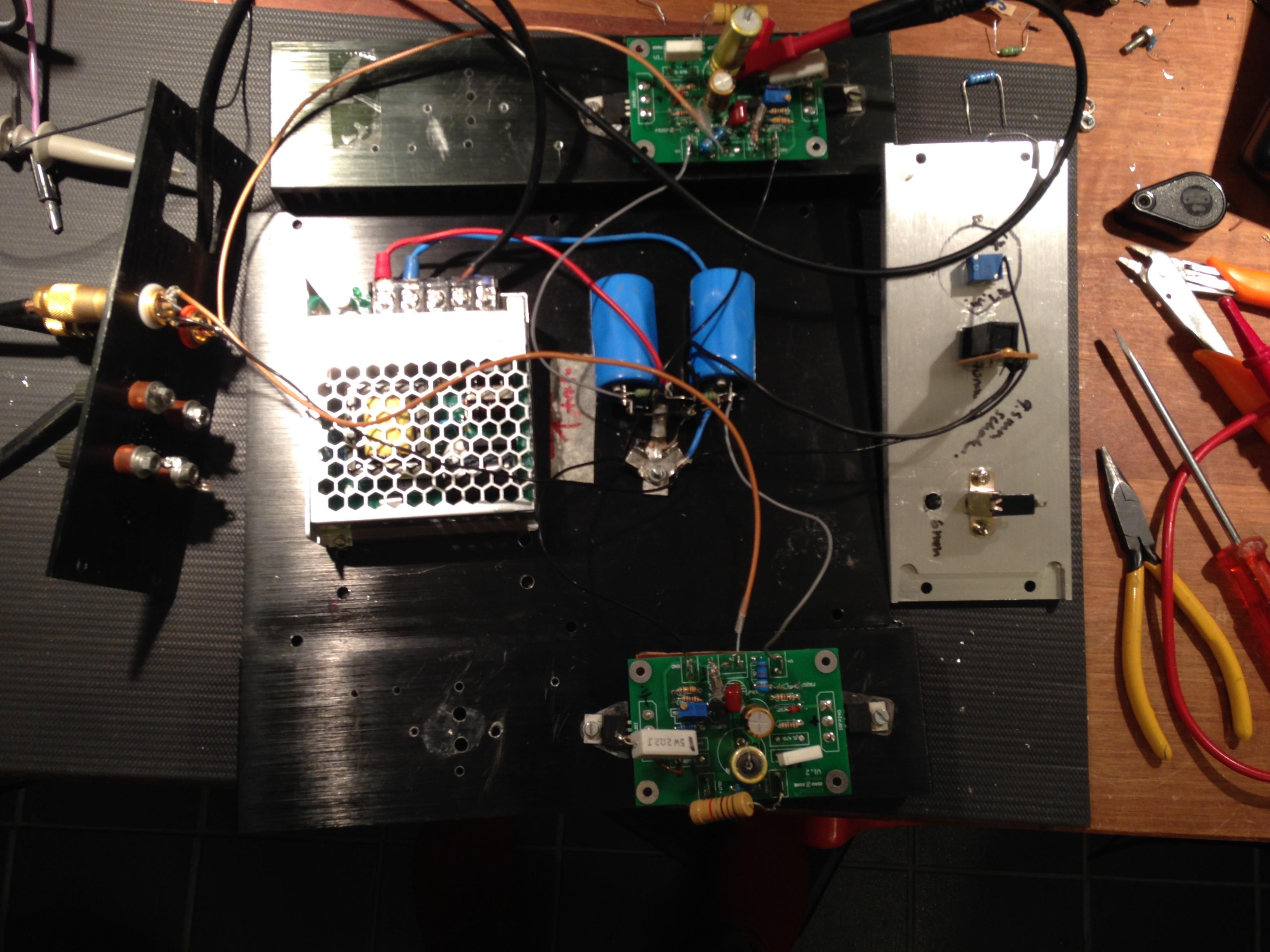

I tried using one of the 27V Meanwell chassis mount supplies in one of my Hafler chassis ACAs. The ACA boards I'm using have CRC filters to the tune of 10,000 uF > 0.1 Ohm > 10,000 uF. The SMPS seemed to perform fairly well, but I prefer the sound of the linear supply that have built for these amps. The linear supply performs best at lower frequency extension and definition.
