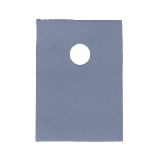

I am an evangelist for using Kapton tape and heatsink compound instead of any other stuff ...also using an alu bar/channel (with a coating of heatsink compound) to press down the device to the heatsink always obtains better heat transfer, IMO.the ones which come with transistors,

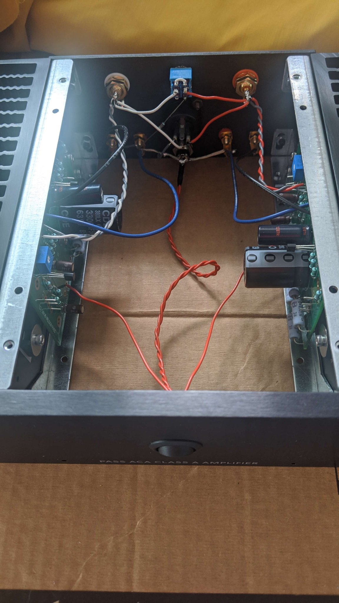

i am working on wiring the back panel, but where do i get this braided wire on step 8 of 1.8 wiring:
https://d3t0tbmlie281e.cloudfront.net/igi/diyaudio/NgFuaPk12ljlAbKN.huge
i didnt see this in my wiring packet, am i supposed to strip a bunch of the colored wires to make this?
edit:sorry i found it, needed to strip the black wire

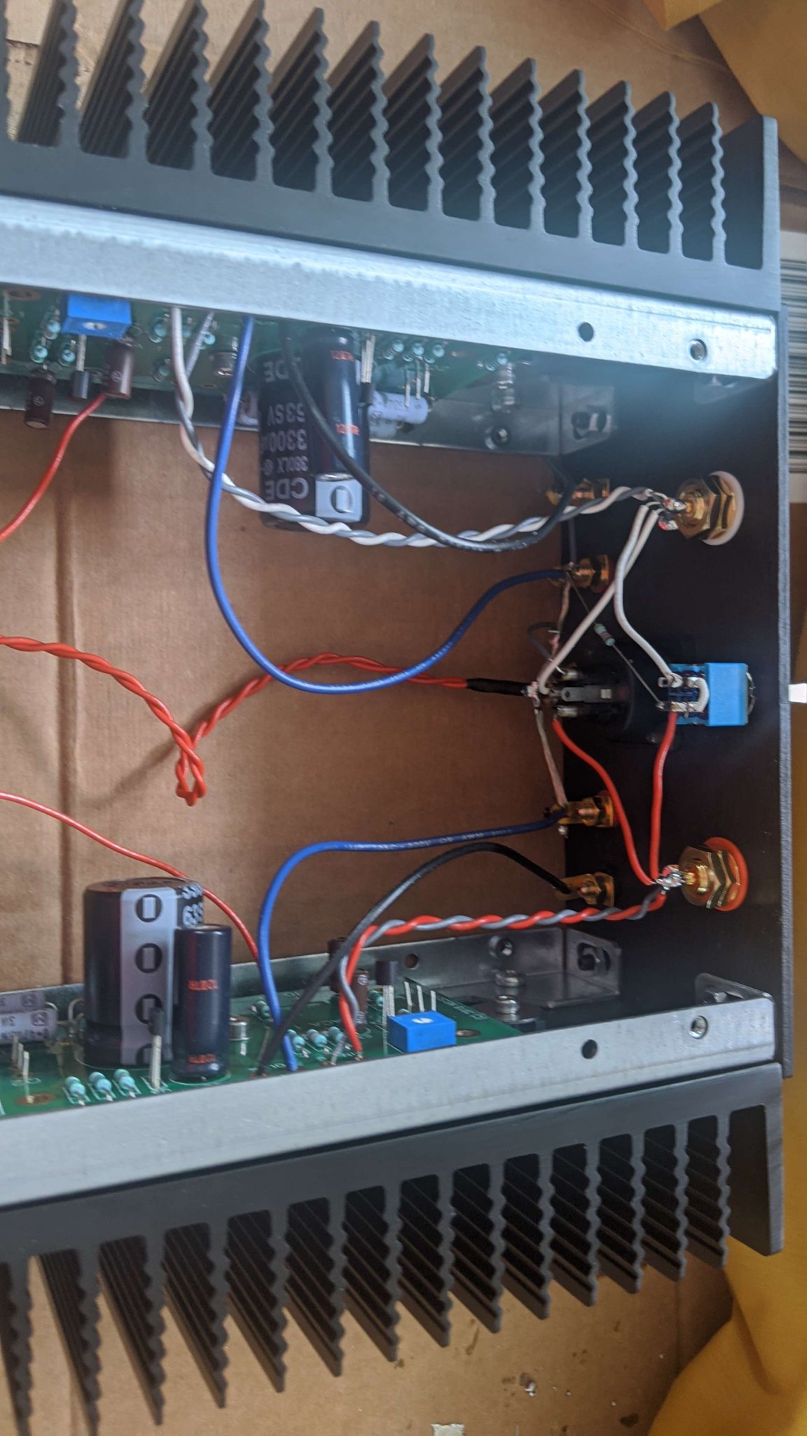

i finished my build for ACA 1.8 today. I was so surprised that it worked right away. I would of assumed there would be a goof some where and i needed to use that troubleshooting guide and get some troubleshooting experience.
so surprised to see how hot the chassis gets(i measured 108-114F) in the heatsink fins
my remaining problems is getting used to the sound levels and the missing sub woofer and not having working RCA cables after getting it connected to my PC. i found some old RCA cables and they are all scratchy and cut out and they need to be reseated or adjusted to get back to working order. I ordered a new RCA cable from Amazon but forgot to buy a 2nd one. ill make due with 1 new and 1 old RCA cable until the new one arrives.
the build guide was very helpful with all the pictures, but there are multiple moments where reading ahead is very much needed and a bit of planning. there were some moments where a novice like me (or someone dumb like me lol) didnt even know where the braided wire would be as ingesting all the instructions was not done(i thought i read as much as i could before the build 🙁 ). I have left over screws and washers and some of the hardware no longer matched the build guides. I made it to the end and i have a amplifier!

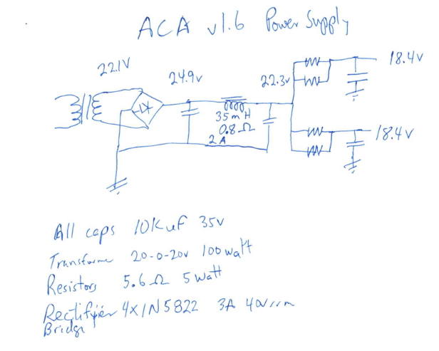

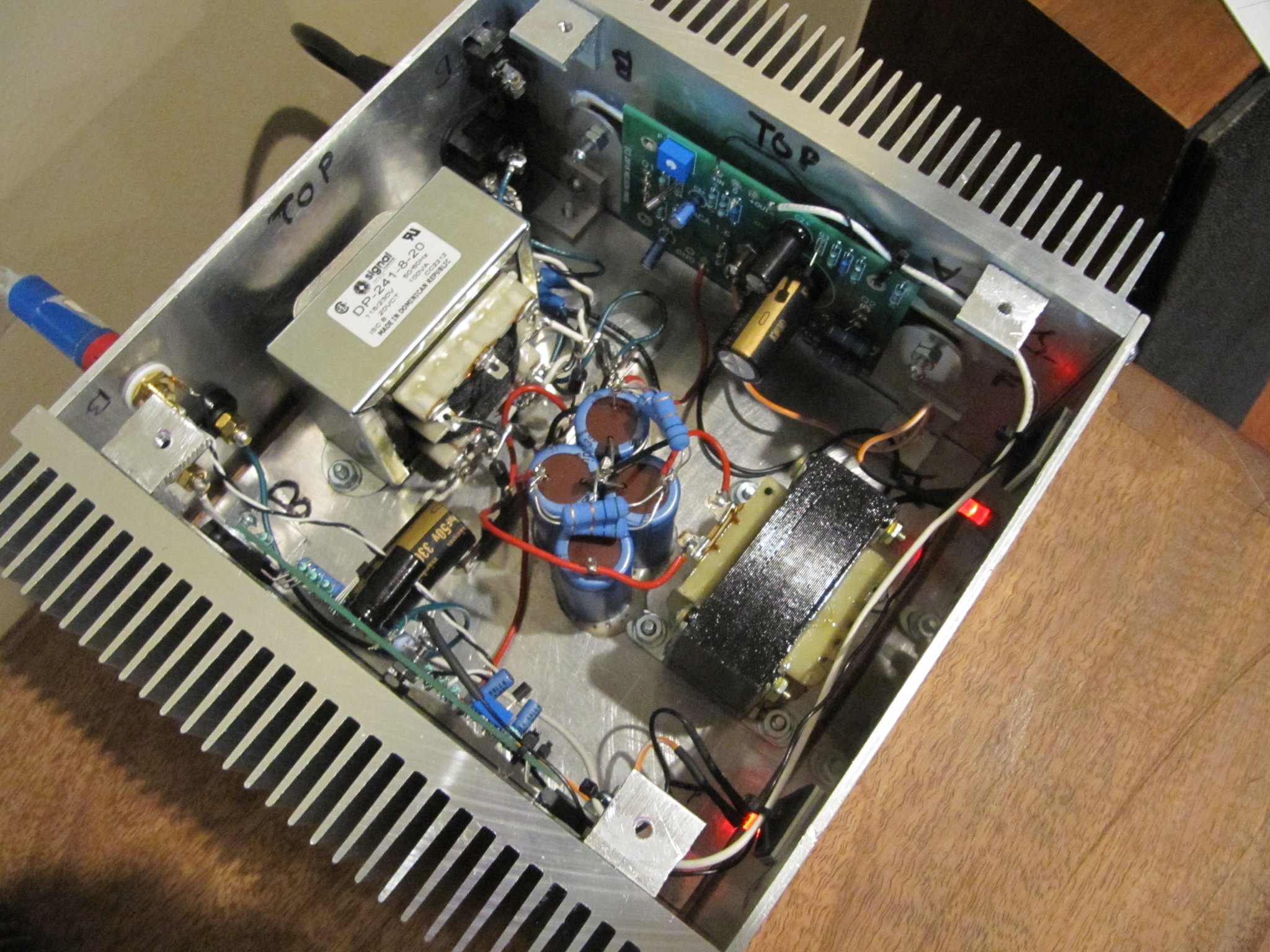

I have a power supply question.
First a bit of background. I've built 5 of these so far. (I can't help buying in bulk, so my last batch I bought enough for 2 stereo amps and 2 bridged mono blocks.) My son and daughter are both enjoying ACA stereo amps. My post is about 2 bridged monoblocks I just built. I have one in the parts bin, and the UPS driver (I assume) is enjoying the first stereo amp I shipped to my daughter.
I've used Meanwell power supplies, but thought I'd give a linear ps a try for the bridged mono blocks. It is a pi filter with a choke - CLCRC. (See attached.) I expected the design to give me just under 24v. But I am getting 18.4v. (I set the drains to 10v.)
I was under the impression that each channel (board) draws 1A, but from what my PS is telling me it is more like 1.5A.
I think my rectifier bridge diodes are underspec'd (IN5822 3A 40vrrm) and my dc volts after the bridge rectifier is way under my expectation.
Also, I figure the 2A rated choke is saturated.
But even with all this, the ps seems to be supplying nice clean dc. Amps are dead quiet. I think the CLC is promising.
And yes, the sound is pretty amazing.
So, any consensus on the 1.5A draw per board? Is this expected?
And my bridge rectifier getting 22VAC and outputting 24.9vdc means my rectifier diodes are under spec'd, right. I was expecting 28vdc with 20VAC secondaries (but with the 100 watt transformer the secondaries are at 22.1VAC.

1.5A sounds right where it should be tbh. When the voltage across R15 reaches around 0.6 volts then Q3 comes into conduction holding the current constant. So you can work out the volt drop needed across the 0.47 and .68 ohm resistors to get that value and around 1.5A (or a little more) is spot on.
I snipped the power to one board to see what happens with just one channel powered.
The voltages changed as follows (before/after):
Transformer secondaries - 22.1VAC/22.2VAC
After bridge rectifier - 24.9v/26.5v. I expected 30.4v with that secondary voltage.
After choke @1.0ohm - 22.3v/25.1v
B+, last resistor 2.9ohm - 18.4v/21v
So the voltage drop across the choke and resistor calculate to 1.4A. The drains are set at 10v, so maybe 1.4A is in the ballpark.
Why would the rectifier bridge not put out 30.4v ((22.2VAC x 1.4) - 0.6)? What am I missing?
I think I will move this over to the power supply forum. Thanks.
