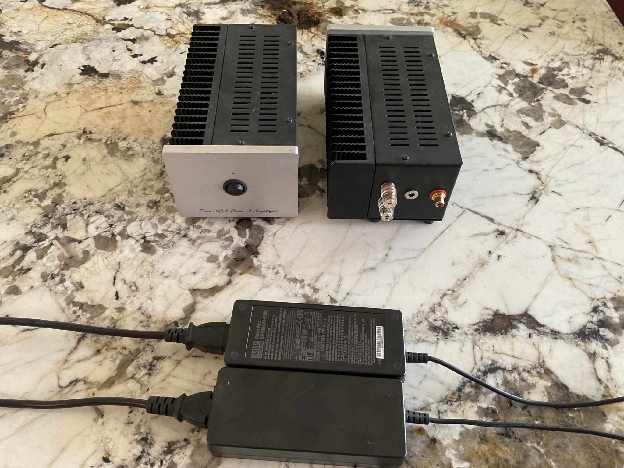

I decíded to upgrade my original First Edition monoblock ACA’s back panel connectors. After all these years the RCA’s were looking a bit corroded, and we’ve also upgraded the PSU connector and the speaker posts. It’s feels great to get them looking more current. I had already added the resistor required to upgrade the 1.0 PCB a few years ago, and now I figured I’d adjust them for a new Meanwell 24v supply, since the 19v supplies weren’t the quality of the current Meanwells.
Because they are monoblocks, I figured I’d stick with one PSU per channel, which meant they could be a bit smaller. I got 2 of the Meanwell GST90A24-P1M that can output 3.75A ea. Which is more than plenty, and it wasn’t much more expensive for a pair.
So that’s another great thing about the ACA’s -they can be upgraded to the current spec, and since you built them the upgrade is easy!

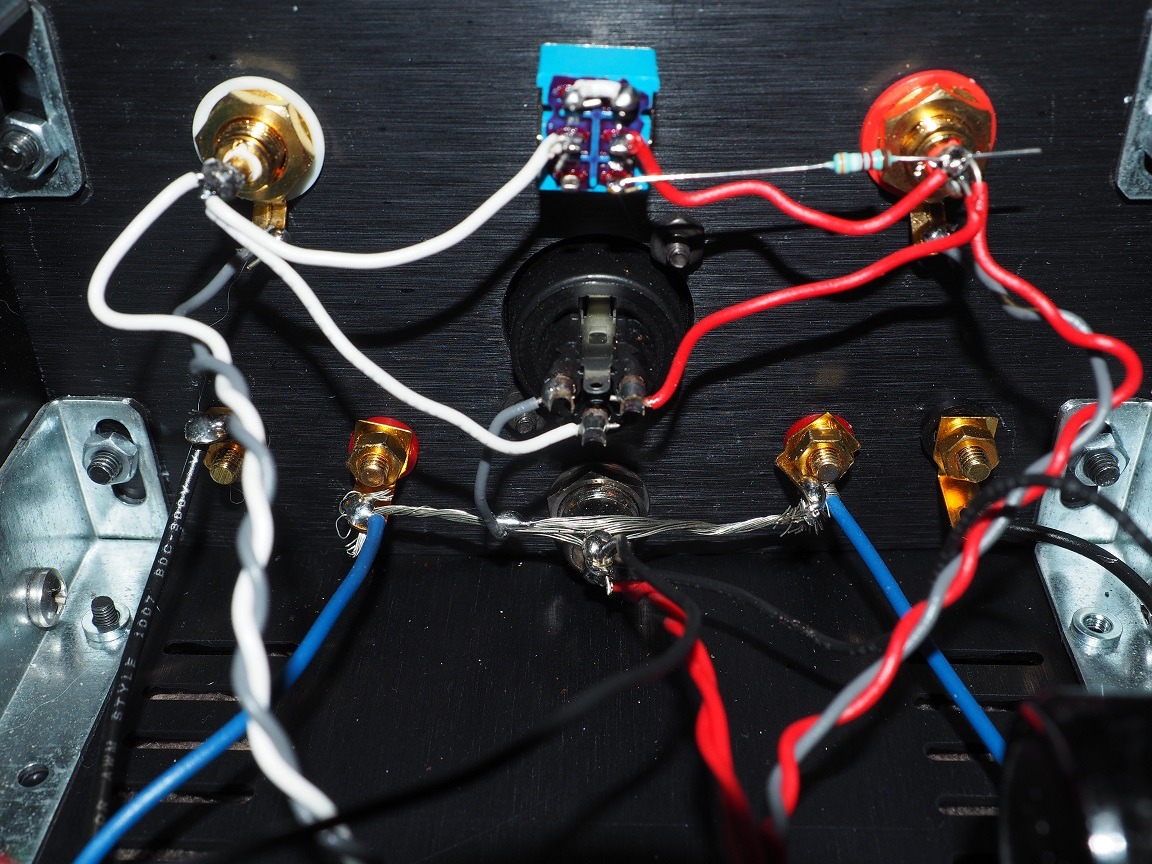

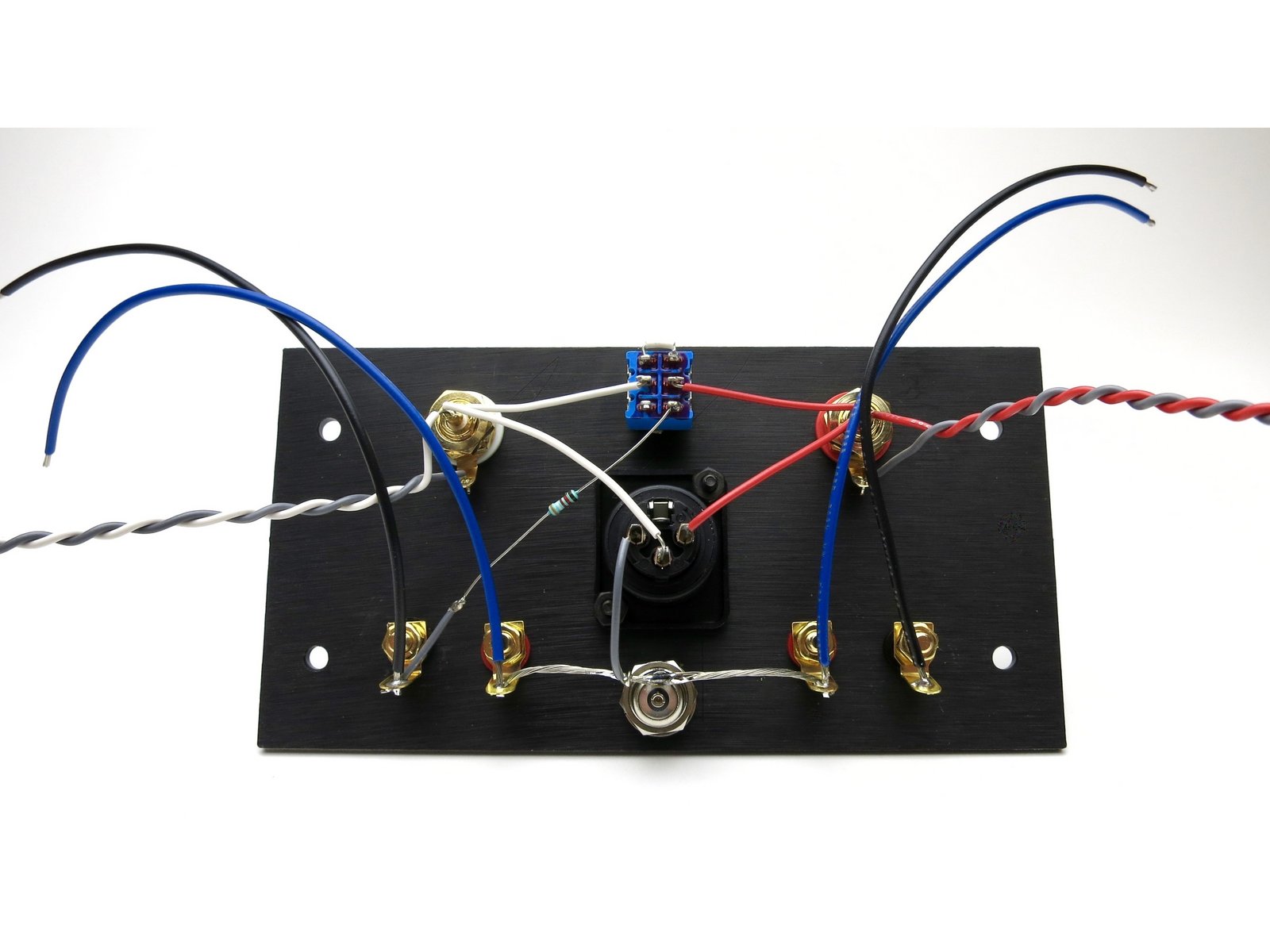

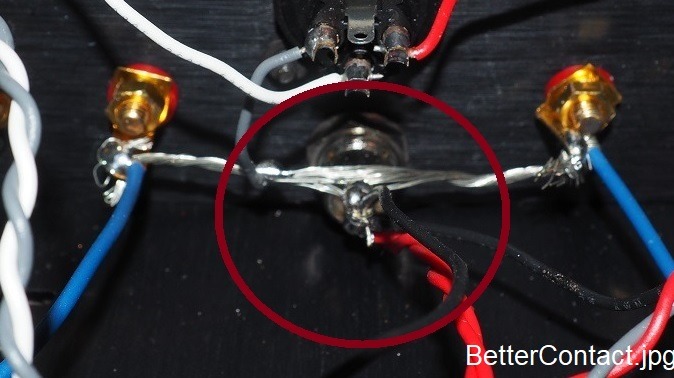

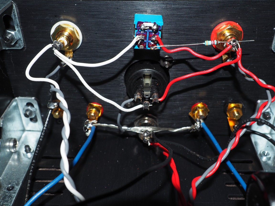

My friend gifted me his ACA because he could never get it working. I've since gotten both boards operational, but the wiring on the back panel is having me scratch my head a bit. There are so many revisions to this kit I am not sure what I am supposed to be looking at. I am unsure what version board I have, it says "Nelson Pass 2018) on the boards. Here's some pics of back panel wiring:
Originally the resistor off of the bridged-stereo switch was soldered to one of the negative speaker terminals. I have since moved it to the Red RCA input per the current directions, but now I am not so sure this is correct as I've seen a couple older kits wired the same way that my friend wired it. Also why are the top contacts on the switch bridged? Why is the bridged-stereo switch wired to RCA inputs when current revision is not? Does everything look safe to you guys? There's just so much going on with the wiring in this design I can't wrap my head around it all with my limited DIY knowledge.
Any insights would be greatly appreciated. Thanks for looking guys.
Sorry guys. I checked all the build tutorials and this must obviously be version 1.8, in which case he wired it correctly. I have swapped the resistor back to original orientation. Sorry for troll. Everything seems fine.

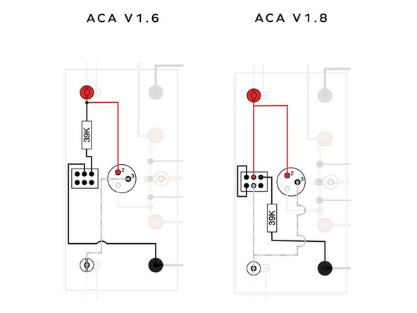

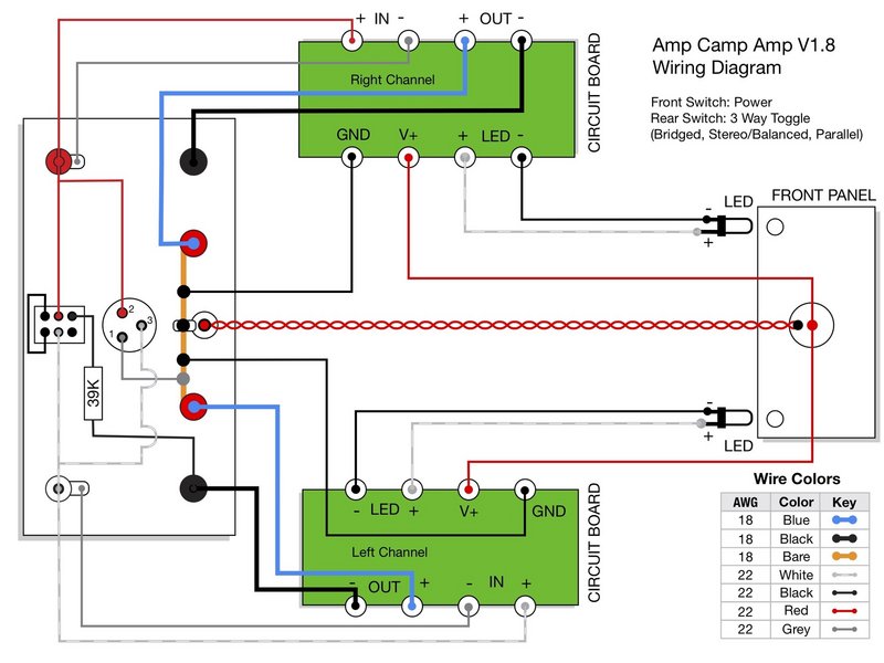

Is the switch 3-position? Does it have a click at up, middle, and down?
If yes, it’s a 1.8 and it’s currently wired incorrectly in your photos above.
Proper wiring here:
From 1.8 change guide - https://guides.diyaudio.com/Guide/Amp+Camp+Amp+V1.8+Change+Information/10?lang=en
Proper wiring here:
Yes, it is 3-position switch. I have since realized my error and changed it back to the original wiring. I'm fairly sure it is correct now. Thank you for the heads up.
