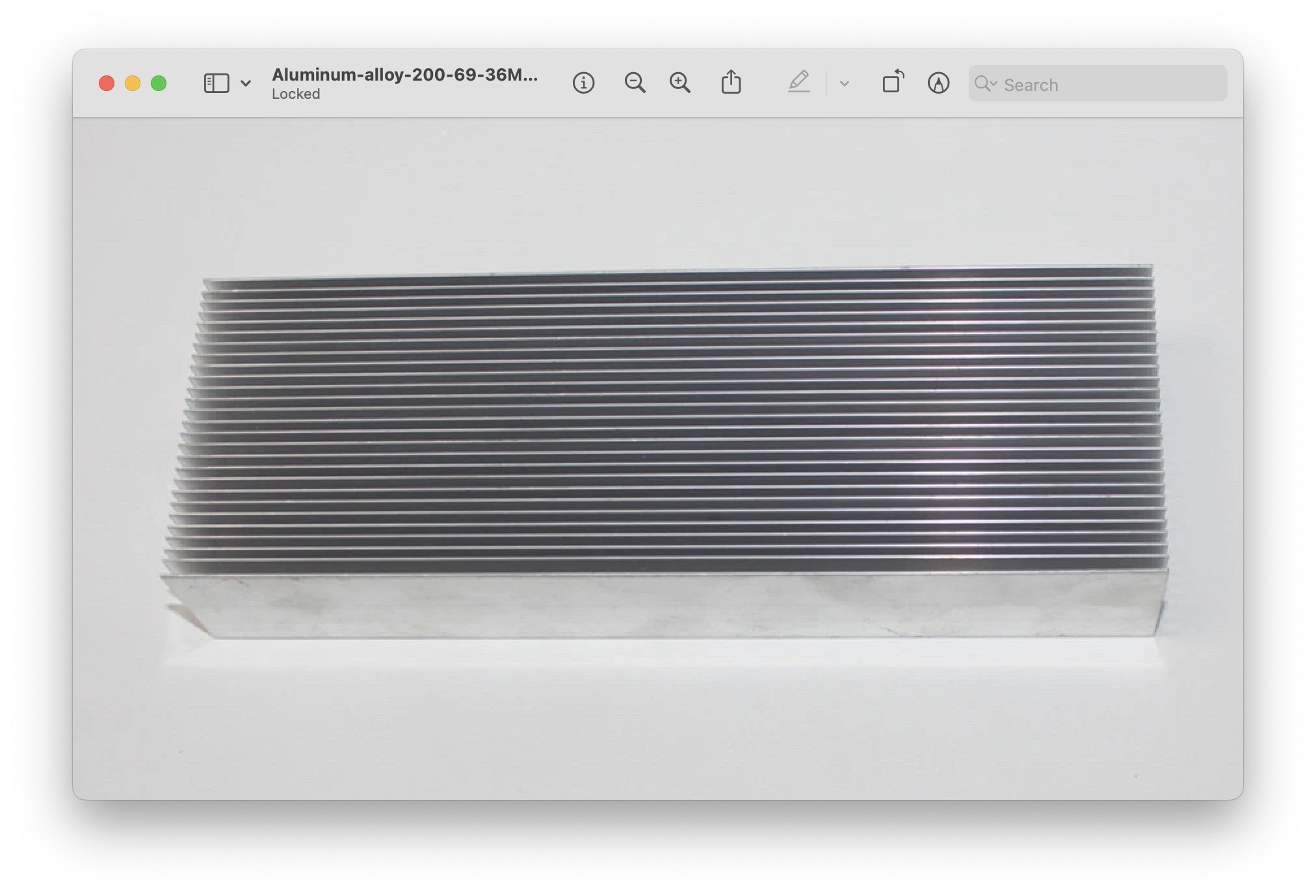

Looking at the fins, the spacing of fins is about 69mm/26 = 2.65mm. Clear space between fins is less. For reasonably effective natural convection cooling, the minimum clear space between fins needs to be about 6 or 7mm. Less than that and the air stagnates between the fins, not moving well to transfer heat away from the heat sink.
With closely spaced fins, forced air is needed.
