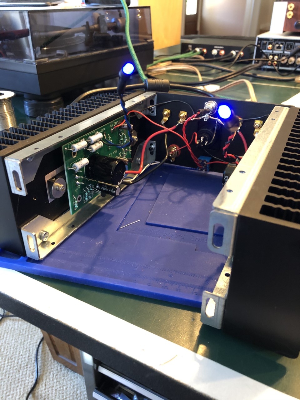

Ok, back again with the humming.
I have found the source but not the solution.
If I power up with no source connected the humm is much lower but as soon as I connect a source the humm is back.
I don't own a preamp yet (got parts and board for a BOZ and jFet BOZ) so I am limited to Chromecast audio and misc phones/tablets but battery or line powered doesn't matter.
I tried a starground with some alligator clips but that didn't do anything.
I then tried to elevate the signal ground by adding a 10R resistor (in series) between the RCA ground lug and the signal ground connector on the board but that didn't help either.

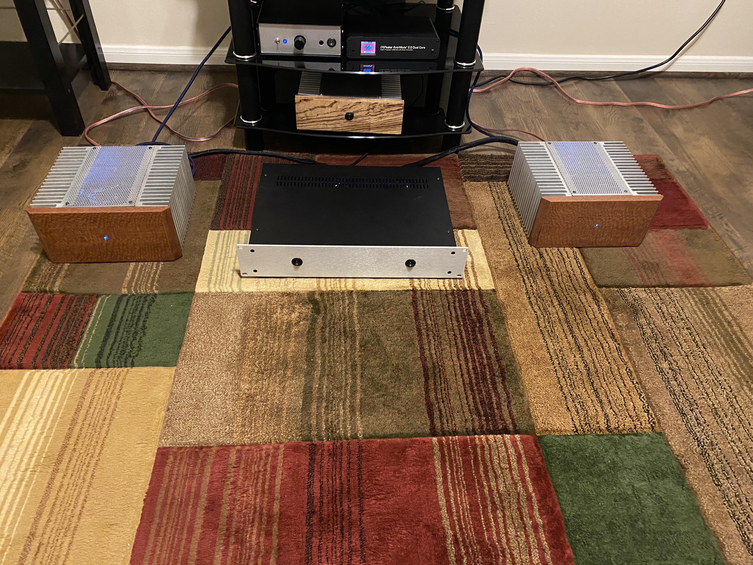

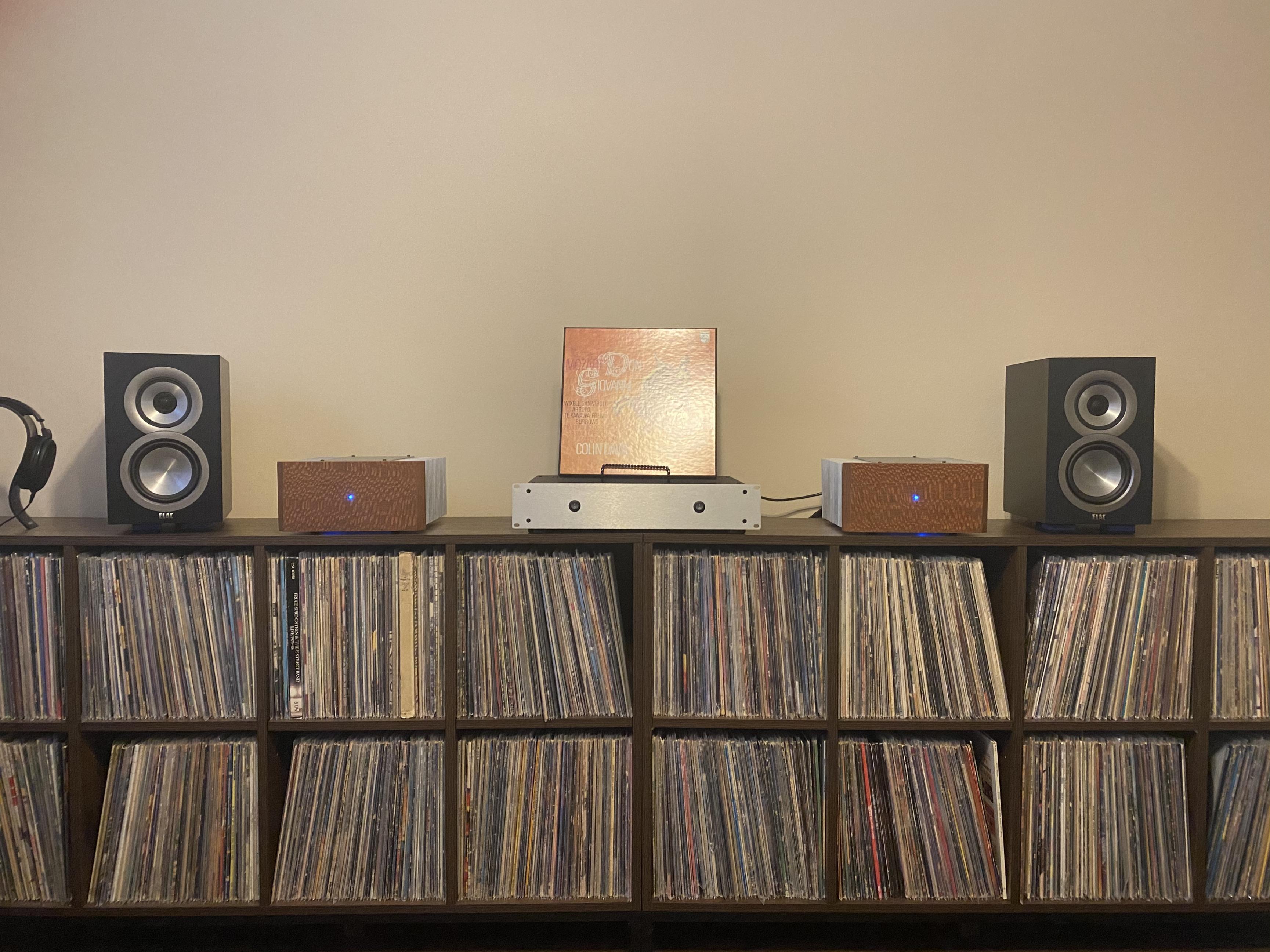

...just finished the ACA 1.6 with back panel power button...first power up everything worked perfect. This is the only electronic build, except the AC Preamp build, that I haven't had to troubleshoot in some way.
I'm driving it with the B1 Korg that was finished about a month ago and it's powering BOFU bookshelf speakers built years ago...very very nice and thanks out to Nelson and Jim for the guidance.
...still have two more 1.8's that will be used a monoblocks...

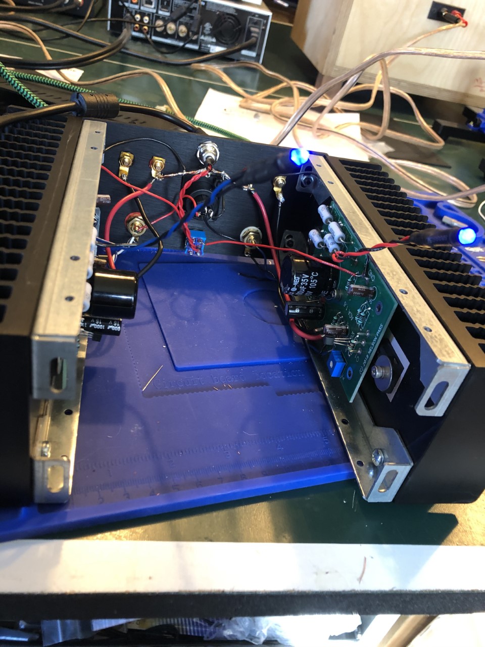

Ok. I tried the changes but it still blows the 2.5A before each transformer.
When I was testing on the bench I did NOT have the added 2.5A Fuses in front of each transformer which probably explains why each amp worked fine then.
Any harm in increasing the rear single fuse to 4A and increasing each fuse in front of each transformer to 2.75A or even 3A?
I’m quite embarrassed but I fixed my problem. A couple of the keratherm pads I used had been penetrated by the screw holes of my chassis (don’t think dirty, haha). The Irfp9140 on one of the boards was for sure sending voltage into the chassis and I caught it. I sanded the screw holes and swapped out all the keratherm with mica and thermal paste and everything is working perfectly.
