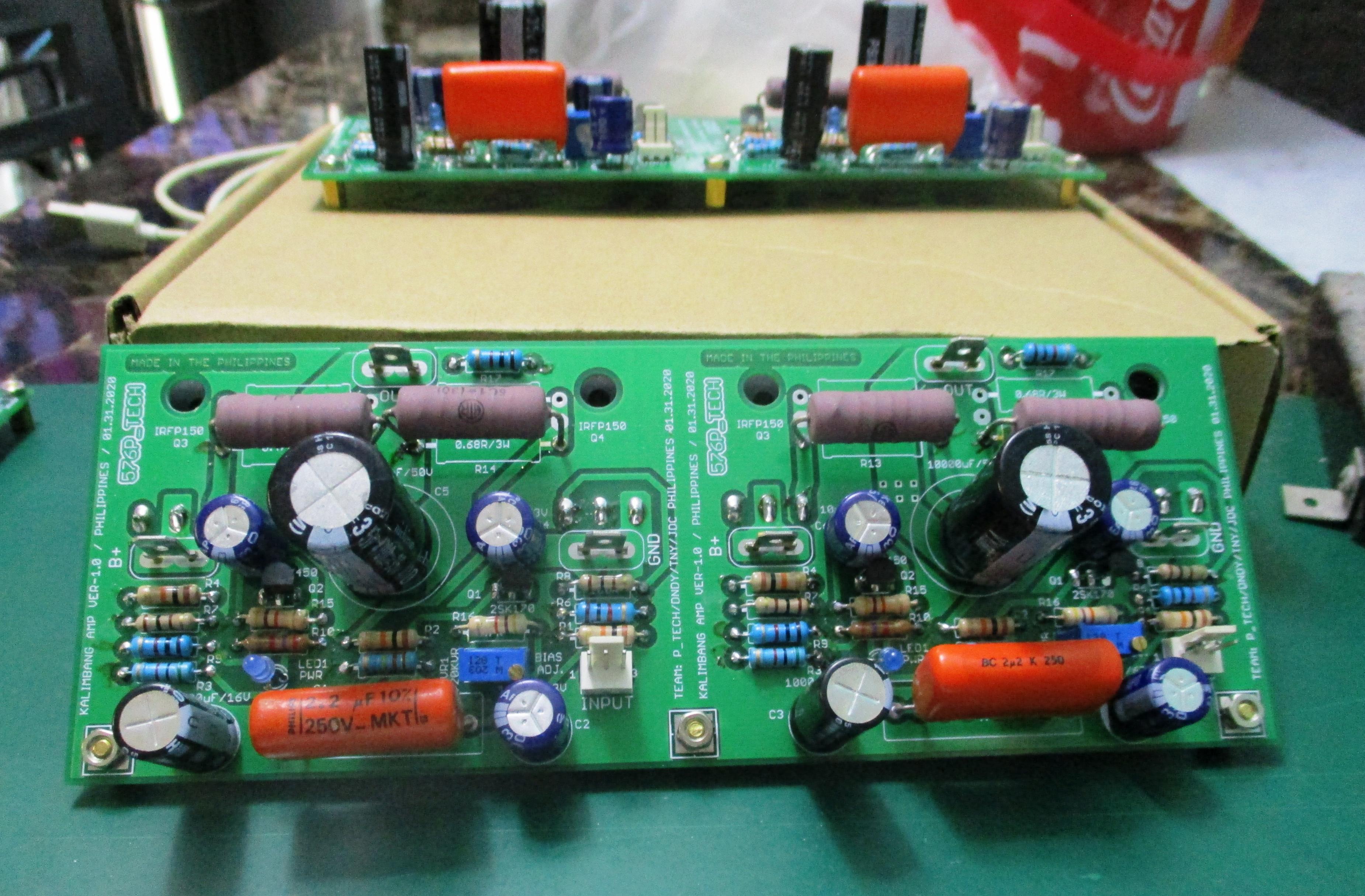

I have ero 4.7uf 40v mkt1826 capacitors so i can use 2 of them in the input by soldering one on and other under pcb and can use instead of 10uF input caps. I do not remember where i saw it that someone said only polar caps should be used on some circuits

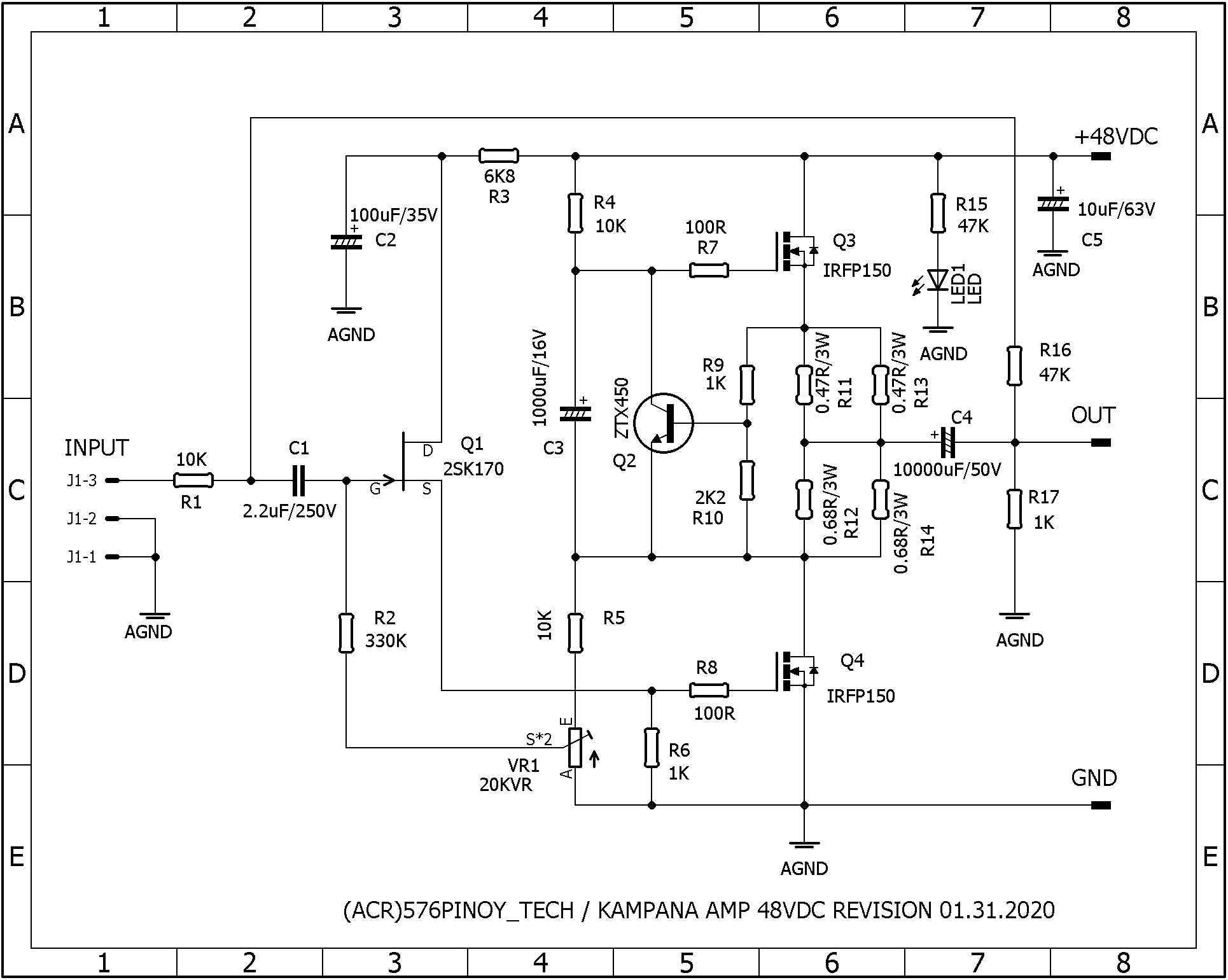

Wow 48v Aca ! Schematic same ? Thanks
basically the same, but addressed the 40v limitation of the 2sk170...
i have a previous build running on 24vdc and will move to 36vdc supplies, i will just replace the jefts to 2sk117.....

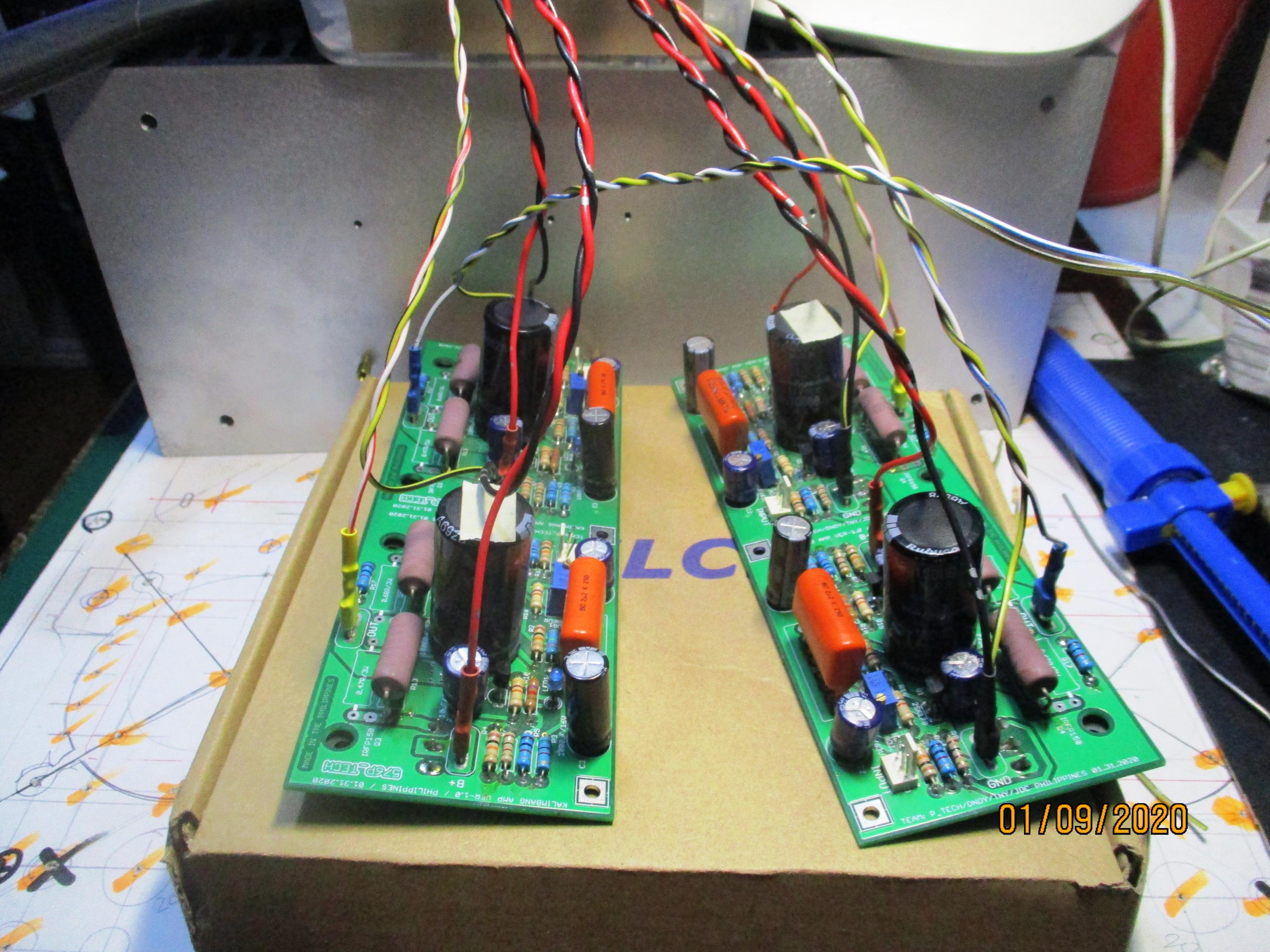

I have 2sk209gr in stock so i can parallel and build them with 48v 🙂
