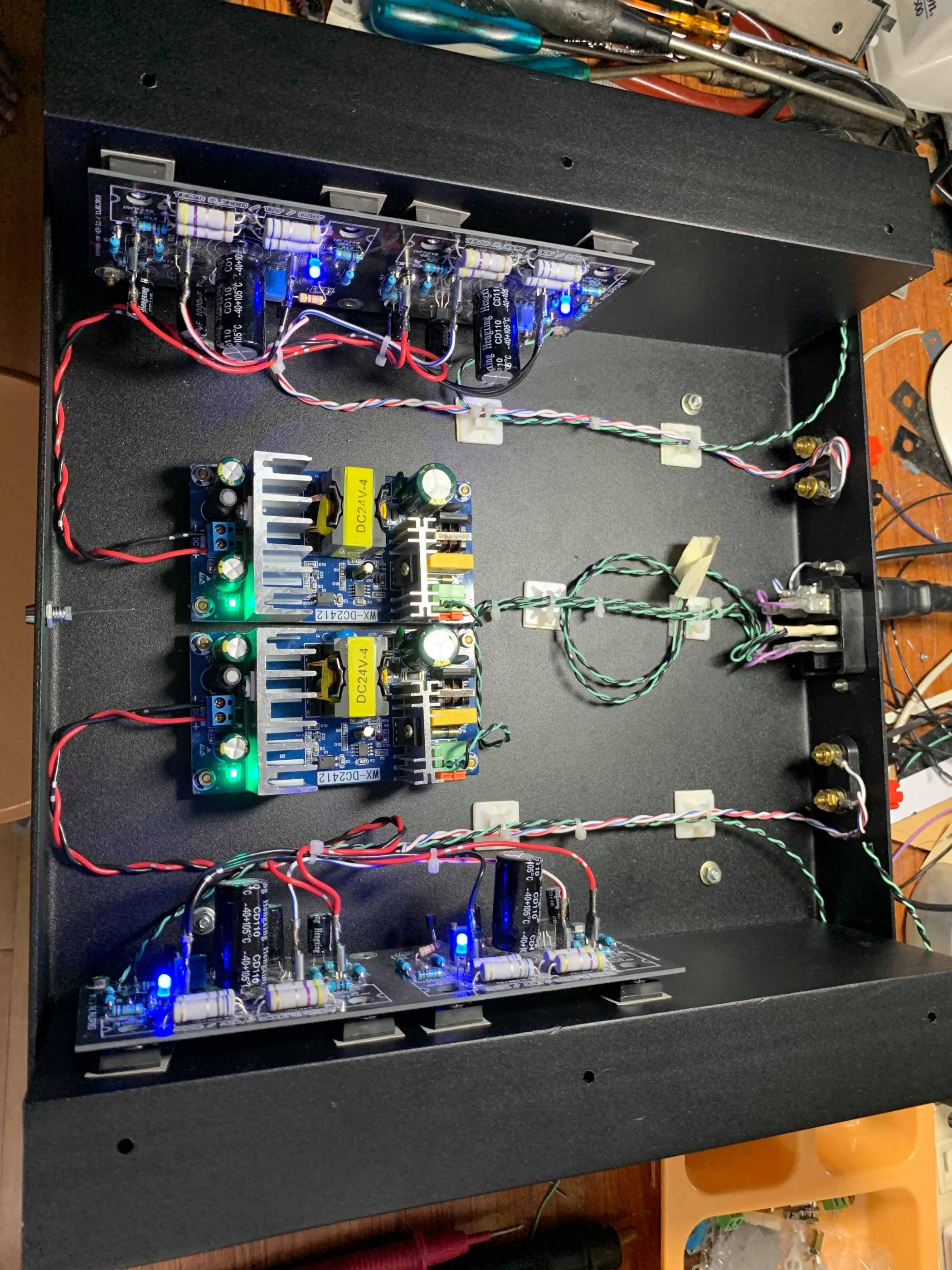

that should survive and you can power two channels with that, like i do in mine...
in some of my builds, the smps boards share the same chassis and it was very quiet..

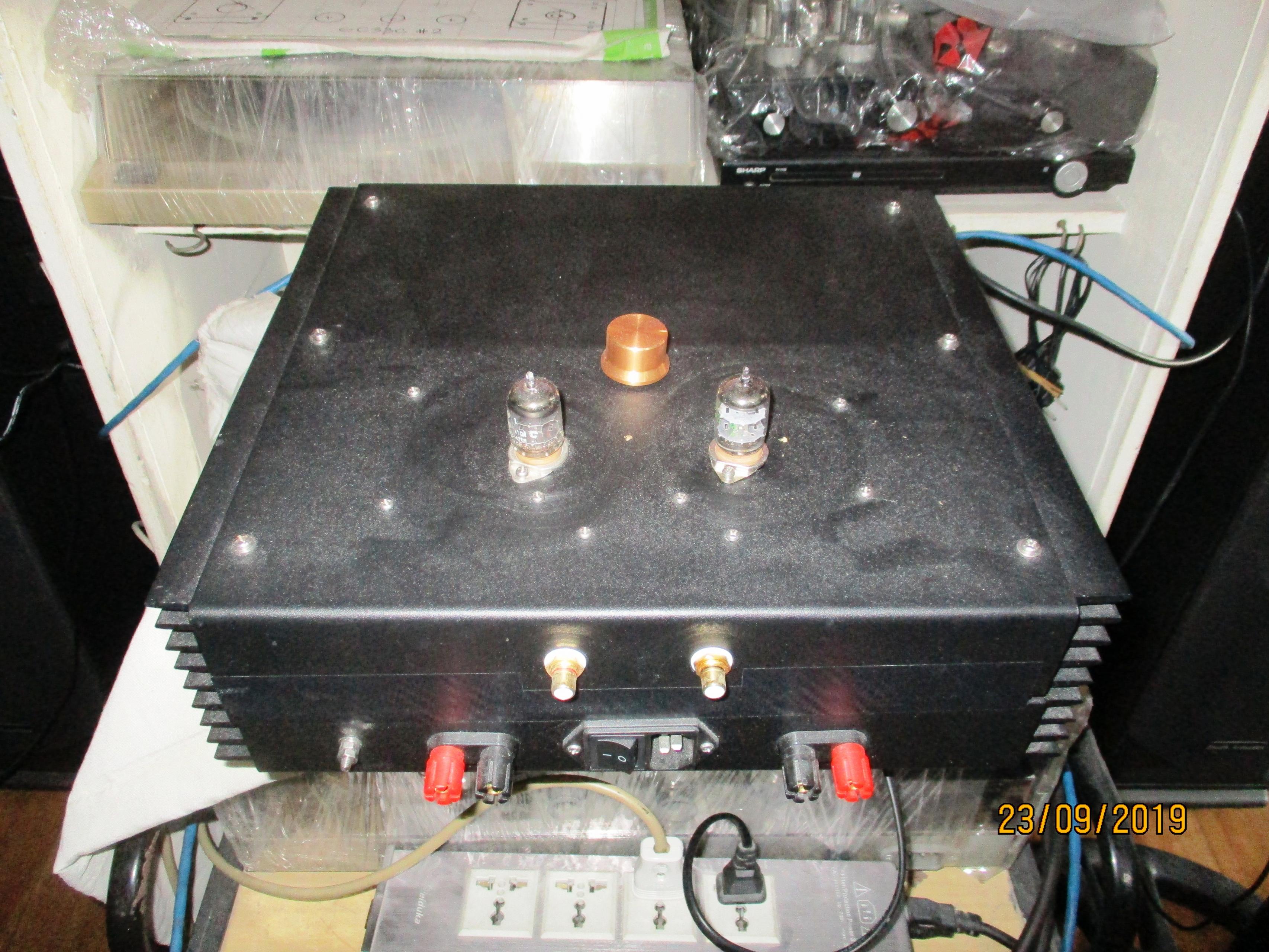

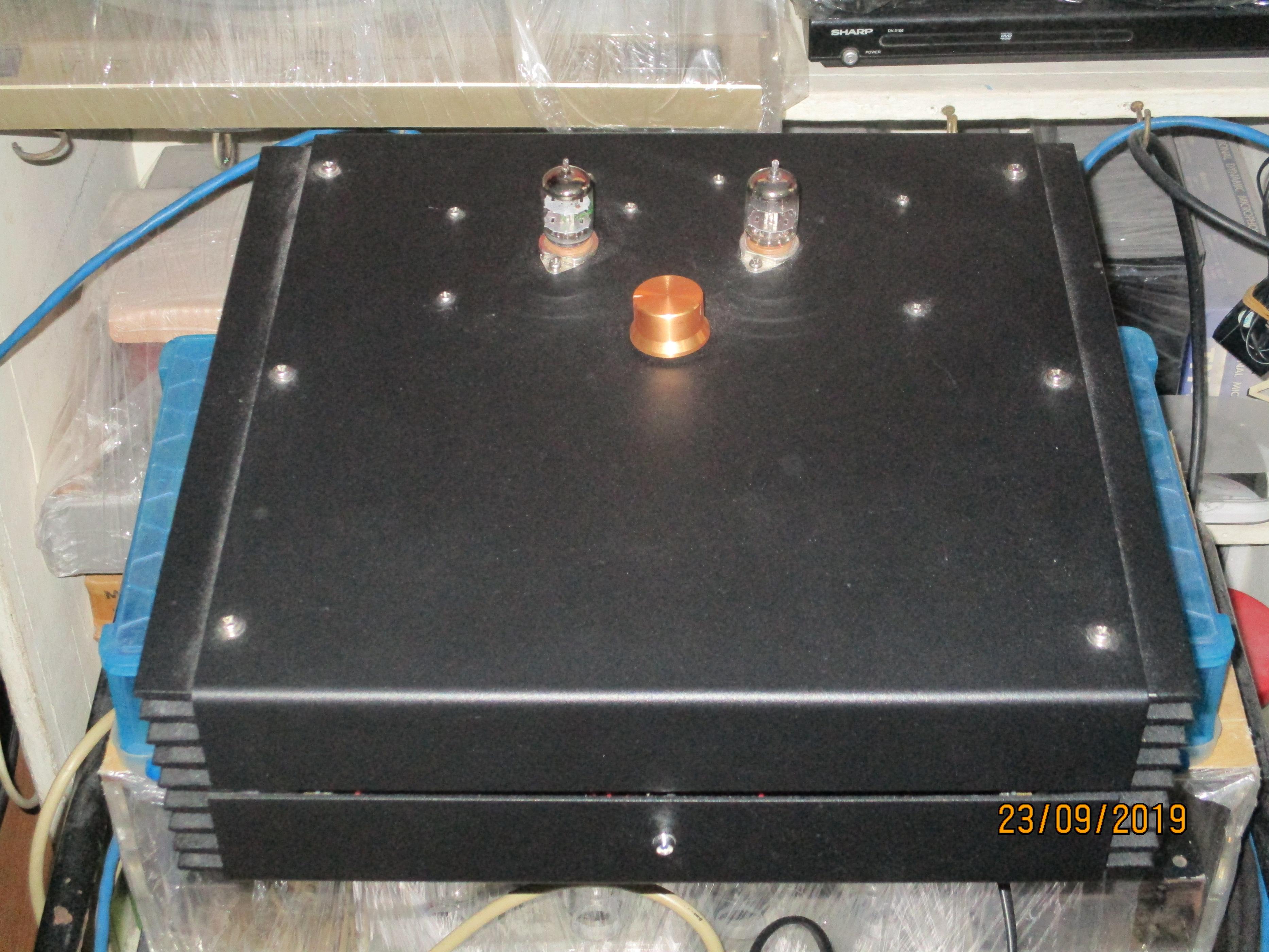

this is a bridged ACA i built with a tube line amp integrated into the chassis...

Nice work!
I haven't thought much about SMPS since, in my experience, they are frowned upon compared to traditional PSUs.
I think so to.

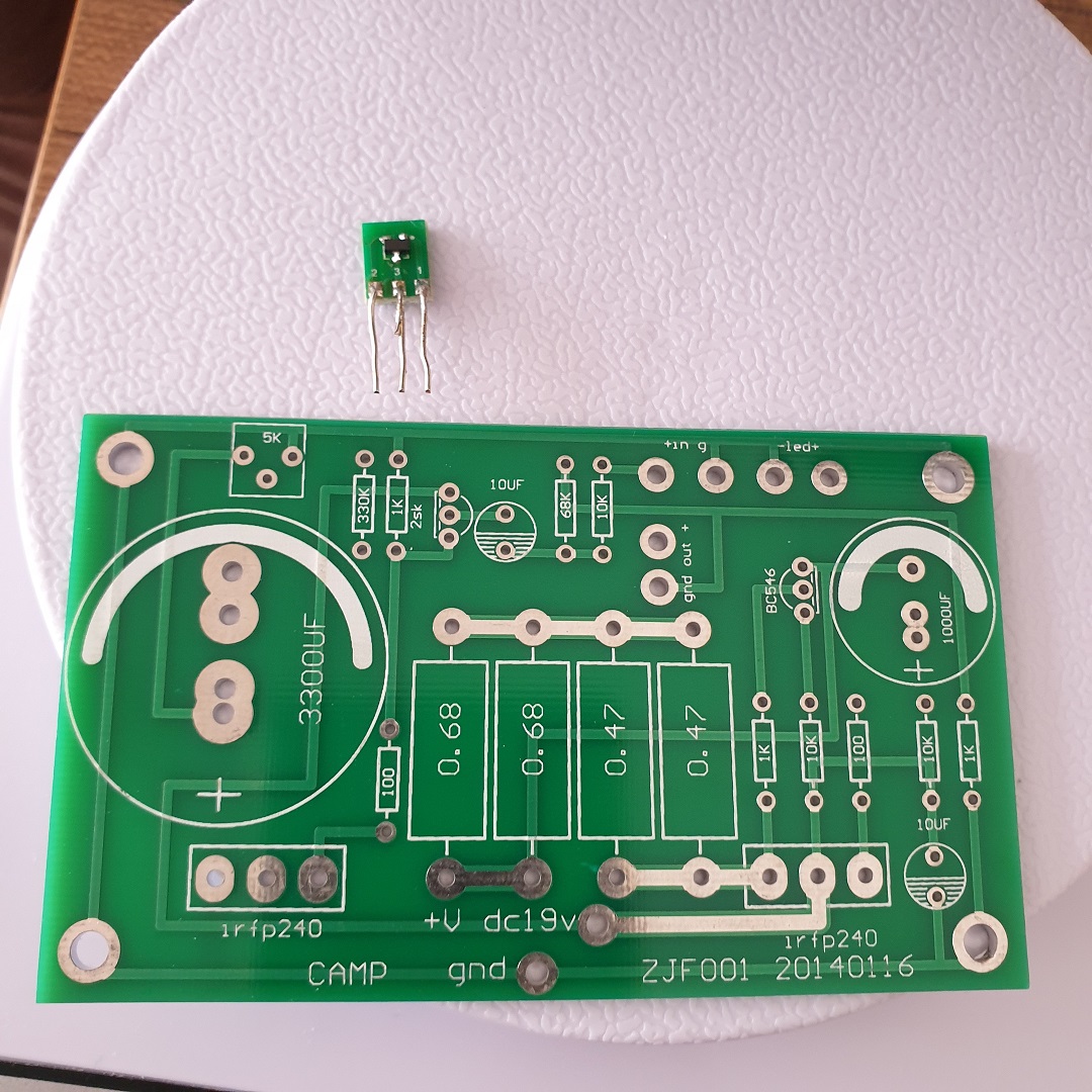

I have this pcb.I will use 2x2sk209gr instead of 2sk170bl.Should i make any revisions for working with 24v? And i have 0r4 3w mox resistors and 0r68 vitreous 4w vishay g202 resistors.Can i use them in this circuit or should make revisions?Thanks
