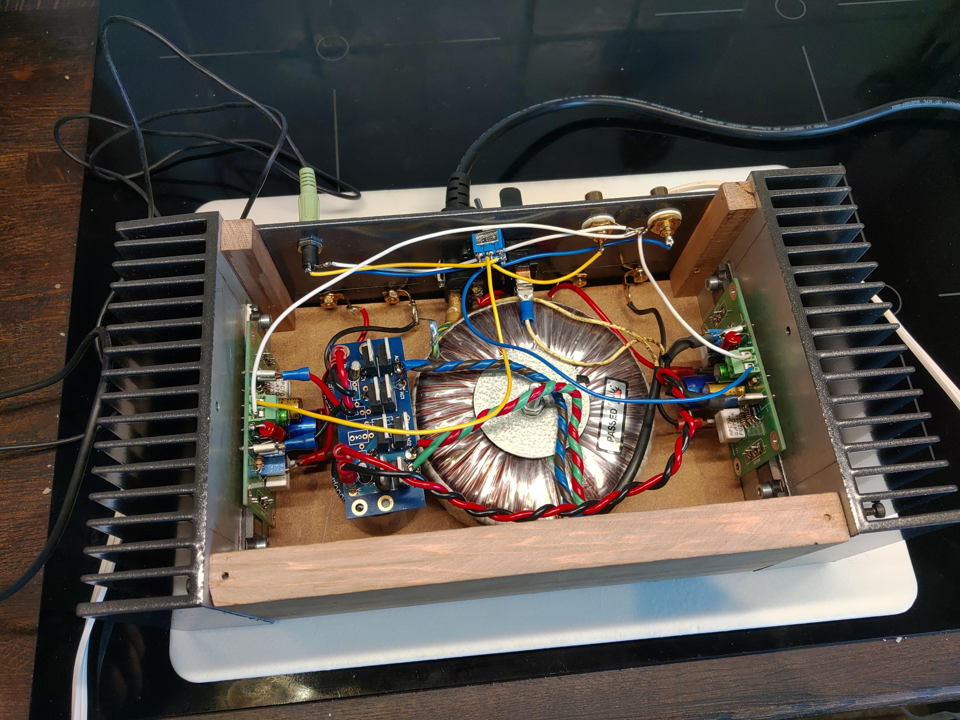

Do Mains Safety Earth first! Join all metal parts (heatsinks, rear panel if metal etc.) to the earth on the IEC socket.
Then run another wire from each GND on the boards back to the earth point.

Ok, back again with the humming.
I have found the source but not the solution.
If I power up with no source connected the humm is much lower but as soon as I connect a source the humm is back.
I don't own a preamp yet (got parts and board for a BOZ and jFet BOZ) so I am limited to Chromecast audio and misc phones/tablets but battery or line powered doesn't matter.
I tried a starground with some alligator clips but that didn't do anything.
I then tried to elevate the signal ground by adding a 10R resistor (in series) between the RCA ground lug and the signal ground connector on the board but that didn't help either.
