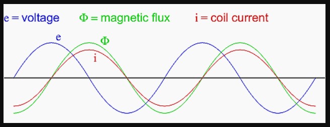

Yes it does, not just in how 'strong' any residual magnetism is but also its polarity and whether that helps or hinders the inrush current.

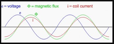

Remember the current in an inductor lags the voltage by 90 degrees and the magnetic flux level essentially follows the current flow. So you would need to switch off at the peak of the mains voltage 😱 to ensure the flux was at a minimum in the core.

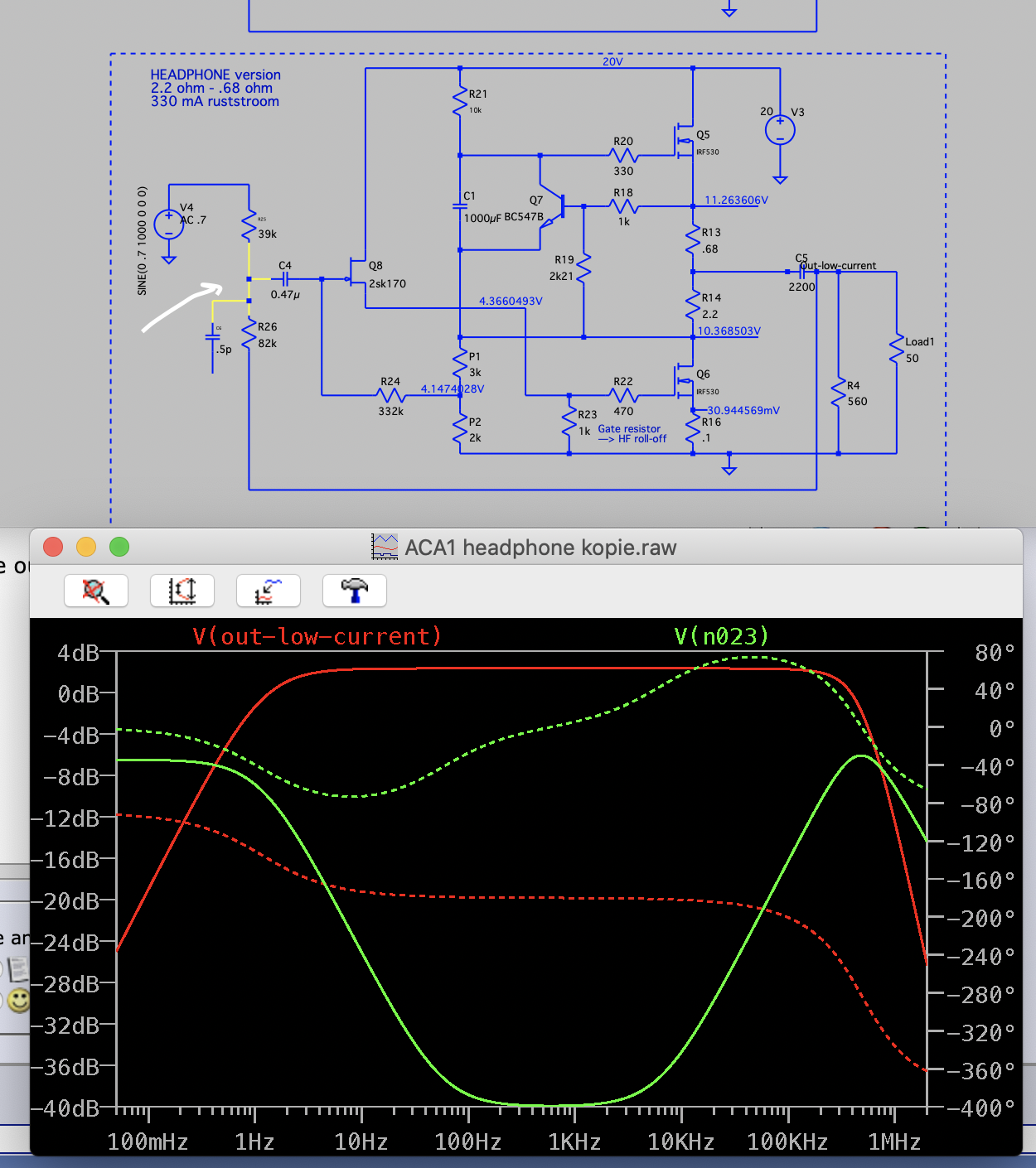

So it looks like the input cap was maybe a bit leaky. Excellent.
If you lower the value of the input cap then the output of the ACA before the speaker coupling cap will try and increase to maintain the level.
It does this because part of the feedback is taken after that cap. What this means is that the ACA may distort (clip) on low bass notes as it tries to maintain output.
Try it on your sim with a 1uF and look at the output before and after the speaker coupling cap 🙂

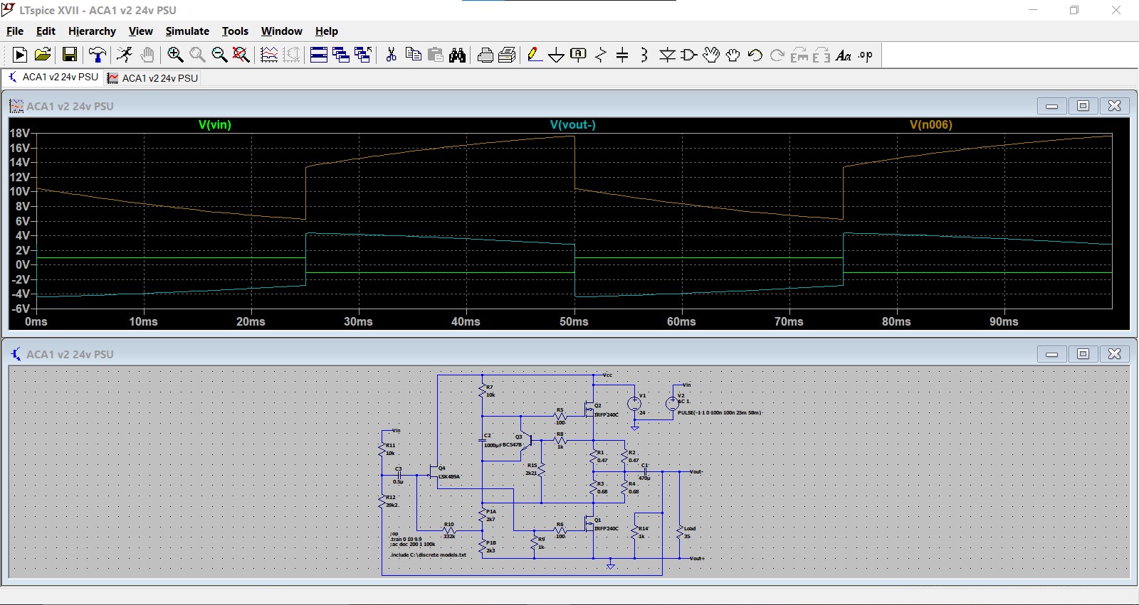

It simmed with a 4 dB peak at 1 Hz low frequencies, but in practice it was no problem. There is a sim rise at about 200 kHz but little.
Indeed, the level before the output cap can increase to clipping. That can destabilize the amplifier maybe, at least I saw that lowering input ould set it offf now with 10 uF on input; (in test I now have 220uF output) I will revert to 1.000 uF output.
With 1 uF input; 470 uF output I had a stable 7 Hz to 270KHz.

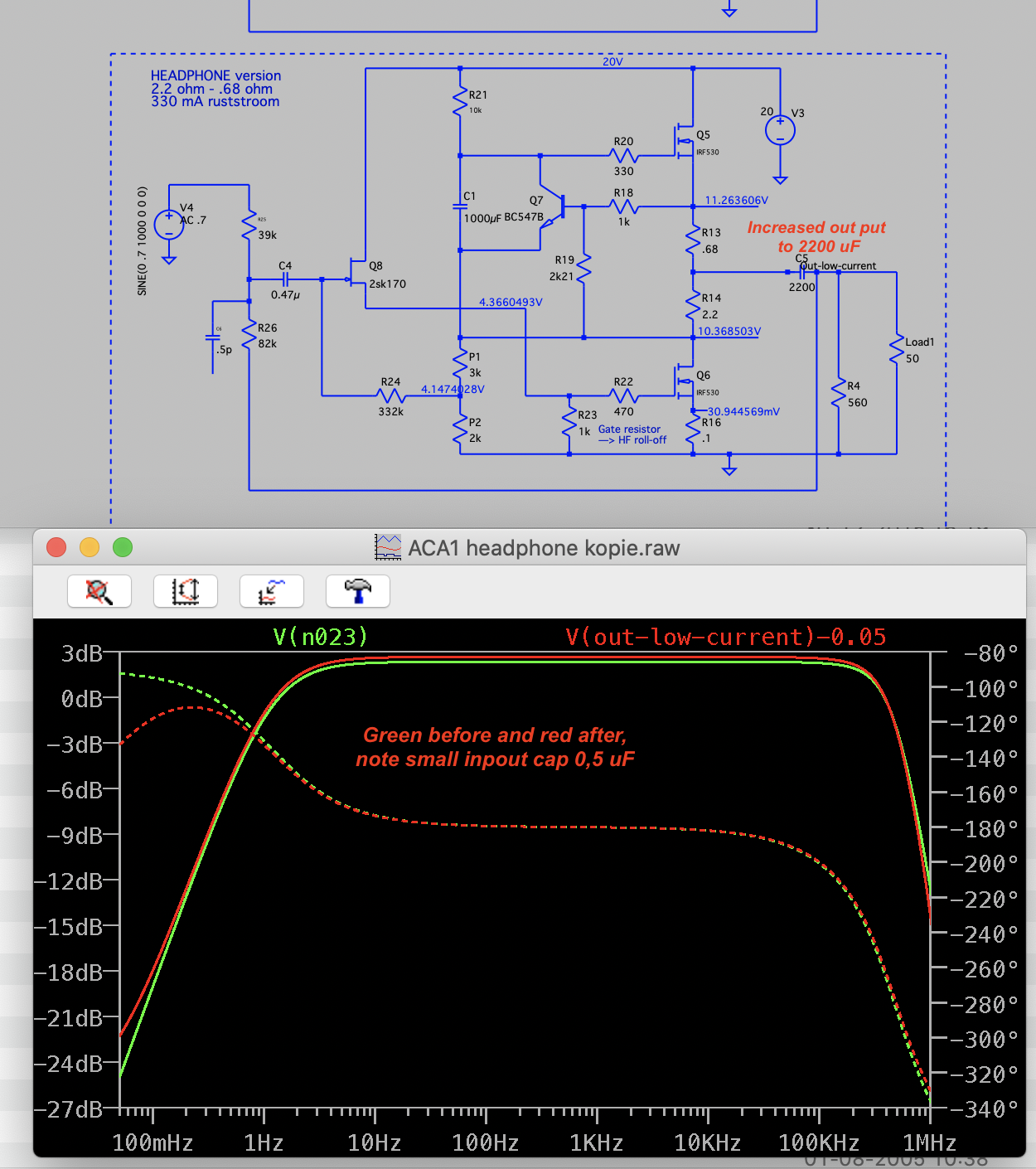

If you lower the output cap then depending on load impedance things can worse still 😉
This is with 220uF output and 10uF input. The response is 'flat' at the speaker output with a gain of around 10db. All good... but is it...
To achieve that the output before the coupling cap rises massively (clipping!) as can be seen in the second trace.
Overshoot can caused by many things, even layout and grounding can play a part. Before chasing things around first make sure your scope (probe compensation) and input signal is good.

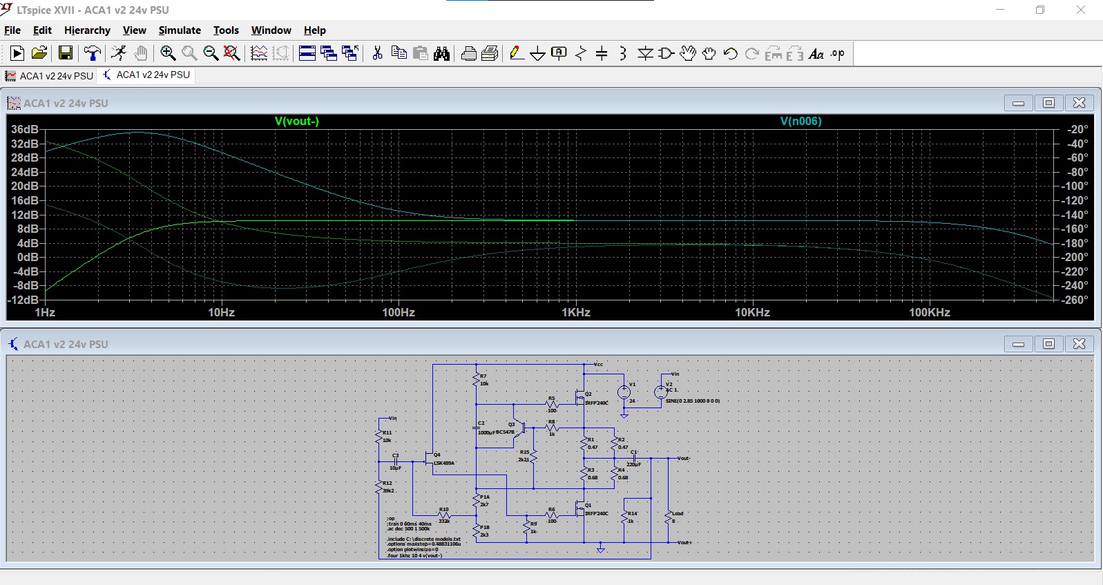

Mooly, you are quite right.
I reduced the input cap to 0.5uF in the sim and there is still a big overshoot on the lows with 470 uF, even on 50 ohms. So I simmed to 2200 uF output cap. Flat!
Output flat. Still there is a sort of bump. That is on the input summing node below 100Hz!
That bump also occurs in the stock version with 10 uF though below 10 Hz. .
By the way, .5uF/470uF sound great on the Fostex 50 ohm headphone, as long as there is no low freq component and you do not flip the on-off switch too quickly (I saw the scope trace jumping erratically after off/on cycle of 1 sec) .

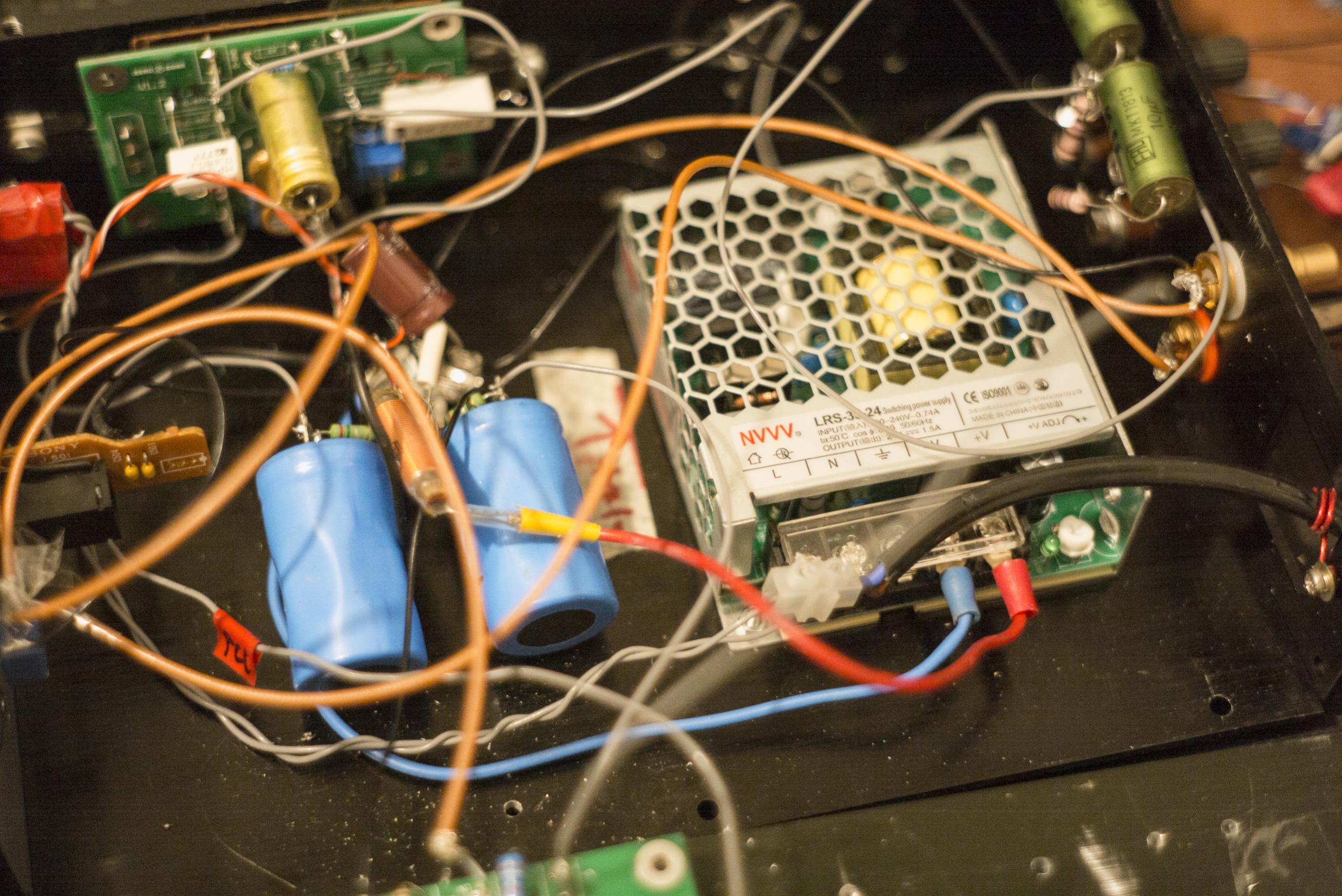

I’ve been experimenting with more and more switching PSU in these types of projects and with just a little post filtering I am finding them to be equal to, and in some ways superior to the big heavy linear supplies.
I have an NVVV switch mode supply on the ACA; it does need a good choke and filtering, there ís HF-residue. But almost gone with a 25 microHs/2200uF.
I asked them (the factory), if I could hang a 56.000 uF behind the supply (I have a box of those 8cm*16cm big cans) , 'sure they said'.
I plan to do that on the F6.
My F5 also has 4*those big cans but with a transformer. Well. Bigger is Better here too. .

It's not easy on a design like this to arrive at the most suitable cap values. You either go way over the top... or...
This is with a 35 ohm load and 0.5uF and 470u.. The input is a 1 volt peak square wave at 20 Hz (which shows this kind of thing well). The voltage across the load peaks at just over 4 volts and with obvious LF roll off, however the voltage in front of the cap is much larger in order to try and maintain the output.
Of course the ACA can run wil a wallwart supply (that is often a Meanwell one for instance, with a cord and plug).
I have choosen NVVV.
yes, 220V inside. But no 20-30Amp splurges and switching residues anymore twice every one of the 50/60 Hz, hard to get away. As we all know. Where we spend money on expensive rectifier boards, post filtering, lineair stages, shunts etc...
Just take time to create a good HF filter, here I used 25microH/220uF and .25ohm/3300uF - I could improve, leave that to my next build.
Caveat. The switching power - does have its own power line filtering caps (of course) and these are connected to the earth line. You have to have it earthed, otherwise inside the cabinet and having no outside connections (input cable) the chassis will have a slight stray power residue, say 80 volt to the touch. Not nice.
Even isolating the switching power case from the chassis (I put a piece of paper underneath) does not solve the problem.
When all is connected connected to input plugs that have an earth somewhere it is safe.
But otherwise, be prepared for a small jolt. 😱 It is not lethal. 😴
I have had this n-times on transformer fed appliances too. Mostly with line input filters I used without having aan earthed socket.
