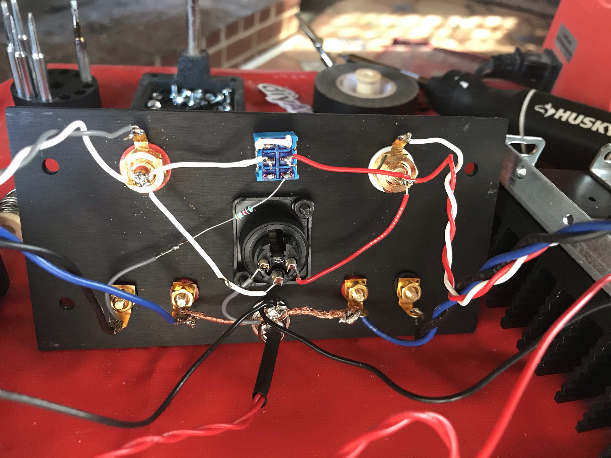

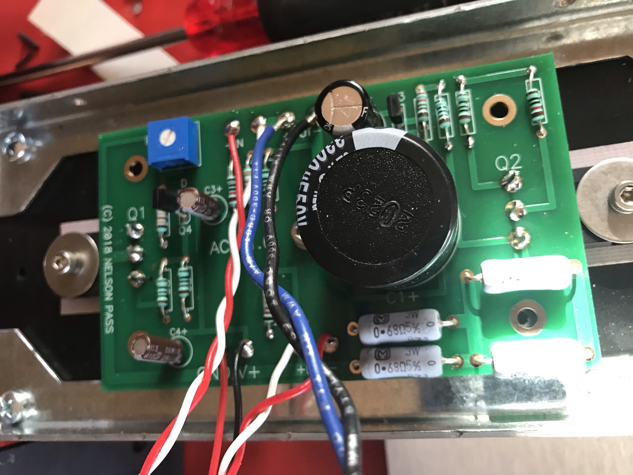

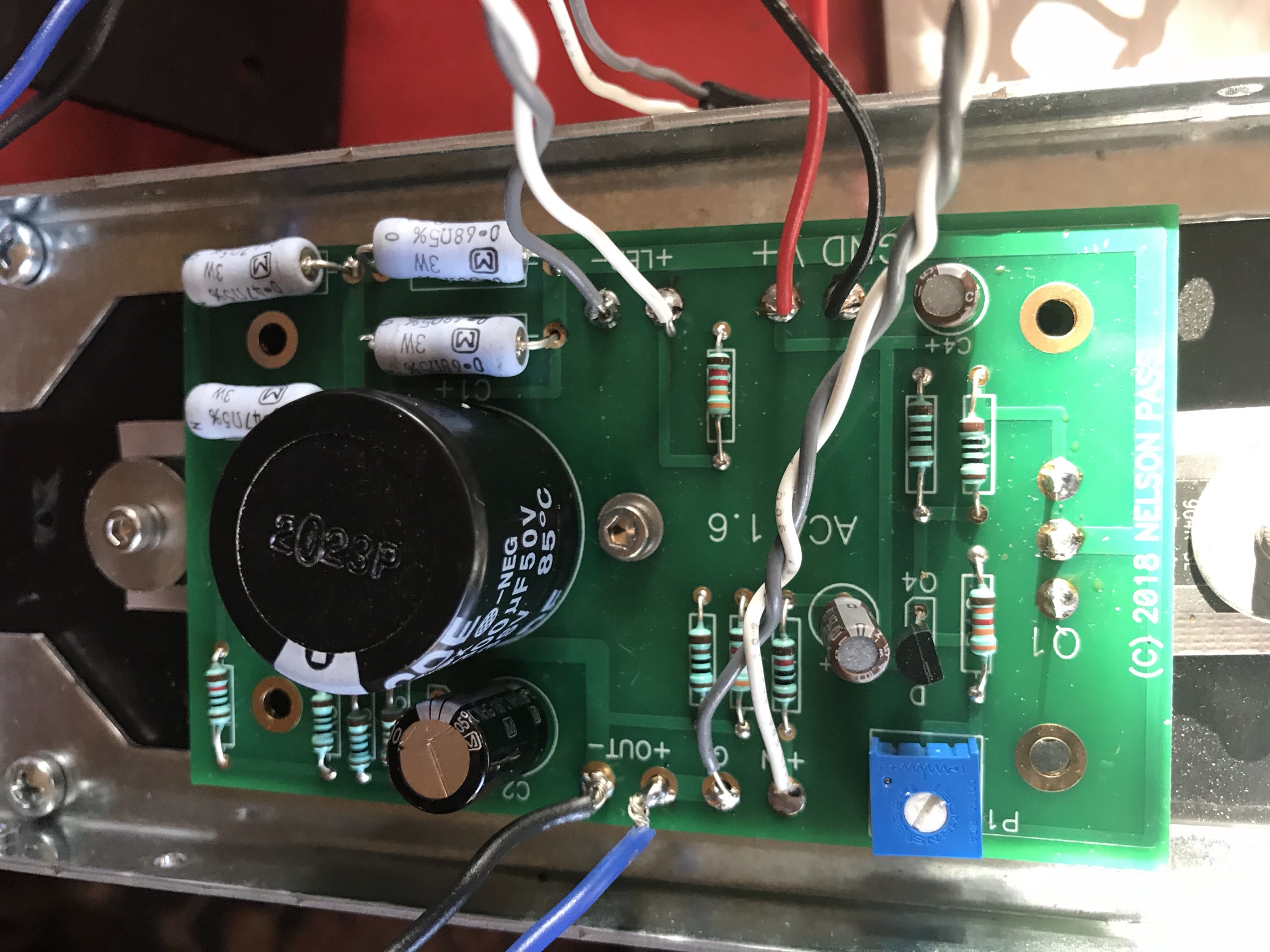

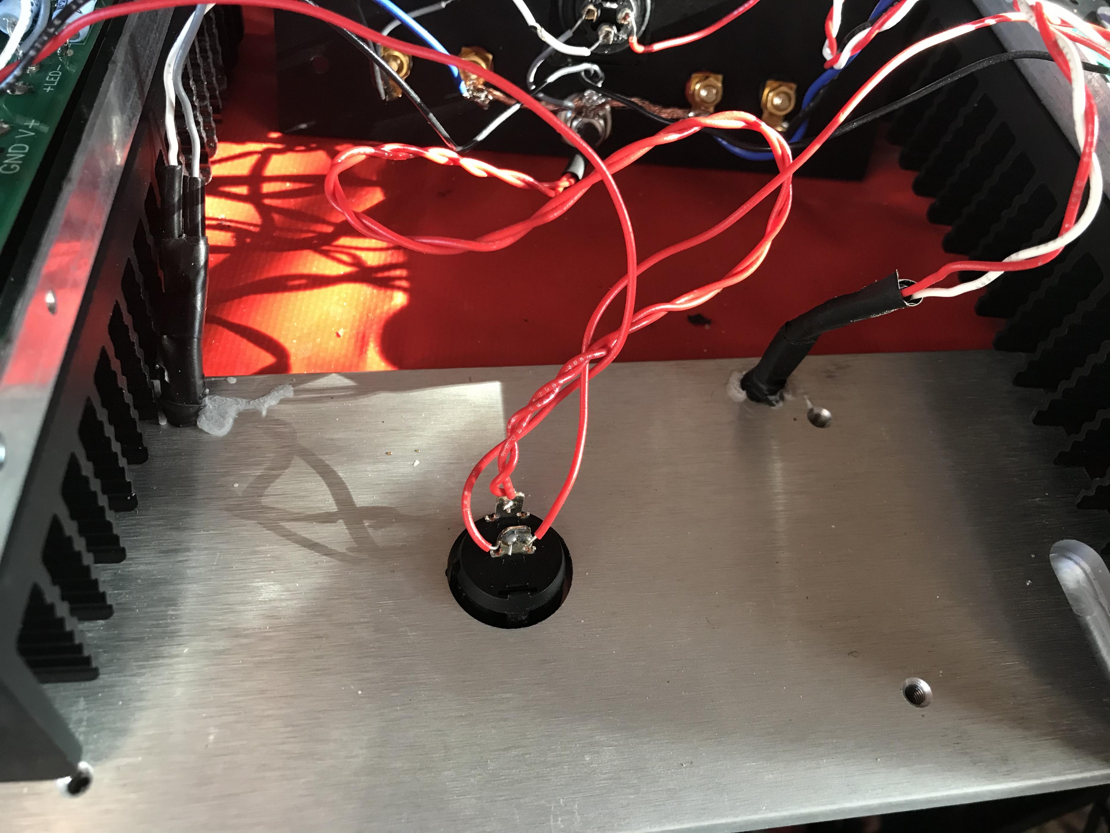

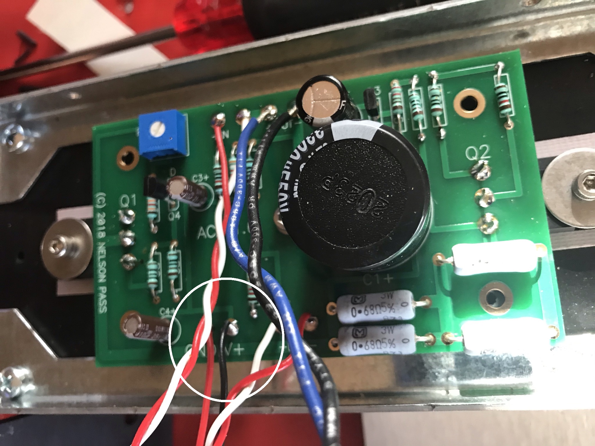

Just got done my two amps and went to adjust balance. No problem with the second amp I built but first amp would not register. I checked all wiring connections to the boards and they look ok. I checked voltage at the switch and got 24 V. Then I took off a rail on each board and checked that nothing was touching that should not and everything looked ok. Any ideas. Pics included.
Thanks,
J

First thing to check is your wiring...
On the image attached the black wire is going to the V+ connection. I cannot follow the whole run, but suspect that black is the -ve lead?
Next is some of the soldering on the back panel is very shallow in places, might not be the problem now, but will let you down in the future.
Alan

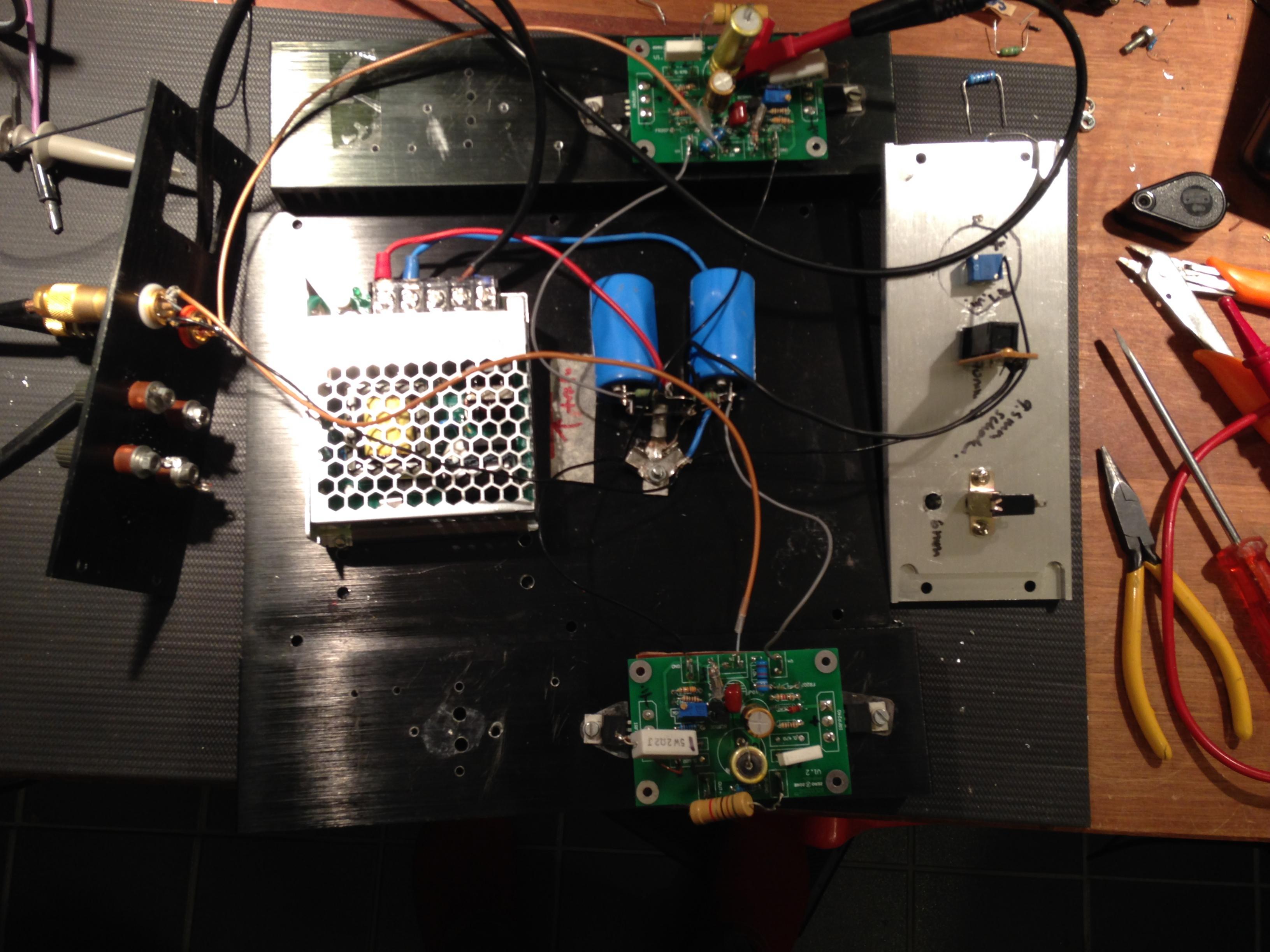

Hi, I like to share my ACA build for headphone: using IRF830. (This FET needs higher gate stopper)
I have it running for now at 330 mA, case stays cool.
I have a NVVV power supply, RC per channel of 0,25 ohm/3.300uF.
Works like a charm. I have 0.47 uF input and I have 470 uF output, all to reduce the turn-on thump.
I have speaker output too so I can use it for bi-amping if needed; then the ACA can be revved up a bit to say 500 - 600 mA and deliver 2 watts in 8 ohm.
bandwidth @ 50 ohm (my Fostex RP phone) is < 7 Hz - 270 KHz.
I have the 2k2 attenuation of the bias. So it gives lower output impedance. test: Moving from 51 ohm to 7 ohm (parallel the 8 /51 ohm) gives a drop of less than 1 dB. [It is a great amp for sensitive fullrangers]

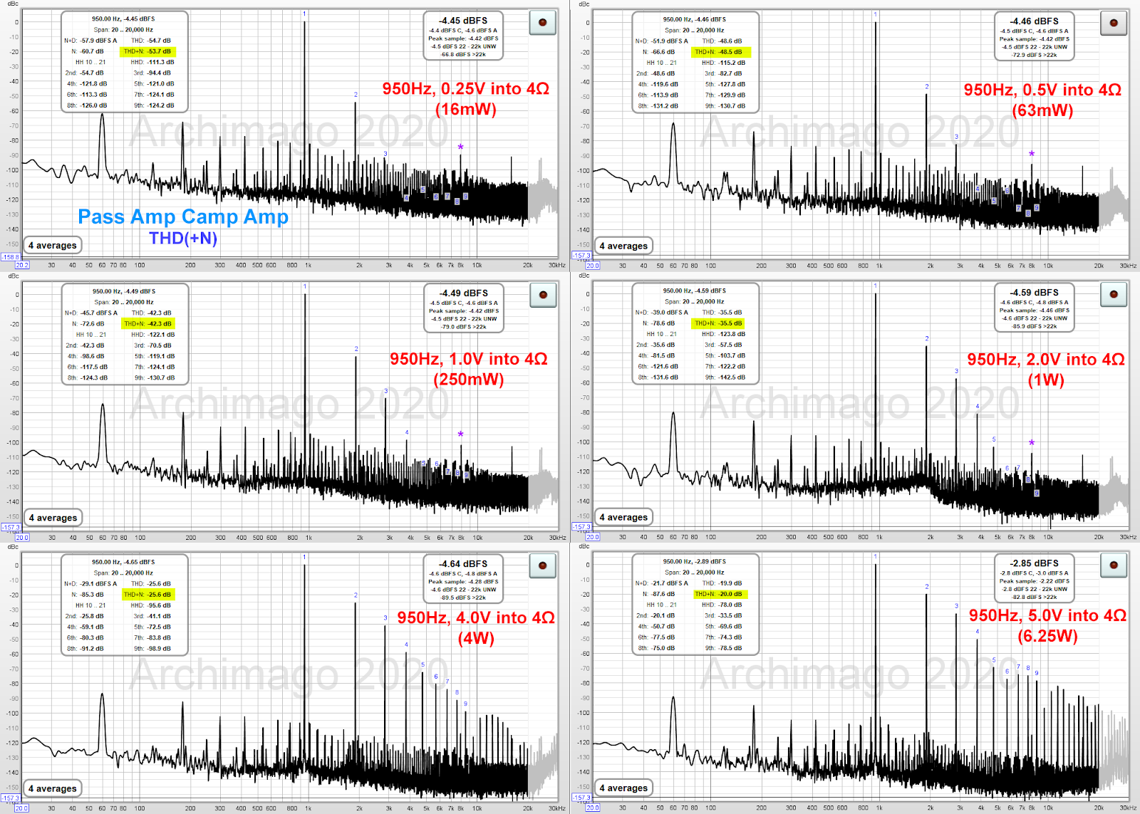

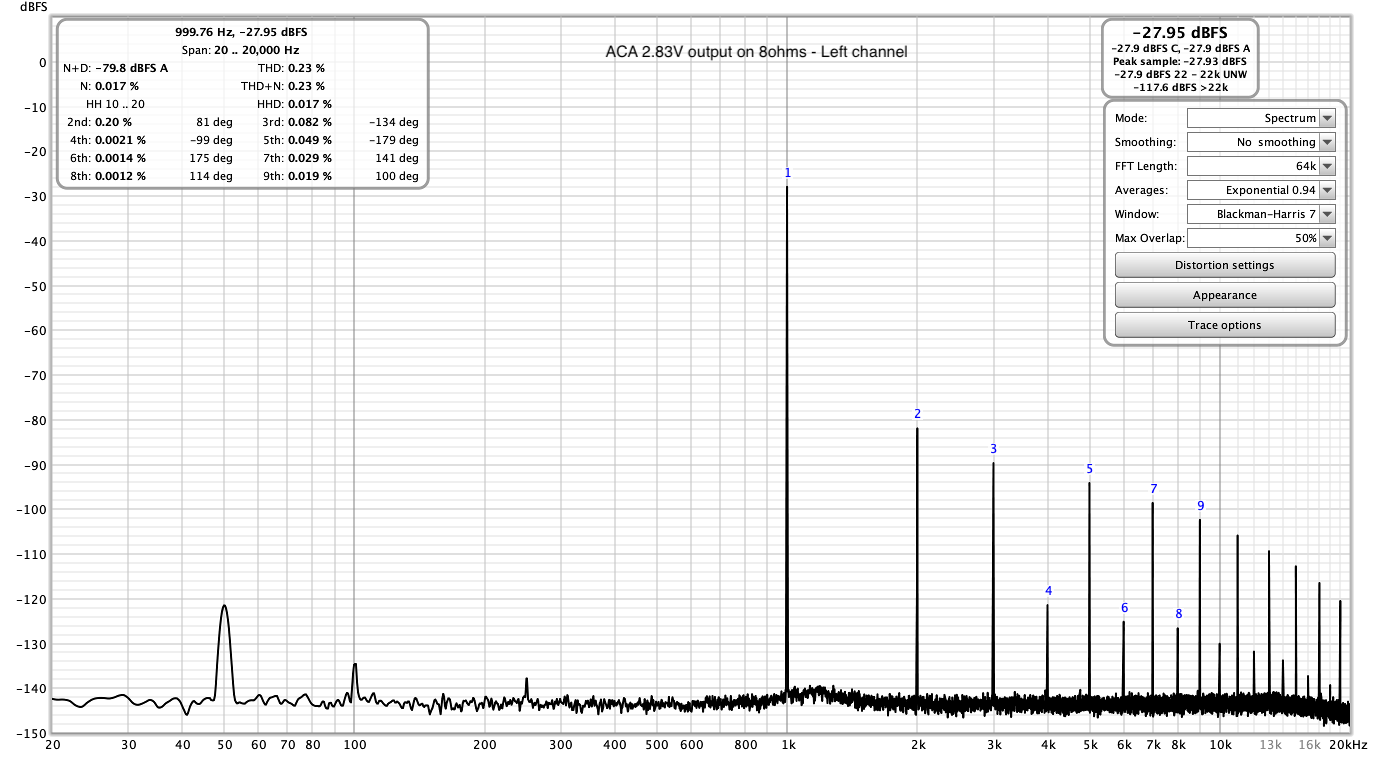

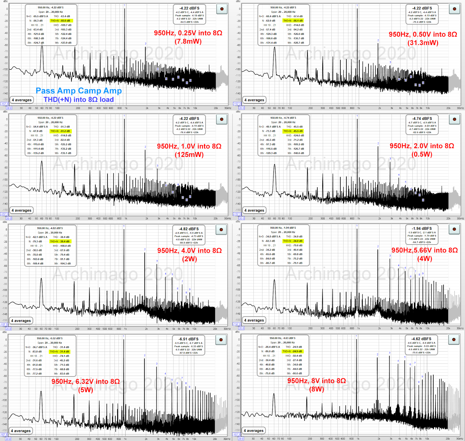

Anybody measured distortion spectra of the ACA? Archimago did in MEASUREMENTS: Pass Amp Camp Amp (ACA) 1.1. The crossroads between objectivism and subjectivism, and reconsidering von Recklinghausen.. One of the magic to note is that the ACA has composition of H2/H3 > 20dB for output power up to ~3W, very close to top quality SE DHT amplifier, exceptional design rarely found on solid state amplifier at any price. Thank you Papa Pass. 🙂
single ended single stage amplification, even tubes will have a hard time replicating this feat...

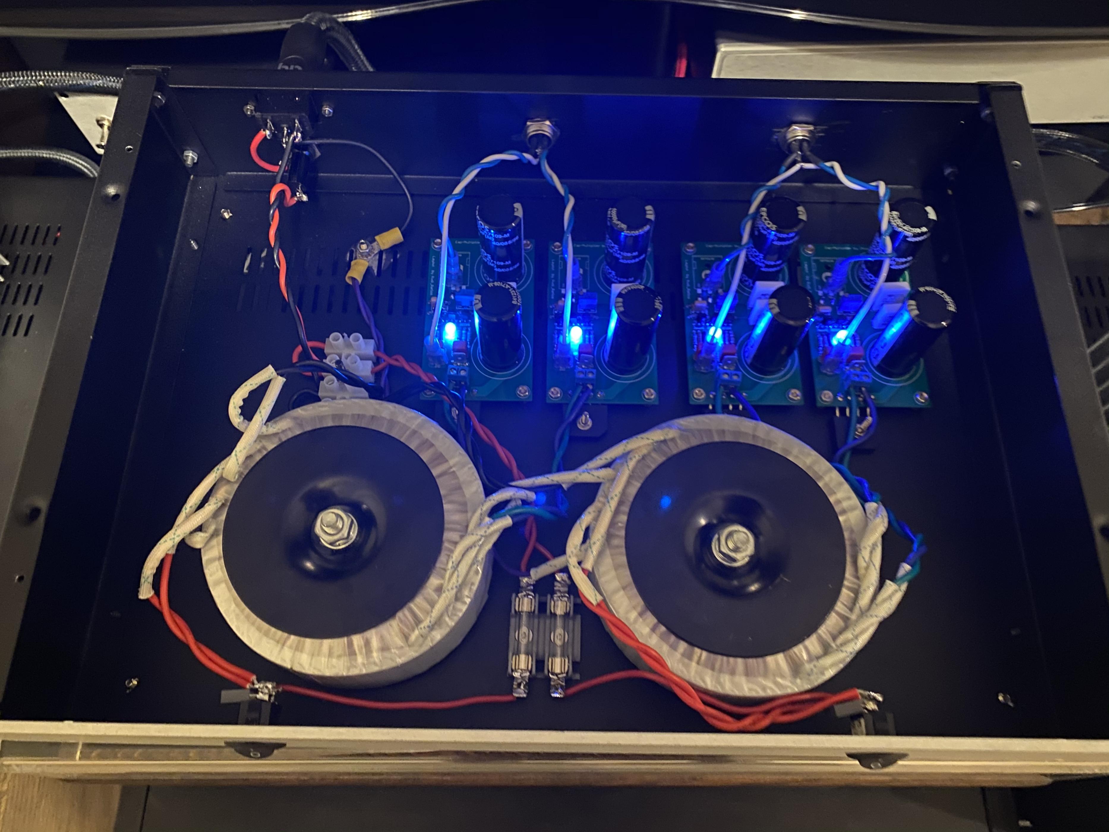

Looking for some help. Built my amp camp with premium parts with an external power supply.
Two torroidal transformers that are 22V 200VA so I see 28V rails with CapMX power supplies. Everything tested fine on the work bench with DBT but after trying to hook it all up today I’m blowing fuses.
I have a 3A slow blow on the back and one slo blow 2.5A on each transformer. The only inrush limit I have is a thermistor across each power button.
Do I need more inrush limiters or am I using too small of fuses?
