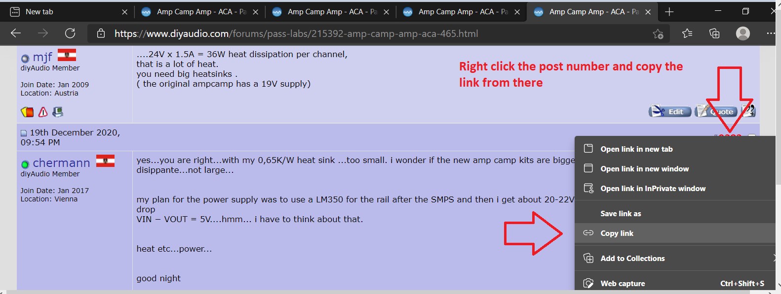

For info on linking to other posts.
When you link to a post 🙂 if you right click and copy the link from here (image) it retains the unique post ID you are looking at and that should open correctly for everyone regardless of how they have the page view set up (number of posts per page).
If you copy the browser top line info it doesn't retain that info. Your links take me to posts #1421 and post #501

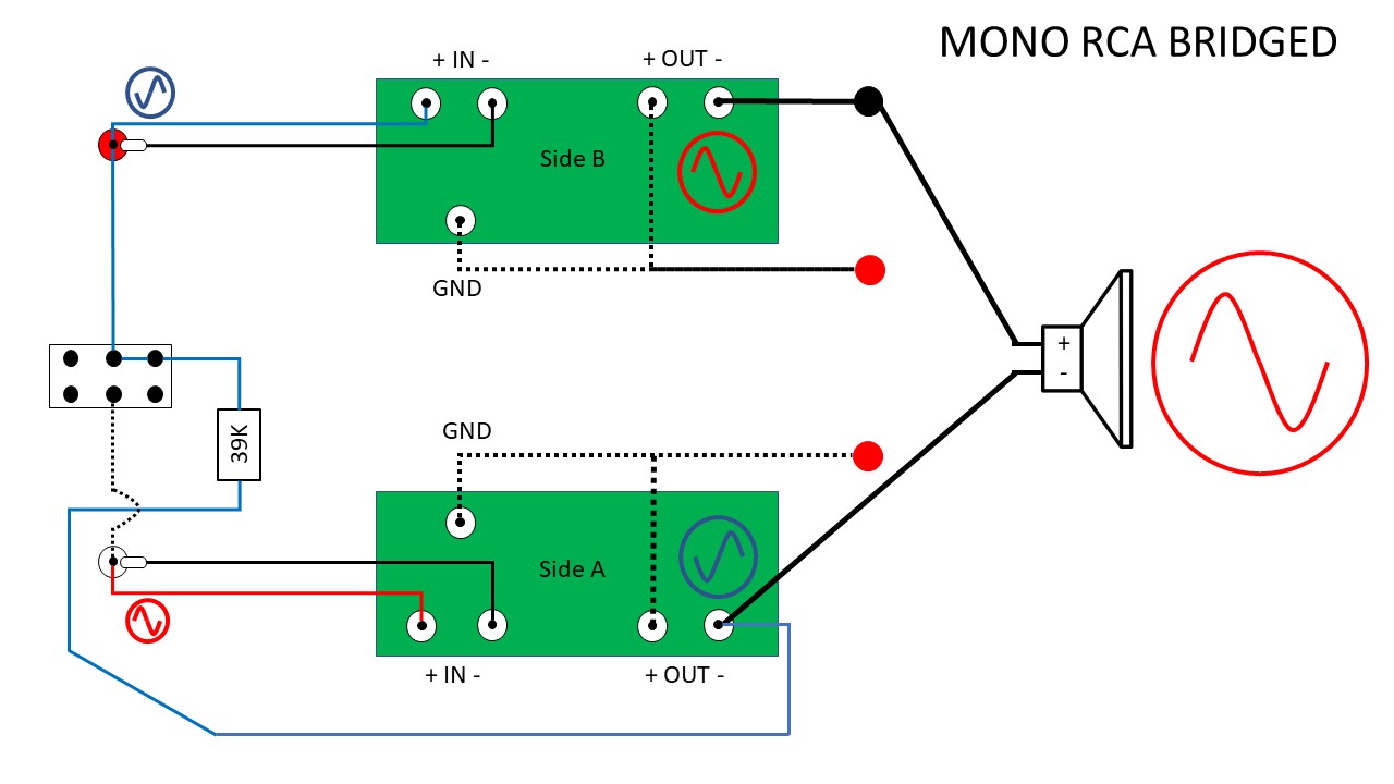

Did anyone notice that the speaker cable set up for bridged mono is reversed in the build guide picturs for 1.8 and 1.6? I think that this is just a mistake and that the 1.6 picture is the correct set up, cannot make sense of it otherwise.
Do not worry, either is fine. Just keep both your speaker connections to the same pattern.
Well, it makes a difference if you connect the cable to the wrong connection as you reverse the phase to the loudspeaker. But I guess they took the picture of the 1.8 when showing how to connect for parallell mono and simply forgot to switch back for bridged mono. As far as I can understand from the schematics, they should be connected exactly as shown for the 1.6 also in 1.8 (when running bridged mono).

Speaker pos to "side B" amp board out | speaker neg to "side A" amp board to retain phase from the input signal.

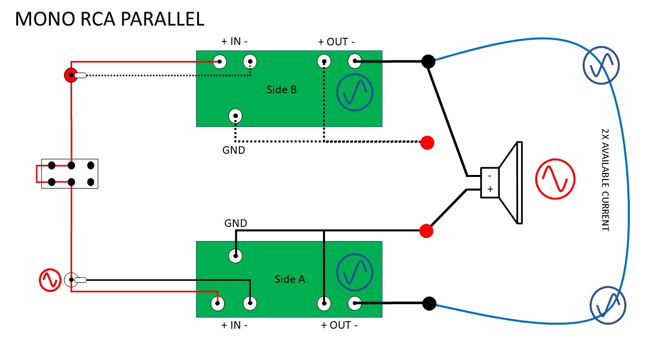

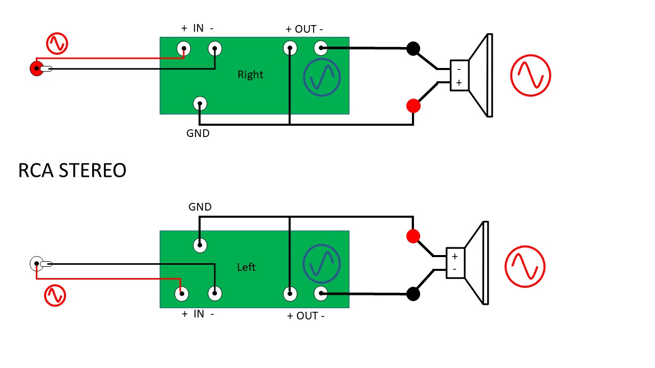

I did these a few weeks ago to help with my understanding. I think they're correct. If not, I'm sure someone will chime in. Overly simplified, but I needed to remove a few things, so I could wrap my brain around it.
Perhaps they'll help others.
Edited to correct spelling of Bjornje, correct note, and add attachments properly. Must get coffee. Keep hitting submit too soon.

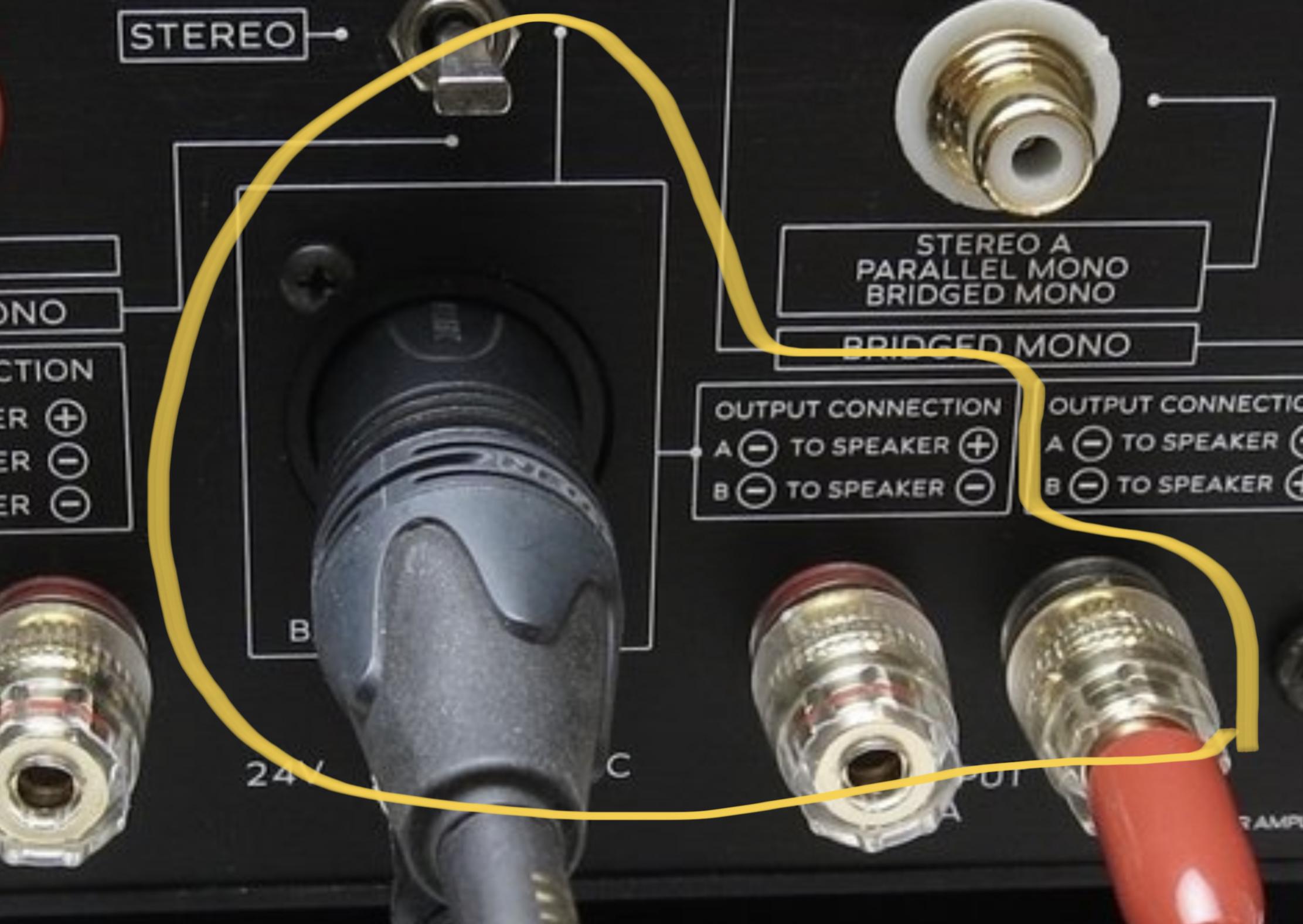

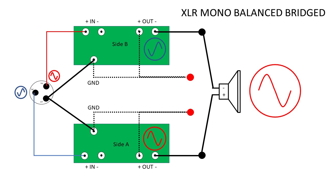

That is how I understood it. And why the picture found here: https://d17kynu4zpq5hy.cloudfront.net/igi/diyaudio/HCcNDknlZGDlSkUu.huge
puzzels me. As you can see, they connected cable + to A-. Probably just an error.
Sorry, linked the wrong image, that was for XLR, but the connections are the same. https://d17kynu4zpq5hy.cloudfront.net/igi/diyaudio/NODRs2hIAZSWXTa4.huge
Still positive to A-, should be positive to B-. Even says so on the back plate.

tl:dr - The photo 6L6 posted of the silkscreen matches the diagram I posted above and should maintain phase, but I wrote it wrong. Speaker (+) goes to side A. Speaker (-) goes to side B.
6L6 - editing time has passed, can you please remove my post. I fear it may cause more confusion. 40 lashes with a wet noodle for me.
