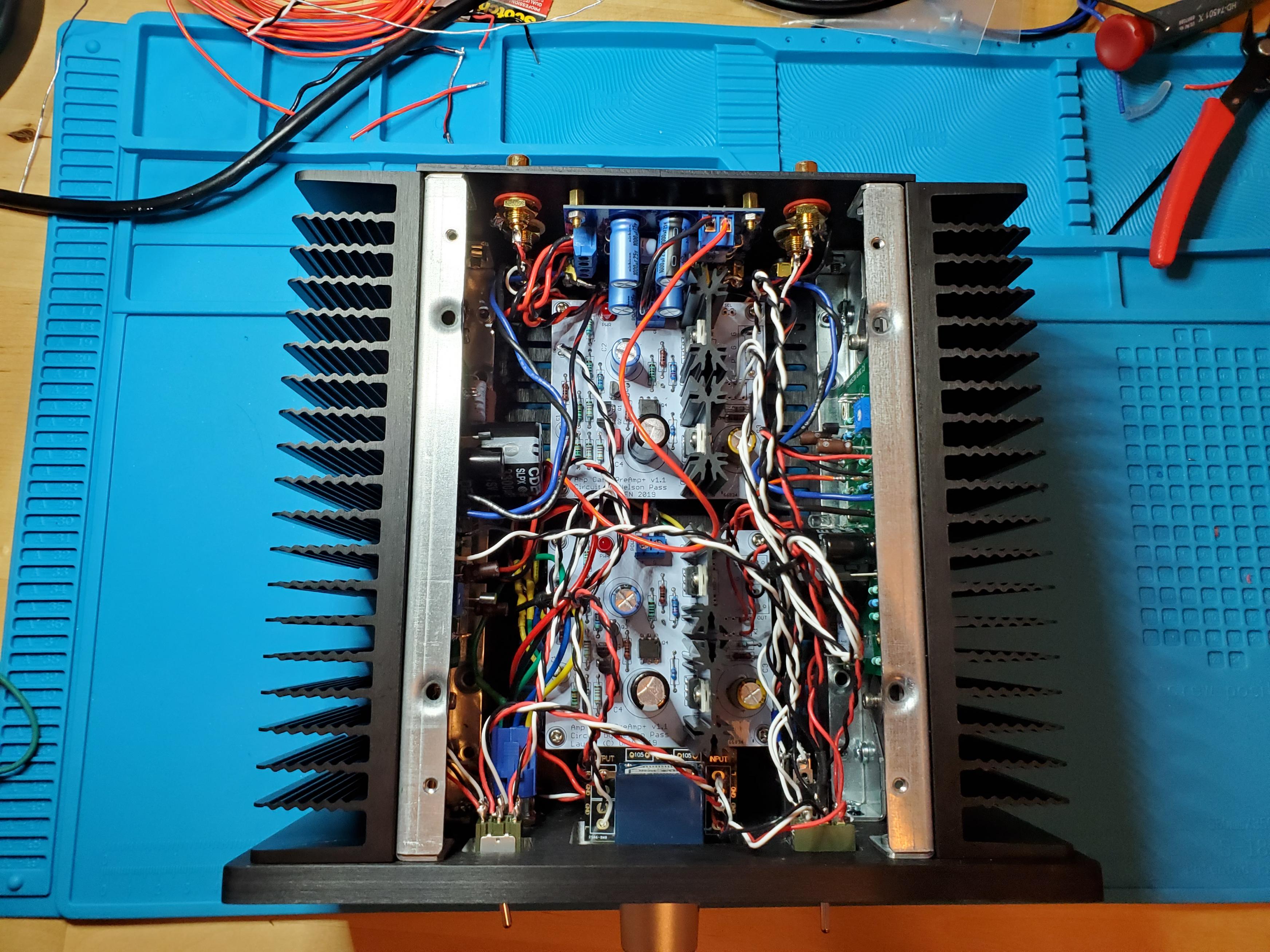

How hot is it normal for the ACA to run?
Testing my fresh build, even before closing the top cover - this thing radiates heat!!
I am sure it does not help that I managed to stuff the middle with an ACP+ to create an integrated amp... 😉

Refer the master's temperature sensing guide in The Aleph-X thread @ Post #1858.
From what I know, heat sink temperature will depend on two things:
- Where you set the amp's DC Balance;
- How loud you play your music (in short, play loud - run cool).
They run pretty hot. That's normal.
My thermometer's 9V battery is dead and I do not have spares 🙁
Will get a new battery tomorrow, and reply with actual numeric values...
Actual numbers are not that important. If the heatsinks are cooler than 55C (130F) it's good.
130 feels really really really hot, but does not instantly hurt. (Instant pain starts around 65C/150F) You can keep your hand on it for only a few seconds it's about that temperature.
If you can keep your hand on it for 10 seconds it's around 50C/120F. You've almost certainly never felt a solid state amp this temperature.
If its awfully warm but you don't actually need to remove your hand, it's 45C/115F and it just warms your room.

Well let's see if your temperature calibration nomenclature
matches mine:
Blimey hot is 10 seconds hands on = 45 deg C.
Crikey hot is 5 seconds = 50 deg C.
Bloody hot is 2 seconds = 55 deg C.
X*?@! is 60 deg C.
All of these are within an acceptable range, although
X*?@! is resrved for the more mature constructor.

OK - took some measurements this morning... For now - with the top cover open, which I know would not give worst case temp. measurements.
See attached photo as a reminder - I have a "standard ACA" with added ACP+ in the middle, which adds its own heat.
Here are my measurements (ambient = 20C):
Time: 0
* ACP+ Heatsinks: 20C
* ACA Heatsinks: 20C
Time: 5 minutes
* ACP+ Heatsinks: 44C
* ACA Heatsinks: 32C
Time: 10 minutes
* ACP+ Heatsinks: 50C
* ACA Heatsinks: 40C
Time: 20 minutes
* ACP+ Heatsinks: 56C
* ACA Heatsinks: 45C
Time: 30 minutes
* ACP+ Heatsinks: 62C
* ACA Heatsinks: 50C
Time: 40 minutes
* ACP+ Heatsinks: 63C
* ACA Heatsinks: 51C
Looks like after 40 minutes temp. is pretty stable. As expected.
So... taking into account the top cover was open - I am not too worried about the ACA getting too hot, but I have a concern with the ACP+ radiating 63C inside the closed case... 😱
Any thoughts? Would the ACP+ become my downfall? 🙁
I can repeat the temp. measurements with top cover closed, but will not be able to measure the ACP+ heatsinks inside. Only ACA's big heatsinks, and the case top cover which would radiate some of the ACP+ heat I assume, but I won't be able to tell internal ambient or ACP+ heatsink temp.
