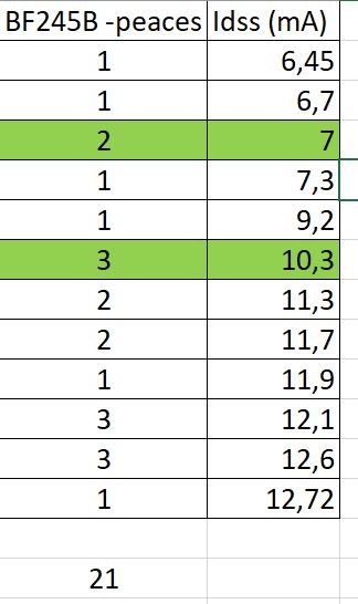

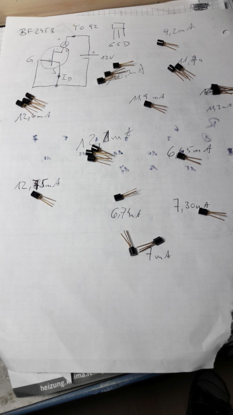

..J FET selection
Hi
i checked the Id current from my BF245B N-JFET.
the current is about 6 to 12mA..so i have to choose the 2 pcs with 7mA...right?
Hi
Should be good. Lower Idss on your list are more suitable for the ACA compared to the higher ones, better temperature feedback for bias stability.the current is about 6 to 12mA..so i have to choose the 2 pcs with 7mA...right?
i thought that the temp feedback is done by R9?...no?
Sorry, bad wording. Given a fixed vgs a mosfet will bias at a current that will be dependent on temperature. Voltage divider formed by P1 in ACA also works as feedback stabilizing variation of output stage DC bias current vs temperature. Lower Idss Q4 will result in better feedback action vs temperature. On the contrary, early clipping will happen if Idss is too low.
