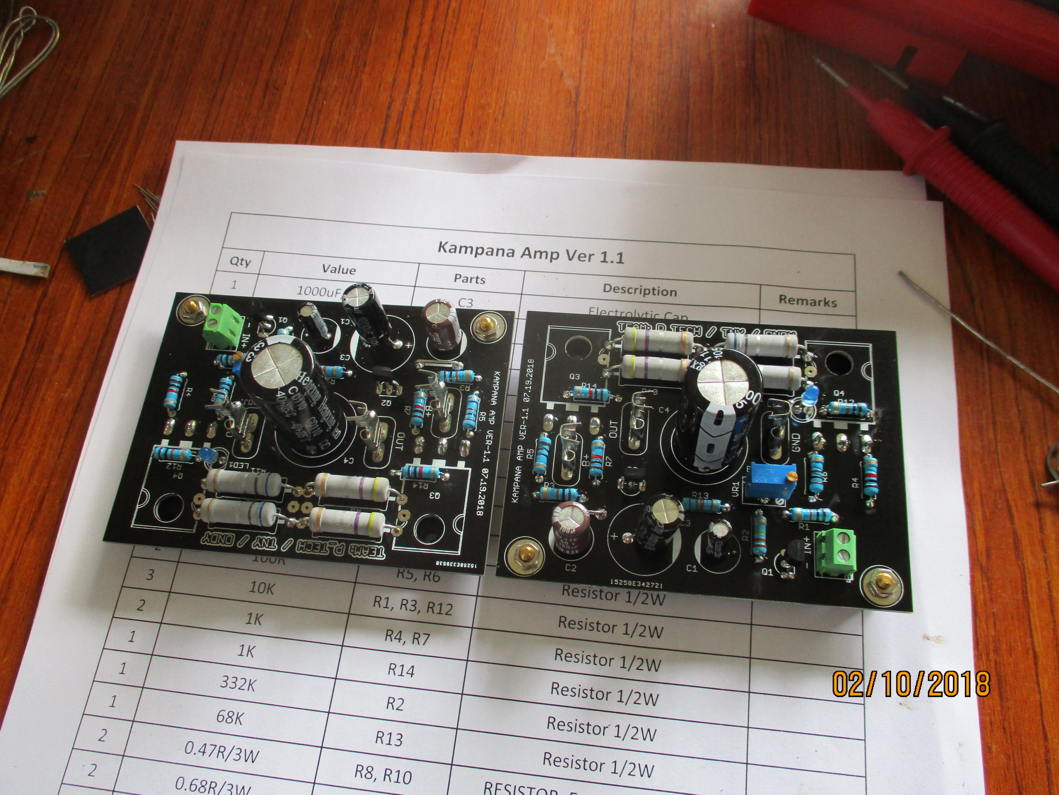

Measure at the resistor leg connected to it, R10 - R6/R9.... the problem with this clone pcb is that its really wiggly to get a measurement at the Jfet and the bipolar. its so closed together. i will try it....
here are my voltages
i measrued both MOSFET
Q1 G 4,76V, 4,68V D 8,72 8,71 S 0,001v, 0V
Q2 G 14,28V 14,31V D = supply 23,82V S 9,67, 9,67
N JFET
Q4 G 4,85 4,74 D= supply 23,82V S 4,72 4,67

@chermann - You are concerned by the gr grade you have. Measure Vgs of jfet to make sure it is less than +0.5V in the ACA. It will not be a large value even if negative for a 2sk30gr. The channel that shows early negative clipping may show Vgs of jfet close or even higher than +0.5V. In that case, it makes sense to replace it with higher Idss part.
so with Gate
4,85V and Source 4,72V i have a different of Vgs= 0,13V .................so everything is fine??

So Q4 Vgs
4.85 - 4.72 = 0.13
4.74 - 4.67 = 0.07
Most probably the one with Vgs = 0.13 is the one giving you earlier clipping, both are usable but are not ideal since we actually want a slightly negative Vgs.
If you want maximum possible output, I'd suggest replacement of both Q4 with matched 2SK246BL, or better yet the LSK170B from the store.

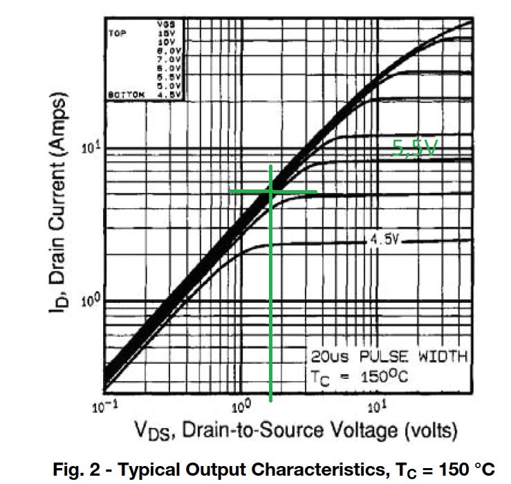

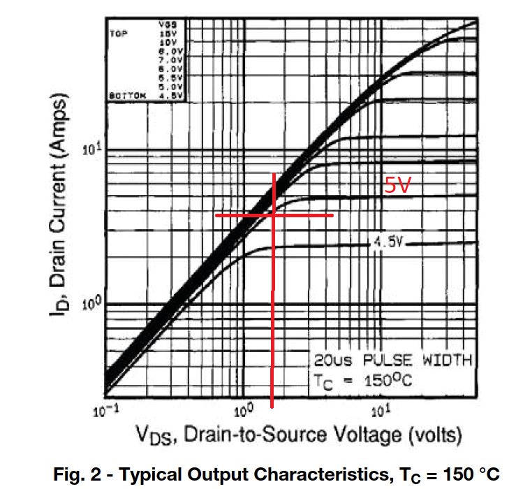

Hi
so at Q1 is following:
i have about 4,8V Vgs and a current of about 1,6A. if i look at the datasheet at 150°C and not the diagram with 25°C i can estimate that? pic with red
should it not be better to have much more Vgs to be in the linear area? 2nd pic green
thank you for your help again

chermann,
The horizontal axis is Vds. Assuming your V+ is 19V, Vds of Q1 is approximately half of 19V, so you are in the linear region. You show Vds of less than 2V on your charts.
Also 150C is most likely not representative of the temperature of Q1. Your Vgs is higher due to the actual temperature of Q1 which I assume to be much lower than 150C.
