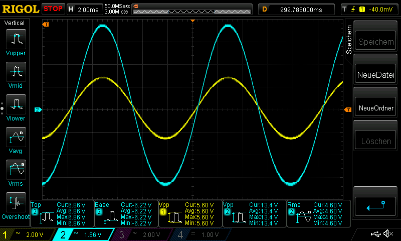

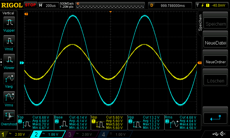

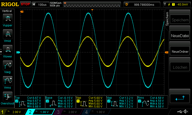

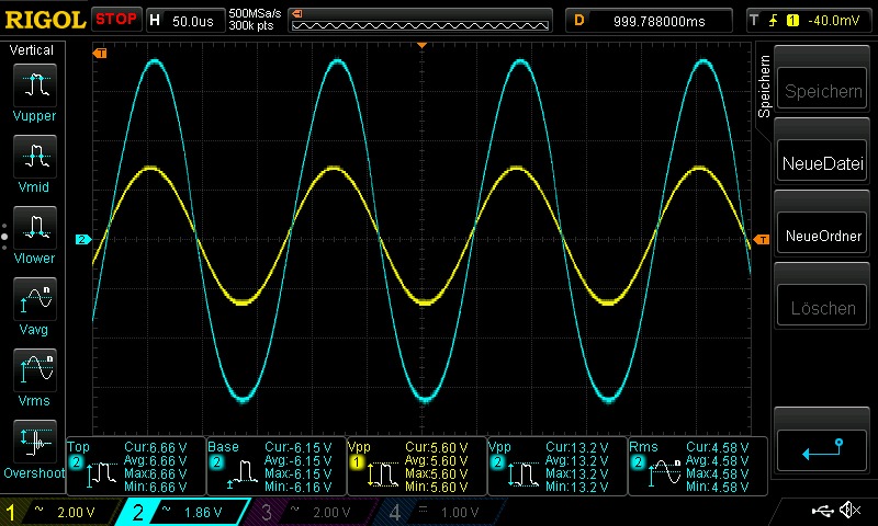

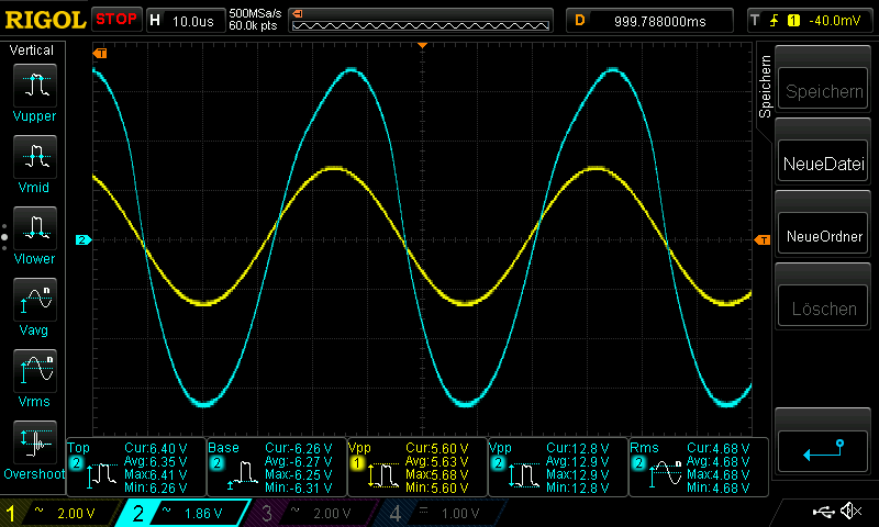

last days i enjoy sounding my new speakers "Nada" and my other amps and for sure the ACA.
i miss a bit the deepness and separation in the middle and its partly "foggy" compared to my other amps.

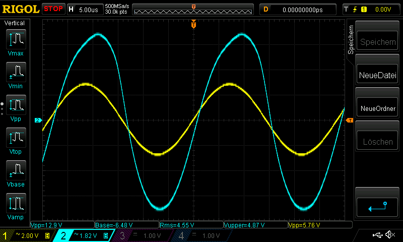

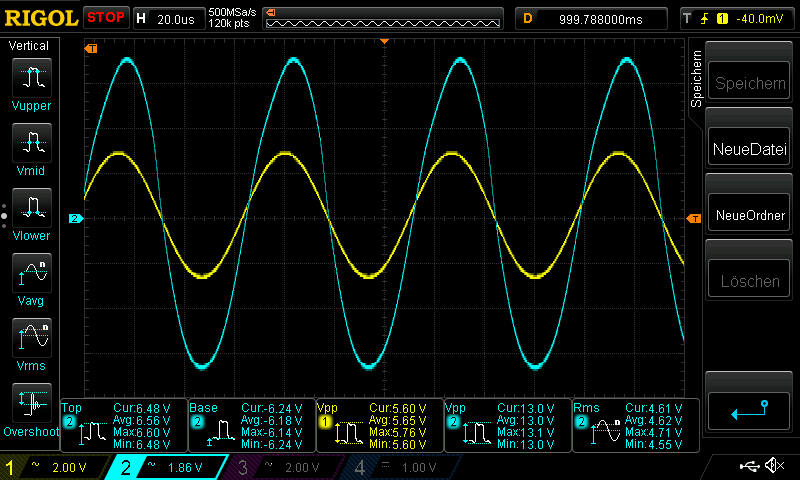

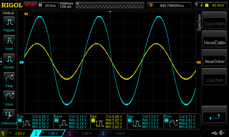

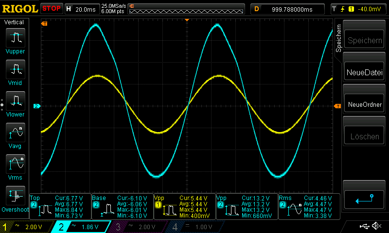

i tried the NFB resistor (R12) to get 39k but with my 81k in parallel with 68k i got about 37k..Gain is about 2,5 and about 8,5dB. i just want to listening and try out something.i have still the topic with the unsymmetrical output. with my 4R speakers i have to go up to 24V to avoid some clipping at some peaks. after setting the DC bias to 9,1V each i get best result on "symmetry" i can have with this setup. (BC550C Q3, and K30A as JFET)
sound is better...separation and dynamic improvement. i think i got at the unsymmetrical setup often then i thought a soft clipping.
problem here is that with DC bias at 9,1V the Q1 have to waste about 15V and 1,6A and it gets very hot without signal....90°C...during playing its better but during compare with other amps its not a nice feeling that Q1 is getting ..*x(! ..hot
here are the Frequency response curves with 1,910Vrms input and max output before clipping. still a bit un-symmetric but its the best i can have. both channel have the same behavior.
pic 1-9
10Hz, 100Hz, 1khz, 3kHZ, 6khz, 12khz, 15khz, 21khz, 35khz
waiting for ZTX450 and as JFET i will get BF245B...hopefully better symmetrical adjustments possible
chris

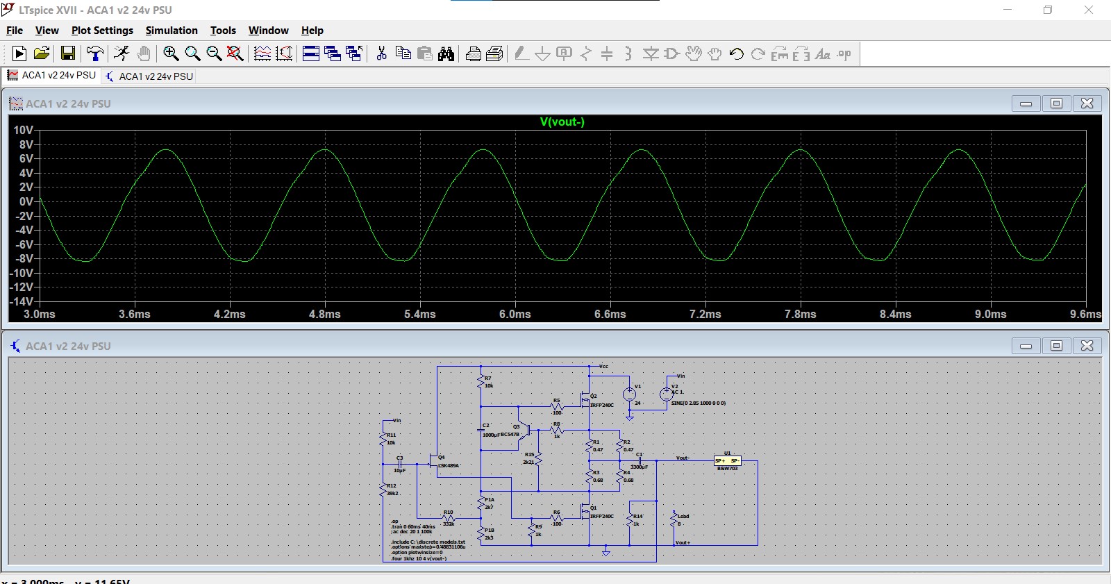

Reduce input amplitude by 50%.

@chermann - You are concerned by the gr grade you have. Measure Vgs of jfet to make sure it is less than +0.5V in the ACA. It will not be a large value even if negative for a 2sk30gr. The channel that shows early negative clipping may show Vgs of jfet close or even higher than +0.5V. In that case, it makes sense to replace it with higher Idss part.

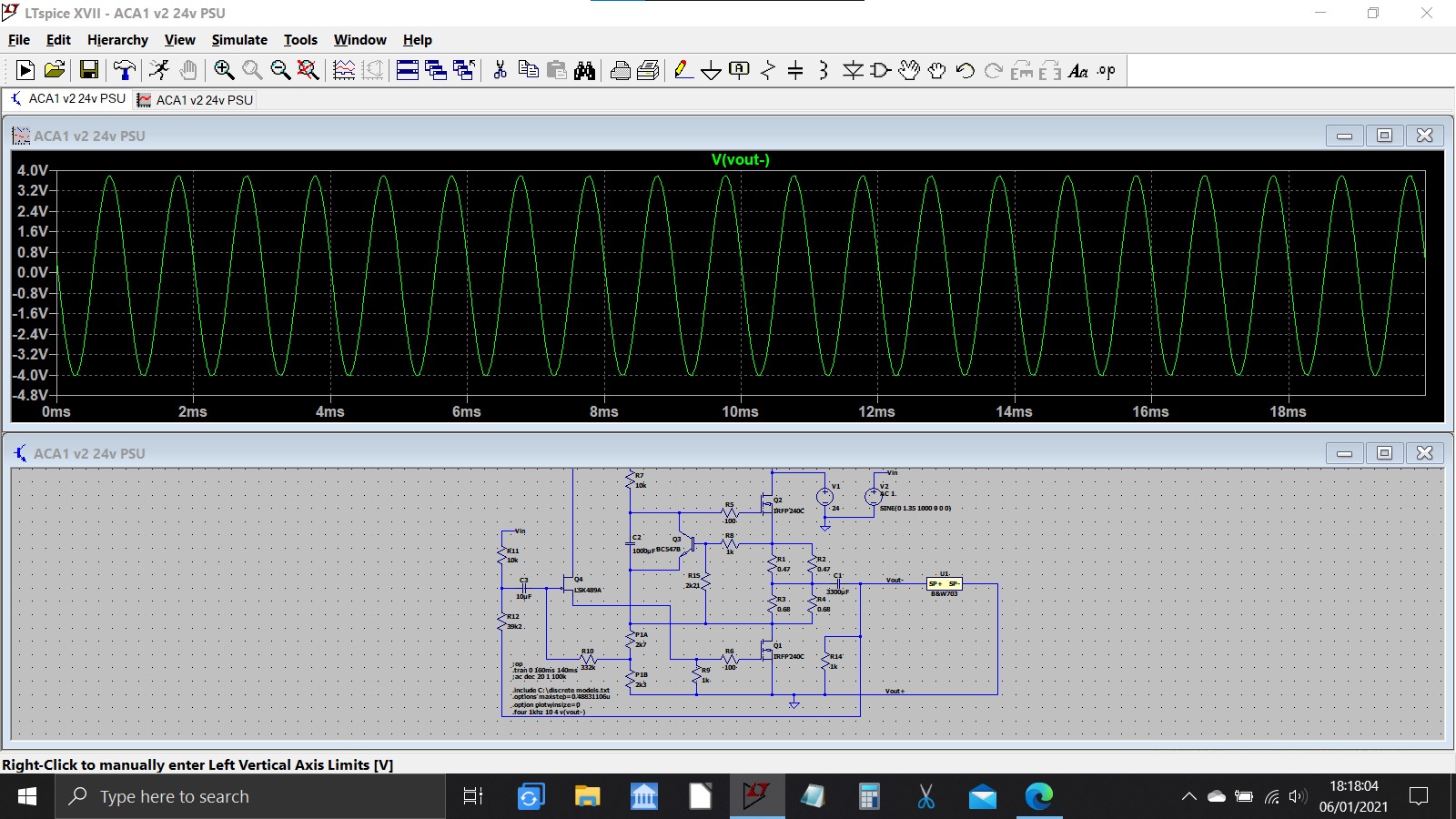

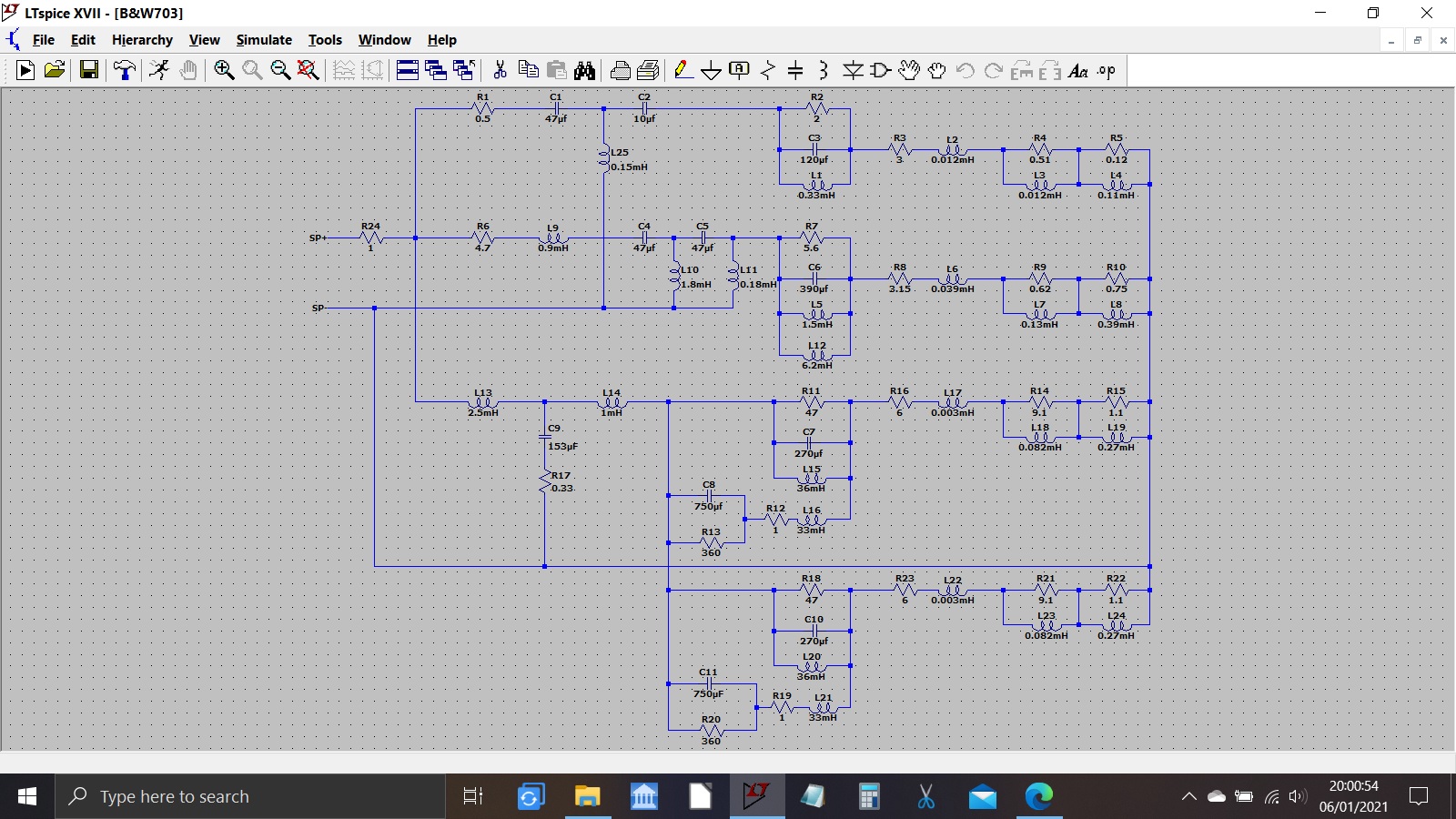

Dear Mooly, author of post #9402 showing impure sine wave simulation output when driving simulated B&W703 load model:
I think you will get different (better) looking output, if you reduce the input amplitude to your simulated amplifier, by 50%. Perhaps I think wrongly.
Hi indra1
thanks you for that information.
the problem with this clone pcb is that its really wiggly to get a measurement at the Jfet and the bipolar. its so closed together. i will try it.
just to be clear:
at scope you see the "bad" negative wave but its in real the other way round = inverted. so in real the negative wave is ok and the positive is "bad"
chris
