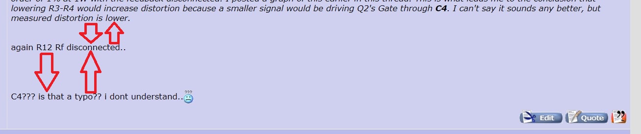

R8-R15 control the closed loop gain, a totally different thing.
As Nelson suggested in the ACA article, I connected a series of .1 ohm resistor to replace R1-R4 with a switch to select a tap and listened to the ACA with the feedback (R12) disconnected. That's how I know it changes the open loop gain. Furthermore I found that when R3-R4 is effectively 0.82 ohm and R1-R2 is effectively 0.15 ohm, (R15 needs to be adjusted to set the quiescent current) open loop distortion is greatly reduced, on the order of 1% at 1W with the feedback disconnected. I posted a graph of this earlier in this thread. This is what leads me to the conclusion that lowering R3-R4 would increase distortion because a smaller signal would be driving Q2's Gate through C4. I can't say it sounds any better, but measured distortion is lower.
again R12 Rf disconnected..
C4??? is that a typo?? i dont understand..😕

Removing R1 and R3 just cuts the 'standing' or bias current in half and so limits the amps ability to drive lower impedance lowers fully. It would run cooler of course.
Removing R12 does not remove all the feedback, it just removes a big chunk.
There is another feedback path effectively in parallel with R12 consisting of R10 and the variable and unknown quantity of the preset.

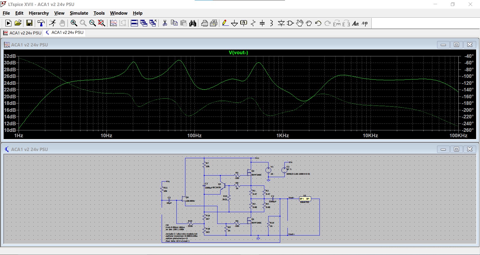

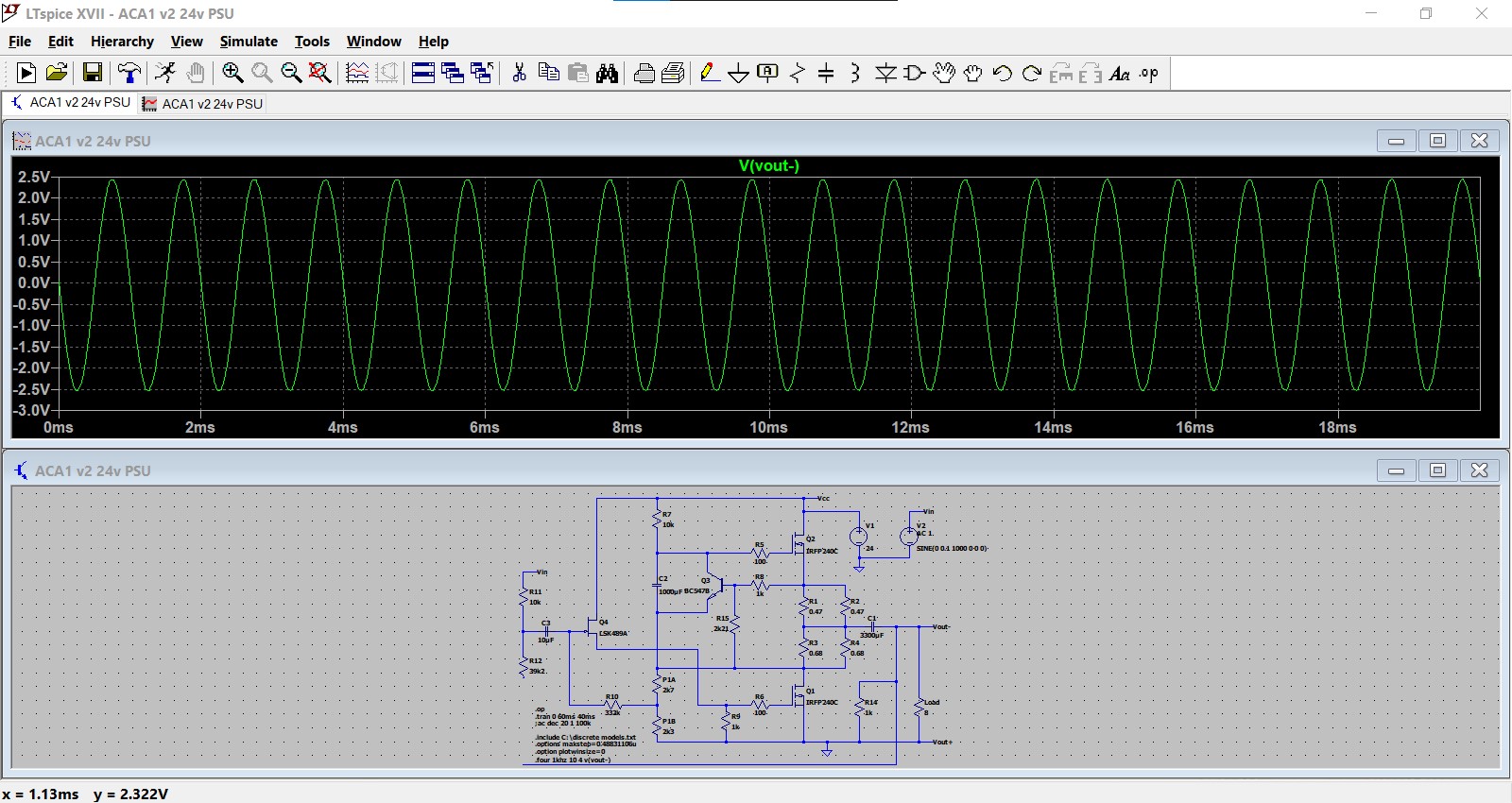

The gain with R12 removed jumps from around 11.3db (no load attached) to around 36db. I think the performance would be pretty shocking run like that because the open loop gain of the ACA is so low anyway that now you would find adding a normal load severely affects the output. Add a load like a real speaker (such as my B&W) and the response would be like looking at the Himalayas. It would be bad beyond belief like that.
In fact... this is how bad. This is with and without an 8 ohm load resistor. R12 removed.
Look at the difference in output amplitude as the load is removed. Now imagine a speaker that goes from say 3 ohms to perhaps 30 ohms over the audio bandwidth. The response would be awful.
So don't remove R12 😉

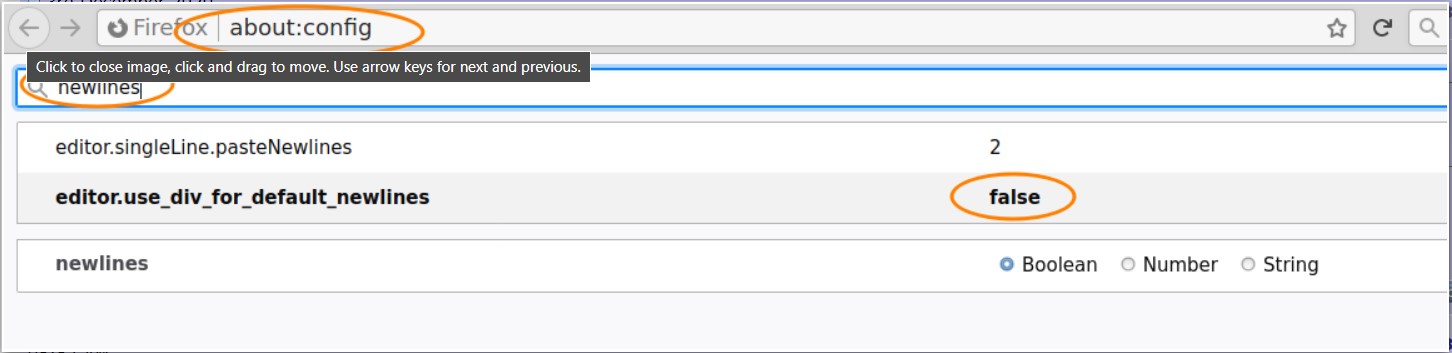

An easy one to start the day. Are you using Firefox? If so then try this to stop this.
yes you are right. its my setup...i am just have to find it where this setting exist

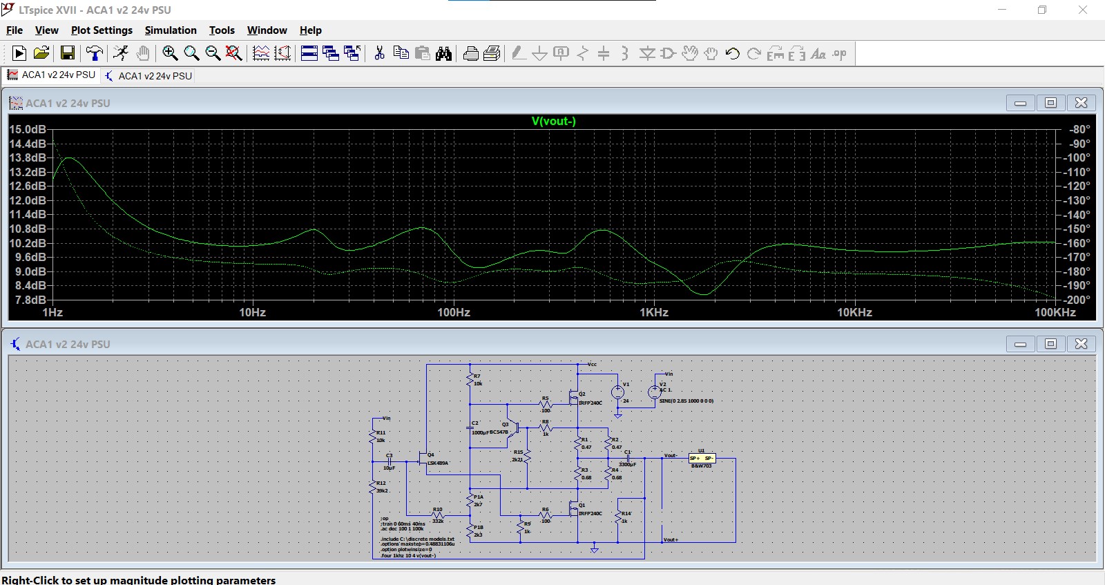

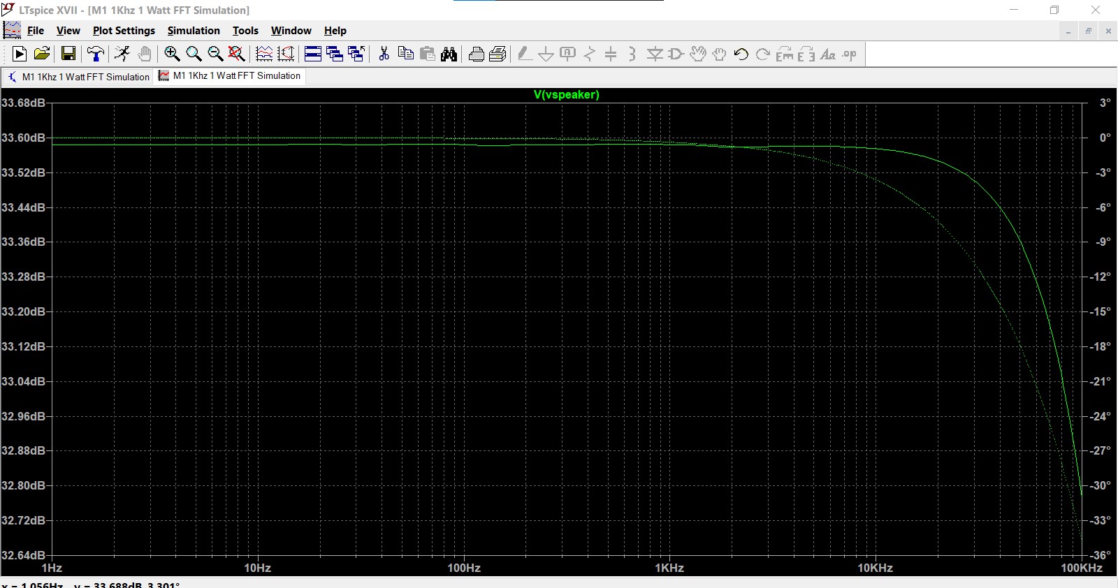

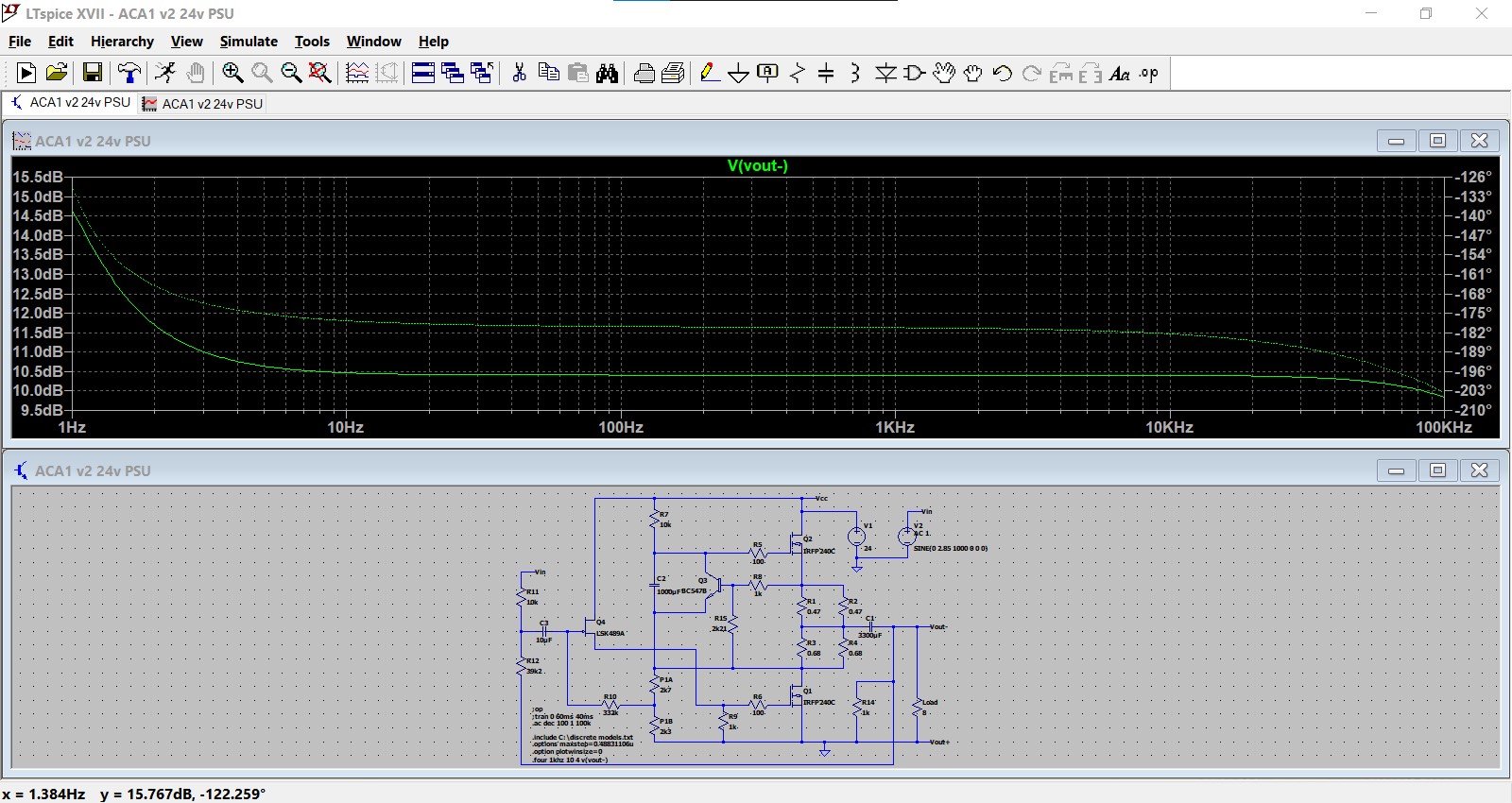

This really shows the effect. Four images, the first with an 8 ohm load, the second with the speaker load and 39k and then with the feedback removed. The final image is another amplifier (most solid state amps and chip amps are like this one) driving the speaker load.
You are looking at the output of the ACA vs frequency. The resistive load does not alter anything, the speaker load impedance pulls and pushes against the output giving the really uneven response seen.
So in part the high output impedance of the ACA, its low open loop gain and the fact that the output gets modified by the load is all part of its charm and gives it its unique qualities.
I'm afraid I don't where that lives as I use Edge but your line spacing has got noticed over many months. I think someone else has been following some of your posts and tweaking them (not me 😉)
Type about:config into the address bar (same place you type http://www....). Then search for newlineswhere this setting exist
