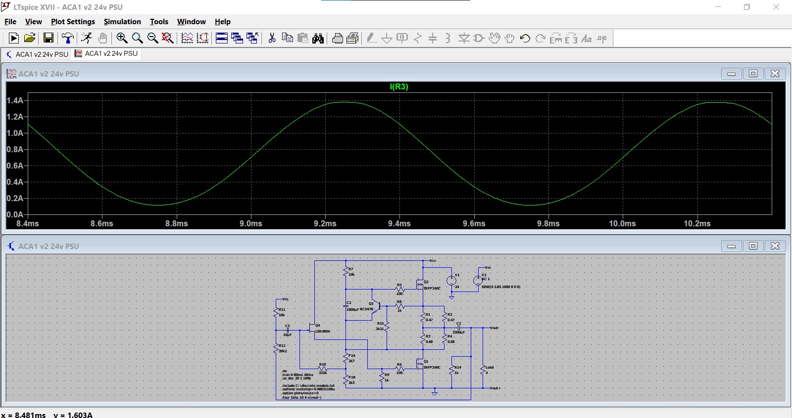

Why are the resistors so big in wattage terms then?
Well in the ACA the current in those resistors varies with signal and load impedance. Over a cycle of a sine wave the current can increase significantly over the steady state condition during the first 180 degrees and then it falls during the second 180 degrees.
This shows the current in one of the 0.68 ohm resistors under worst case conditions, a 4 ohm load and almost at clipping. The current actually approaches near to zero over the second half of the sign.
I'm not familiar with that one but yes, 0.5A in 1 ohm is just 0.25 watt dissipation as Zachik says.
Does that mean that momentarily the current would reach 1.4A (peak of the sine wave you're showing)?
So peak power would be 1.4*1.4*0.68 = 1.33W?
The only resistors I soldered to touch the PCB are the 0.47 ohms, so peak power would be 1.4*1.4*0.47 = 0.92W? I wonder if that is enough to warrant replacing the 0.47 ohms resistors? Leads were already clipped, so I cannot just heat the joint and pull gently to add air gap 🙁
Yes, but that is power at that exact moment in time. Once average out over time it is very much less.
The heat concern over these resistors shouldn't be an issue at all.
