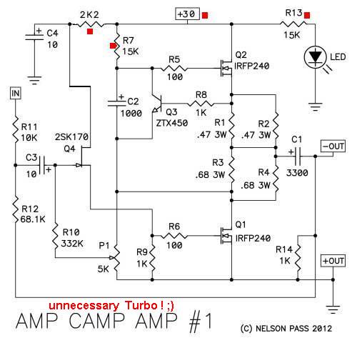

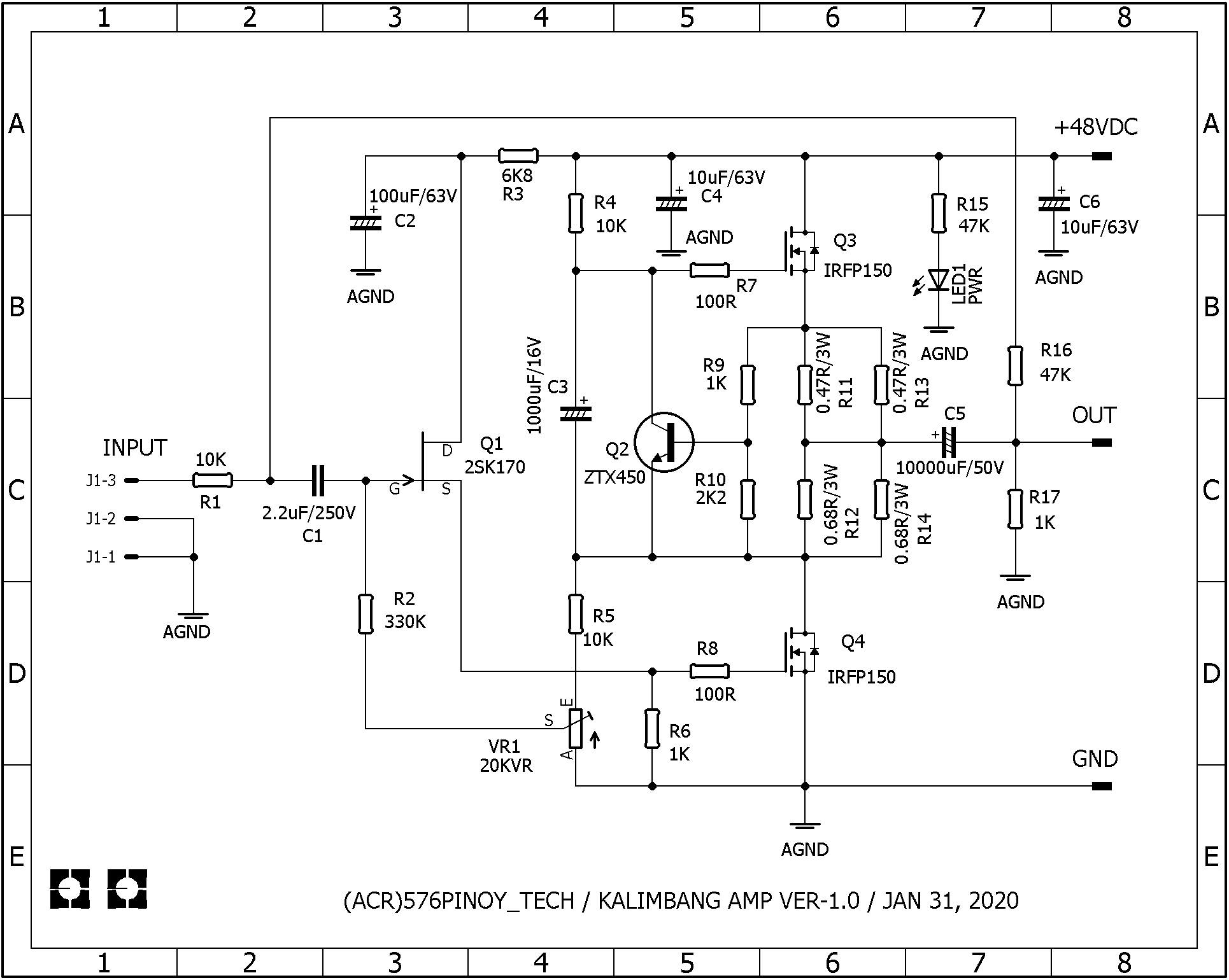

Hi Chris,
Below are the schematic diagrams of Tony Tecson's Big ACA and ZenMod's unnecessary Turbo ACA.
Instead of the diode on your PCB they have a resistor in series with the drain of Q4 so the drain voltage is reduced to a more comfortable level. To do that on the regular PCB one has to cut a trace and many people are hesitant to do such thing.
Also don't forget to add that capacitor at the node, I think it's missing on your PCB.
There are also one or two more resistors that need to be added / changed.
All in all an easy modification but it should be a subject of a different thread so not to confuse the builders of the regular ACA.
why is that small cap 10µF or in premium part 100µ so important?
sorry to be nooby...
Is that because of the pinch off mode of the N-JFET area?importatn at 48-v supply also at 24V volts?

if i looked at tonys schematic a can see the feedback RF = 47k so its about 11,5Db gain.
trimmer is changed from 5k to 20k + an additional resistor R5 10k...why is that here?

That cap together with the resistor (2.2k or 6.8k or whatever you need it to be) forms a LP filter that filters noise for the buffer stage (Q4)
The resistor also eats some voltage at the drain of Q4 and keeps its power dissipation down and the voltage through it at some manageable level.
Maybe ask Tony why he chose those values, re. trimmer and feedback.
