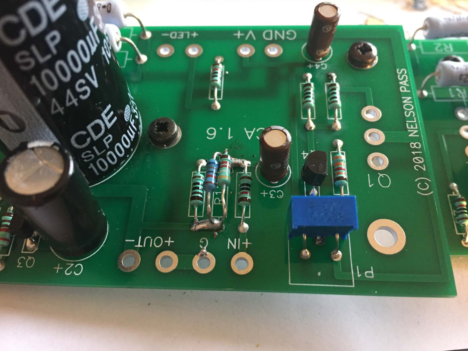

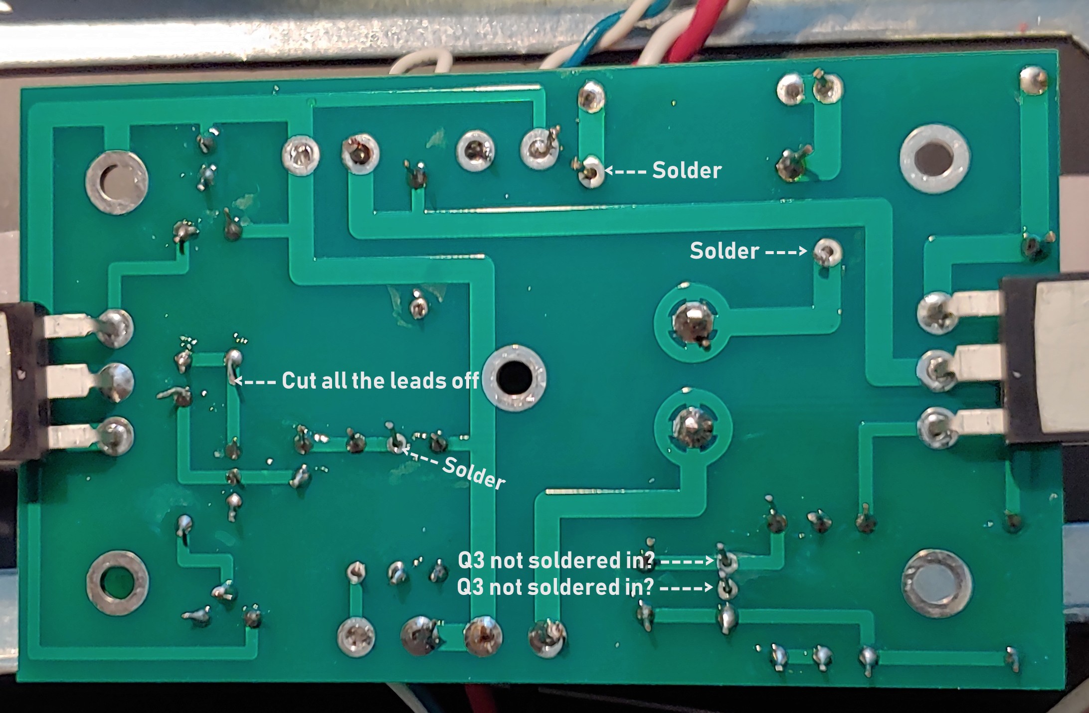

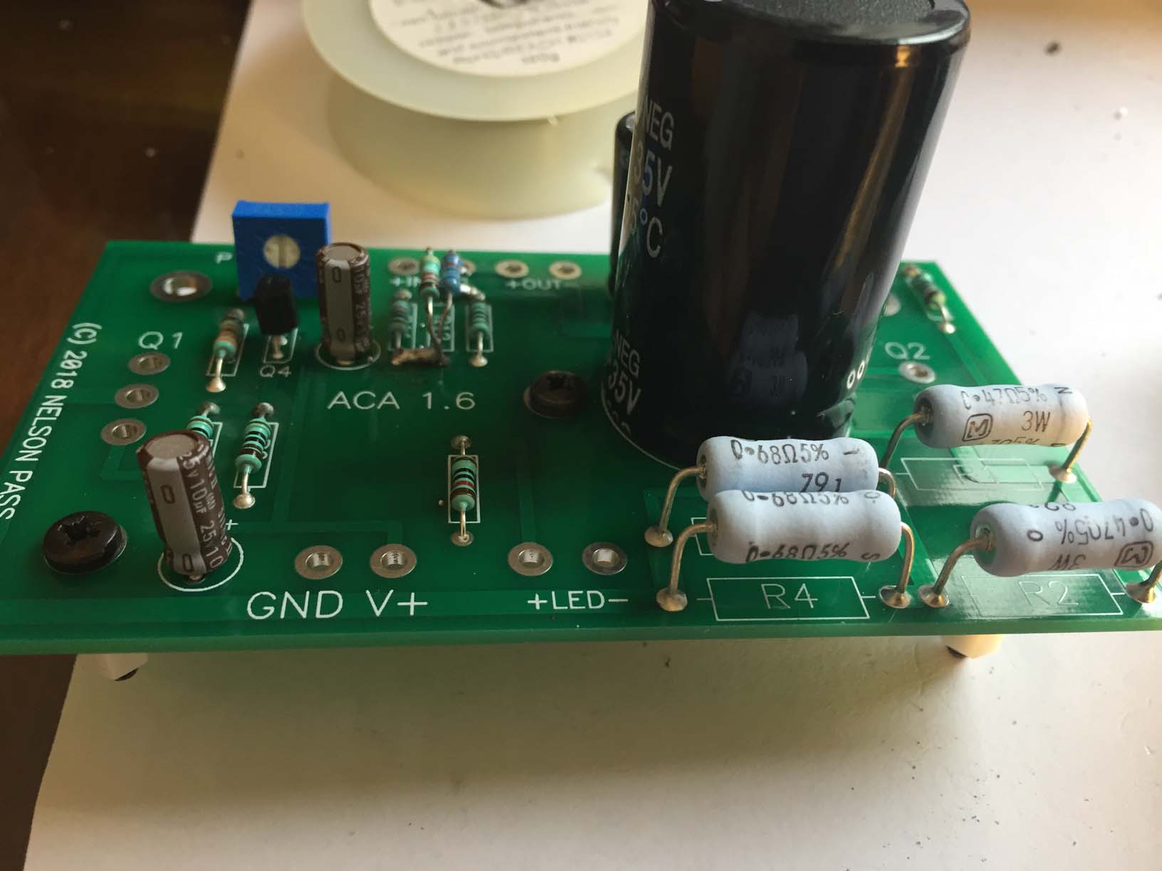

apparently no shorts to Q1 or Q2 on board #1
however r1, r2, r3 & r4 became extremely hot in short order when board powered up
You have to re do quite a lot under there I think.
As has already been posted, you need to re-flow some solder pads, solder in Q3 and trim the leads to a much shorter length. See how that goes first!

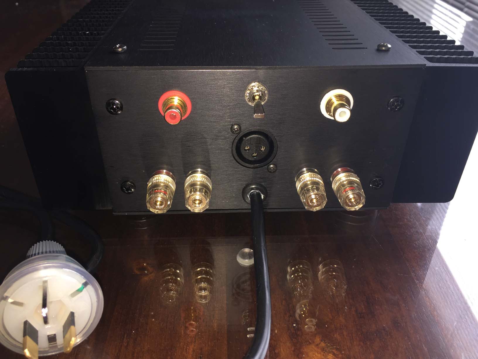

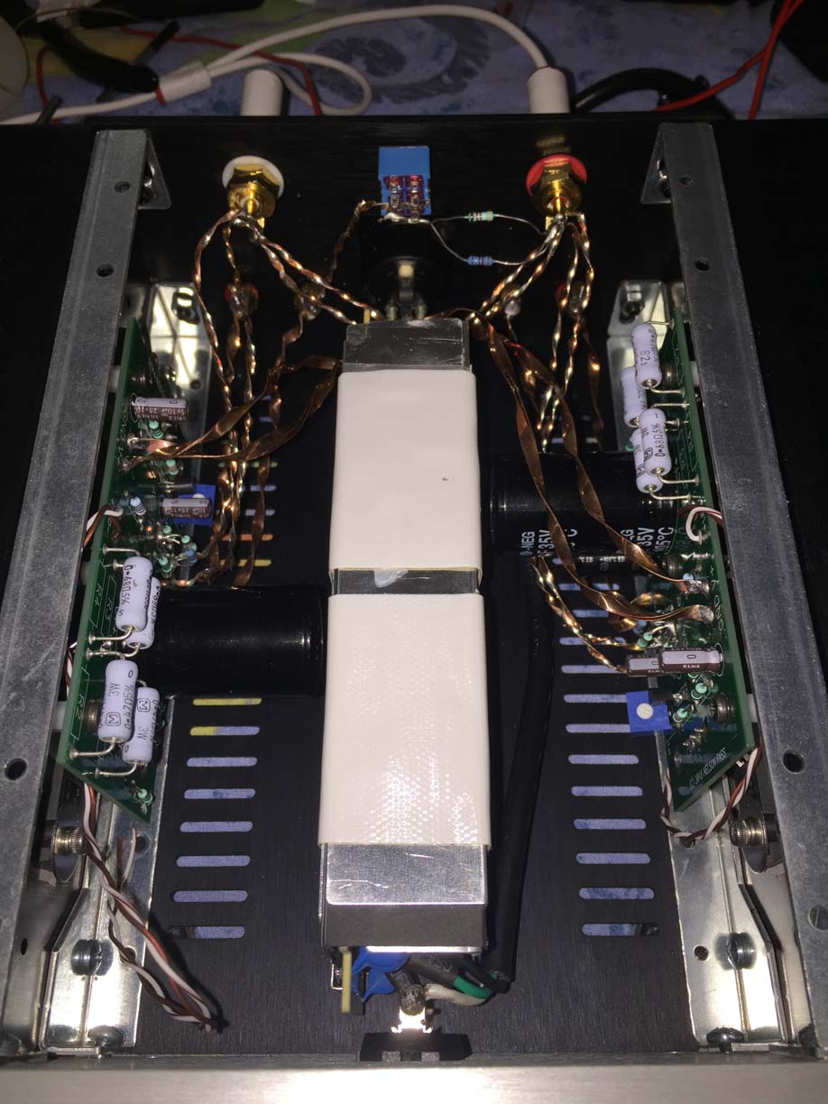

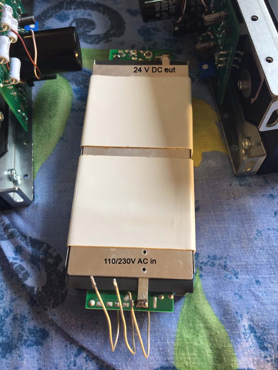

As a token of appreciation for this great kit and all the hard work that went into preparing everything required to offer it as a full kit, here are some photos of my build. The intention was to get the most out of this two gain stages, pure class A design.
WARNING - I do not recommend placing the SMPS inside the ACA to unexperienced DIY-ers. Please take this warning very seriously.

I set my DMM to 00.0mv it gave me 01.7 Right 01.5 Left. The probes are touching GND and V+. Are these correct?
Thank you.
Not exactly 🙂
The idea is to measure the applied AC signal and the AC output level using a DVM to try and see why one of your channels is quieter than the other.
First disconnect the speaker. Now connect just one input socket to your player/preamp because we are testing each channel separately.
1/ Set the meter to AC voltage.
2/ Connect the black lead of the meter to the Red speaker socket (which is ground on the ACA)
3/ Connect the red lead of the meter to the Black speaker socket.
4/ Play the tone and adjust the volume to give a reasonable output voltage on the channel under test. The ACA should be able to easily reach 6 volts rms so aim for that.
(Absolute value is unimportant because we are only comparing readings and also seeing if the gain works out correctly)
Write the result down.
5/ Now transfer the red meter lead to the 'input' side of R11. This is the end that goes to the input wiring and sockets.
6/ Without altering the volume write down the reading you see.
Those two results give you an output voltage and corresponding input voltage. From those two results we can confirm if the board is working correctly.
8/ Without altering any settings now swap the input to the other channel and repeat the test. You should be seeing similar readings of output voltage and input voltage on R11.
Lets see where yours falls down on this.

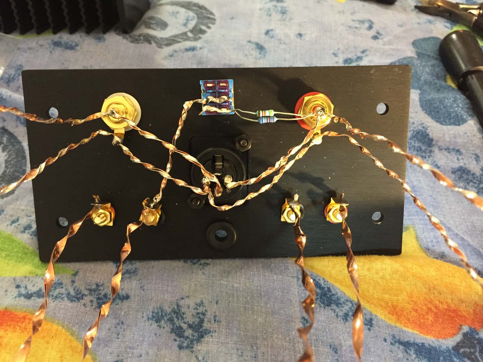

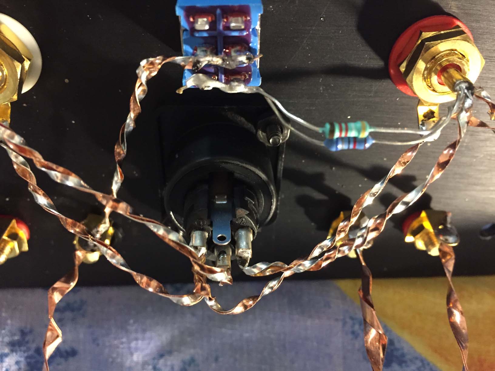

As I was building my second amp, I was mounting the rear panel connectors and couldn't remember exactly how to distribute the various insulators, lugs, washers and nuts. So I looked at my first build for reference. I noticed that on the RCA input connectors, I had the lug inserted next to the panel. That prompted me to examine the photos closely and that revealed that they should have been isolated by the insulators. I will probably unsolder them and re-do the order of the hardware, but I am wondering if it really matters if the ground of the RCA connectors are connected to the chassis.
Gary,
The grounds of the RCA connectors need to be isolated from the chassis. I would address that. Not addressing it could cause ground loop issues, etc...
Best,
Anand.
@Extreme_boky thanks for sharing pics. That’s an interesting choice of wiring. Are those copper ribbons enameled? With the smps in the chassis do notice any noise? I thought one of the added benefits of the outboard PSU was noise isolation.

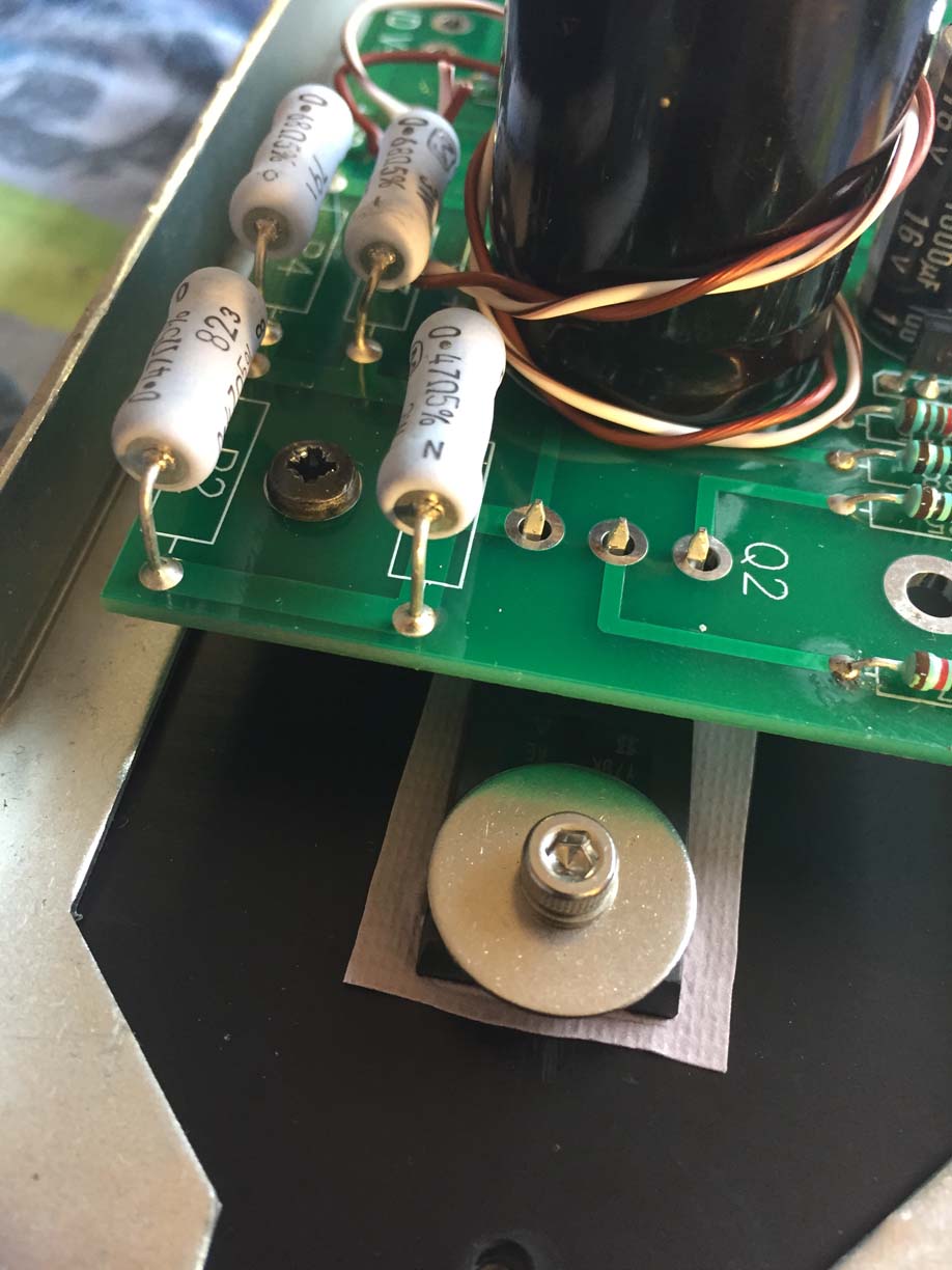

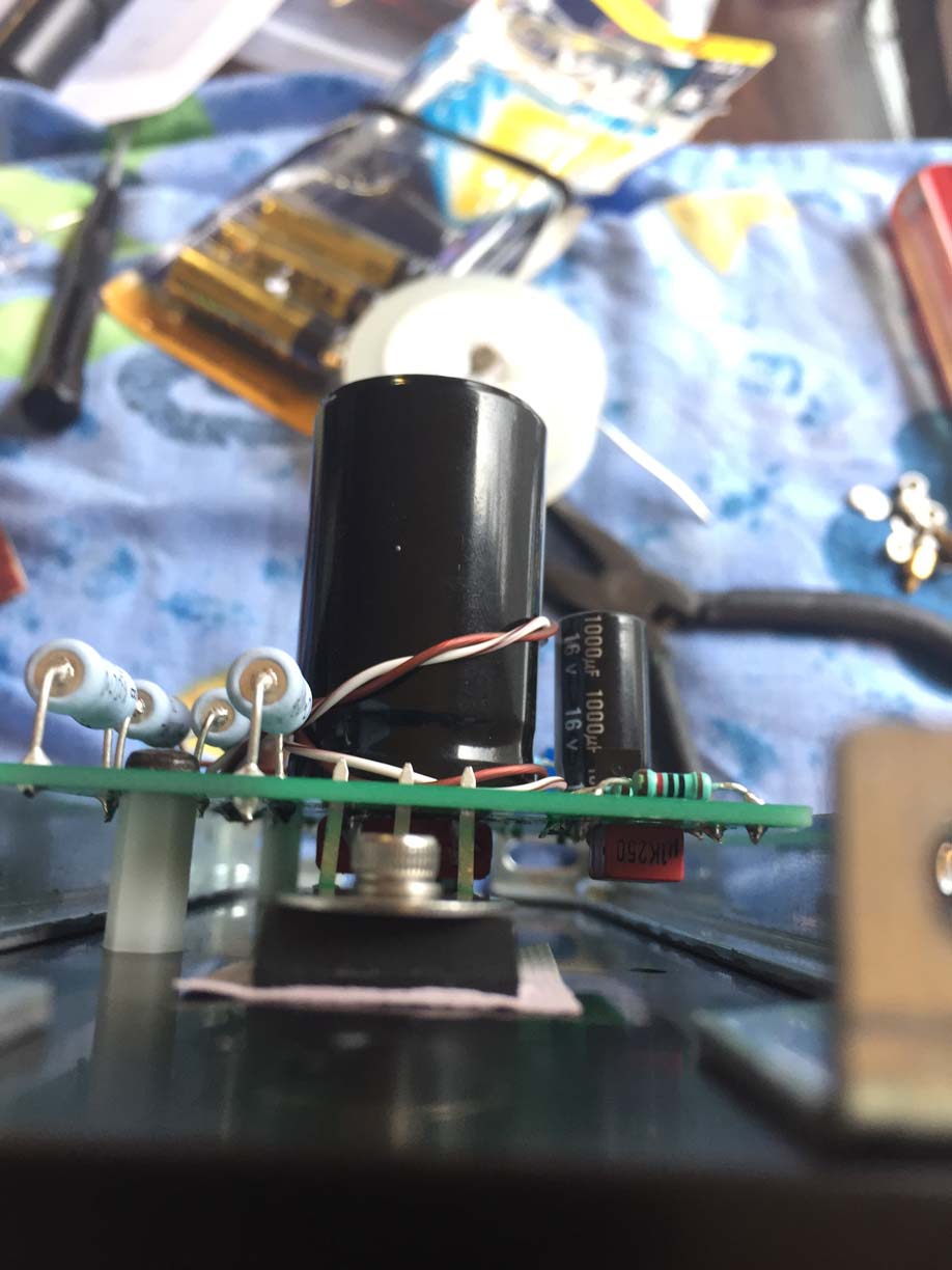

I notice you keep your resistors above the circuit board. Is there some benefit to doing so or is just so you will have extra lead if you have to re-solder them?
Hello again,
Ask Rafa why some stand off for the 3 W resistors is a good idea. A few pages back the subject of resistor heat dissipation came up.
As per ...
Any suggestions as to the minimum air gap and how to make it happen?
Maybe a spacer underneath the component during soldering that's easily removed or is it a case of bending the legs in a specific way? If the latter, feel free to offer up any tricks of the DIY trade.
Thanks .. 😉
Hi all, found this mounting guide for power resistors. Good luck with your Build.
http://www.rcdcomponents.com/rcd/pr...ines for RCD Leaded Resistors & Inductors.pdf
