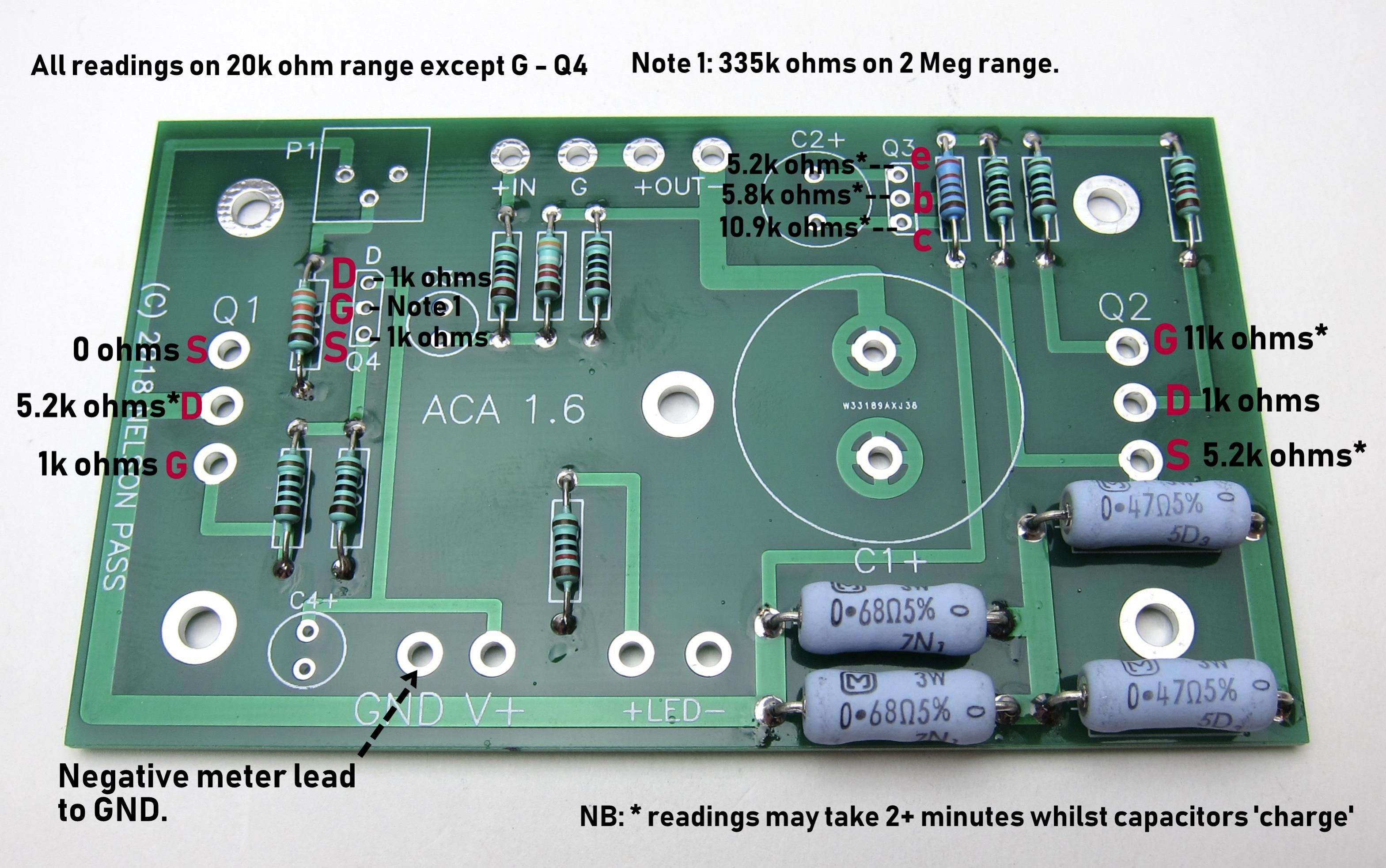

Boyz , for troubleshooting purposes , always include some measurements , information of exact schematic (few schm. iterations are there) to be sure about nomenclature , and few well made pictures
example of important measurement points , you can use it as general guide (parts nomenclature not by Papa's schematic!!):

Having a think here.
Seeing that a few problems arise on new builds and not every one reads a circuit diagram (no shame it that), I wonder if a simple 'No Power' resistance checker would be useful?
One; for checking for obvious faults before switching on for the first time when the assembled board is mounted in the heatsinks and
Two; for first line checking of the active devices without the need to power up and measure voltages.
Something like this perhaps? Hope it fits in with Mr. Zen's needs too... ;-)
Alan
Should of added, the readings are a compilation of a couple of working ACA boards and 3 different digital meters, so 10% either way maybe.
