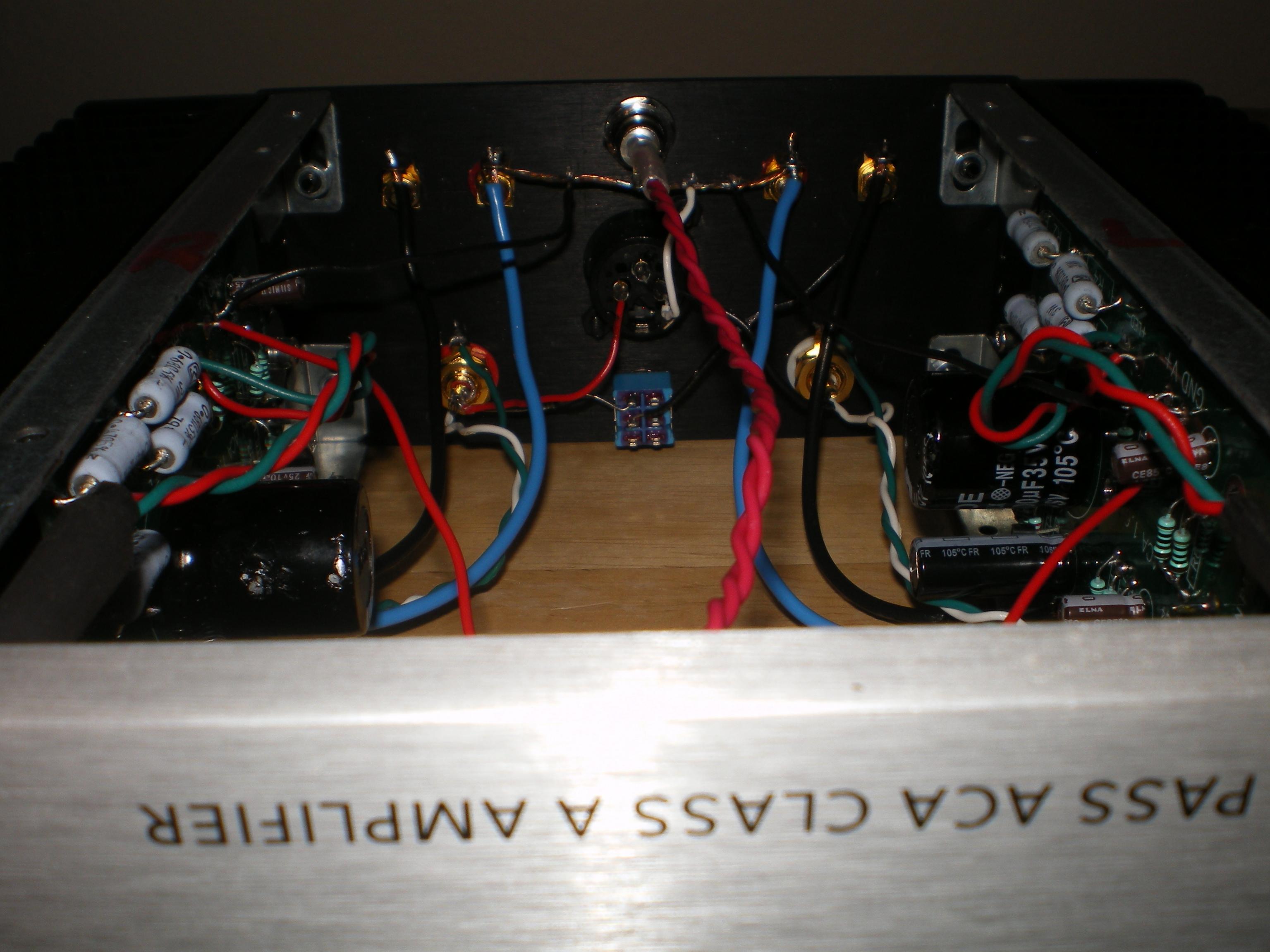

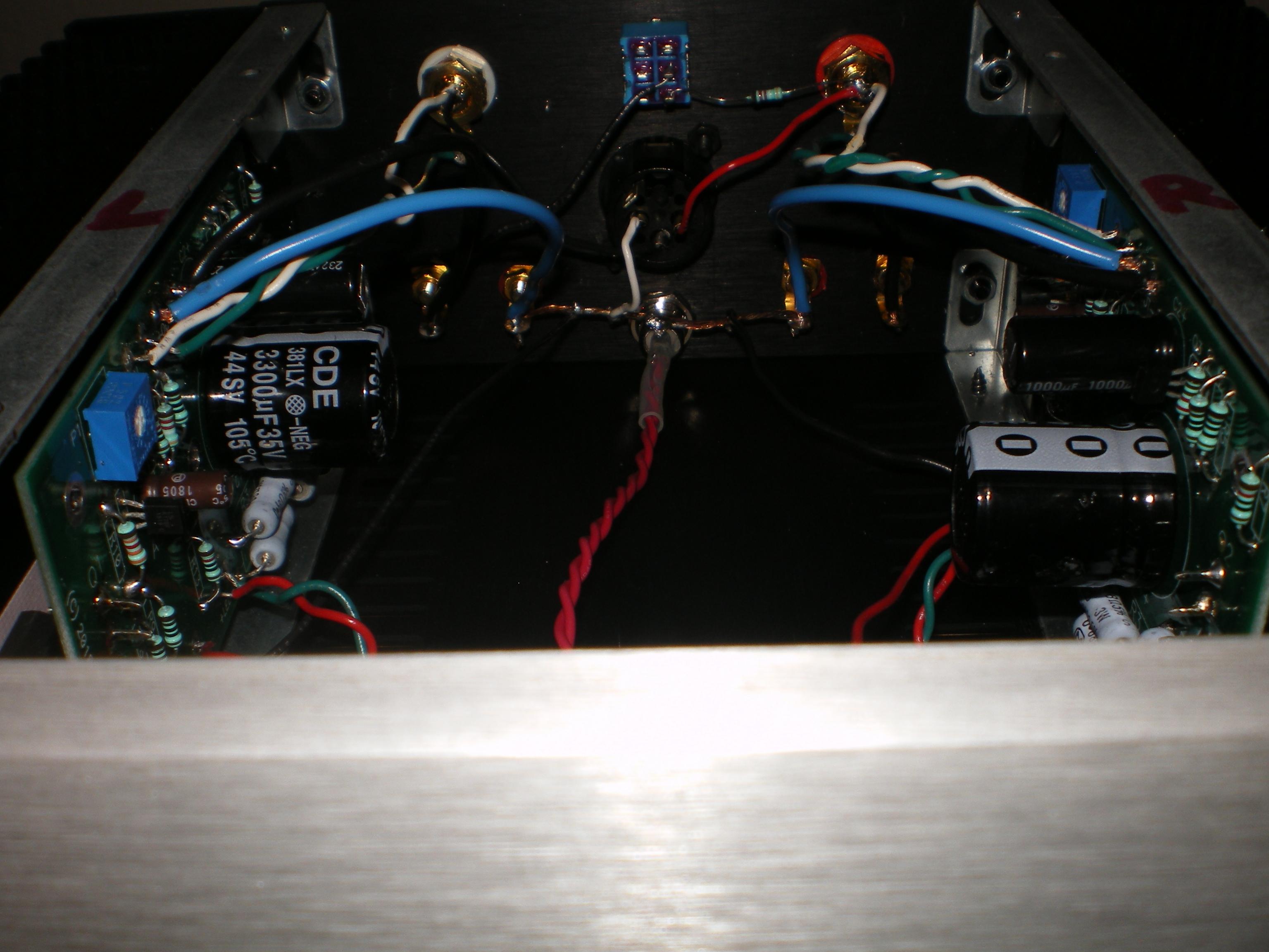

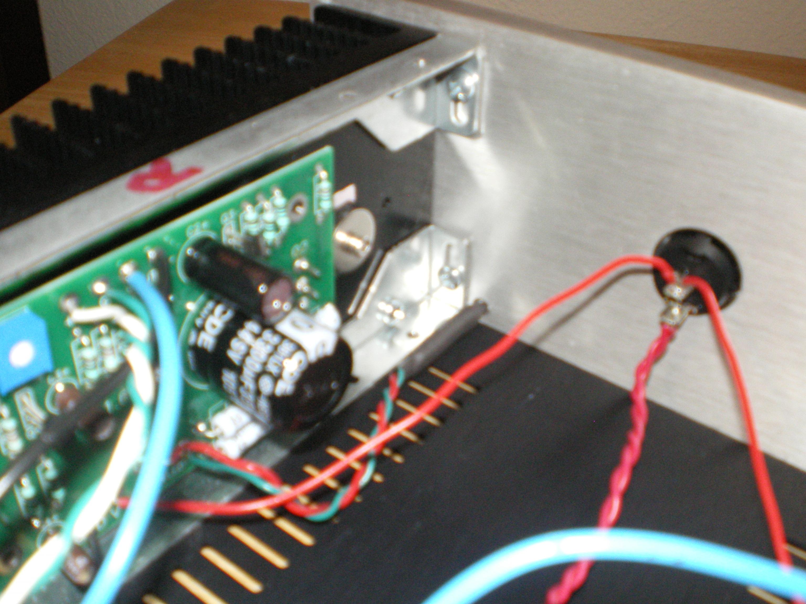

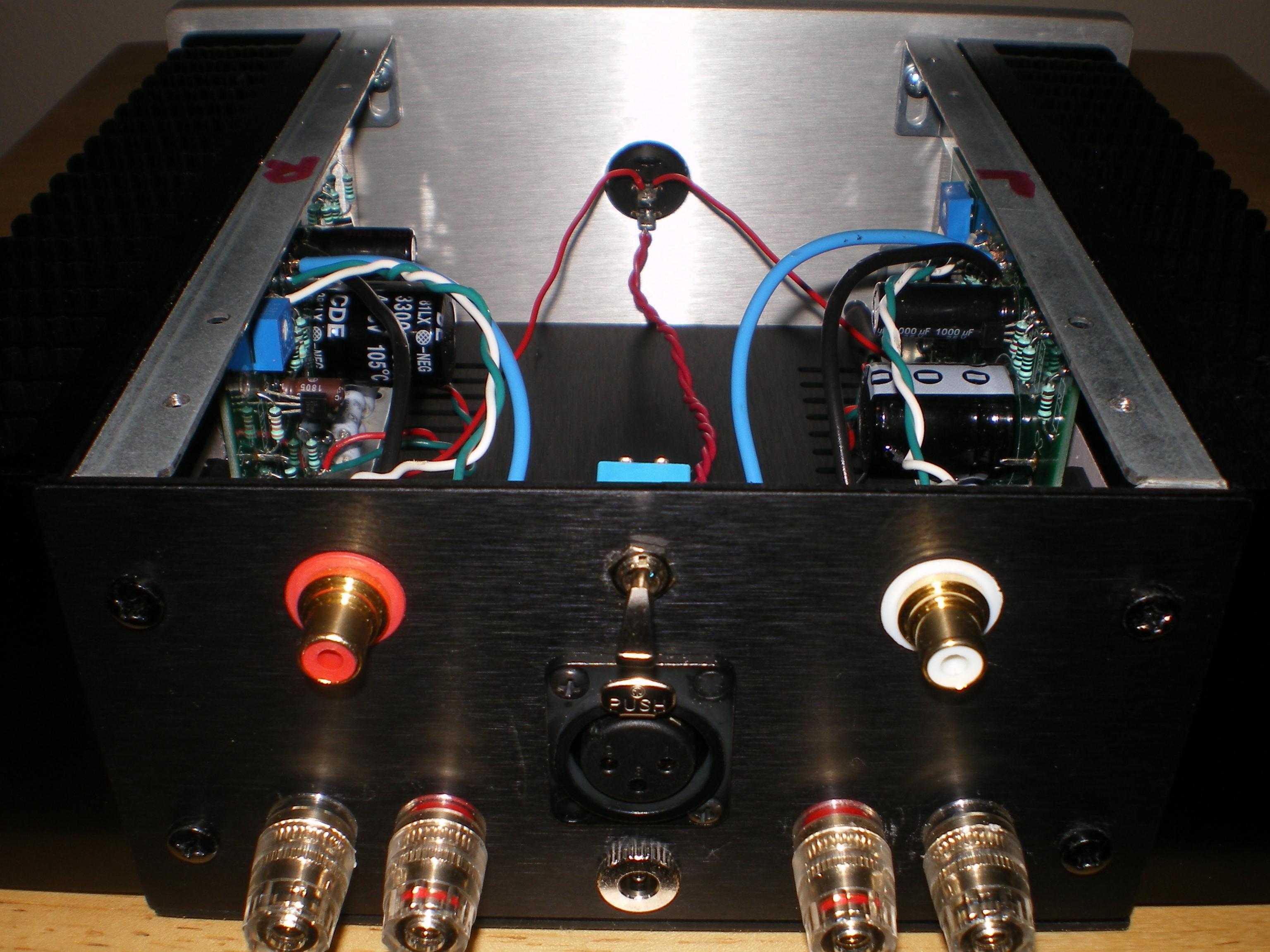

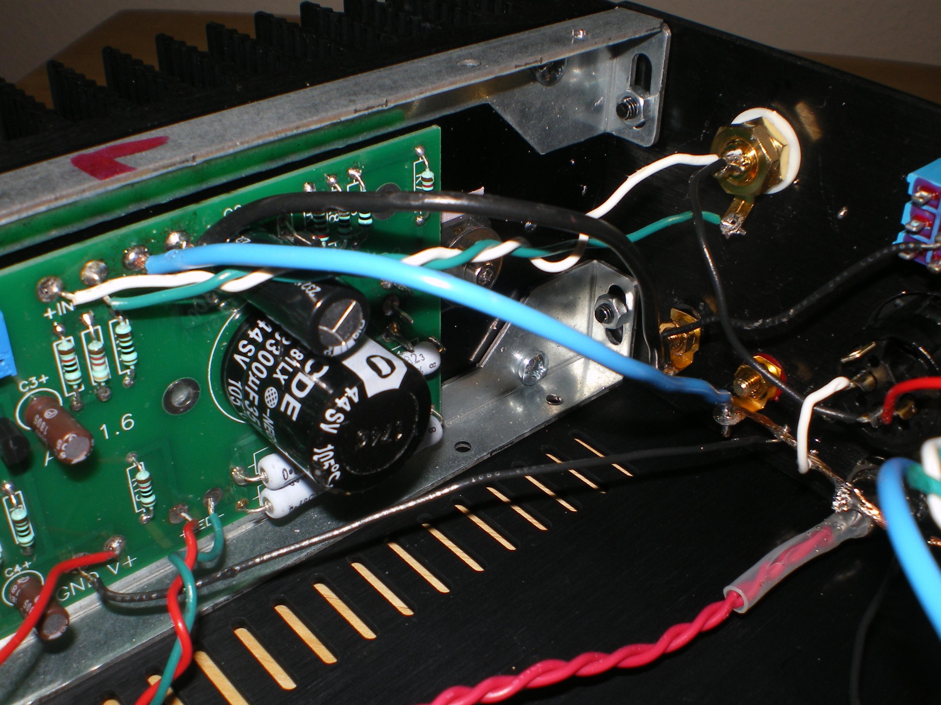

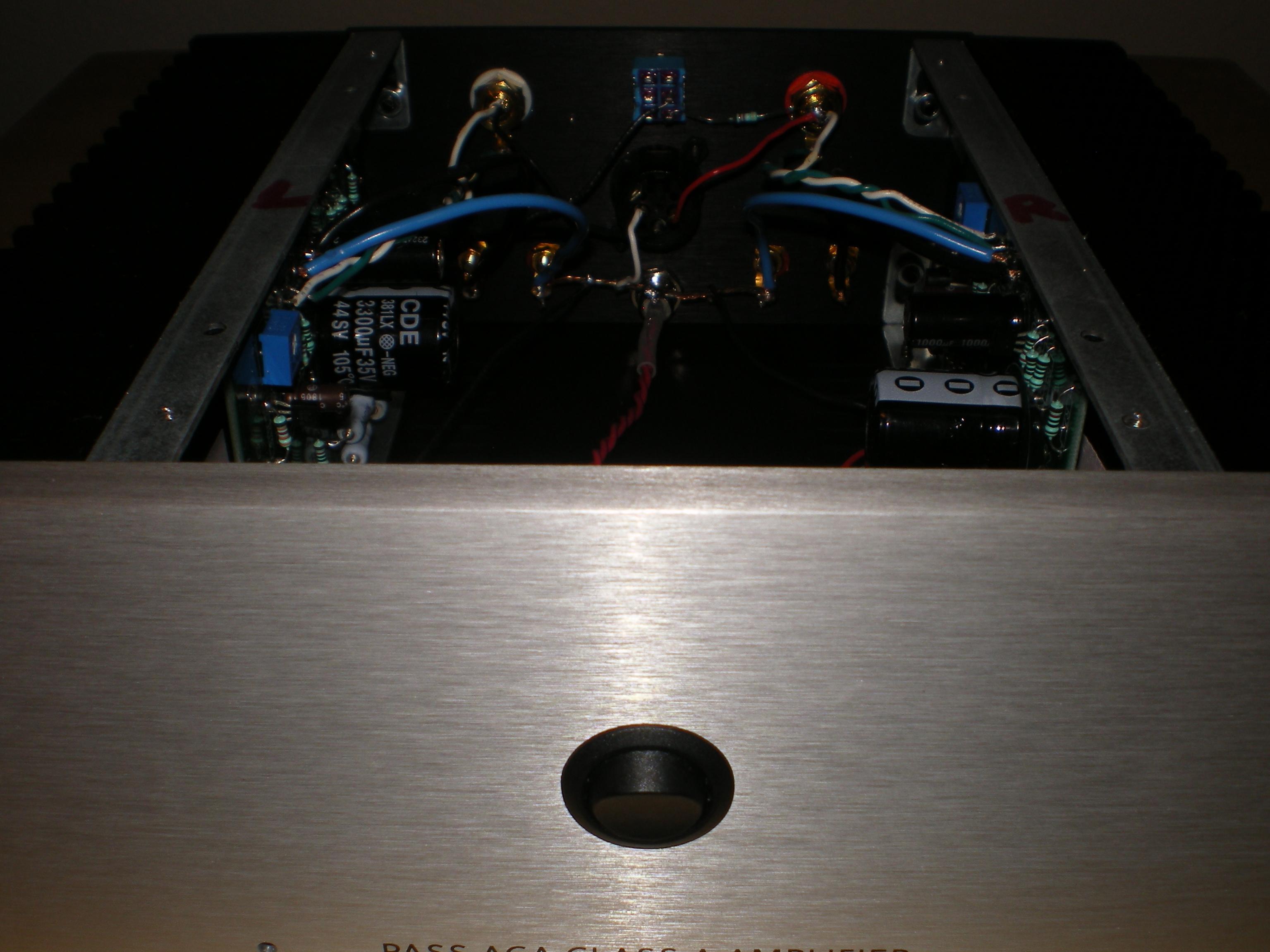

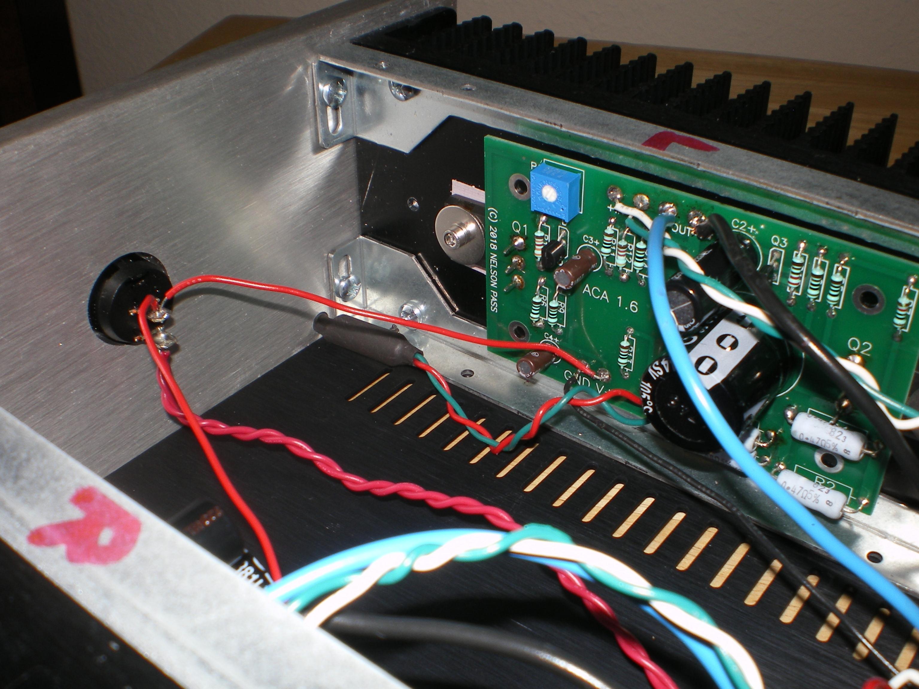

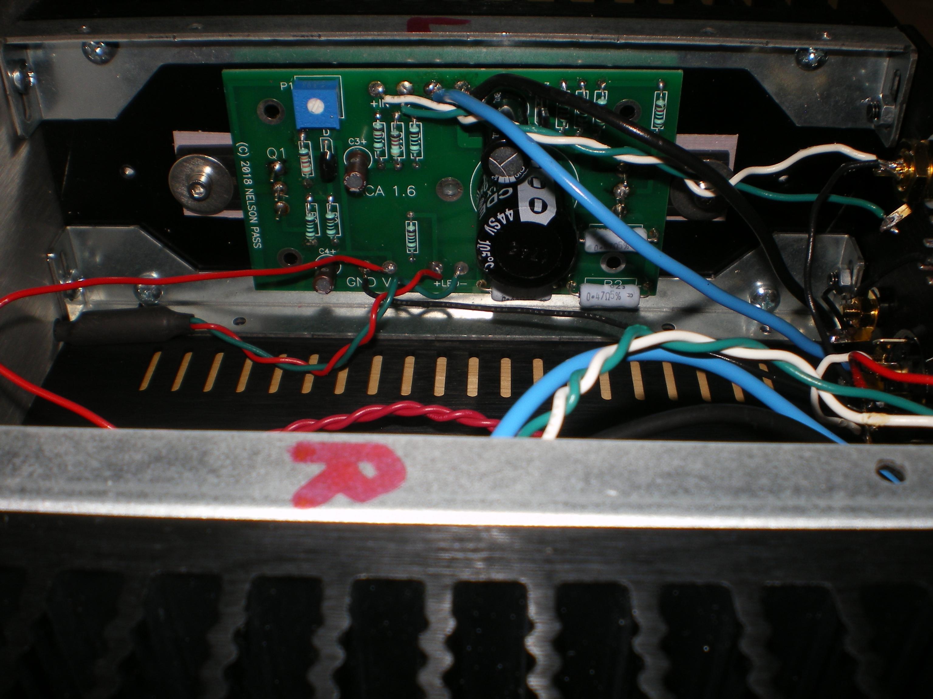

Rafa, Here are some pics: 🙂
I cannot spot anything obvious, I'm sure others will be of more help.
I have one question: are you able to see perpendicular into the PCBs to make sure that no cable or component leg is touching the heatsink from the non-component side? If one of those cables is too long it could be making contact with the heatsink.
That would be the first thing I would try to check.

Hard to see perpendicular, tried it, but I am sure no cables are in contact with heatsink.

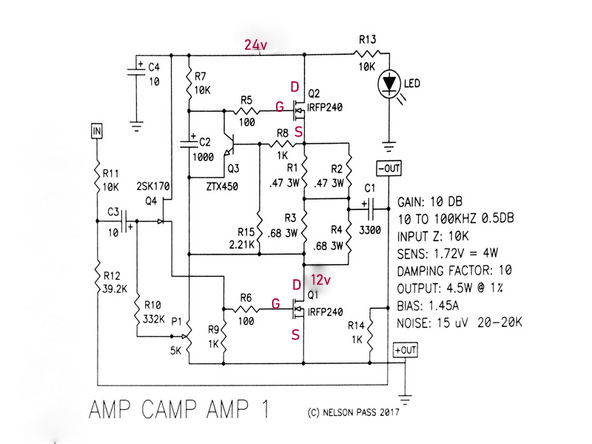

You need to connect the meters black lead to the main zero volt (ground point) which is that common 'bussbar' connection at the back of the amp.
Make sure your meter is on DC volts and check the supply voltage on the middle leg of Q2 which should be 24 volts.
You should also have 24 volts on one end of R7.

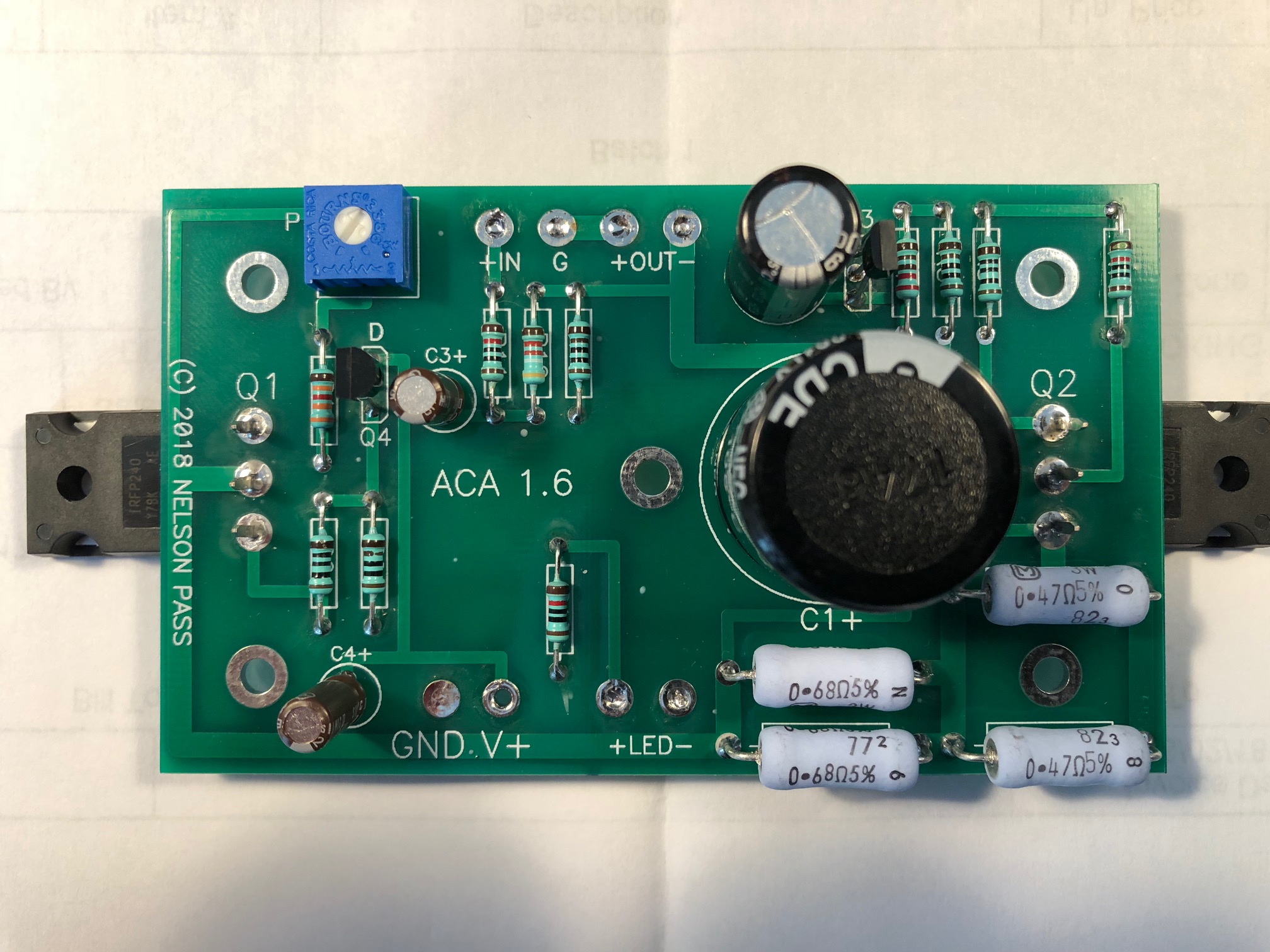

Problem with ACA 1.6: Q2 23.V, won't bias
Yesterday I finished my ACA 1.6, standard stereo configuration.
All went well, but when I hooked it up the right channel played much softer than the left. Tried some other speakers, same situation.
Now this morning I started trouble shooting, and found on the RHS board
- the center pin of Q2 reads 23.7V, whilst Q1 reads 12.04V after biasing
- Q2 stays on 23.7V, does not react to turning the potentiometer.
Can anyone give me some pointers where to look?
For full information, I first installed Q4 and Q3 the wrong way around (rushing...), took them off the boards and but them back the right way. Would damage to these transistors lead to the fault I am experiencing?
Thanks in advance,
Laurens

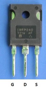

That is correct. The centre pin of Q2 (the Drain) is fixed to the +24 volt supply and cannot change.
The centre pin (Drain) of Q1 will change as you move the pot P1 and 12 volts is spot on.
Did you 'switch on' with Q3 and 4 the wrong way round?
Have you tried swapping left and right inputs as well yet?
Alan

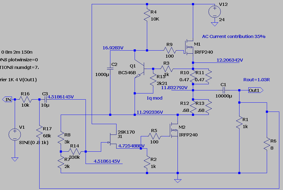

Boyz , for troubleshooting purposes , always include some measurements , information of exact schematic (few schm. iterations are there) to be sure about nomenclature , and few well made pictures
example of important measurement points , you can use it as general guide (parts nomenclature not by Papa's schematic!!):

check Q3 and Q4 for shorts, in situ
if suspect , desolder them , check bjt with diode test , JFet with simple Idss matching jig (9V battery)
If the two key DC conditions are correct... midpoint at approx. 12 volts DC and approximately 0.5 to 0.6 volts across each 0.68 ohm resistor then its possible you have an AC/gain issue. Check the resistors R10, 11 and 12 have been fitted correctly (correct values).

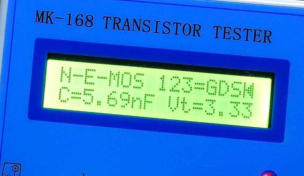

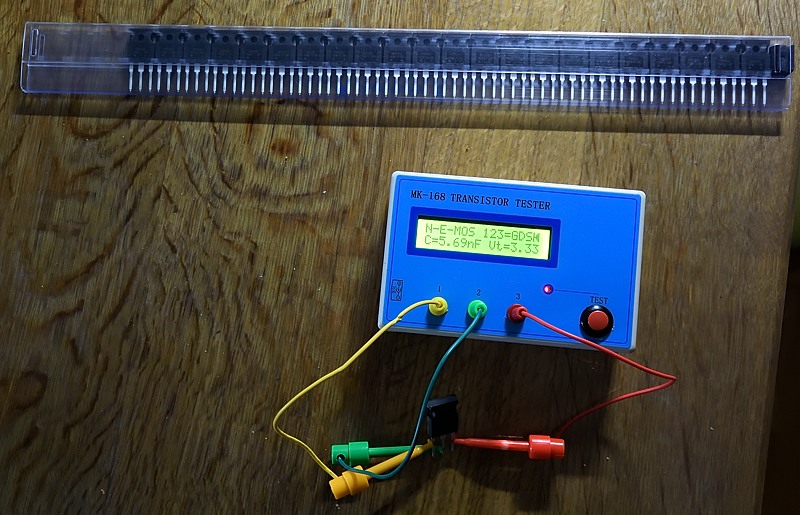

I think this little transistor tester is very useful for DIY people.
It automatic finds out which device it is (FET, Bipolar, Diode, Resistor, Capacitor etc.) and it does not matter how the wires are connected. It shows this in the display if the device is recognized. If the transistor is damaged it will be shown as "unknown or damaged" in the display.
In the example I test a IFRP250 (used for the MoFo). The display shows that it is a N type MOSFET. E is probably (Enhancement mode). Then it shows the Gate capacitance and the forward voltage to have it conducting (Vt). It also shows that wire 1 is G, 2 is D and 3 is S.
It is "made in China" so very cheap…….but useful and clever made I think. It is not for matching devices other than a very very raw match.

I measured 0.501V (DC) on R4 and 0.500 on R5, so it would seem the problem is on R10 / R11 or R12.
I will take both boards from the case so I can see what I am doing.
Thanks for all your help so far.
There is continuity between all pins on Q3 and Q4, so that would mean they are OK, right?
Hi Mooly,
0.5 volt across those resistors shows that around 1.5 amps in total is flowing. Just as it should be 🙂
It does sound like an AC gain issue at the moment. Make sure you haven't mixed those three resistors up in some way.

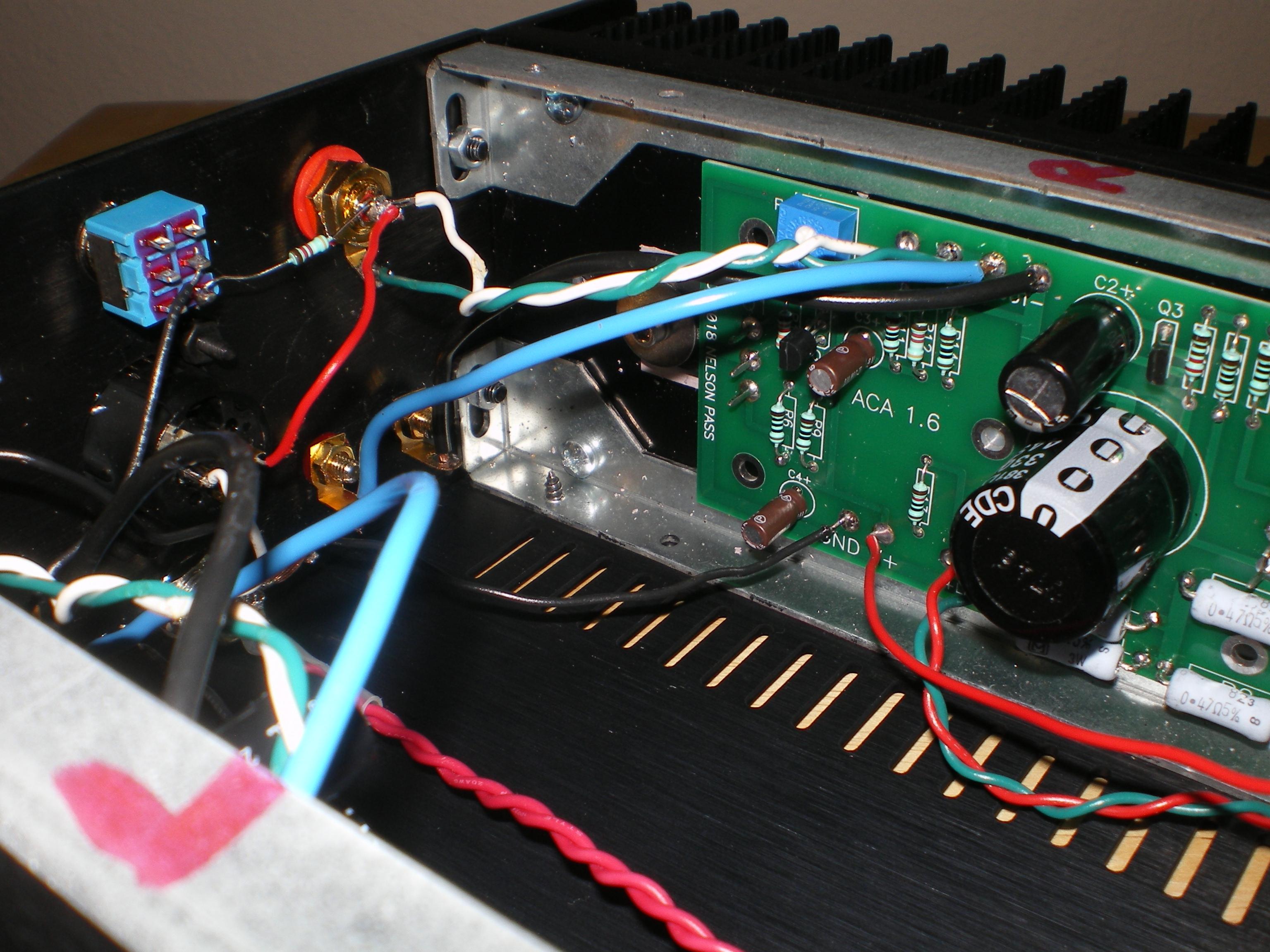

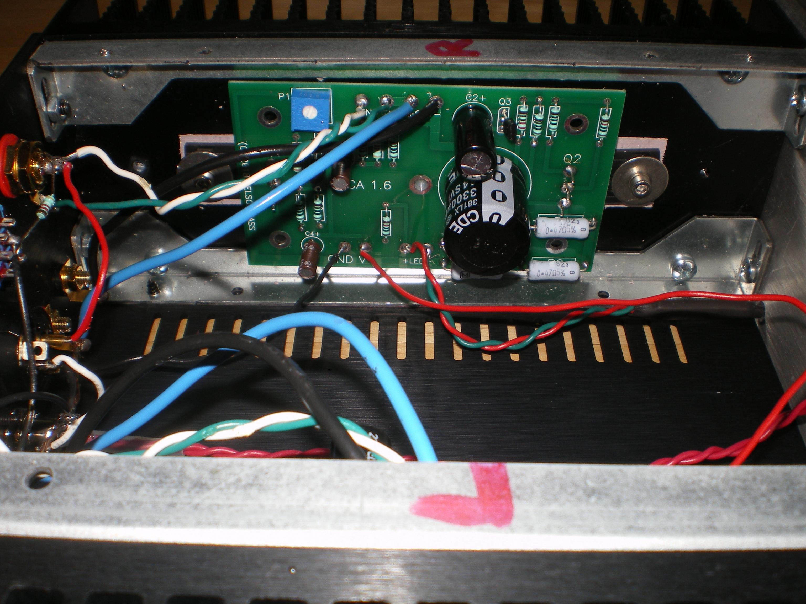

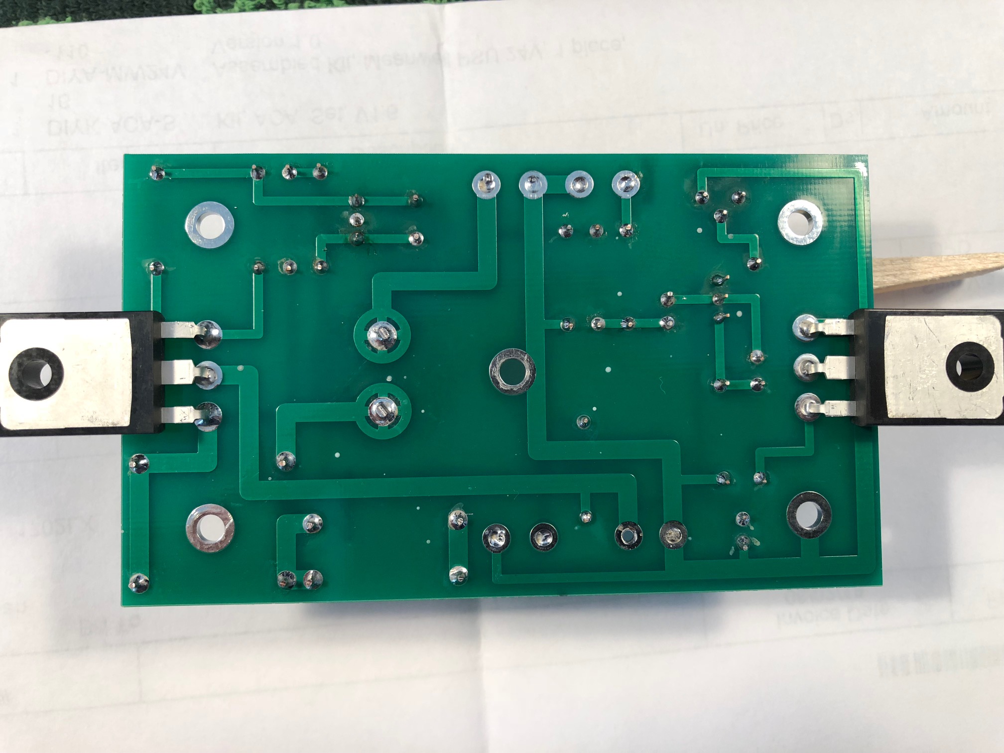

Ed,
Thanks for the pics. Do you use a temperature controlled soldering iron (just curious), do you have a wet sponge or tip cleaner?
I see a number of areas that I would be suspicious of cold joints, lack of solder and too much solder. Just because there is a lot of solder doesn’t mean it thoroughly spreads into the hole. I would strongly recommend desoldering braid and liquid flux and addressing those problematic areas. In addition I am suspicious of the solder points in the input/output connections.
In particular, resistors R1-R4, I see a few that are suspicious. Notice how your voltage readings there are problematic.
I haven’t checked to see that you have the correct resistors populated in the proper locations, I am assuming so, since your voltages around the input JFET (Q4) and around the ZTX transistor (Q3) seem to be correct.
Best,
Anand.

Did you wire the BACK stereo/mono switch? If so, did you try that in both positions? Normally, it stays down for stereo and up for mono. Not sure what that does to the right channel in mono, but that could be the cause of a weaker right channel???
BC,
All resistors, and Q3 and Q4 look correct. I am suspicious of a pin of Q1 that does not look shiny (pin closest to C4). I am also suspicious of the middle pin of Q2 (directly in series with R7). It also looks dull in the picture.
Add some flux if you can and resolder. Or reheat and resolder. Make sure your soldering iron is sufficiently hot if it is a temperature controlled type. I use 700 deg F or about 375 deg C.
