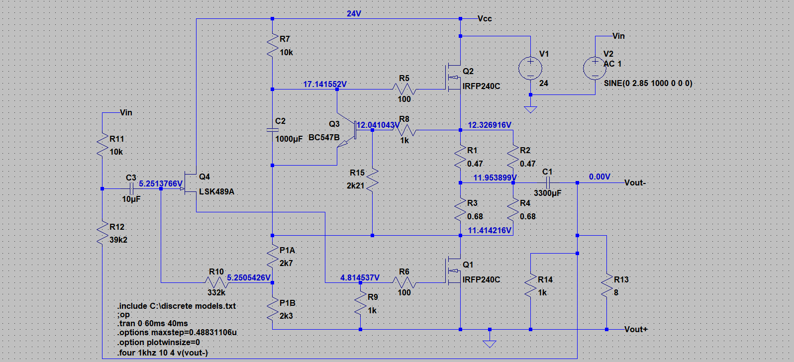

I’m ready to plug in 1.6. Please remind how to bias and what voltage to get it to. What setting do I use on multimeter. I know. Newbie
Use the DC Voltage setting, choose the next range up from what you are trying to measure - for instance, if it’s 12VDC, your meter may have a 20V range.
Place one meter probe on the chassis (or “ground”), and the other on the centre pin of Q1, the big transistor near the square blue potentiometer, just don’t slip and short anything out Adjust the potentiometer with a flat bladed screwdriver until you get to 12.0 volts (if using a 24vdc power supply). Be careful, the potentiometer is extremely sensitive to movement, and there is a time lag between moving it and getting a steady voltage reading. Turn the potentiometer just a VERY tiny bit at a time, then wait perhaps 30 seconds for it to settle before the next adjustment. The voltage reading may also change as the amp gets up to its normal operating temperature. Ensure final adjustments are done after the amp has warmed up for half an hour or so.

As always, do a DC voltage check at the various nodes. Something should show up and reveal a problem. Exact voltages will vary a little (and vary depending on where you have the bias set) but some major discrepancy should show if your FET's are cold.
(didn't you have this issue earlier and it mysteriously healed up ? and I suspected broken print somewhere)

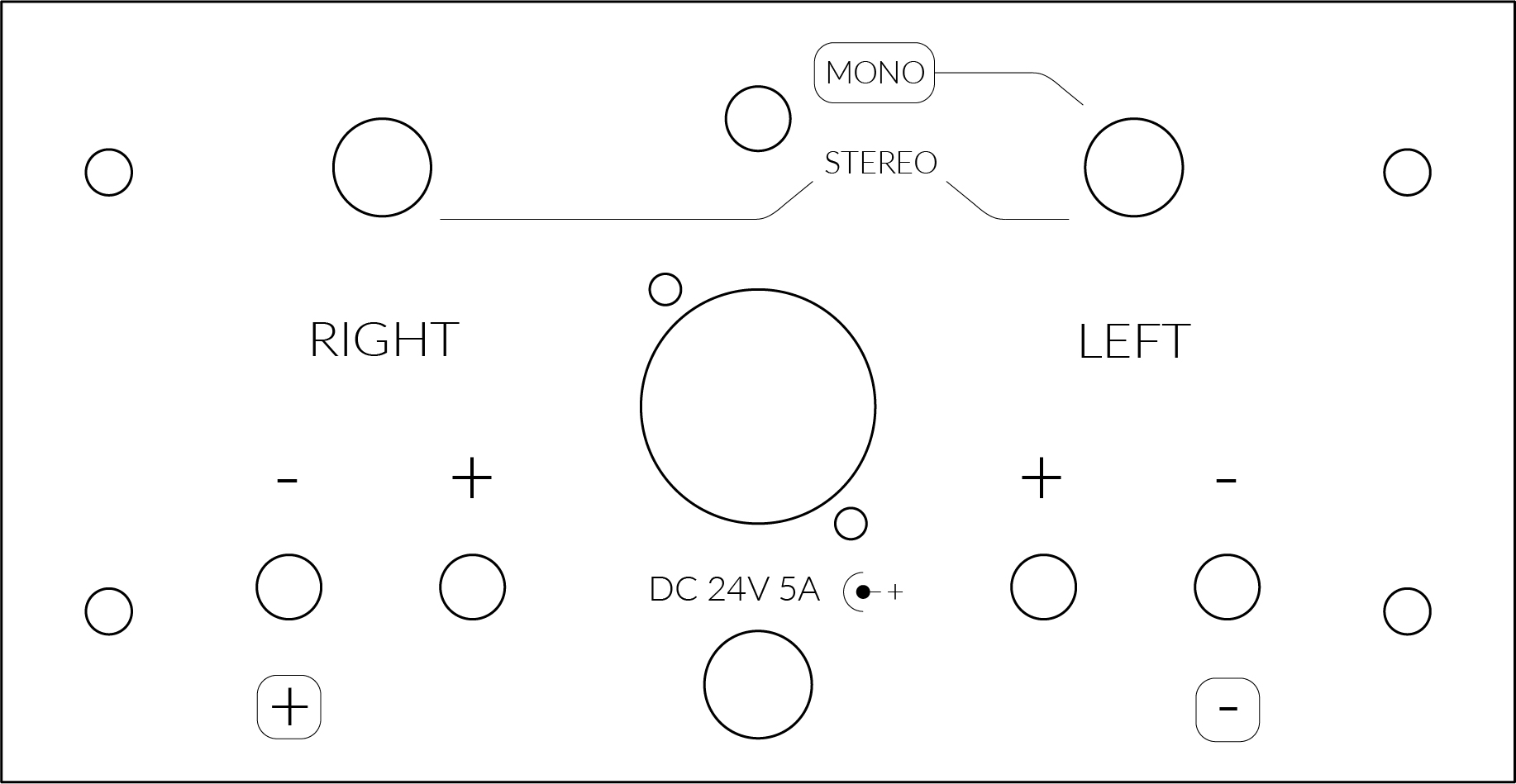

Finally I made some progress for the second version of the backpanel engravings. Adjustments were made with the help of you.
What do you think of it now?
I like it!
I like it a lot! Much cleaner and readable than the previous iteration. Looks great!...What do you think of it now?
May I ask why you moved away from the double-outline font? I like this one better, but I thought that was a requirement of the laser in order to etch the outlines better an with more presence and readability. But if this will work also, then... yes, much Nicer!
Awesome! I actually like the mono designations, specifically on the speaker outputs (black terminals). As you show correctly there is a positive and a negative with that too.

Thank you dear diy friends! When I laser I will show the results. First I will try a sample the the inside of the panel. When all is correct I will post a pdf. This way other diy’rs or HIFI2000 can use it for the next badge. You can even send a back panel to me and I will engrave it for you. Price will be a little shipping and handling.
As for your question RafaPolit. The first drawing was made in 3D CAD. I converted that to a 2D dxf file and used that in Adobe Illustrator. This way I can use layers which the laser will detect: cut lines, engraved hair outlines and/or engraved area’s ie thicker fonts.
