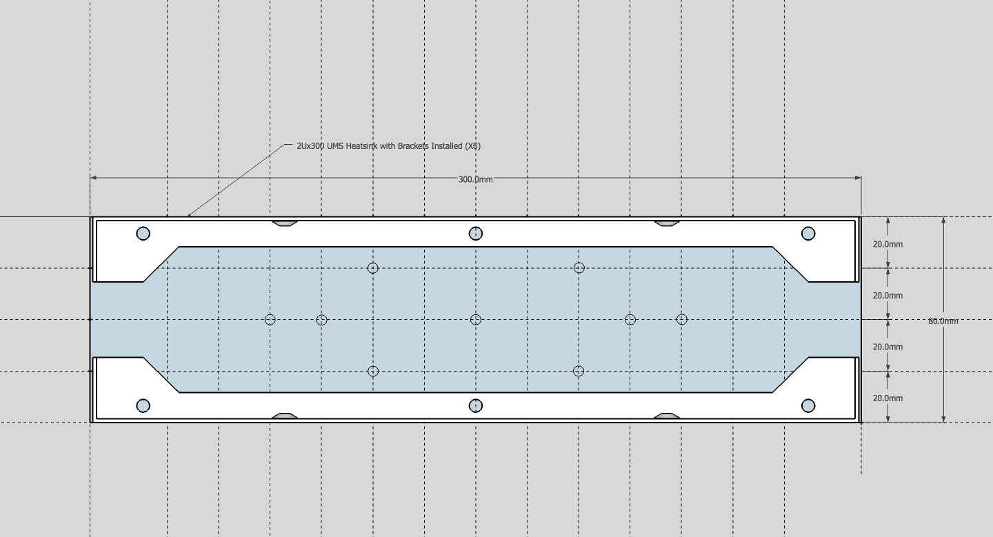

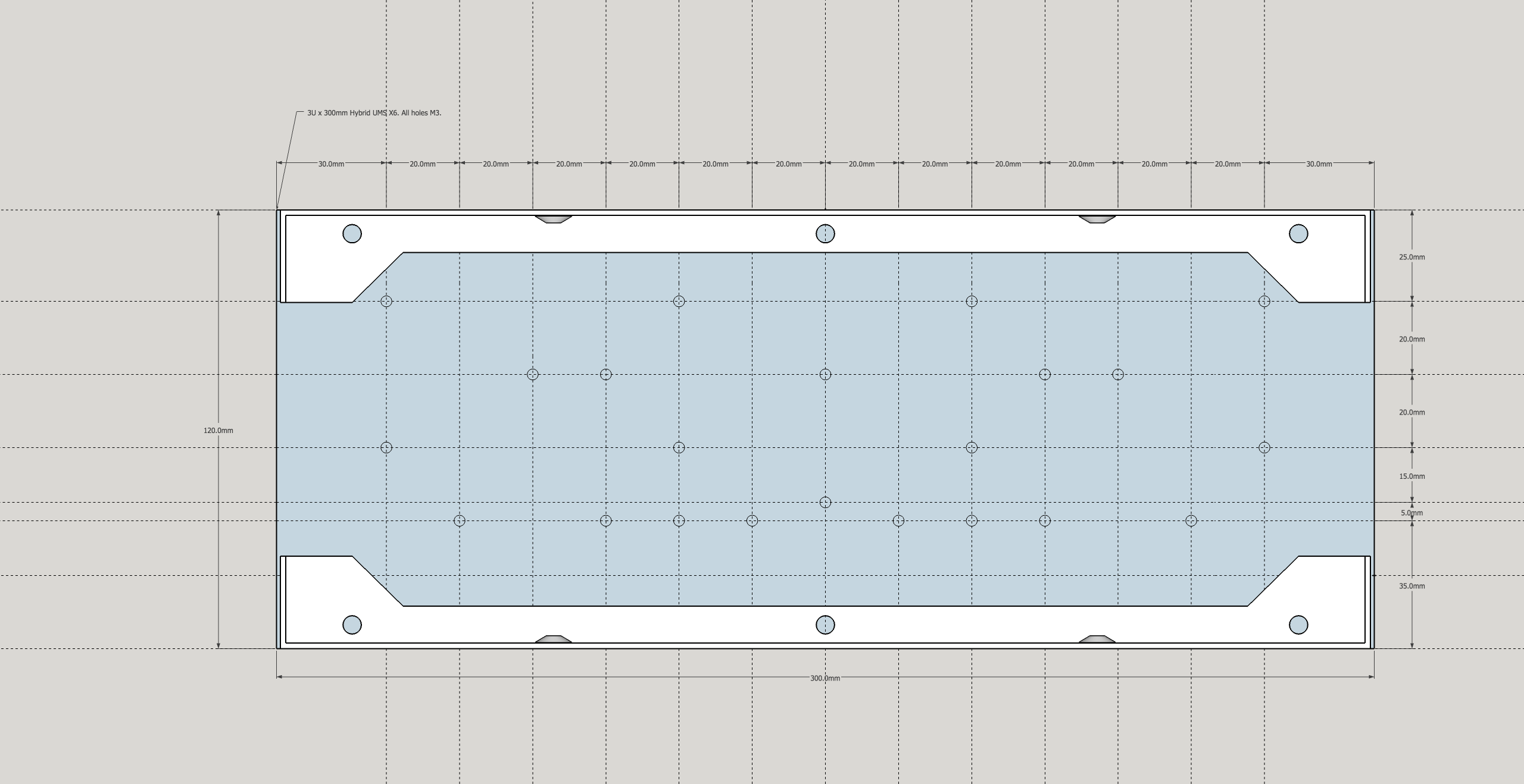

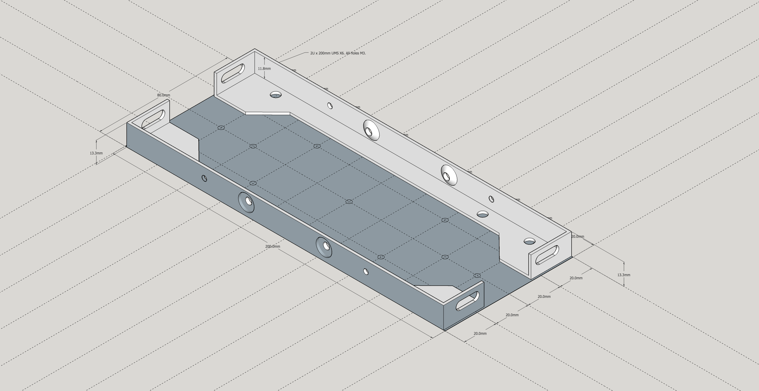

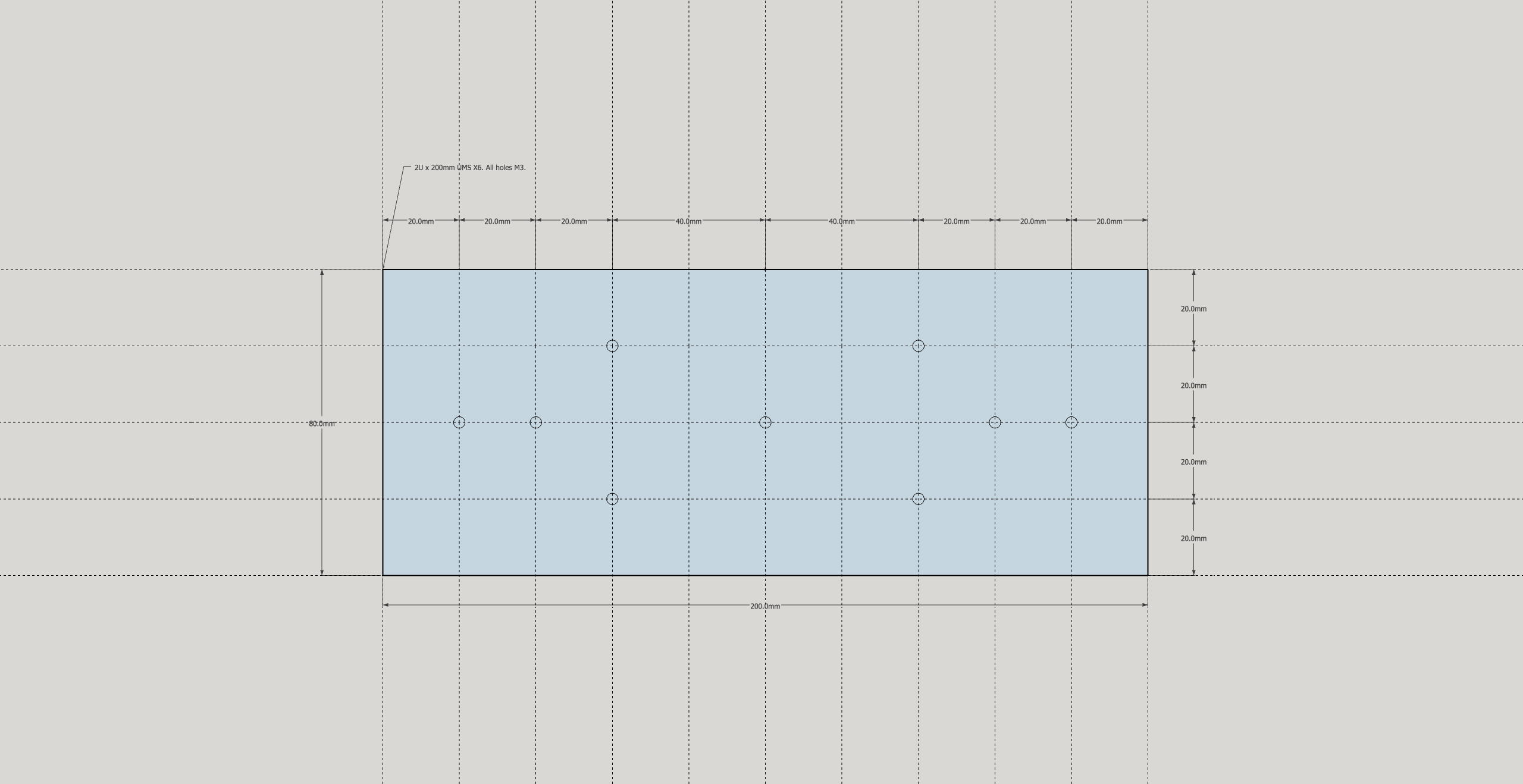

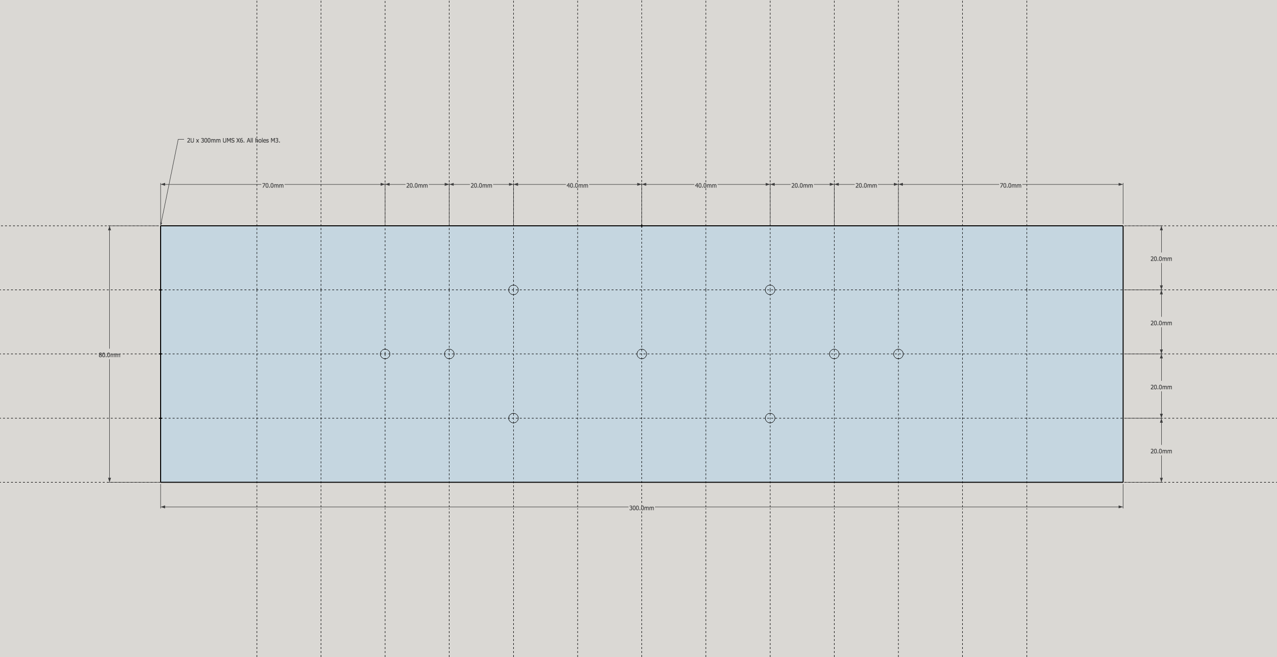

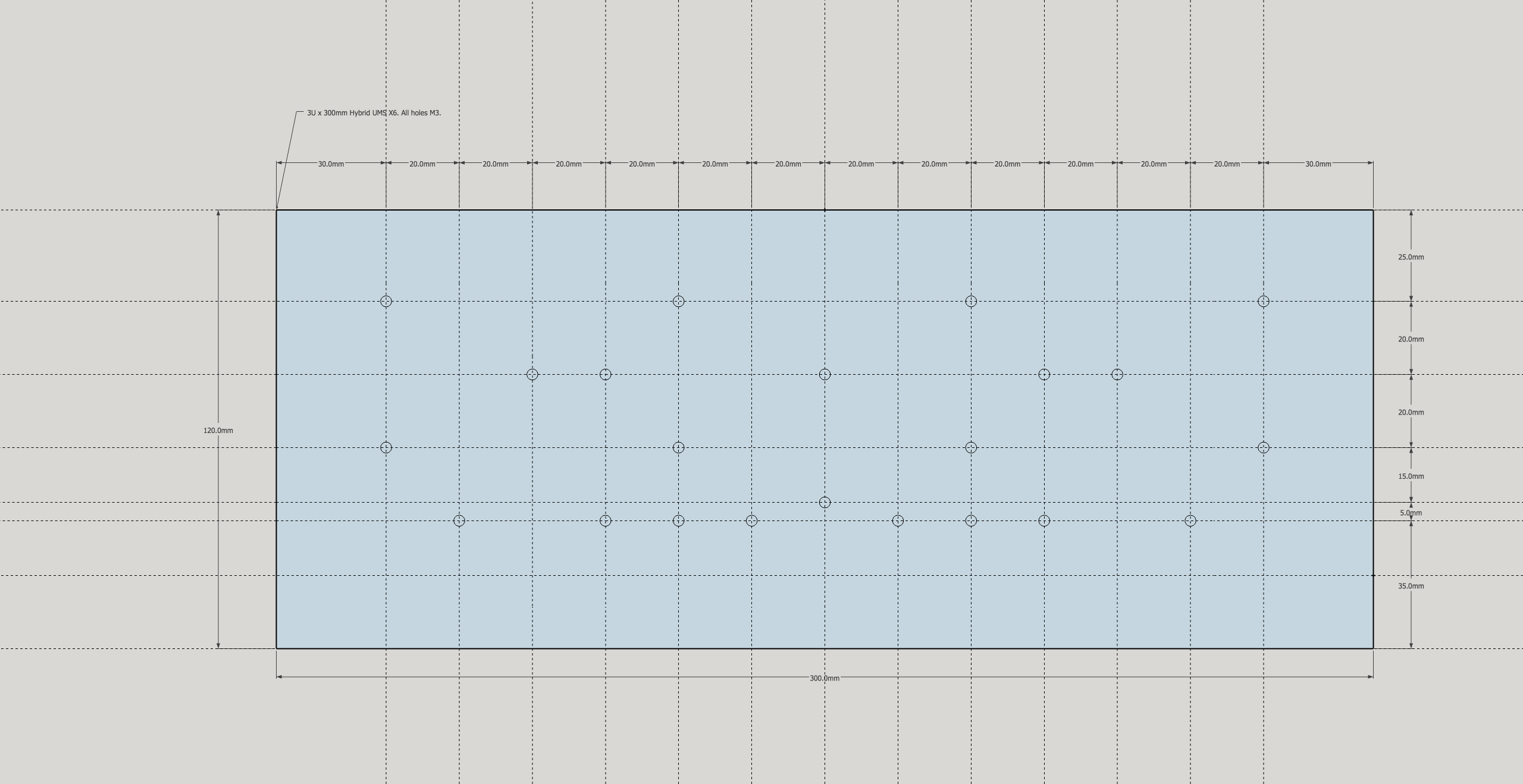

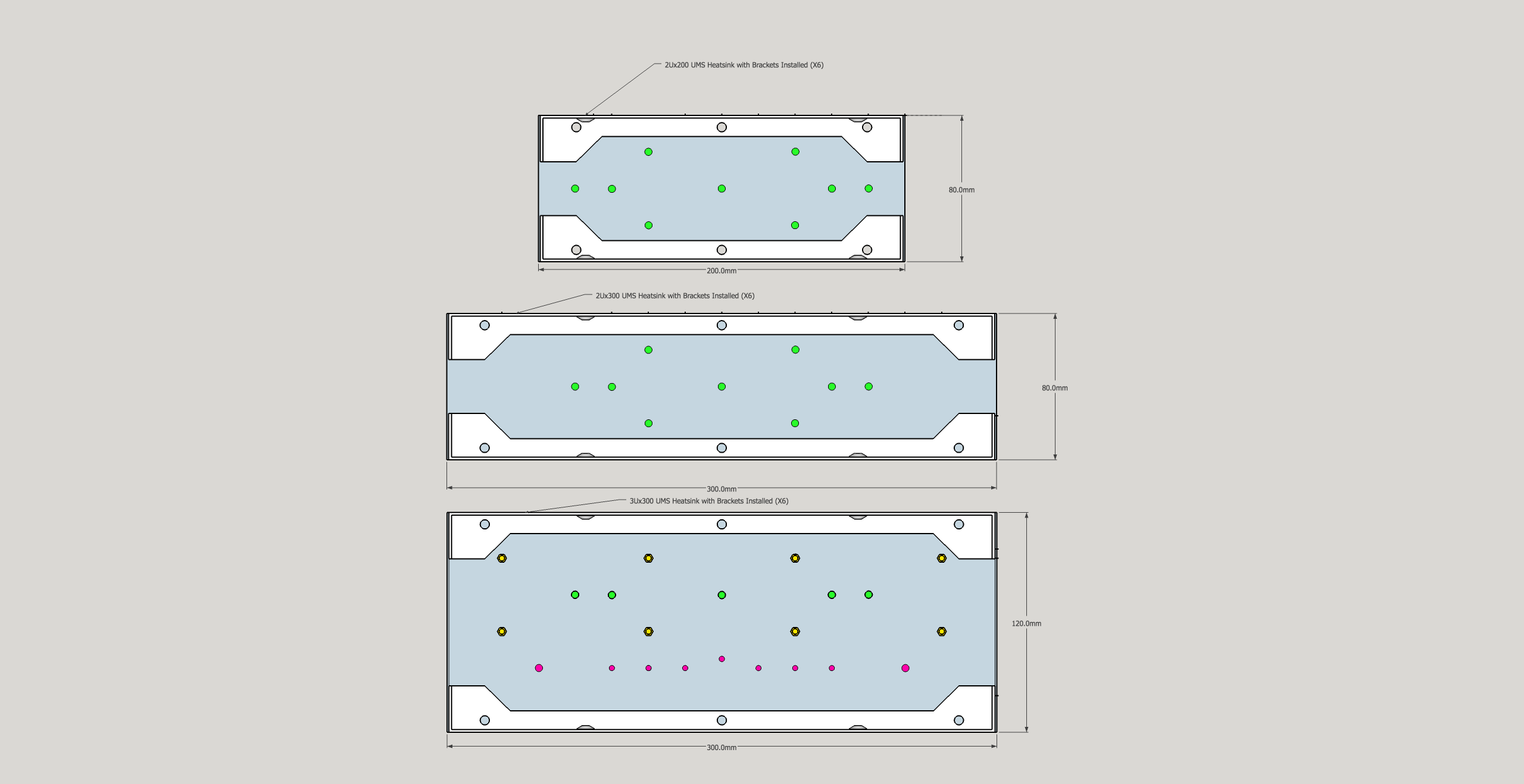

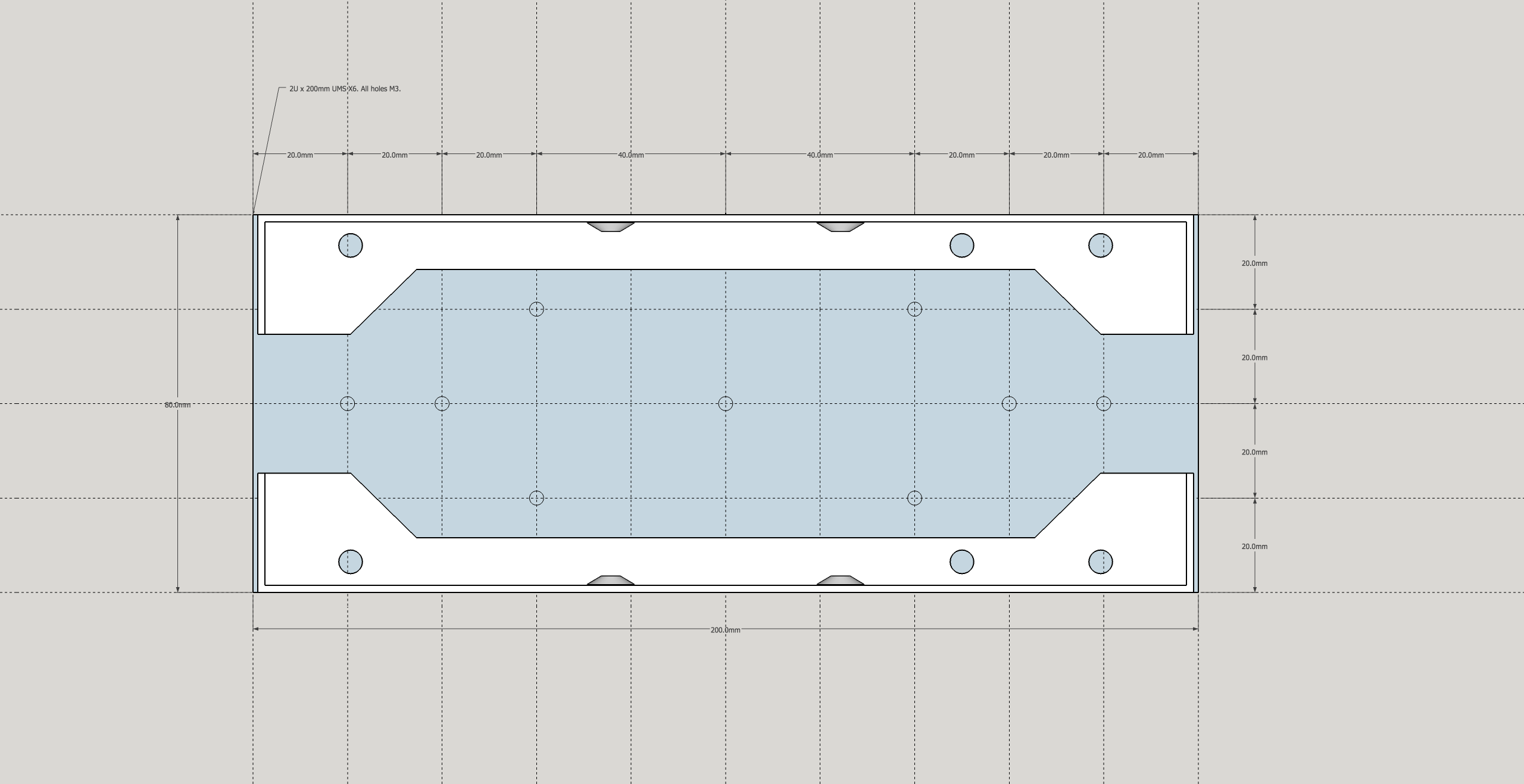

I got my kit a little while ago, and still haven't warmed up the iron to dig in to the project. I didn't buy the chassis, because I'm going to mount the amps to a bulkhead in a sailboat I'm refitting. I found some big flat heatsinks I'm hoping will work; I guess I'll find out soon enough. If not, I'll find bigger ones. 🙂 There's a reference somewhere to "the new 2U UMS 8 hole pattern." Does anyone have specs for, specifically, the 3 holes for the transistors and board? I couldn't find that anywhere. Sure, I could measure it, but I thought I'd ask.
Yeah that would be because they aren't published anywhere yet. One foot in front of the other and all that.... Here's the 2Ux200, 2Ux300, and proposed 3U Franken-UMS. All this can be considered "unofficial", but as time allows, it should all become "official".
Nice work Jason.
Getting this sort of info out helps everyone (especially those going off script) plan accurately for their builds.
Much appreciated by me for one.

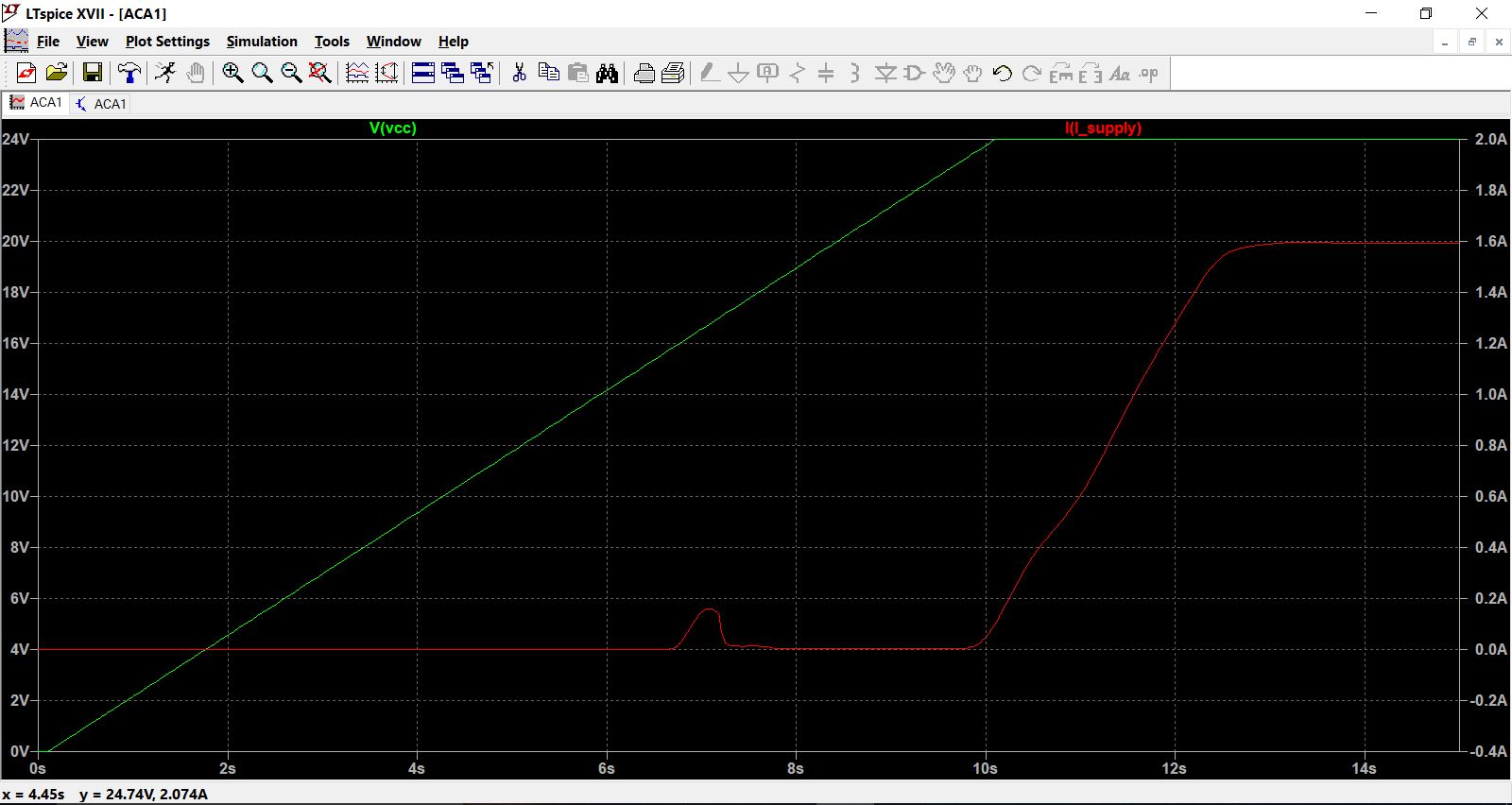

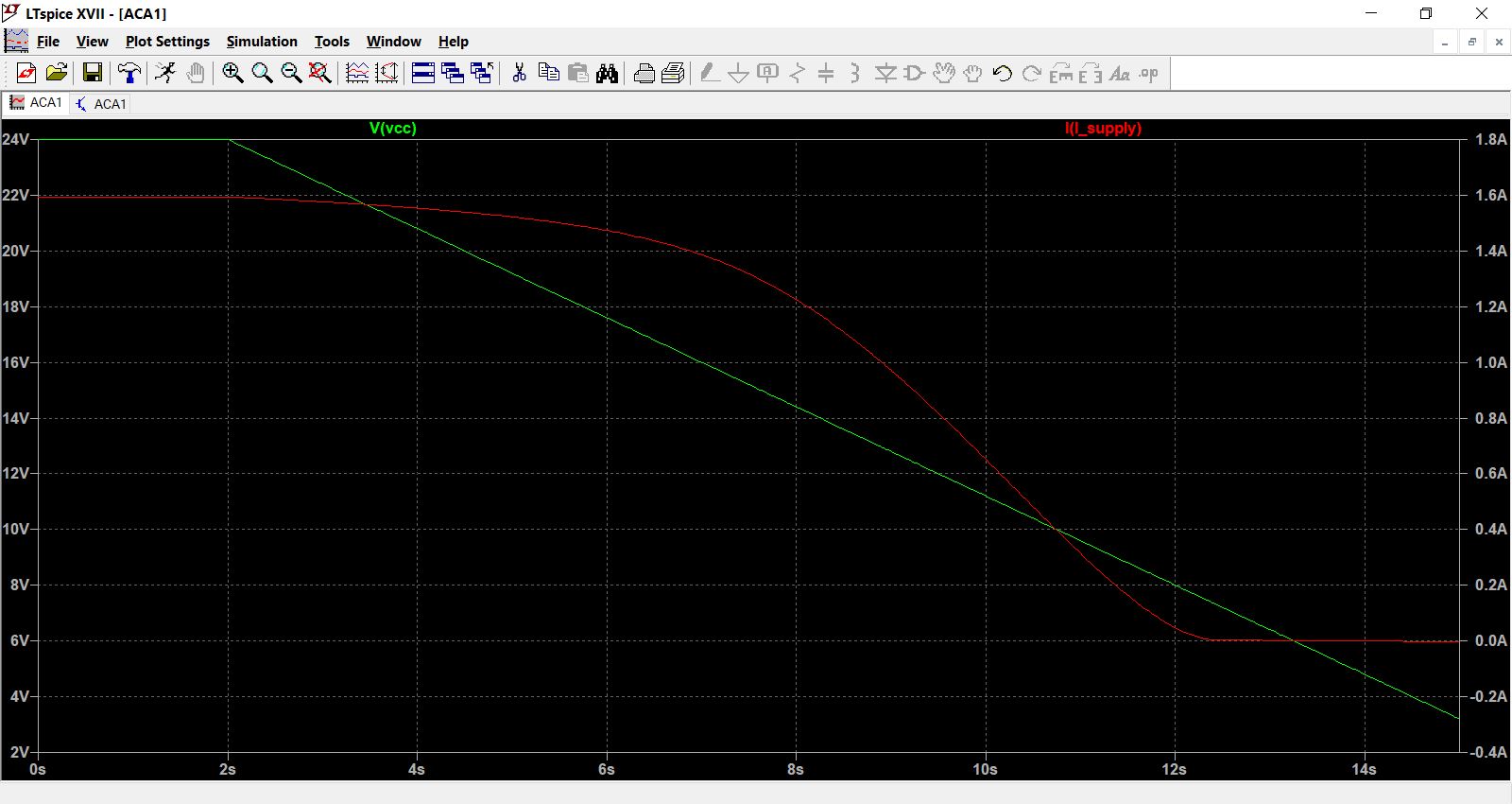

Hello, I built a pair of ACAs. They both bias fine and work fine. I am curious about one thing though. When I turn off one of the amps, the LEDs will immediately go dark. When I turn off the other amp, the LEDs will slowly fade to dark. I am wondering if this points to something I may have done incorrectly. I double checked all wiring and they are the same.

With around 1.45A of the constant current draw, the LED's should immediately go dark...
A voltage across C2 should be around 0.65V; bias current around 1.45A; i.e. voltage drop across R1 (or R2) should be 0.34V..... check the orientation of Q3.
You have a good working ACA, so -> compare...
No bias current? When idle for a while, do the heatsinks get as hot as the other one?When I turn off one of the amps, the LEDs will immediately go dark.
So nothing for the 3Ux400 (which I was planning to use for my M2X build) or is the 3U Franken_UMS just shifted down?

Actually, I rechecked this, and I guess it is a false alarm because both do the same thing. They immediately go about half dark, then fade out completely over the next 6 seconds. What I checked measures well, and both heat sinks on both amps are at about the same temperature by touch when idling for a while.
In simulation the current drawn by the amp decreases sharply below a certain supply voltage, actually down to single milliamp numbers, and so that would explain the LED behaviour.
This shows supply voltage vs current at power on and at power off. Current value is on the right hand side.
