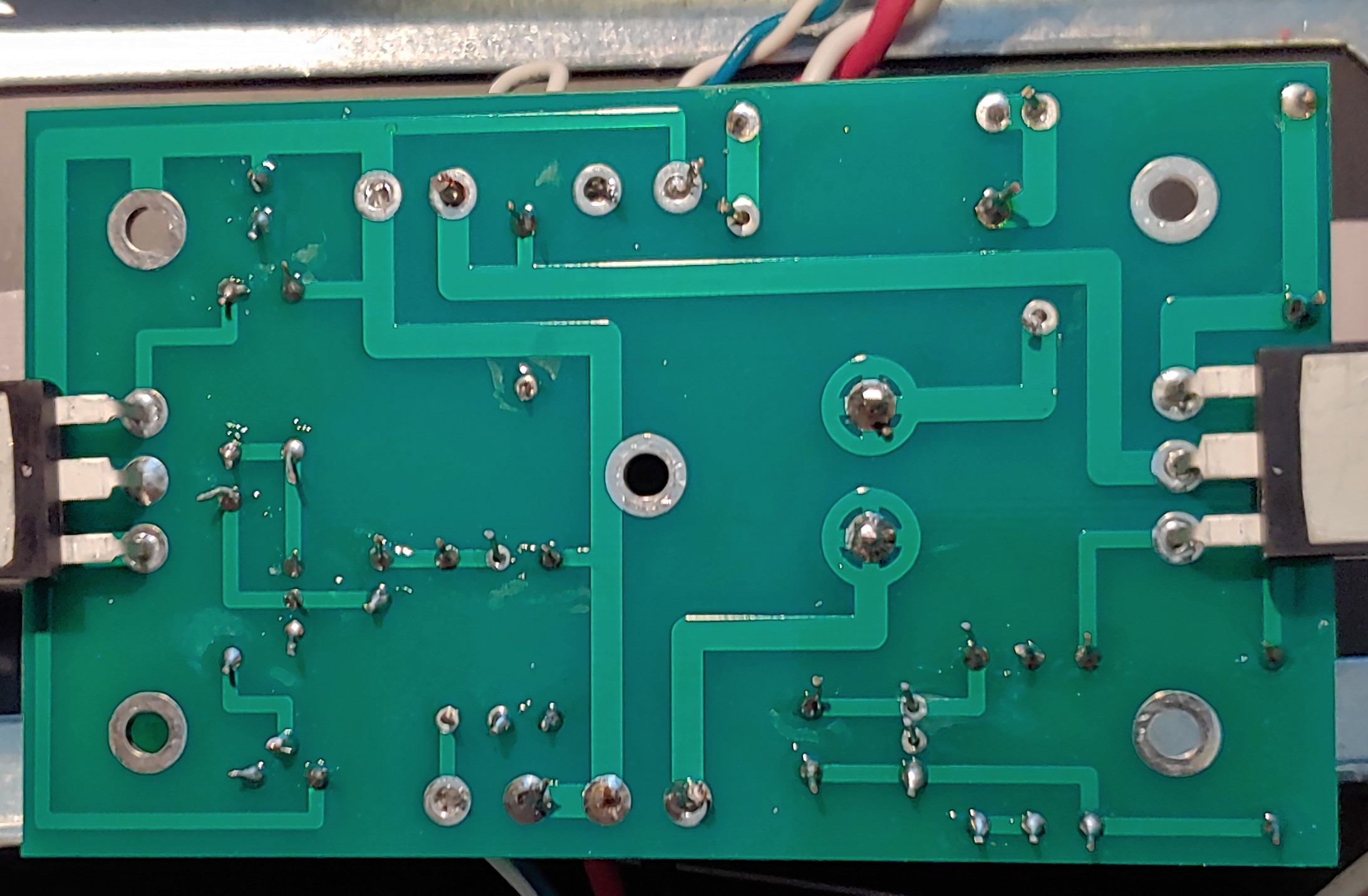

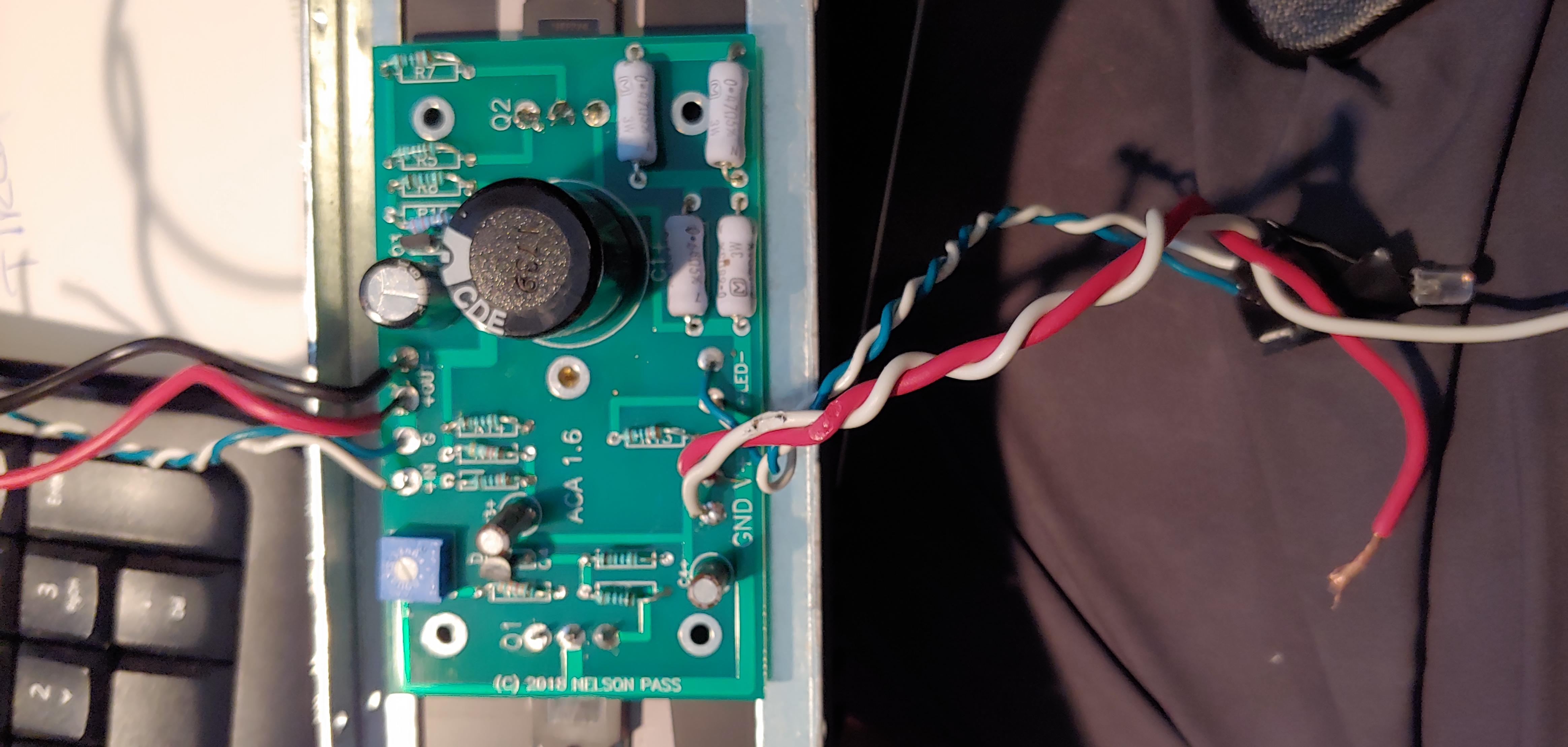

apparently no shorts to Q1 or Q2 on board #1
however r1, r2, r3 & r4 became extremely hot in short order when board powered up

Hi CJ5,
Sorry to be blunt but you need to practice soldering a lot more.
Most solder joints on the second photo are very bad quality.
Solder has to cover smoothly the solder pad and the leg of the component.
You have potentially quite a few dry joints.
Also the legs must be trimmed short.
Have a look at all the building guides here and you'll see good examples how quality solder joint should look like.
Maybe your soldering iron is not up to the job, maybe the tip is too small, or the temperature is too low, or maybe all of the above, I don't know.
But what I know is once you eliminate these issues you'll find that a lot of the problems will go away.

No offence taken. After looking at an enlarged pic I have to agree with you completely. I guess I need new glasses or a magnifier stand. I will resolder everything and see how it goes from there.
