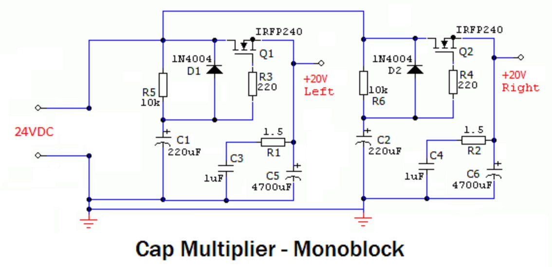

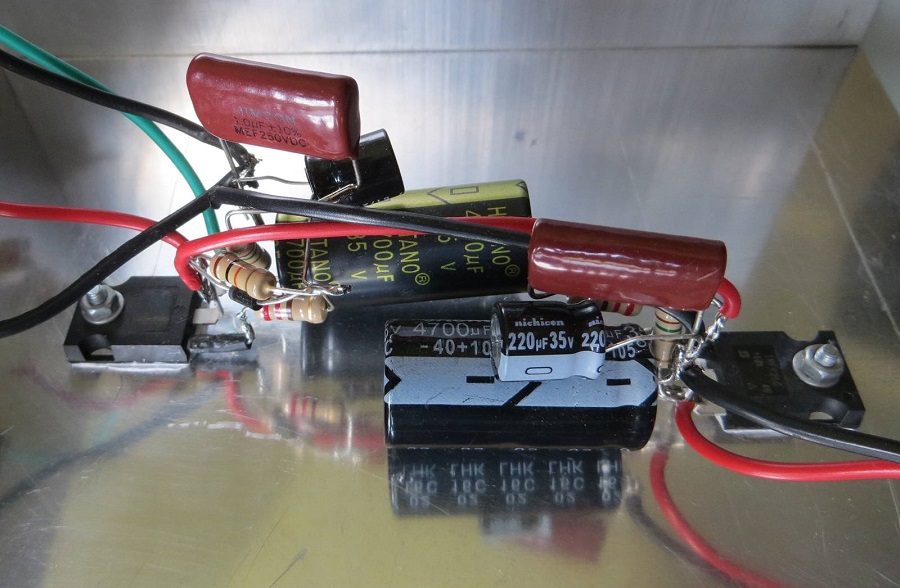

Could you please elaborate into this enhancement? Where is this inserted? Diagram? Photos? Values?...but I've installed a cap multiplier inside the ACA cabinet which ramps up the power slowly. The idea behind the cap multiplier is channel separation - 100dB I believe....
Thanks a lot, best regards,
Rafa.
Hi Rafa
You'll find more info in the Juma's Easy-Peasy Capacitance Multiplier thread. It goes between the PSU and ACA boards, but be aware that there is a drop of 4V (needs 4V higher PSU voltage to begin with), plus quite a bit of heat from the Mosfets. I used the bottom plate of the DIY ACA chassis for mounting the IRFP240's. IRFP250's can also be used.
I have used a modified schematic for the two channels. Note that the output voltage is always 4V less than the input voltage. So, if you need 24V out, start with 28V in.
The benefits of a Cap Multiplier are:
- Reduced cross-talk between channels.
- A soft-start mechanism to slowly ramp up the current.
- It also provides a nice ripple reduction as a side benefit.

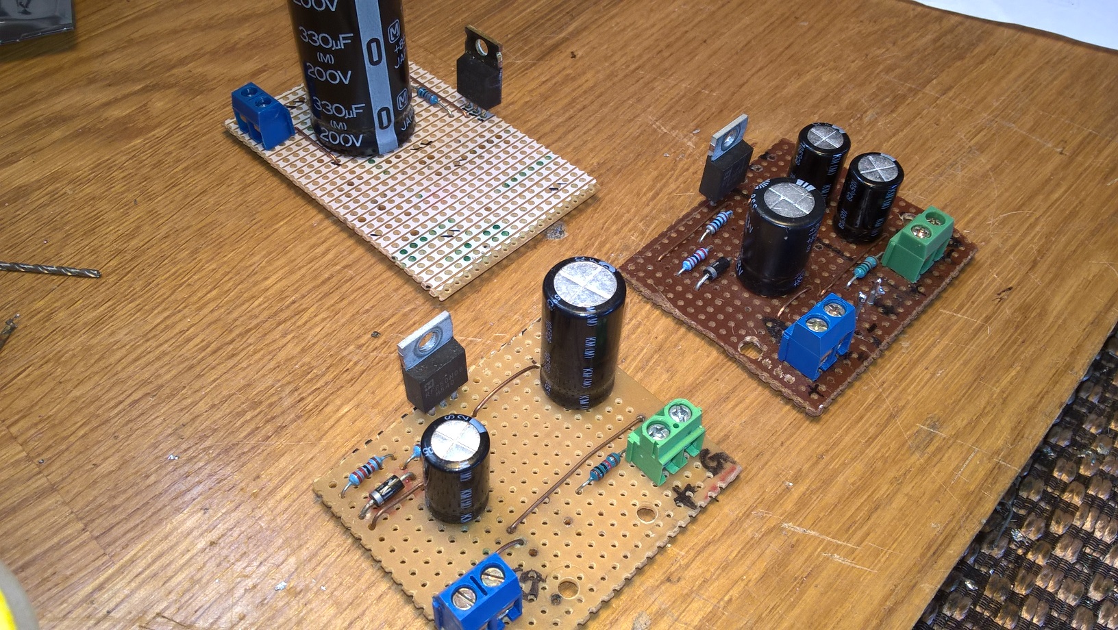

Rafa.

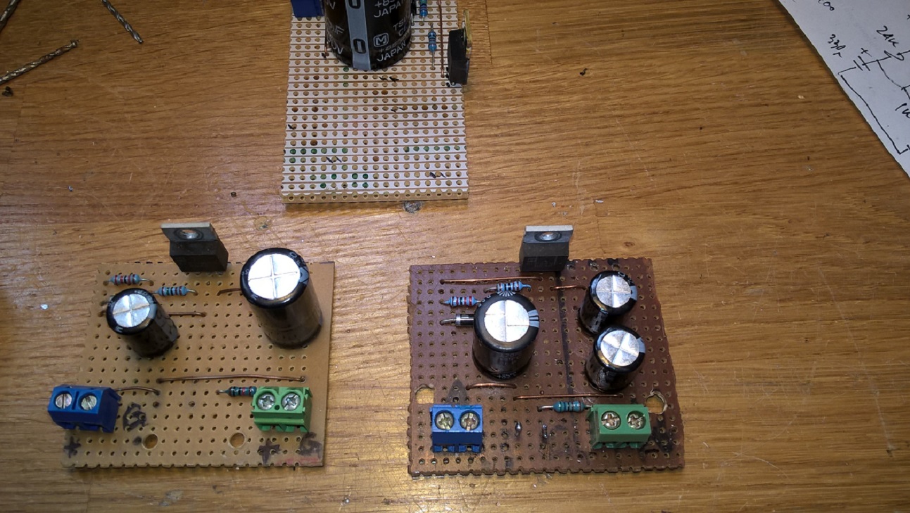

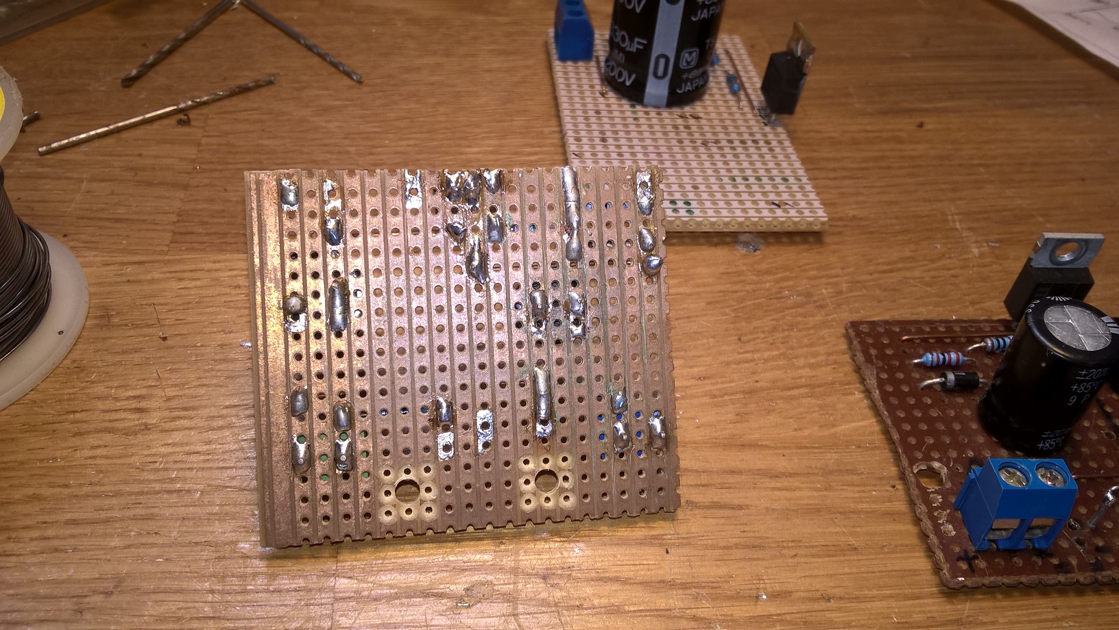

Hi Rafa,
I am using Cap Mx with all my projects, have been doing it for a number of years now.
Here are my simple rules, based on the parts that I have:
R5 (in Juma's diagram) is between 22 - 33k, very rarely more.
Caps 220 - 330uF (voltage depending on the requirements).
gate resistor 1k.
diode 1N4007.
Mosfet IRFZ40 or IRFZ44, because I have hundreds of them and their transconductance if very high.
Always using left over strip boards, makes for a very easy assembly.
Below are some photos.
