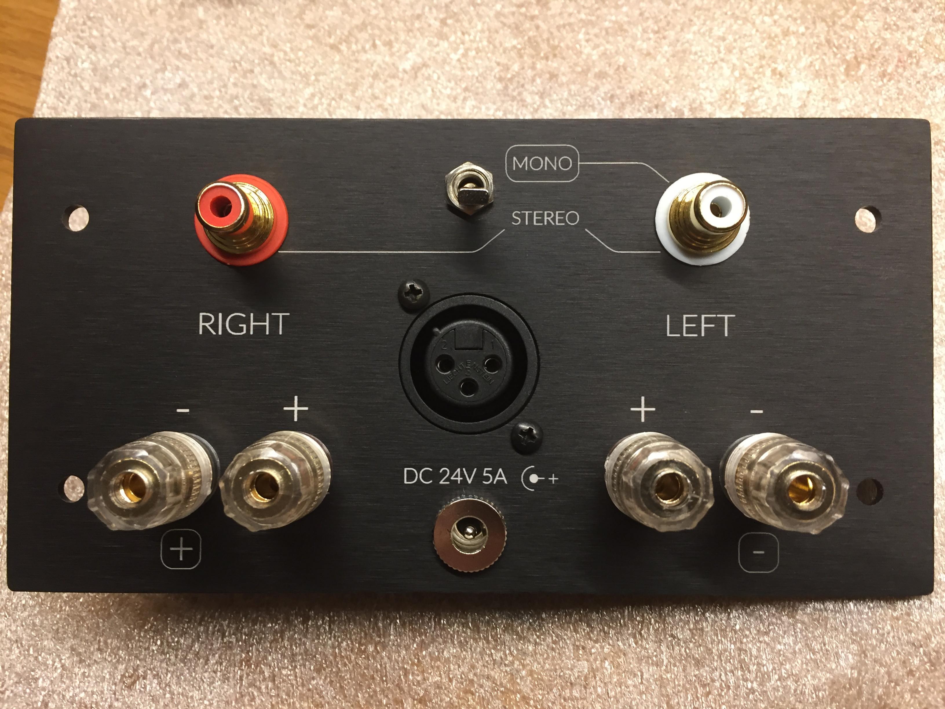

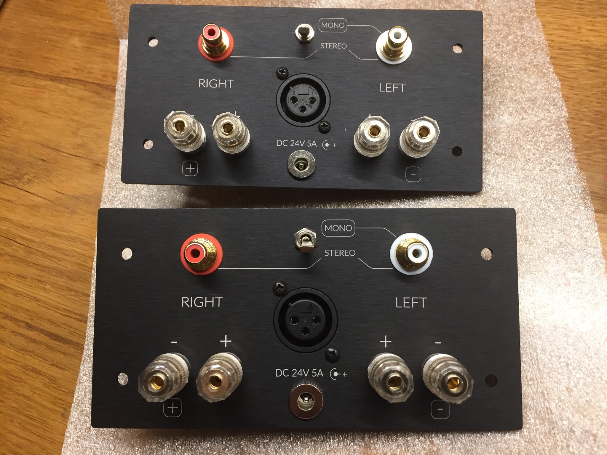

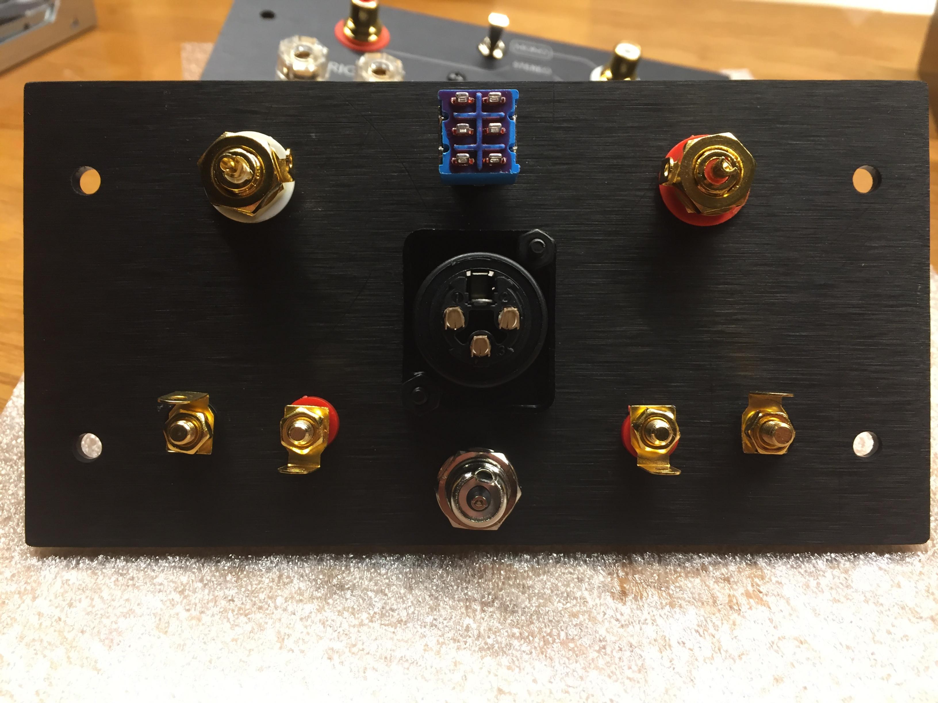

I can’t wait... wanted to see how the back panel looks with mounted hardware.
