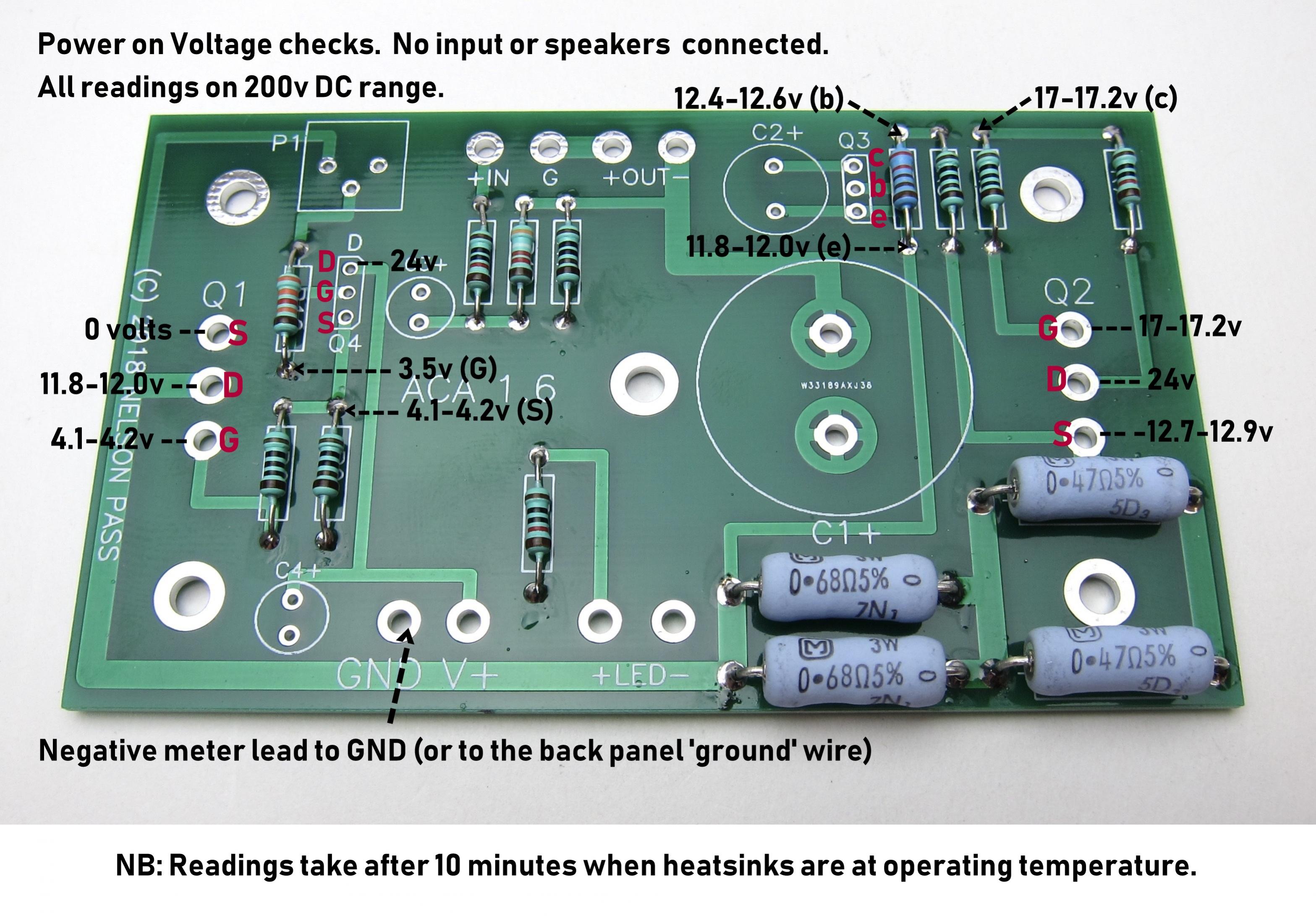

Hi Mooly,
Did the above measurements: On one channel with both leads into speaker posts: .844v and with red lead to input of R11 .244v This channel has sound.
On the other board, both showed .001V. This board has sound on the speaker because at power off there is loud pop.
Please take note, this used to be the good amp which I replaced in service with the now fixed amp.
Did some re-soldering on it and when I re-installed it, sound is gone, but both speakers have loud sound when amp is switched off.
Is .001v no voltage at all? And are the other voltages correct?
How do we fixed this?
Thanks.

Your posts are a bit spread out now. Can you restate the problem please?
1 amp working and 1 faulty. Both not working - which?
The 'pop' is just C1 (the big cap) charging / discharging - it proves very little.

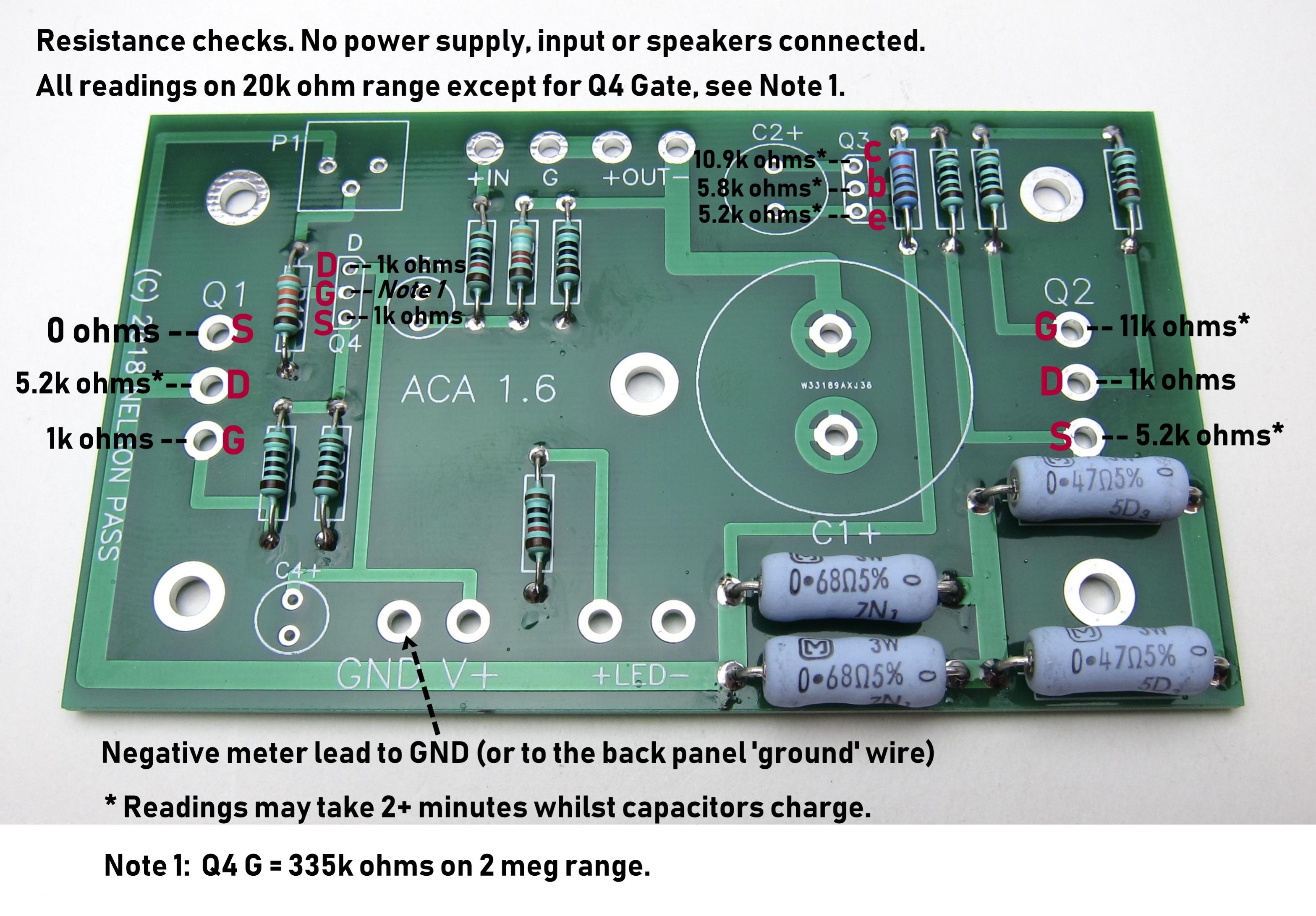

I posted a couple of resistance and voltage check pictures a while ago, #5600 & #5650, maybe give us some of the readings you get off your board(s) to compare?
Extreme_Boky is correct, if you have someone close by who could help.

The readings show that the good channel is in fact operating correctly. An input voltage of 0.244 volts would be expected to give approximately 0.844 volts output. So all good there.
0.001 volts on both output and input of the other board show that there is no applied input signal present.
Causes can only be either a lack of continuity from R11 to the input socket (including continuity through the switch), or a short circuit on the input wiring that is removing the audio.
If you compare with the good amp you will probably find the good one has direct continuity from R11 to the RCA input socket, and the bad one has either no continuity, or there is a short circuit from R11 or the socket to ground.
Thanks for the measurements. Should be very helpful.

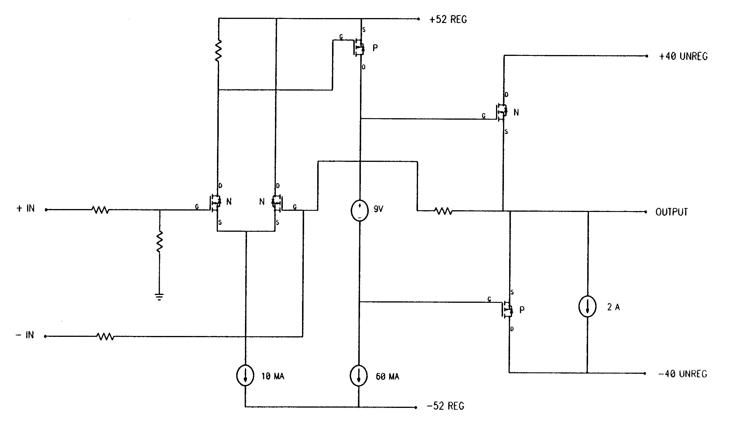

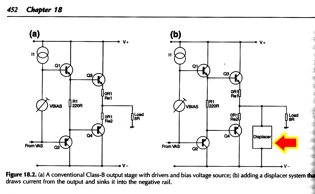

Try Douglas Self's "XD" approach. It does to power amplifiers, today, the exact same thing that nosebleed audiophile tweekers did to opamps 30 years ago:
Self recommends Isink = 1.0 ampere for power amplifiers. Running the EE algebra through a calculator, that means the power amp operates single ended Class-A at all power levels less than or equal to 4 watts (8 ohm load); or single ended Class-A at all power levels less than or equal to 2 watts (4 ohm load). Of course this increases DC power consumption; Self then discusses a couple of pirouettes and backflips that achieve the same goal at considerably less cost in power.
Here's a diagram from Self's textbook, 6th edition:
_
Take a Class-B or "mildly" Class-AB power amplifier. Connect a current sink between the output pin and the negative power supply rail. Voila! It's now Class-A (in fact: single ended Class-A !!) for small swings. How small? Any swing whose output current is less than the value of the current sink.
_

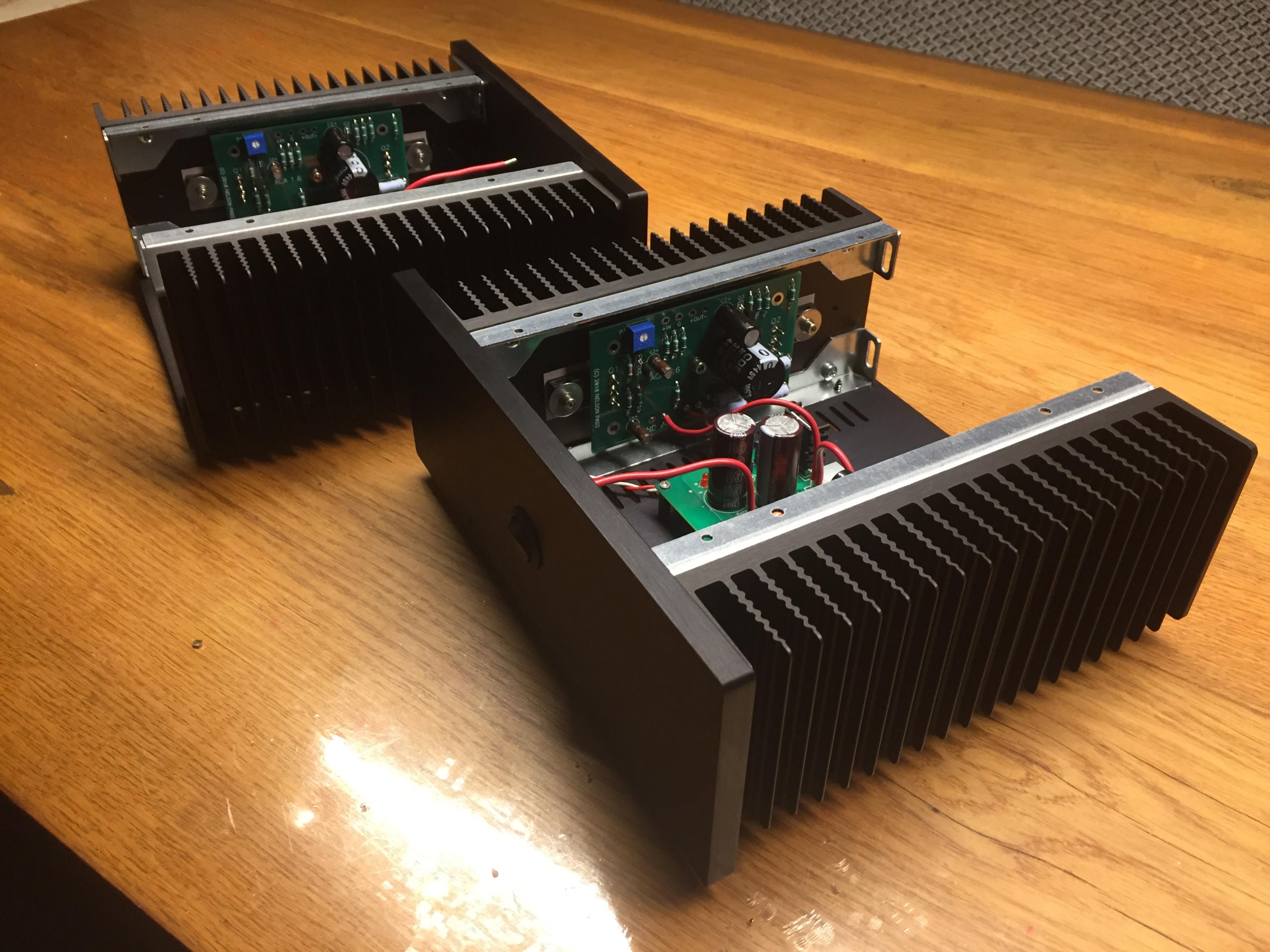

My two ACA’s are playing after a days work. They are truly value for money.
Of course they have to break in a little longer.

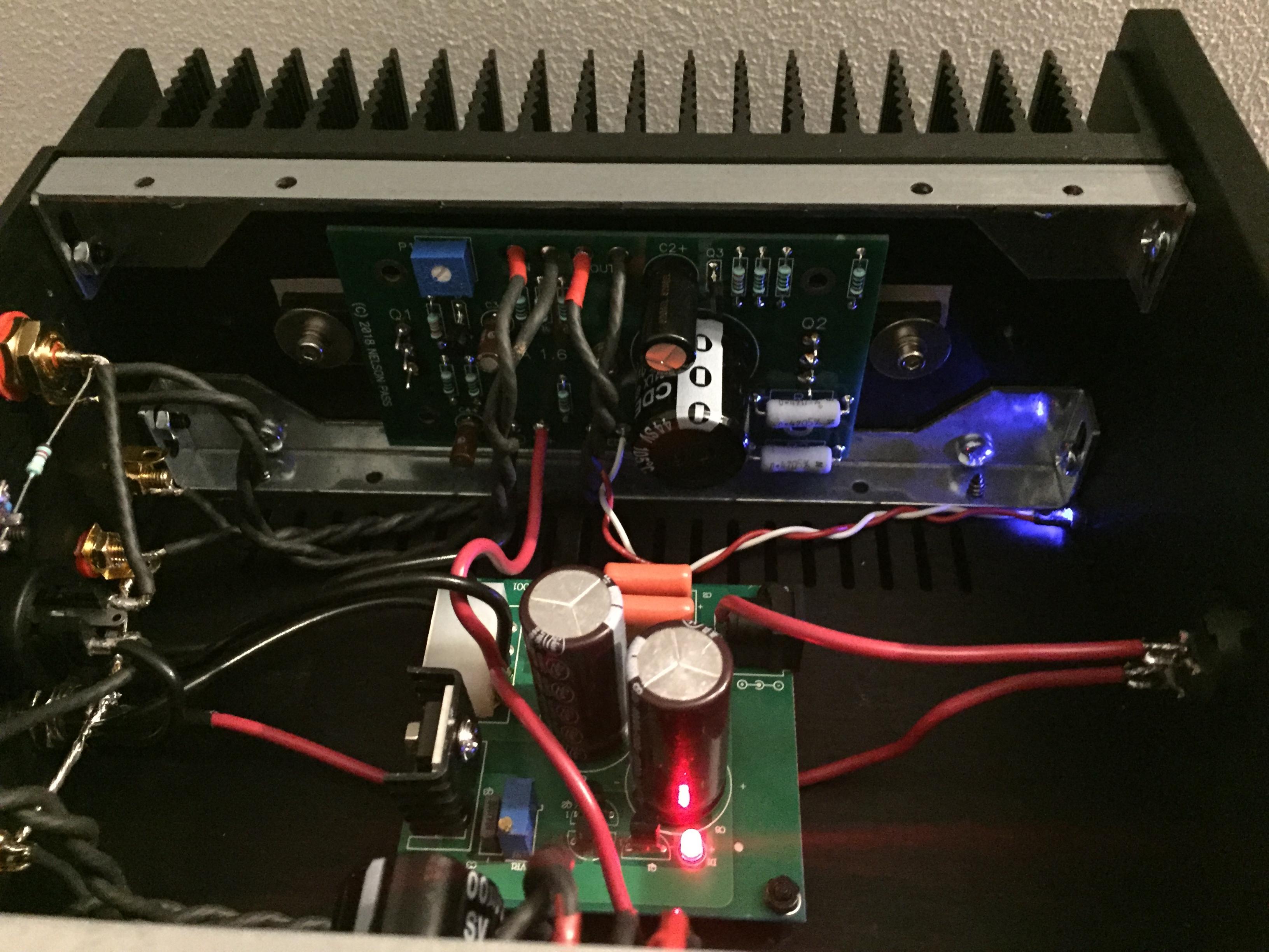

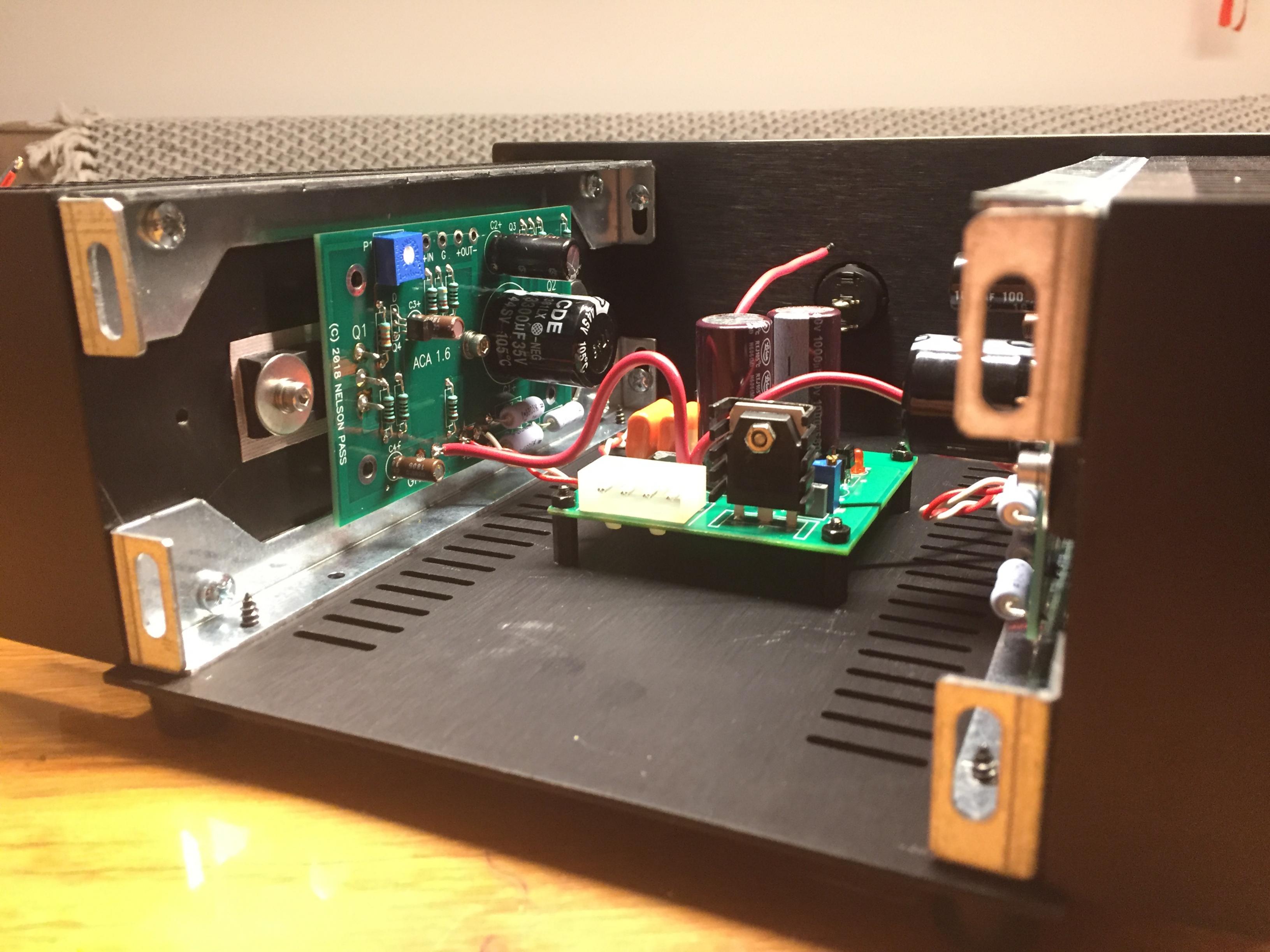

Internally I used silver wiring. Also mounted a CM from Allo eating 0,3V away. I solderd the wires directly to the CM. It’s mounted after the switch.
At this moment they already sound marvelous. Class A a little tube like. They remind me of my Audio Note Conquest amps. Same power approx. same signature. Promising!
tbc!
Thanks Mr Pass! Thanks DIY audio team! Thanks diy members!
tbc!

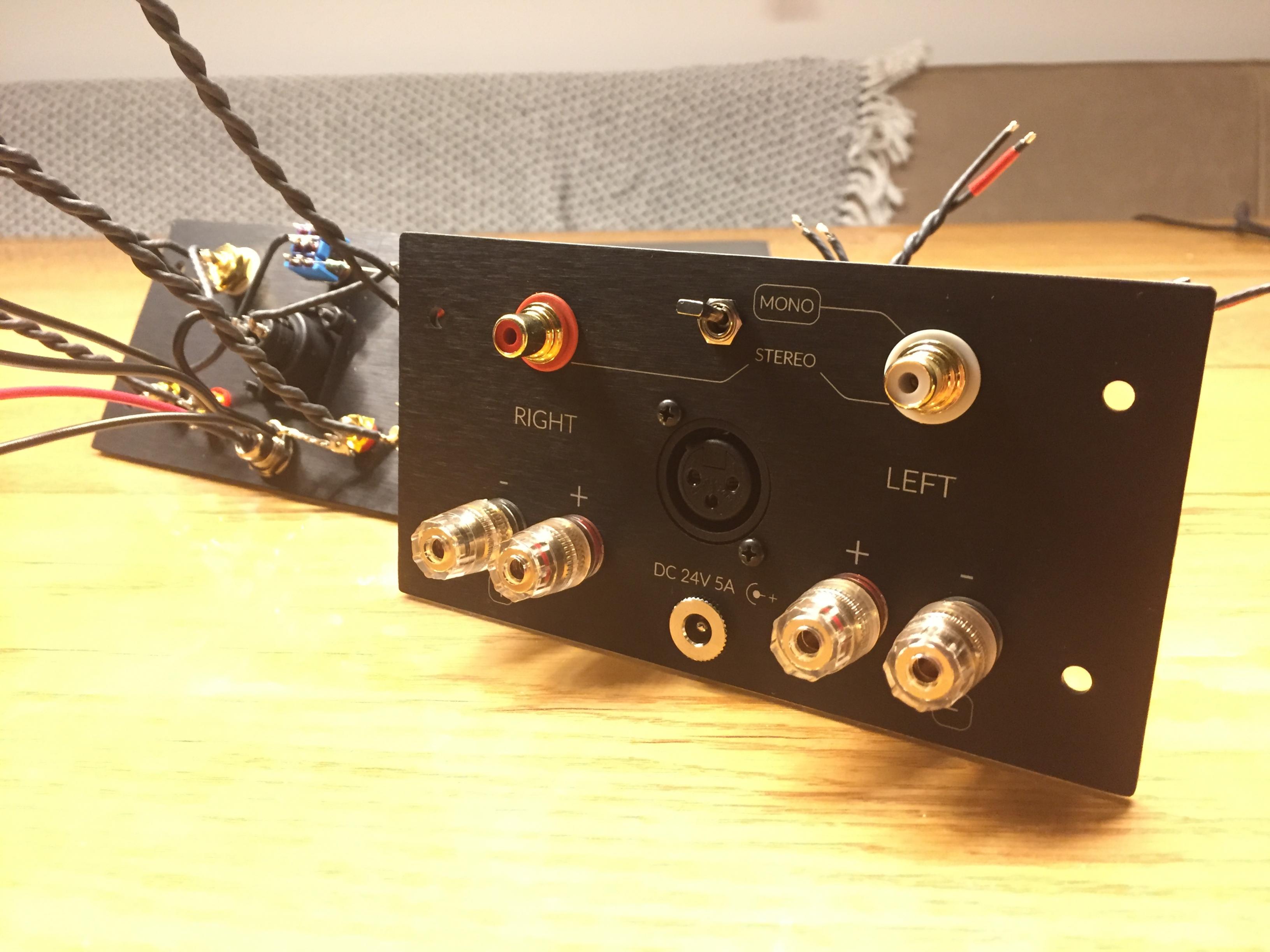

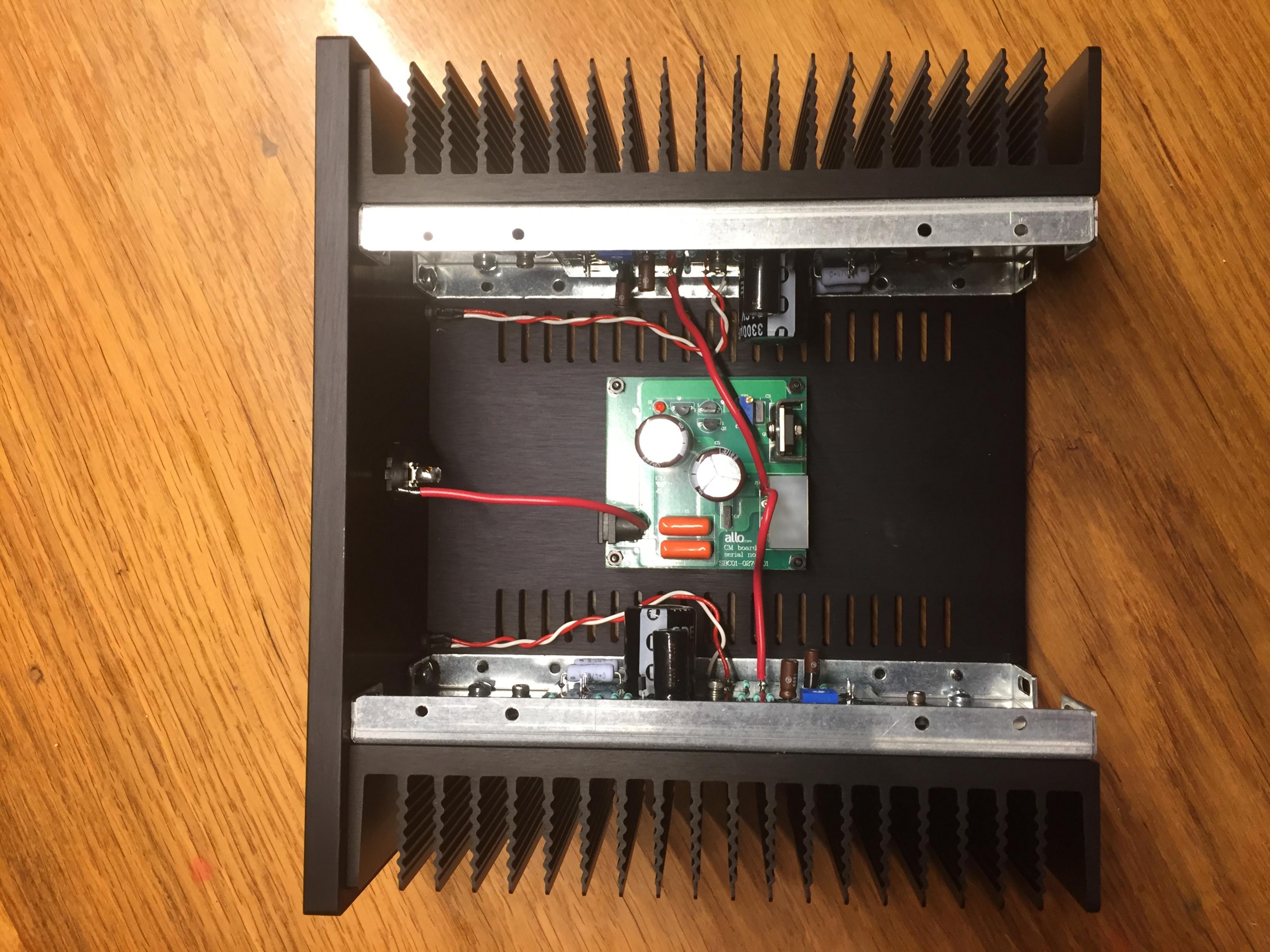

Nice one JeffreyD.

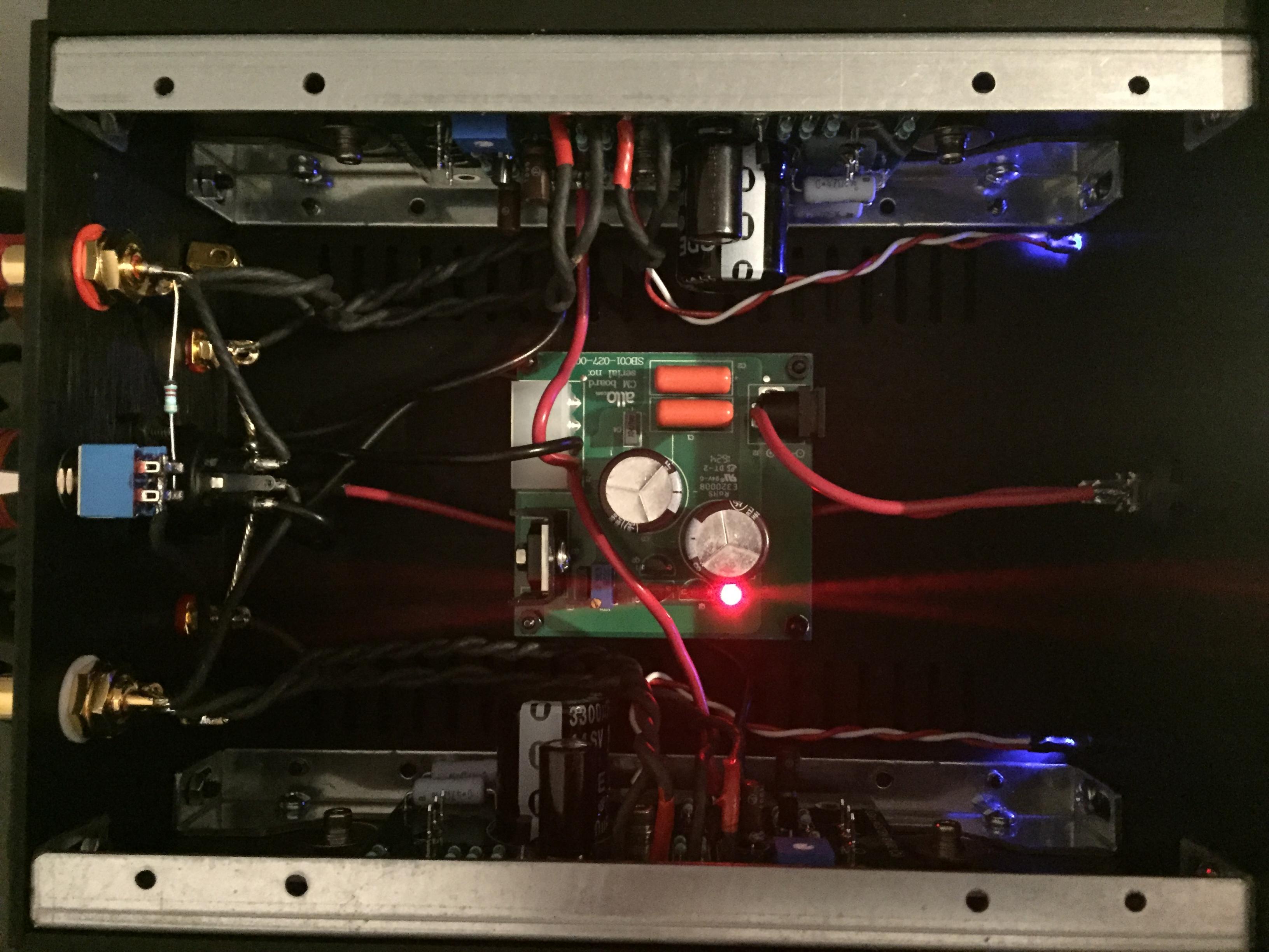

With the CM, how is the input ground dealt with? There's not enough light in the shot for me to make out that detail. Or are you just working off the single connection back to the bus that's wired up to the back plate DC jack?
Any thoughts on the possibility of making the CAD files of the back plate engraving available?
Photo's 3 and 4 show a black wire from the CM ground (0VDC) near the 4 way Molex connector back to the OV bus at the input connector to the amp.
Good idea to put the CM in the amp chassis, close to the ACA V1.6 PCB's.
That is what I will be doing, with an external regulated 24VDC supply feeding the ACA with separate +24VDC supplies for each channel and 2 off CM pcb's - one for each ACA channel.

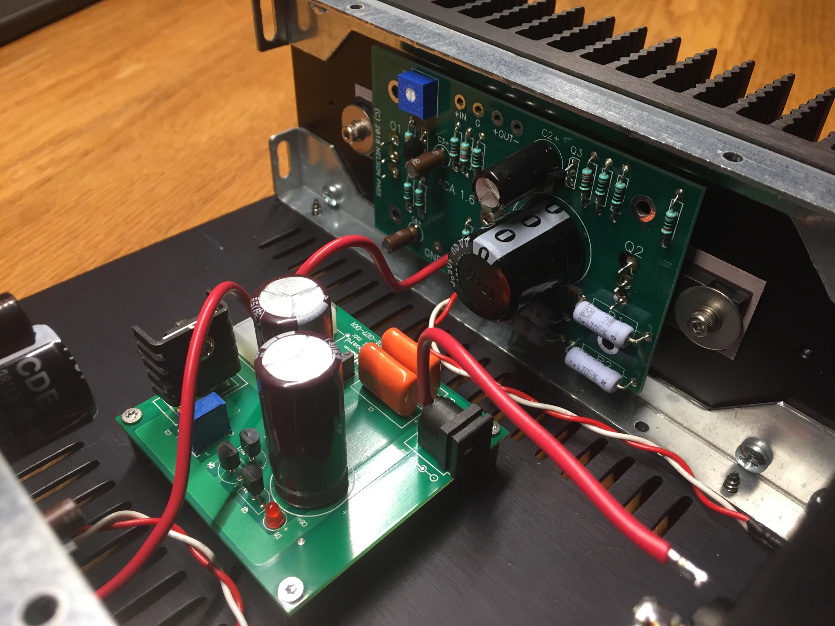

... ohh, forgot to mention, it will be really great to hear from you how the CM performs under load once you've got everything settled in, especially in light of this comment:
Using thin wires, multiple connections, crimps, and capacitance multipliers' PCB on various boards with more thin wires... ain't gonna cut it...
Yeah, that's what my eyes tell me but I was just wanting to check I hadn't missed anything.Photo's 3 and 4 show a black wire from the CM ground (0VDC) near the 4 way Molex connector back to the OV bus at the input connector to the amp.
ACA 1.6 Fun
Wondering about a couple of things. I ordered the ACA without the front power switch.
1. Cosmetically, I didn’t want it in the front. Can you still install it on the back somehow? Drill a hole?
2. I want to run my ACA’s as a pair of balanced monoblocks (I bought two kits). From the build guide, it looks like you can flip the switch to run them stereo or monoblocks. Does flipping the switch make them from stereo to mono - single ended AND balanced - depending on how you hook them up (use RCA cables for single ended, XLR for balanced)?
Thanks in advance for any assistance you can provide.
