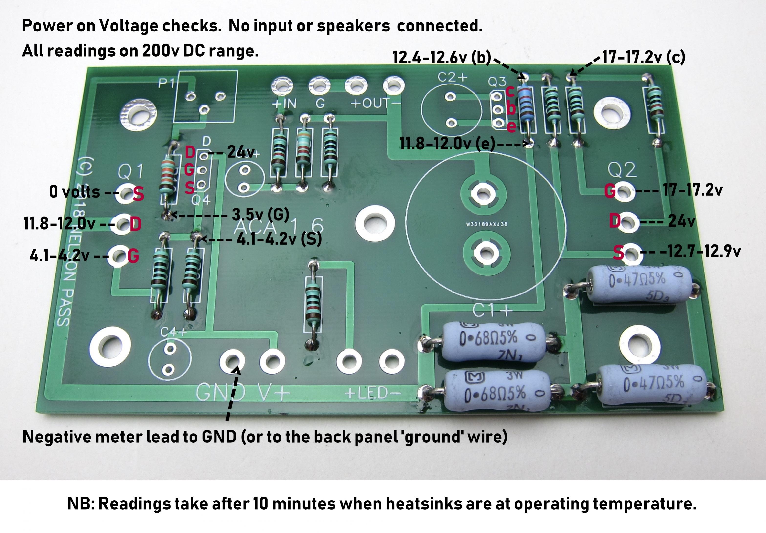

Following on from my post # 5600 ACA resistance checks,
Here is the ACA voltage checks and locations.
I've used easy to reach components as test points to save shorting anything out with the power on. Take your time and use well insulated probes to be extra sure.
The voltages are from 2 boards I built. The Q1, Q2 and Q3 figures are consistent with 'modelled' amps. Q4 is a little different.
Anyone care to measure theirs and let us have a range of 'acceptable' voltages. Or other comments to improve it.
Alan

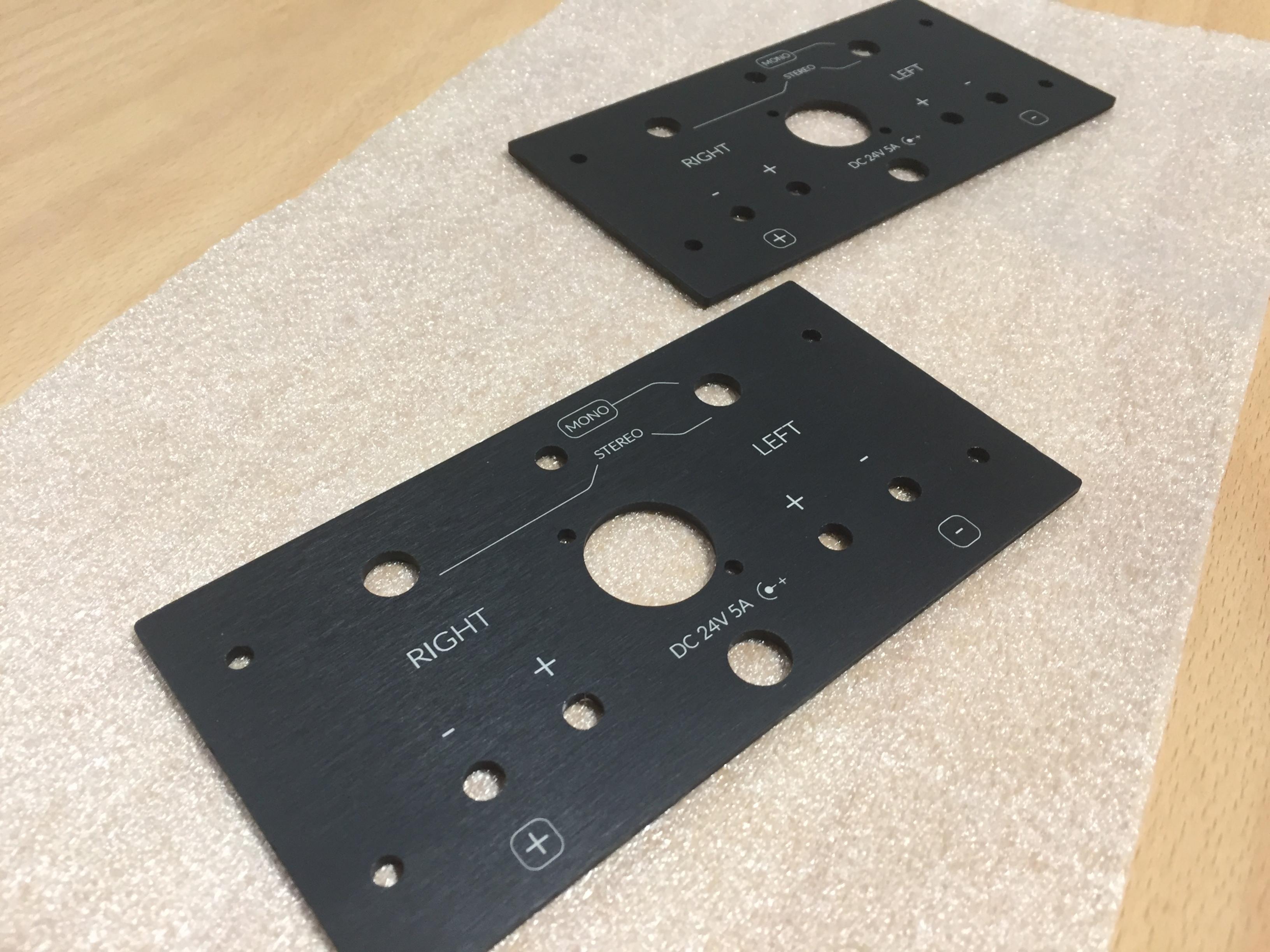

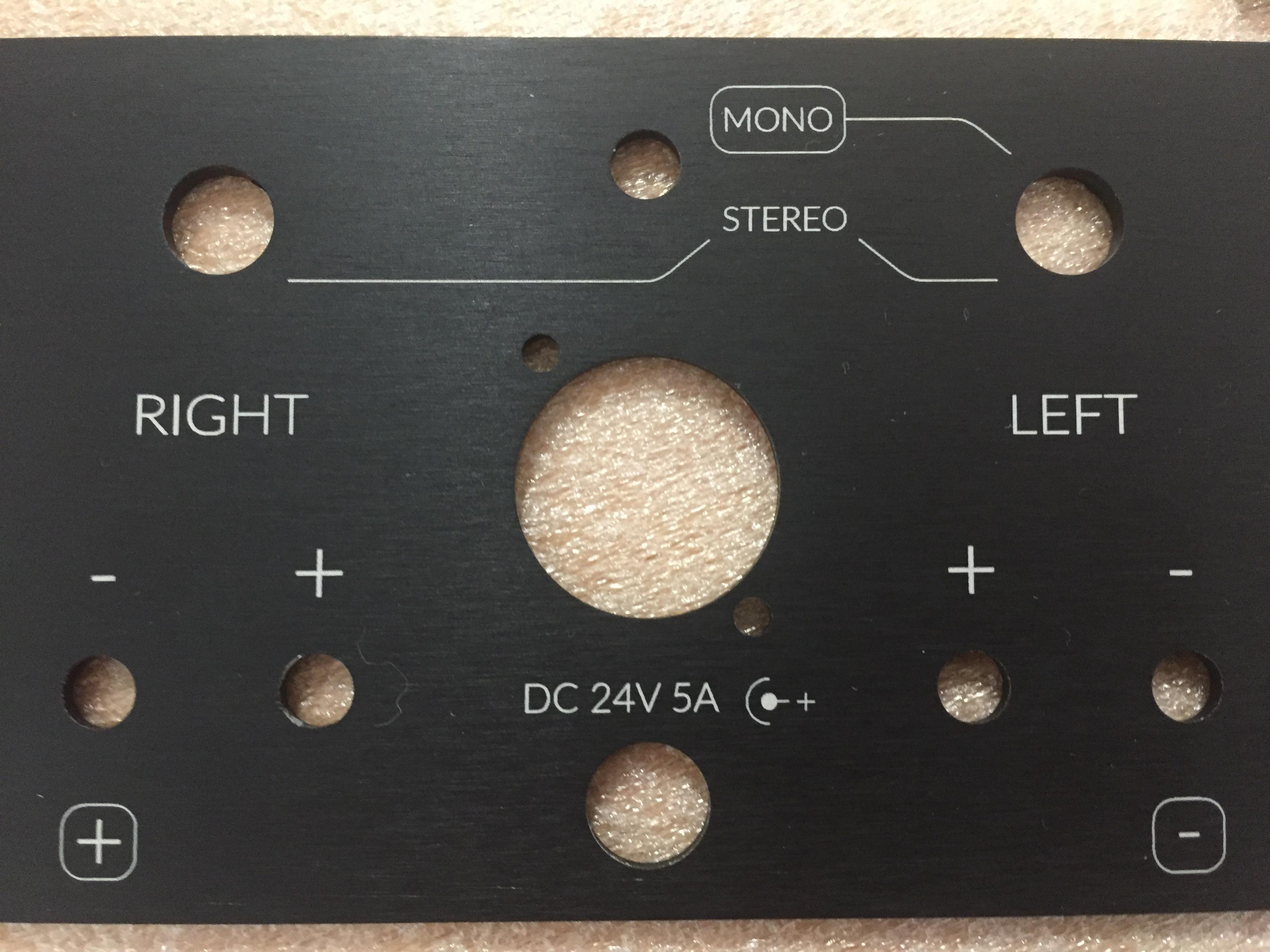

Finally found some time to engrave the back panels. First time I used the laser cutter to do that. I’m very pleased with the result. If you want your BP engraved PM me. As stated before it’s free of charge for the diy community. Only shipping you need to arrange.
Really nice! Great job. Thanks for the offer to do this for free. That's a wonderful thing to do.

Alan, I think these are invaluable tools for troubleshooting! I won't offer to measure mine as they are biased at 10v instead of 12v, so as not to confuse everyone, but even though I finished mine, his is a great helping hand!Following on from my post # 5600 ACA resistance checks,
Here is the ACA voltage checks and locations...
Thanks,
Rafa.
Really clean Jeffrey! Love the result, Very, very professional looking. Congrats!
Thank you both!
