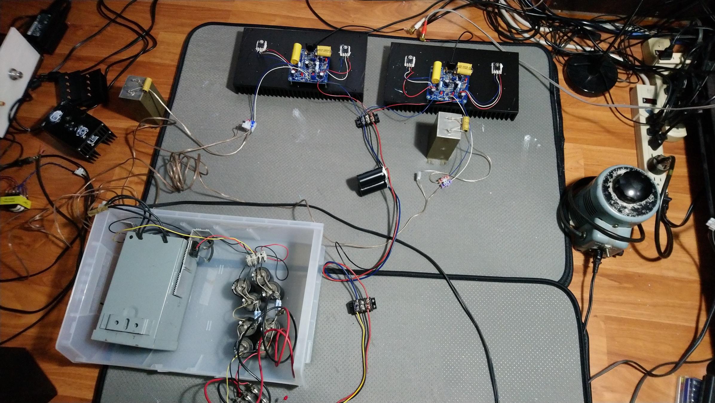

Thanks X and Hugh for great amp. I am still in early stages, heatsinks only arrived today. I built boards about a week ago, and was waiting for delivery of heatsinks. Just tested a birdsnest with variac, works from the start. I am running it with test speakers though caps first to break it in. I will put it together in few days. It shows great promise. Cheers! Stay safe.

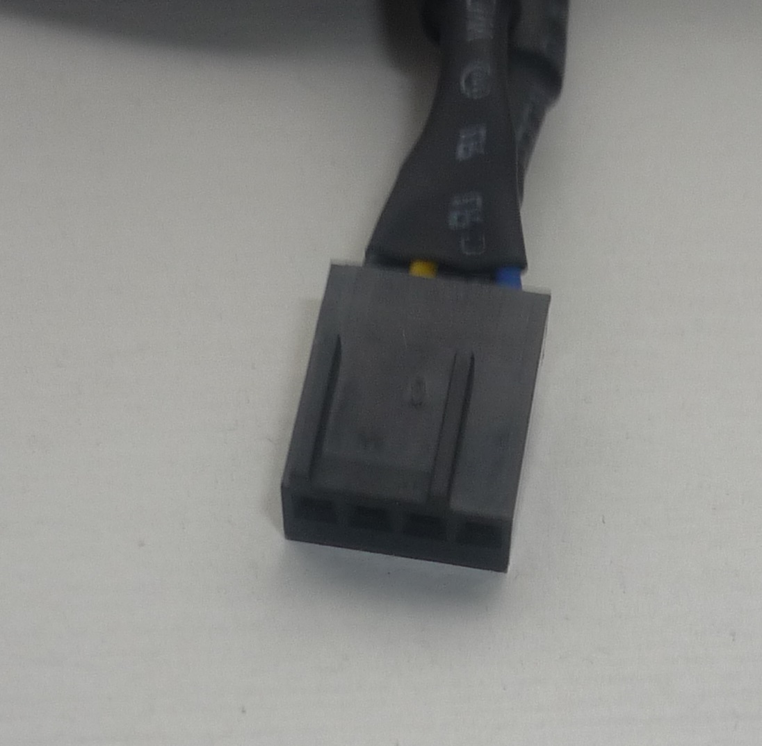

But do you happen to know which male base matches the 4-pin female connectors on the end of the fan's cable?
Would this Molex connector match it?:
https://au.rs-online.com/web/p/pcb-headers/6795596/

Just found I have an easier solution to hand, V !! 🙂
The actual socket on the end of the fan cable is shown in the 1st attached pic.

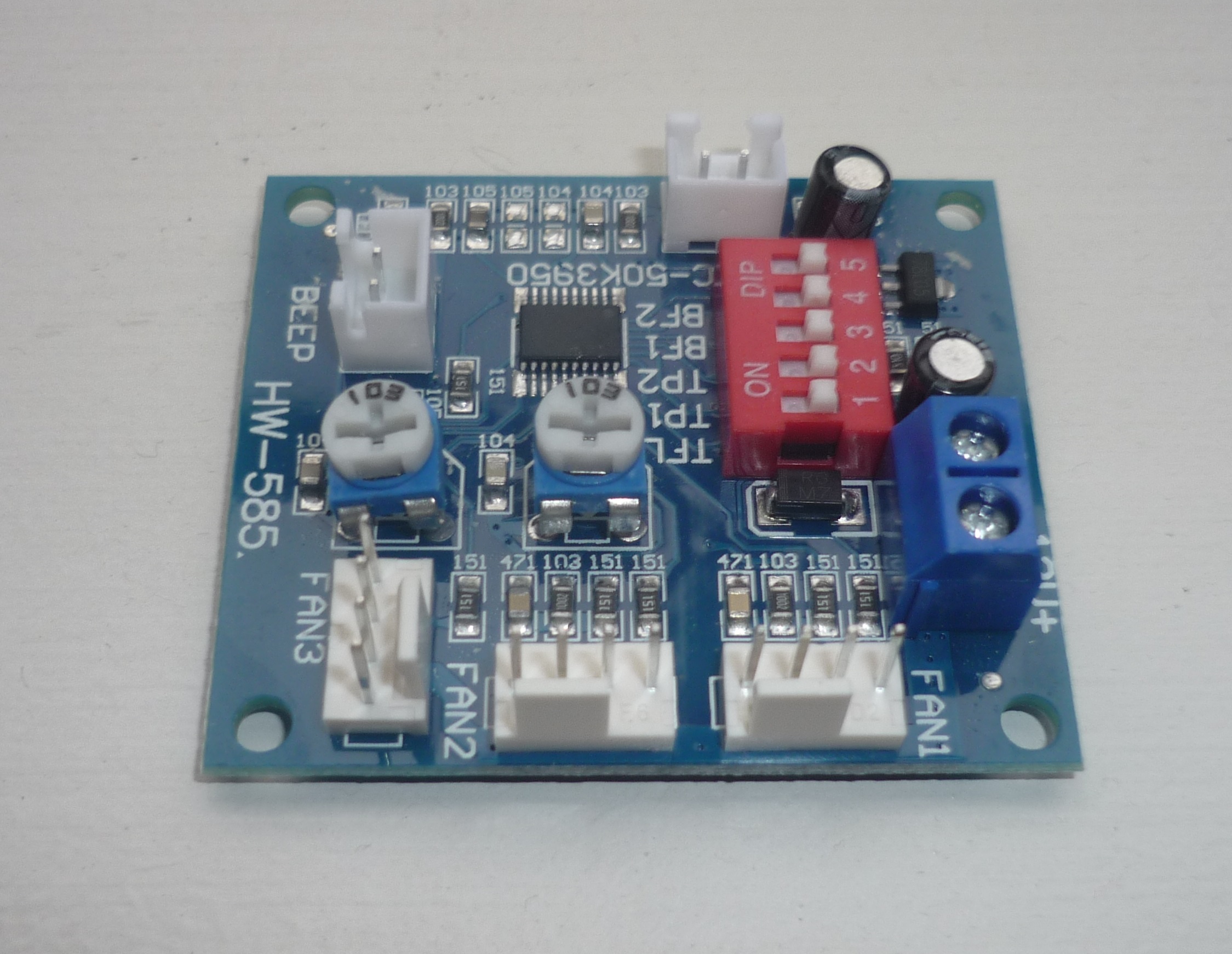

This matches the male plugs on the PWM controller - see 2nd attached pic. This is obviously a standard plug used by computer mfrs.
I searched for both Molex and Worth 4-pin, in-line male connectors and they all have the vertical 'locking piece' going the full width of the pins - so they don't mate with the Noctua socket. 🙁
However, the vertical 'locking piece' on a 3-pin Molex connector does mate with the Noctua socket - and the 4th pin just hangs off the end!
I have some 3-pin Molex in-line male connectors (I bought them to match with the 120mm (non-Noctua) fans I bought initially) - so will use these ... and keep the 4-pin sockets on the fan cables. 🙂

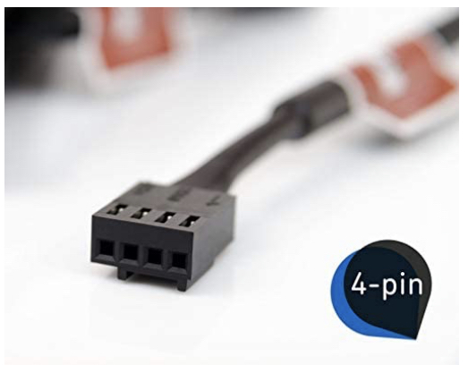

Andy, my 4 pin Noctua PWM connector fits that motor control board perfectly. It senses fan speed which is important as it is actively controlled. I am not sure why yours does not fit?
Mine looks just like this and if you look carefully you see there is a polarized little channel on one end and that mates perfectly with the 4 pin connectors in the PWM board.

Andy, since you have the 4pin PWM fan and PWM fan controller. Why don’t you just use it as is like it was designed? That controller allows you to vary the speed with those pots and dip switches. It’s very easy and convenient. I mean they took a 6month project of a PWM controller with temp sensor and audible alert with set points for fan speed up and made it for $5. You are tryig to defeat a marvel of engineering - why?
At least try it as intended and tell me what’s wrong with it. Then maybe go off and do it differently.

Yes, X - the 4 pin Noctua PWM connector fits the connectors on the PWM motor control board. 🙂
Andy, since you have the 4pin PWM fan and PWM fan controller. Why don’t you just use it as is like it was designed? That controller allows you to vary the speed with those pots and dip switches. It’s very easy and convenient. I mean they took a 6month project of a PWM controller with temp sensor and audible alert with set points for fan speed up and made it for $5. You are trying to defeat a marvel of engineering - why?
I just wanted to see if I could get away without using PWM ... to simplify matters! 🙂

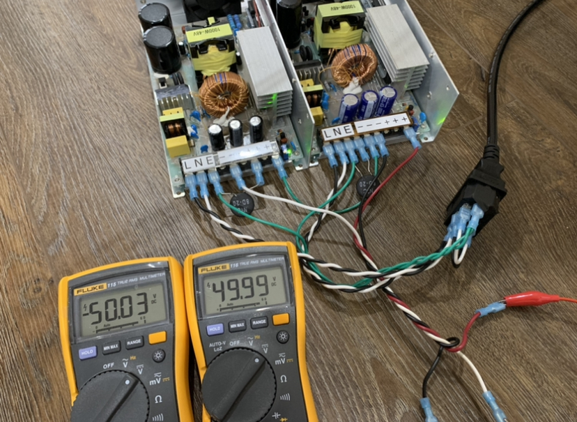

I just connected my two 800w 48v SMPS’s together in series. I verified that outputs are electrically isolated from chassis and earth ground. I put 8D-20 NTC between earth ground and common 0v point on both. Looks like it works fine. I have it boosted to +/-50v AN’s supplies say they are rated for 16A (with fan).
These are very quiet supplies (I do not see any noise in audible range on FFT and noise floor is -127dB, not even a hint of 60Hz bump).
