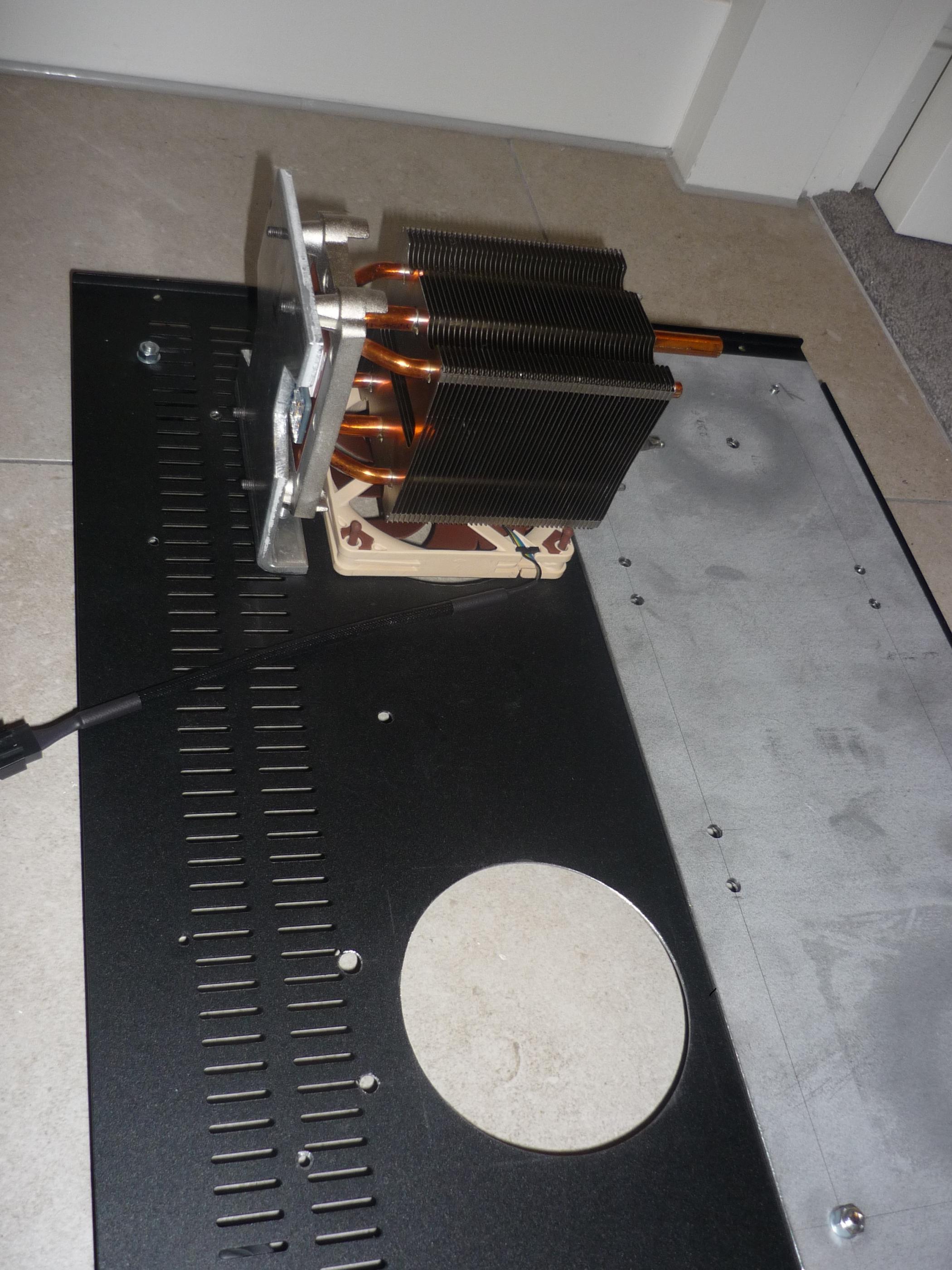

If you’re using the Dell FD841 cooler this Noctua NF-A9 PWM is a 92mm fan that fits perfectly and moves a heck of a lot more air than the 80mm, believe it or not. It also comes in a slim 14mm wide version that might give you some extra clearance in your chassis.
Noctua NF-A9 PWM, 4-Pin Premium Cooling Fan (92mm, Brown) https://www.amazon.com/dp/B00RUZ059O/ref=cm_sw_r_cp_api_i_dBrOEb1X7E3D0
You do need a PWM fan control board (it can control up to three fans):
Fans arrived - 92mm holes cut in the base, this morning (done by my friendly metal man).
Attached is a pic of one fan installed on its rubber mounts, with Dell CPU cooler above ... also showing the second cut hole.
I'm not going to use the PWM controller - instead I'll:
1. use a 10 or 12w res to drop the voltage from the 20v SLB +ve rail to 12v, and
2. make use of the 'Low Noise Adaptor' cable, which lowers fan speed from 2200rpm to 1700rpm.
Andy

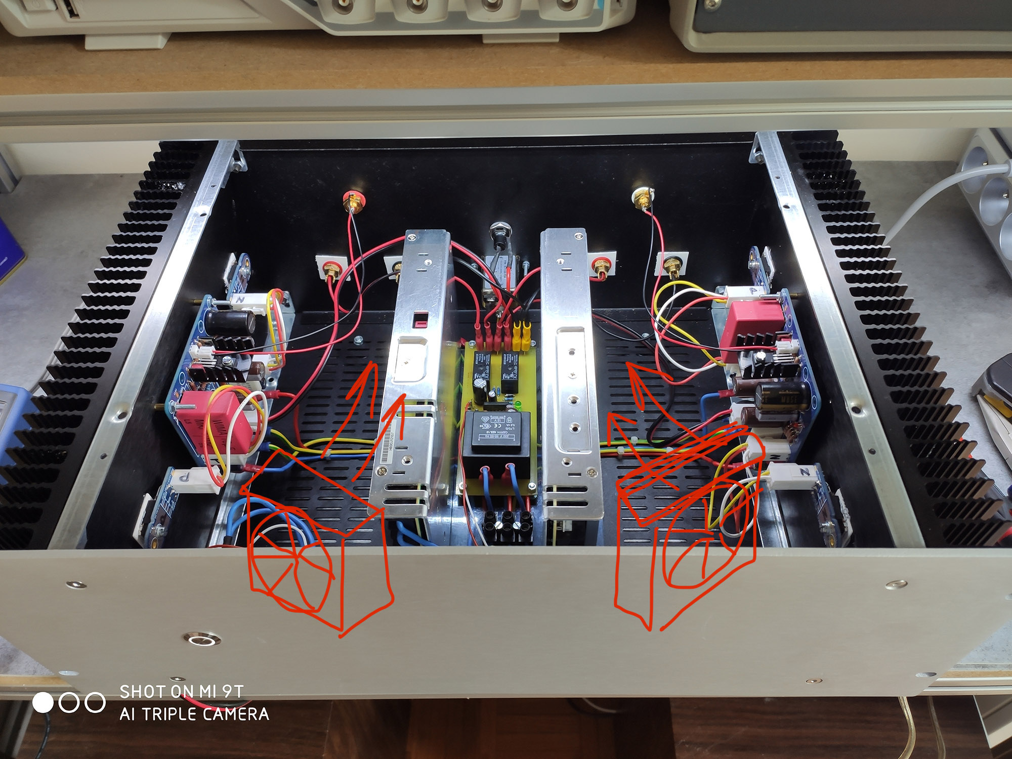

AN SMPS
I thought I would innovate using SMPS for my AN build. So I did.
Great sound, especially bass. No hum, no hiss between tracks. Positive WAF.
But after some listening time, the MeanWell SMPS fans kicked in: a different story. Loud!
My preliminary bench tests were not long enough to start the fans and I thought they would never turn on….
Well, it’s time to start building a proper linear PSU!
Jacques

I think a 120mm Noctua PWM fan like this one should do:
Noctua NF-F12 PWM, Premium Quiet Fan, 4-Pin (120mm, Brown) https://www.amazon.com/dp/B00650P2ZC/ref=cm_sw_r_cp_api_i_UGfQEbV8VQTGC
You can drive both with an inexpensive PWM motor controller like this:
https://www.amazon.com/dp/B0752GMMPJ/ref=cm_sw_r_cp_api_i_WLfQEb449YKGN
These are available from China for about $4 if you want to wait 2 weeks.
Here is my idea of where to mount the fans after your remove the cases that the MW’s are in, in order to expose them to more airflow. Use the in-line speed reducer that the Noctuas came with. Play around with dip switches to get low velocity silent fan. There is a temp sensor even that set to say, 85C (whatever the internal fixed threshold points are) or so to make inside never gets too hot.

Hi X,
I'm afraid the built-in SMPS fans might still kick in, they seem to turn on at a relatively low temperature, even with the amp lid open. Apparently cutting the fan wires disables power output.
I was thinking instead of removing the original 60mm 12V fans and mount Noctua 92mm Flex on the outside of the SMPS case (with additional ventilation holes drilled) using the original two-pin connector & circuitry logic.
Power consumption is very comparable and ultra-low noise option is available with Noctua's this size.
Jacques
