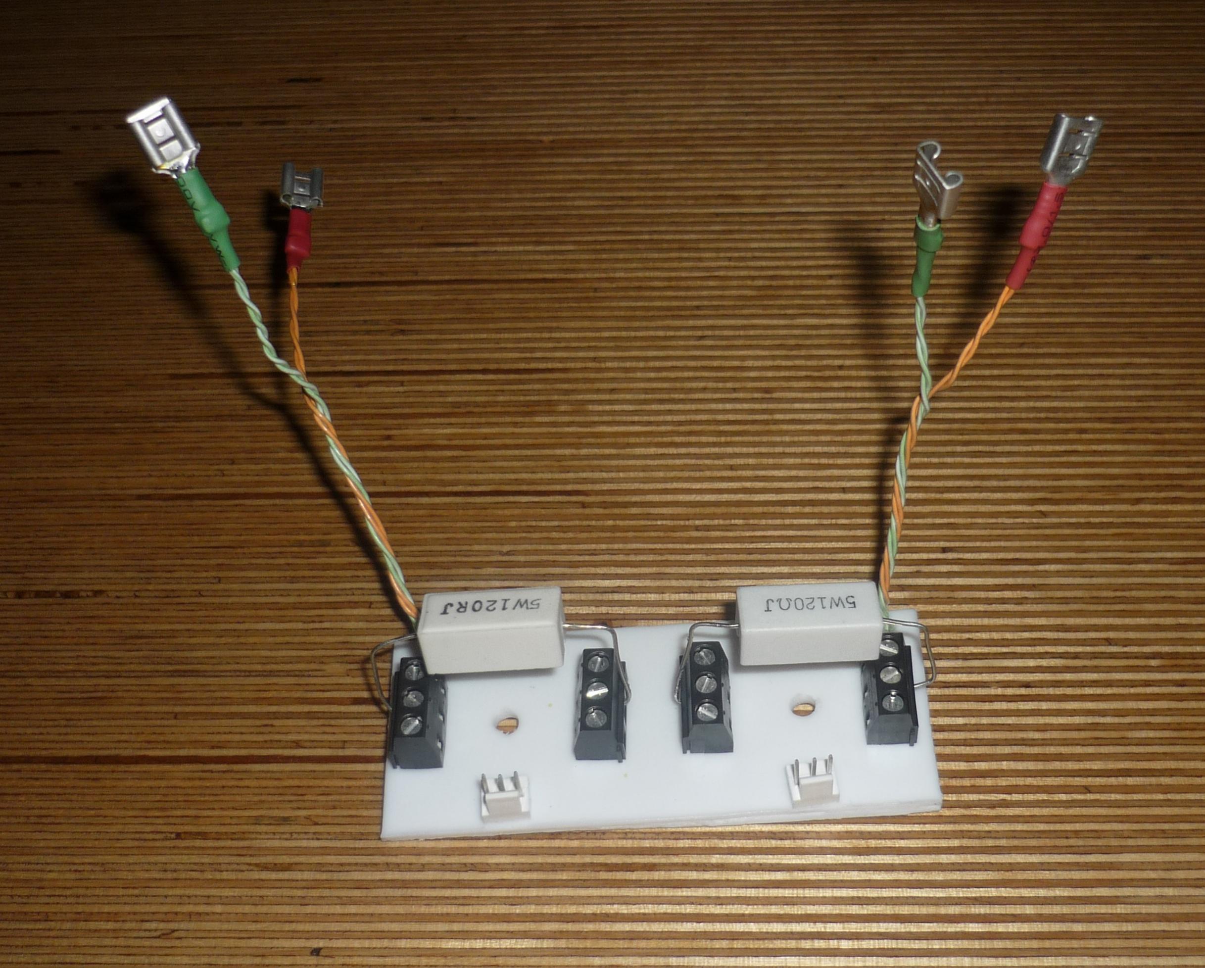

Here is a pic of my Fan Voltage Board. 🙂
As I'm not quite sure what DC rail voltages I am going to end up with (when the AN boards are all connected up), I used a 120 ohm resistor in the Phoenix connectors on the fan voltage board. Then, using a benchtop power supply that I have, I fed 20v & then 22v to the board.
Interestingly, the fans were seeing (ie. after the resistor):
* 11v with a 20v supply, and
* 12.25v with a 22v supply.
The resistors measure smack on 120 ohms - so the current draw of each fan would appear to be 75-80ma (using the supplied NA-RC7 Low Noise adapter cable) - not the 110ma mentioned in the specs.

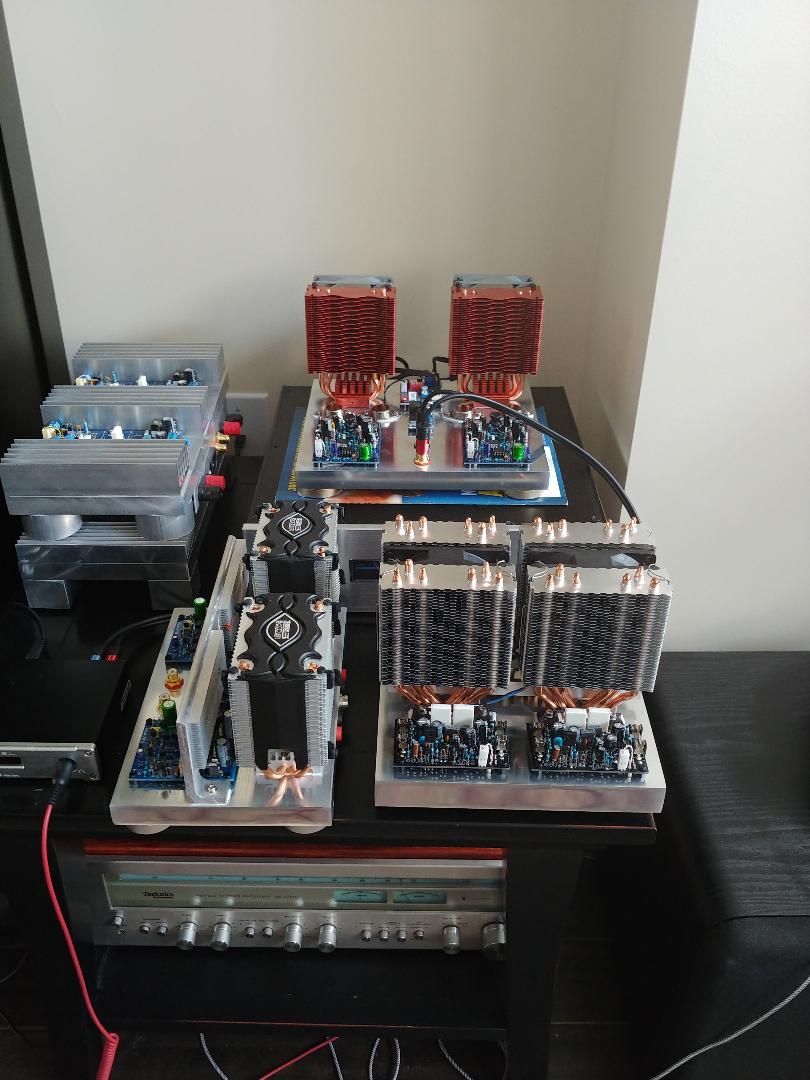

The season is finally starting to warm here in NY and I notice a temperature difference in the main part of my home with the AN playing 8-10 hours daily.

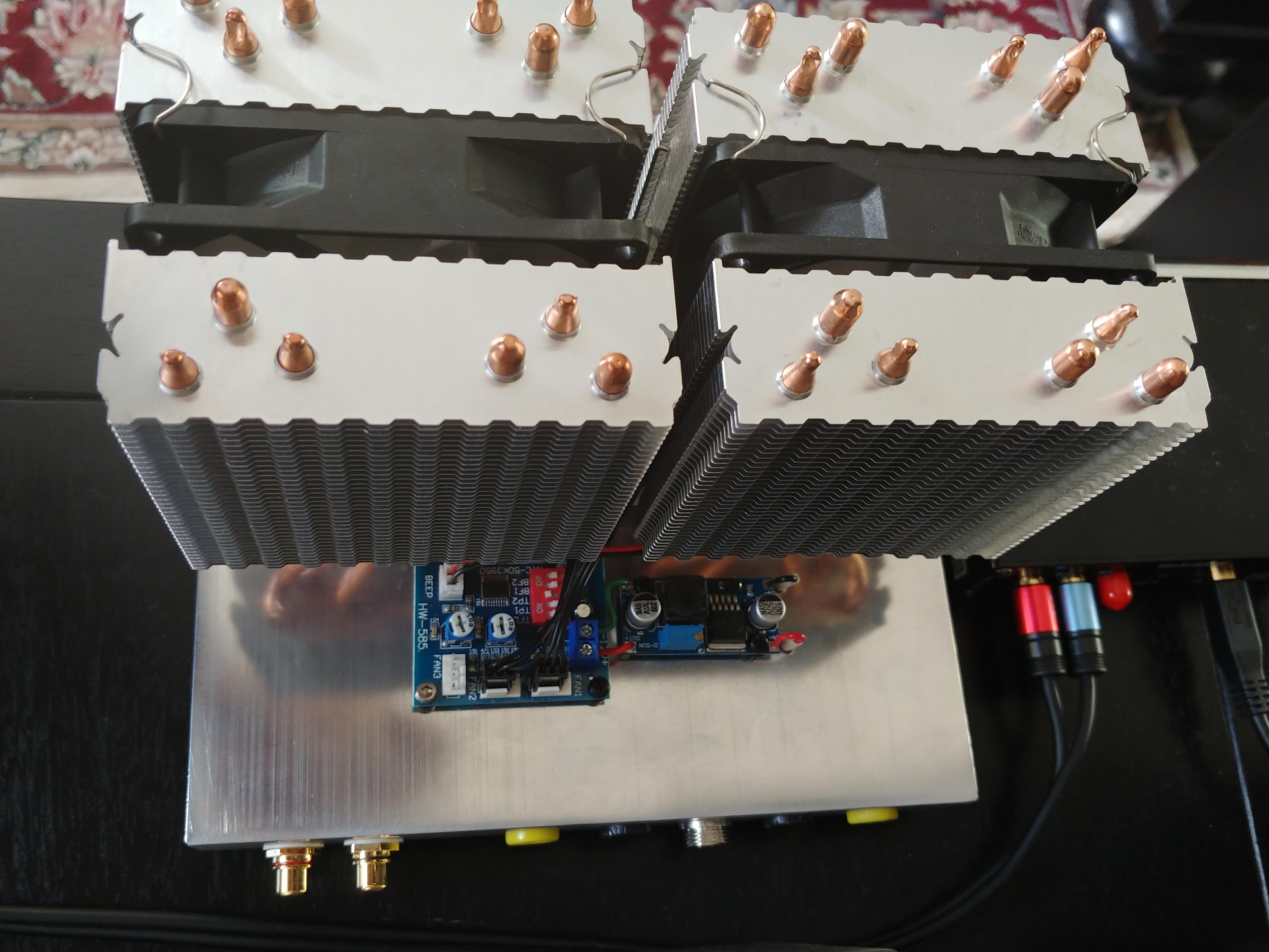

Just completed AN build.
Tested, scoped, everything looks good.
Now time for thermal tests 🙂
Need to plug it in, and watch the temperature for a few hours, to see if these 2 heatsinks and fans are enough.
So far, after 10 min running, output transistors are running at 60 degrees C
(21V rails, will test 27V as a next step)..
PSU is external one - the box in the back, with VU meters. It's +/-80V (800W),
with speaker protection and VU meters.
I have auto-transforer in front of it, so I can adjust voltage as needed.
AN chassis is made from Alu slab, 8x8, 1 inch thick.
2 little boards behind the fans - voltage regulator to drop +rail to 12V, and fan controller.
PCBs are obviously different - smaller then originals, with power FETs soldered directly to the boards.
Thermistor sensor from the fan controller, is glued with thermal glue to one of the output transistors, but I guess
it doesn't matter - I expect these fans to run constantly...

Love the look of that amp! 1” slabs of aluminum..... I love it!! At first the amp looked huge but when your measurement of 8x8” sinks in you start to realize that it is very compact. 60c after 10 minutes is pretty hot! It will likely go hotter before it stabilizes and you will need to monitor it if pushing past 21 volts. Can you adjust fan speed?
Yes, I can.
Also, 60C was observed BEFORE I glued thermistor to the output fet.
First, it was connected to the CPU heatsink.
Now, when it's directly sensing temperature of the fet, fans will kick in sooner, and at higher speed.
Fets are bolted VERY close to CPU heatsinks.
60C is not too bad, I'd be happy if it stays at 60C.
I built and tested this kind of cooling with other amps, but not A class, so we will see...
