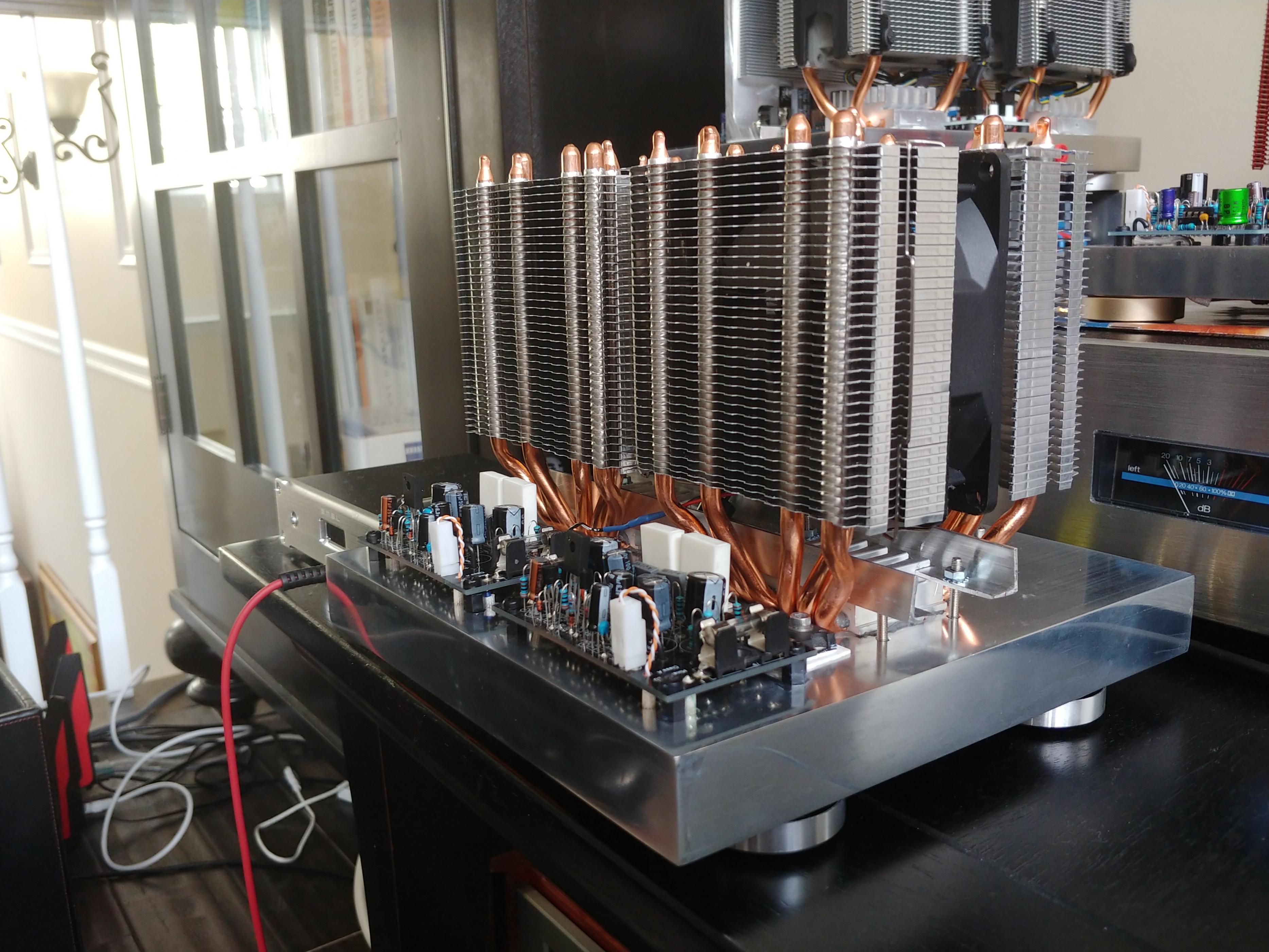

Just completed AN build.
Tested, scoped, everything looks good.
Now time for thermal tests 🙂
Need to plug it in, and watch the temperature for a few hours, to see if these 2 heatsinks and fans are enough.
So far, after 10 min running, output transistors are running at 60 degrees C
(21V rails, will test 27V as a next step)..
PSU is external one - the box in the back, with VU meters. It's +/-80V (800W),
with speaker protection and VU meters.
I have auto-transforer in front of it, so I can adjust voltage as needed.
AN chassis is made from Alu slab, 8x8, 1 inch thick.
2 little boards behind the fans - voltage regulator to drop +rail to 12V, and fan controller.
PCBs are obviously different - smaller then originals, with power FETs soldered directly to the boards.
Thermistor sensor from the fan controller, is glued with thermal glue to one of the output transistors, but I guess
it doesn't matter - I expect these fans to run constantly...

Also, 60C was observed BEFORE I glued thermistor to the output fet.
First, it was connected to the CPU heatsink.
Now, when it's directly sensing temperature of the fet, fans will kick in sooner, and at higher speed.
Fets are bolted VERY close to CPU heatsinks.
60C is not too bad, I'd be happy if it stays at 60C.
I built and tested this kind of cooling with other amps, but not A class, so we will see...

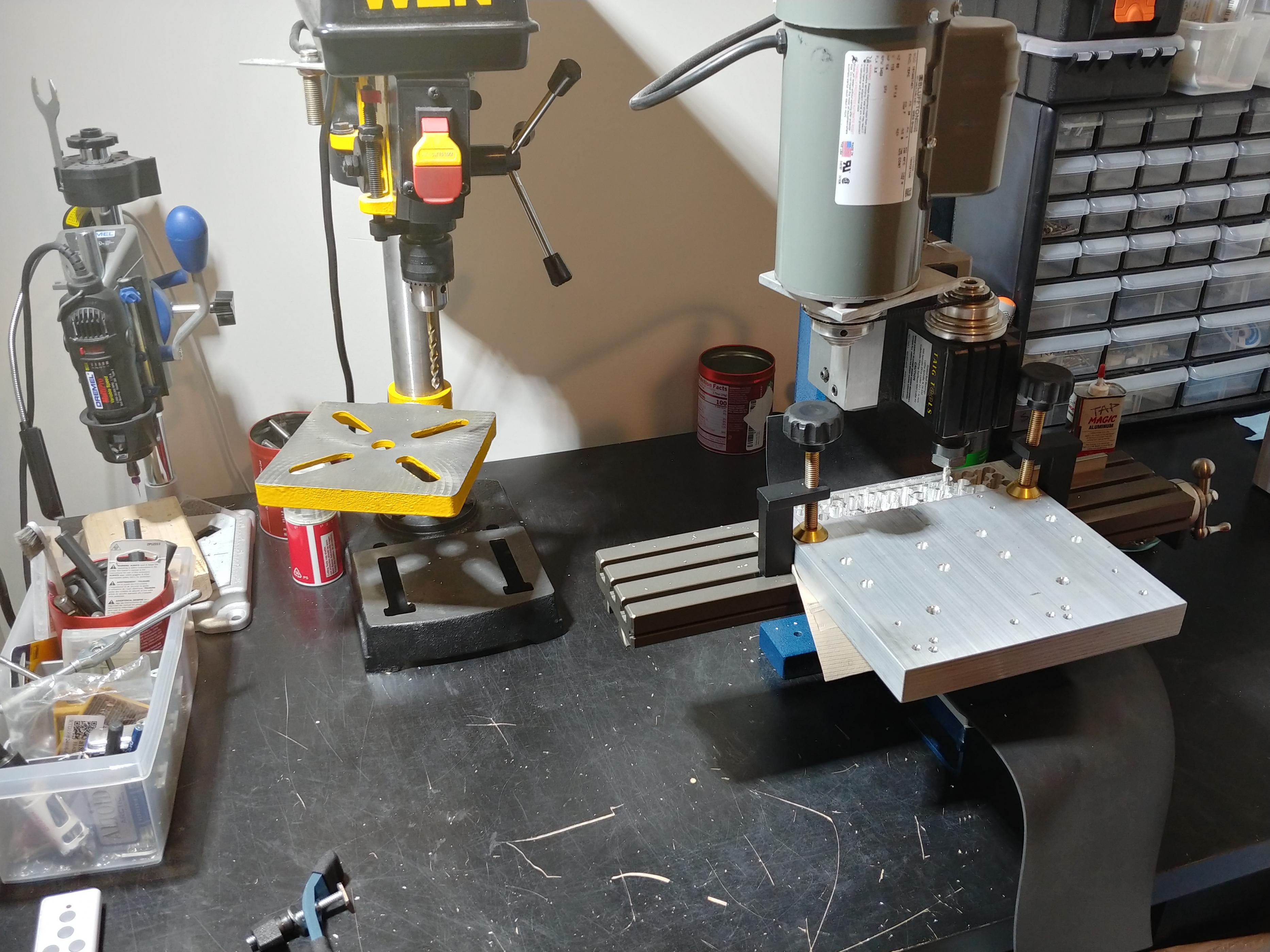

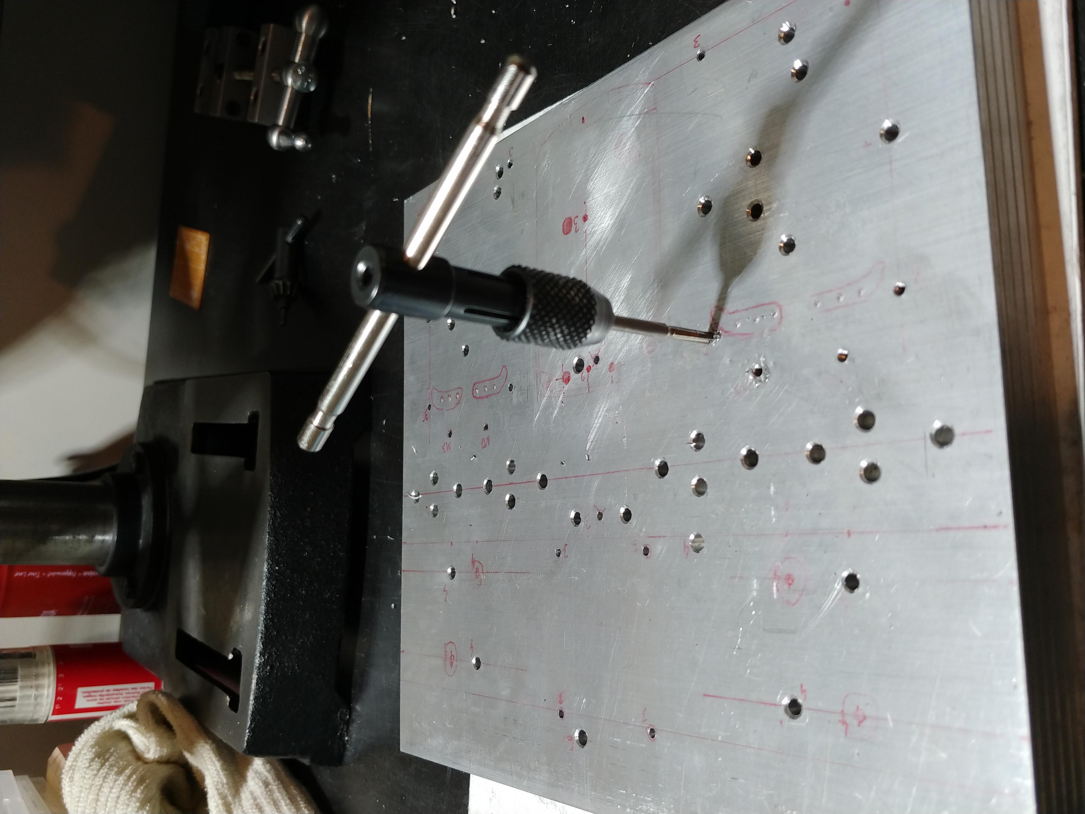

I love your slab chassis! That’s got to be the best looking minimalist chassis I have seen. Way more interesting than a box with fins. The 1in slab appears to be machined out on the bottom side because I see RCA jacks etc feeding through the back edge like a panel. Is it hollowed out on the underside or just strategically milled where necessary?
It occurs to me that you could have milled or drilled in channels for water cooling in the slabs and clamped your MOSFETs the other way. Then have two tubes go to a separate water cooling radiator unit. Although the fins and fans look way cooler.
Which brand/model is that copper finned one? Never seen that before.
Congrats! Beautiful work.
:cheers:
Yeah, all the cables and connectors had to go somewhere, to keep surface
uncluttered.
The 1st thing was for PSU to be 'outsourced' and connected
by cable. I wanted to do it for different reason - too many amps, too many PSUs.
Why bother ? - just have one PSU box, and use it for all amps.
I only use one amp at the time.
Chassis is milled where necessary.
a) didn't want to mill a lot - it's time consuming work and my milling machine is slow
b) wanted to keep it bulky, and retain as much metal as possible
One big disadvantage of this kind of chassis is servicing.
As you see all cables are soldered to the PCB from beneath.
In case you need to remove PCB to fix it, or change a resistor, it's pain in the neck.
Lots of work, but of course can be done.
Box with fins allows easier access to everything.
Yeah, I though about it many times, but there is not much to gain.
Lots of work, and you still need a fan or two. Plus water cooler with fins.
Volume wise - bigger then 2 CPU coolers, and more clutter.
But it might be OK for really hot-running A-class amps...
Another thought was - to built in water cooling fans, coolers, etc.. into the PSU, and just connect it to the chassis with 2 water tubes..
This way it could be re-used for other amps.
It's not Cu, I'm afraid 🙂
It's Cu plated aluminum, generic cooler, but I replaced fans with Noctua silent ones.

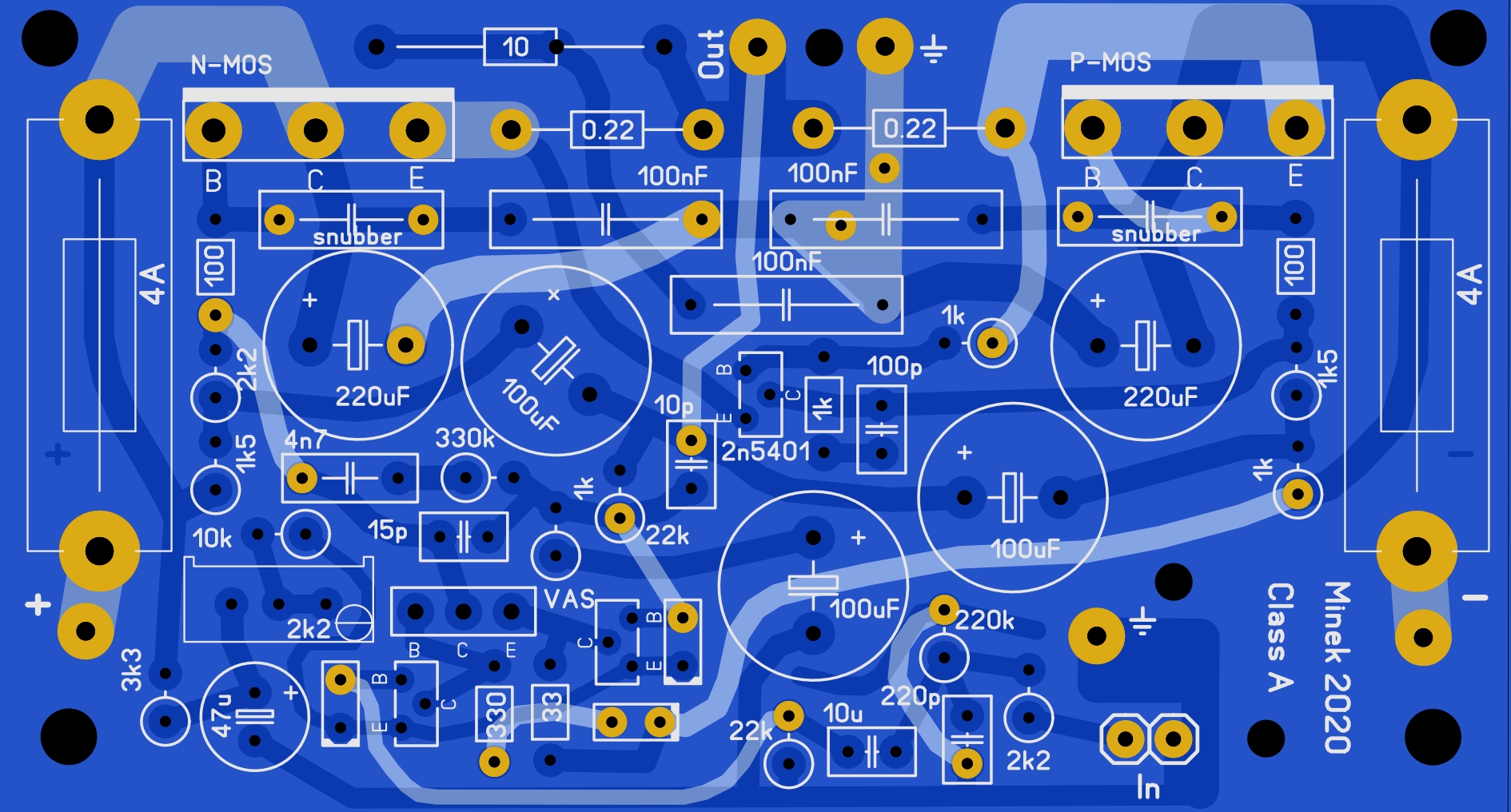

Impressive, minek123!
Are you able to convert the .lay file to gerber?
What speakers do you have?
rgds
I can generate new gerber files if you need.
The original ones had few holes too small, and I had to -re-drill PCBs.
My speakers are JBL_STUDIO 590
Little bit over 6 Ohm..
But I have to warn you - this PCB is very dense, and does not support any terminals, headers, spade connectors, etc..
Just holes for cables to solder them directly. So it's not user friendly for traditional builds.
Also, it has two grounds - input ground, and dirty ground. They are NOT connected together on the PCB.
I always use 2 separate cables to connect PCB to common ground.
No ground lifting with a resistor.
It always worked perfectly for me. No loops, no hum, no resistor.
Feel free to modify lay6 file and make changes...
