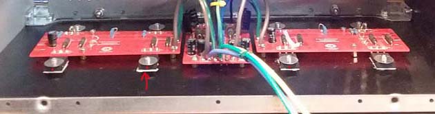

Hi Minek,
I do think your arrangement is good and clearly keeps things cool.
However, I'll discuss why we used plugs and wiring to connect the outputs.
Here were the reasons:
1. To accommodate passive cooling, cpu towers and other forced air methods, we needed to rearrange the outputs in different ways. For example, with passive cooling you might need to have the thermal centers at least 100mm apart to optimise thermal stresses on a long heatsink. For the cpu towers, very narrow positioning meant you could use one tower per channel - and two devices running at up to 60W EACH could be cooled by one tower designed for up to 120W dissipation. These are very different arrangement, and we had to design for it.
2. There is no instability on this approach due to long wires. I'd done a lot of work 25 years ago with IRFs mounted off the board, and there were never any instabilities, even though in those days I never used any but the IRFs. More gm mosfets are slightly more self-oscillatory, so we put on the snubbers to be sure. Optimally they should be mounted on the devices, hence the snubber pcb.
3. If there is an output failure, replacing them is a doddle. A few reconnections on the snubber pcb, and plug it into the main board and it's done - a single bolt, a few minutes of soldering and its' done.
A big issue with Class A is heat management. We are DIY, so we have to give a generic solution which will please everyone. This one works, and there are no down sides. You used your own approach - credit to you - and it seems to work. But you did design your own pcb, and we attempted to make a beautifull, SOTA designed pcb for other builders at low cost to save the inconvenience of doing their own.
Thank you for building the AN 40 and adding to the list of happy builders!

Hugh, you are right. I follow your logic. Long wires (as shown in this case) will definitely
work - with snubbers and stoppers.
I wanted to keep everything simple, that's why I skipped wires, snubbers, pcb connectors,
clipping indicator, etc...
I always design my own boards, that's the best part of the project!
Also, my goal was something small - this amp has only 4 transistors + fets.
It's smaller than 'baby Aksa' 🙂 No adjustements, no drivers, no bias, not thermal tracking.
That's its beauty.
Kudos for designing it. It does sound great, the longer it plays, the more I like it!

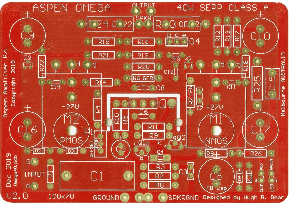

Hi Minek,
The temperature sensors are taped on top of the heatsink.
Maybe I'll try directly on one output next.
Jacques
Hi Minek,
OTOH I understand your point too. To show you my own pcb you will see I used your technique!! But I was using a different forced air heatsink, a Conrad MF18-150, and it was custom for that heatsink.
Thanks for your thoughtful answer!
Hugh

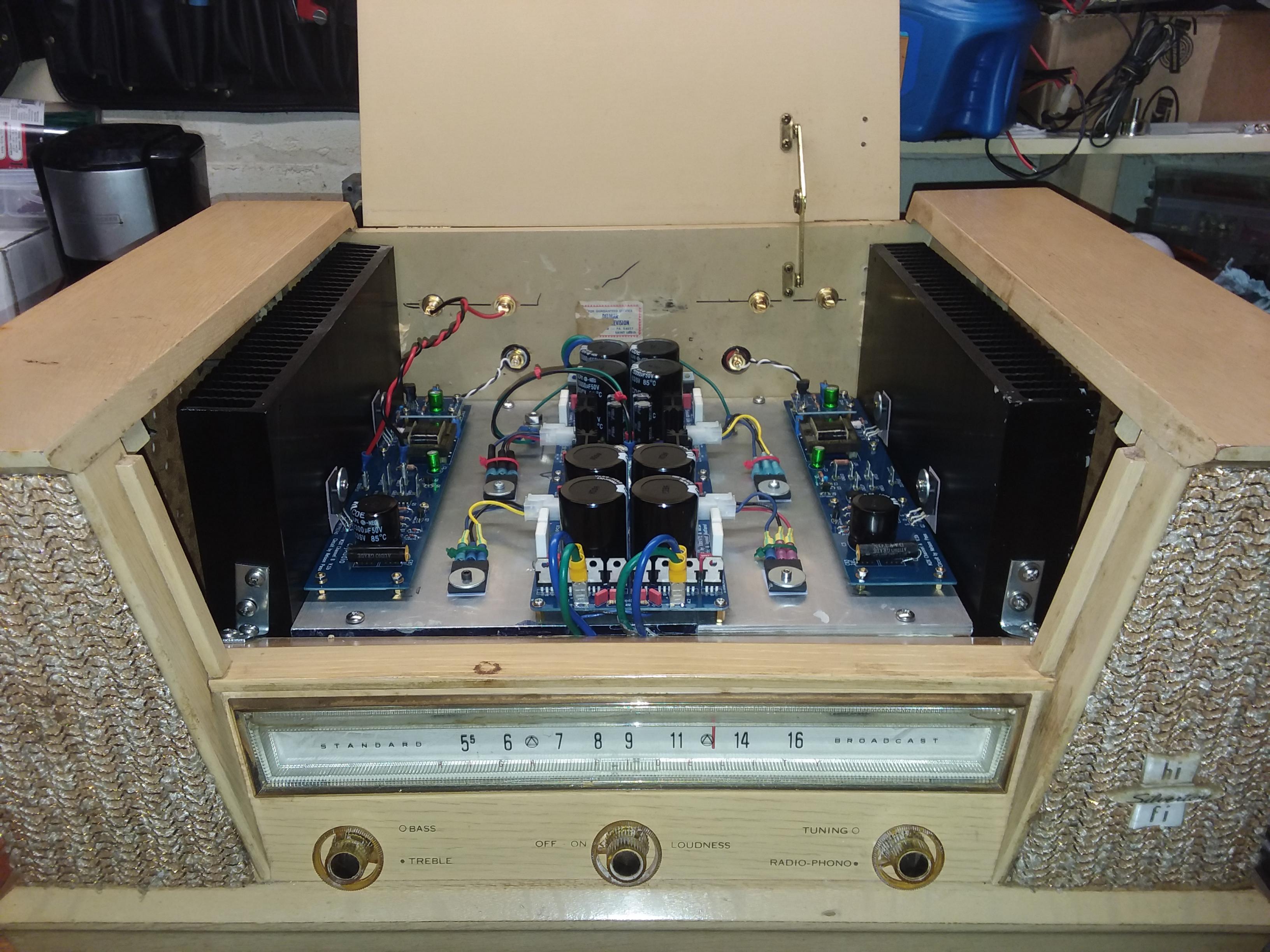

Ya, that was my first Class A build, it's an F5T V2 and, if memory serves, it ran around 55-60C. I gave it to a friend for Christmas, or I would fire it up and check.
I have also built the M2X which runs a bit warm because I put it in and old school 50s radio chassis. She runs about 54-65C.
My J2 has large sinks and runs in the low 50s, MY AN monos have small sinks and runs a bit hot too at 57-65.
I have 3 Pass builds and they all run from about 50-65C. The M2X is dual mono and has four fans on the sinks because of the old chassis. Here's an image to get your mind around it.
Beautiful build!I have 3 Pass builds and they all run from about 50-65C. The M2X is dual mono and has four fans on the sinks because of the old chassis. Here's an image to get your mind around it.
Beautiful build!
SHe was runnin to hot, so I took the side panels off which was just some partical board. I cut a big rectangle in them and put burlap over it to let the sinks breath and then installed fans to help a bit and now I can run it with the top down. 😀
