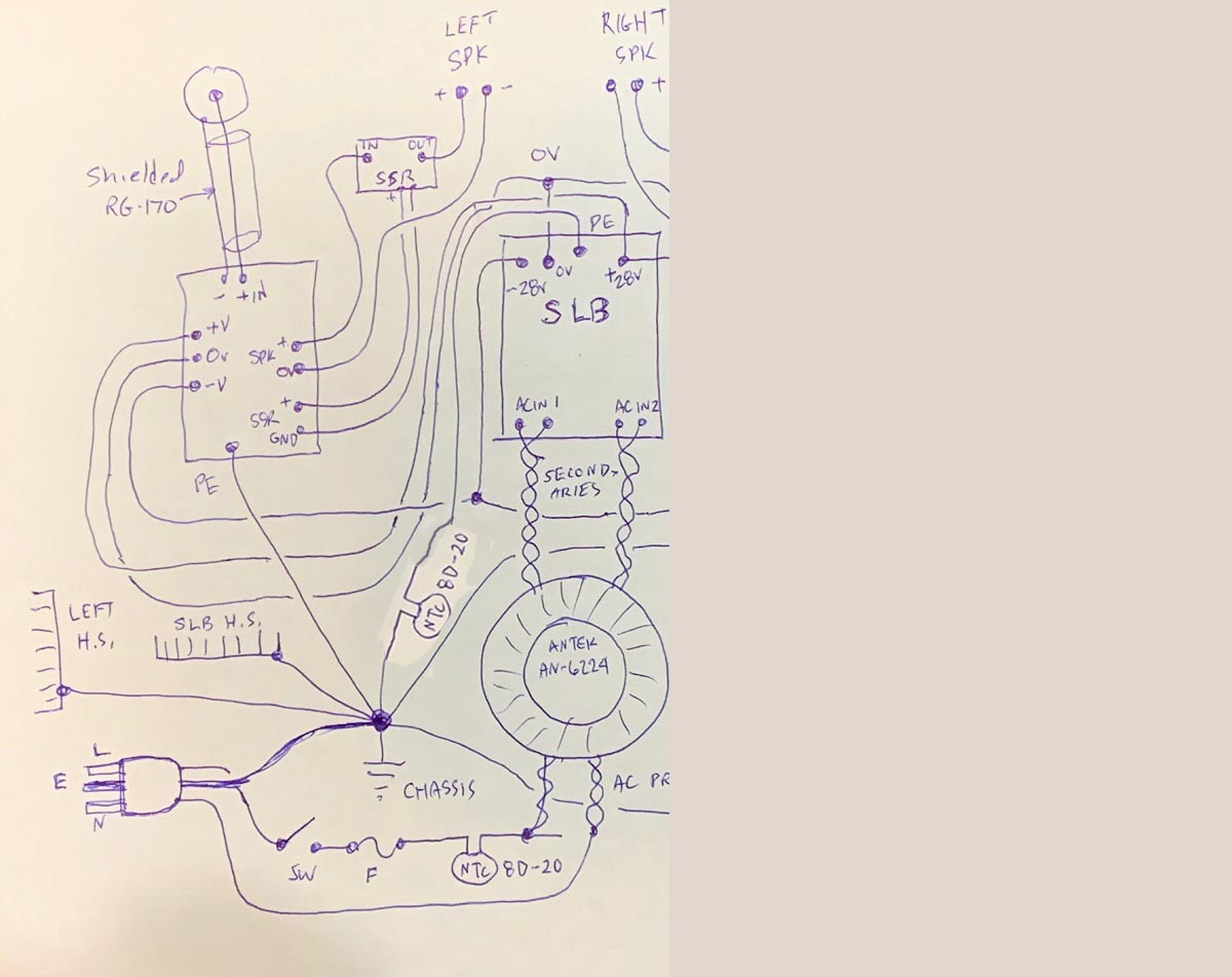

Could some one shine some light regarding power?
from X's etsy "Recommended use of SLB PSU (sold separately in this shop) with single 600VA 24v trafo (Antek AN-6224 or equivalent) or dual SLB with dual 300VA 24v trafos."
Im looking into a stereo set up and I've been seeing builds with 2x dual SLB and a single or dual trafos. Then I look at the "grounding diac" document it looks to me just a single
dual SLB.
Is there something Im missing a trick or best practices?
Thanks for your help/clarification
Perhaps Vunce or Thompsontech have a wiring diagram for their dual trafo dual SLB Aloha Nirvana.
Basically take my sketch and double it but connect one of the amps to the second one rather than sharing an SLB. Keep the power ground of each SLB and amp separate. They only connect via the PE ground through the NTCs.
I can do that, one thing I wanted to touch base on is that the ground scheme you have posted does not reference NTC from the PE... 😱 It is in the SLB but, not on the no-hum-ground, schematic.
That is, unless I missed something.... Again. 😛

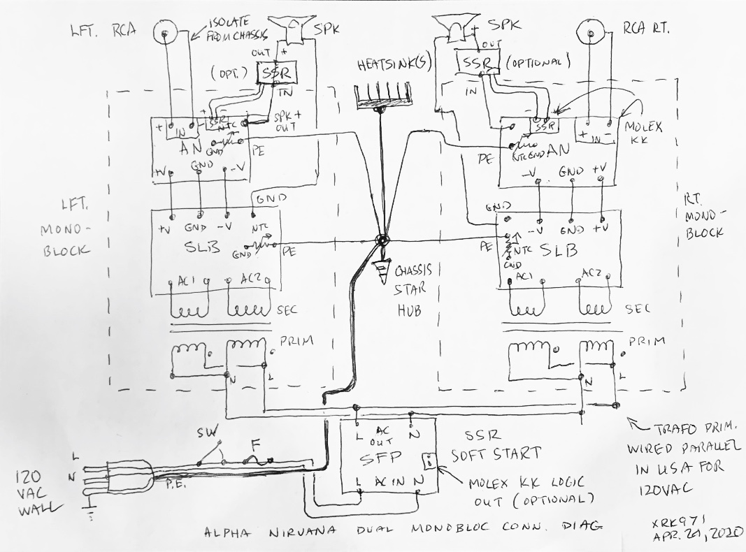

dual SLB.

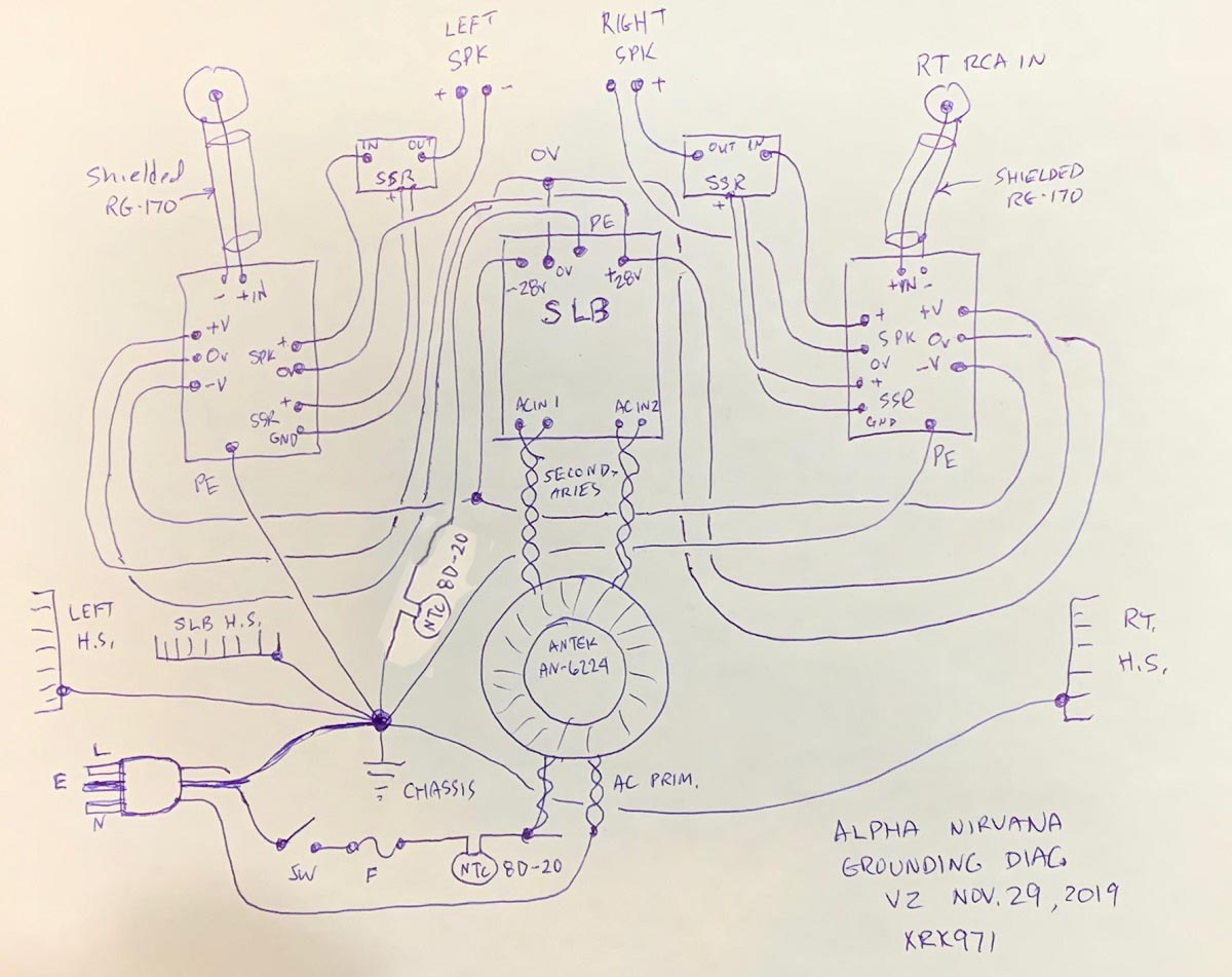

If you are doing dual SLB, I would do dual Trans too. It's simple really, You just duplicate the ground schematic for each side. So one trans and one SLB for each. THe grounding scheme doesn't show the ground loop break though. It is on the SLB schematic, but omitted from the drawing, so I added it in to the attached.
The second schematic is showing half or the left side, you simply build one just like it for the right and include the other trans and SLB. Make sure you do the inrush for each side and the ground loop breaker too. The grounding point will be the same point and will go from bottom to top SLB1-2 (PE) through NTC 8D-20, on bottom, Amp1(PE) and Amp 2 (PE)
I think I have that right X?

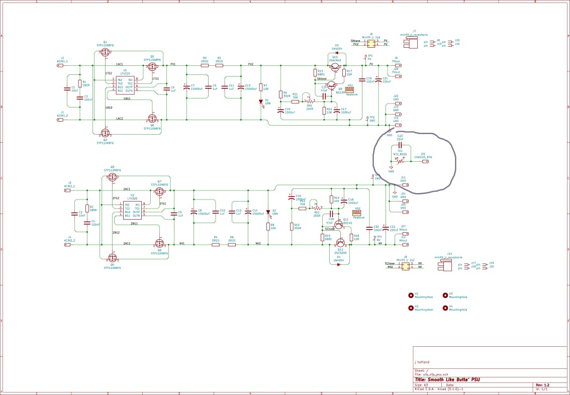

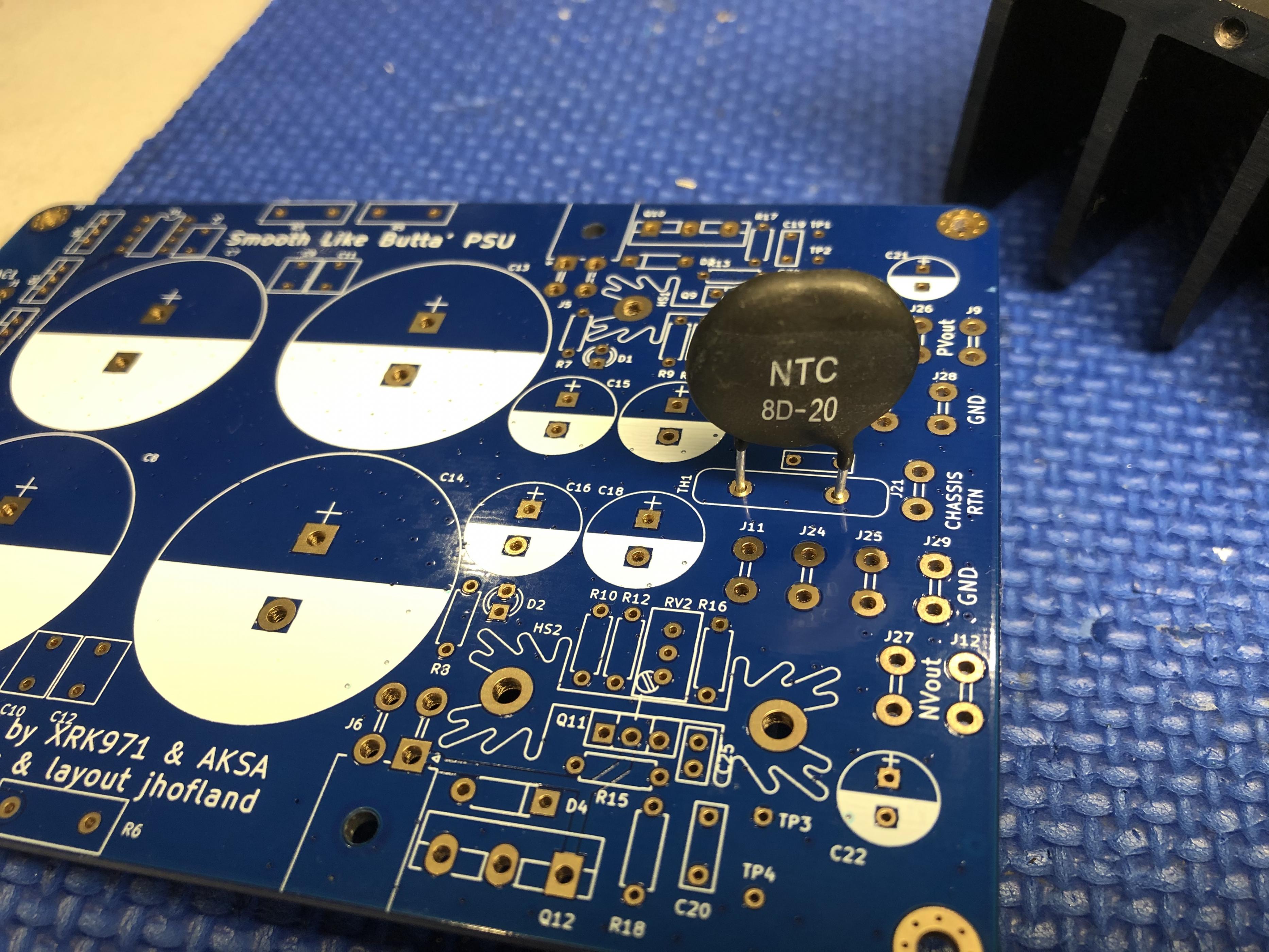

JT,
The GLB is in the schematics AND included on the SLB/Alpha Nirvana pcbs. It’s the NTC that installs right next to the GND faston tabs.
You edited in a duplicate NTC, it’s not needed because it’s already installed.
I'm understand there are GLB on the Amps, but I also have one on each SLBs PE to ground. as shown in the SLB schematic.
It’s already there.
The above grounding scheme drawing is specific to an AN/SLB layout. Adding the NTC to this drawing will further confuse.
If using a different power supply, it is a good safeguard to add this on your own.
