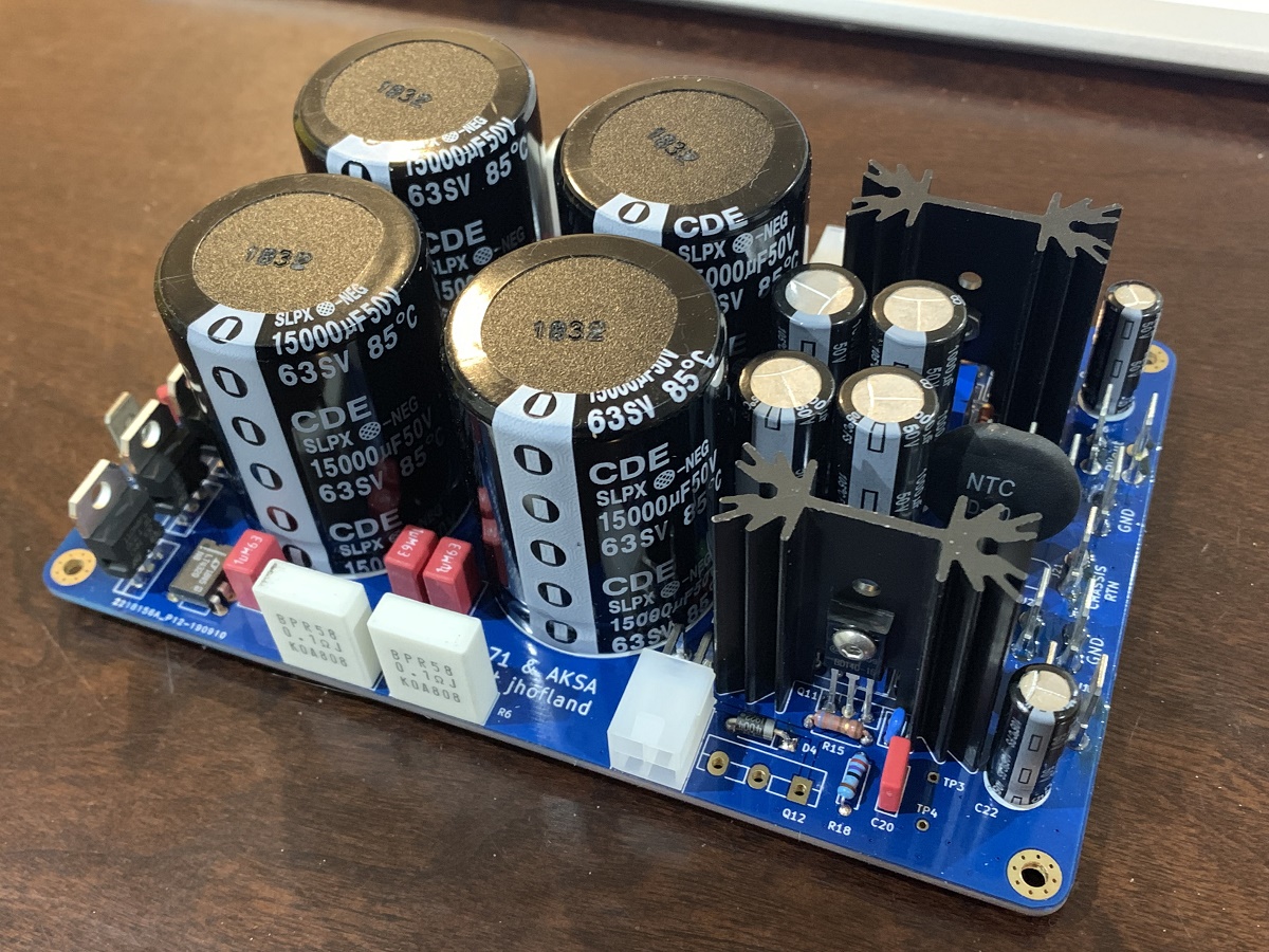

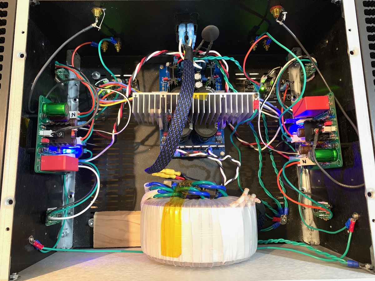

Vunce convinced me to build up a true production SLB power supply. I had been using the verification build prototype which only has 1.6mm FRP, half the copper thickness at 1oz, and most importantly, lacks the star ground hub which has 8 Faston spade connectors concentrated in a small area. So I built one last night, traded it for 2hrs of sleep 🙂 Did not get a chance to try it yet, but I do know immediately it feels heavier and the soldering iron had a hard time melting to solder for the pins due to the thickness of the copper planes. I did not have that problem on the verification build. Hoping that this takes the residual mains hum noise peaks down even lower.

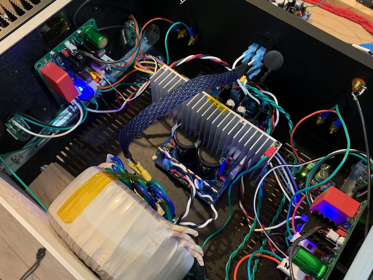

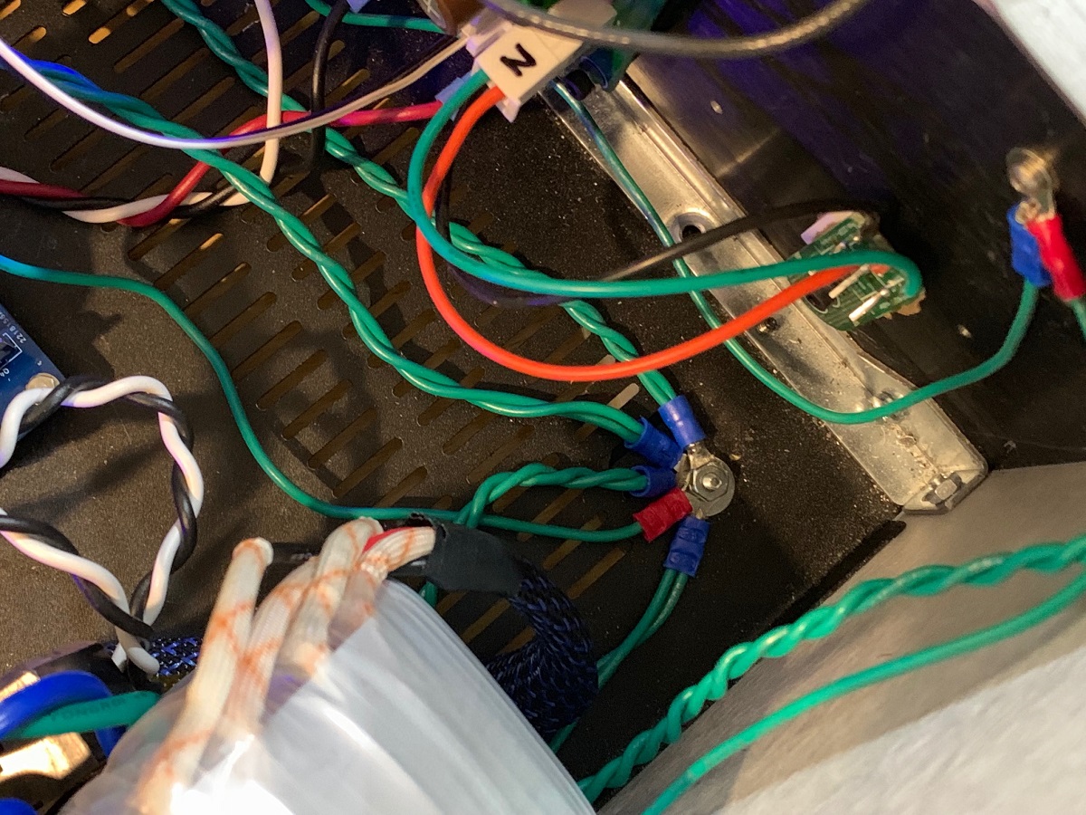

I installed the new v2 SLB into the Alpha Nirvana, and while I was at it, cleaned up the wiring a bit. I put the chassis and earth grounds all on one bolt on the chassis rather than a screw terminal block just to simplify. The Mains AC from the EIC to the trafo is now in the braided PET tube. Here are some photos.

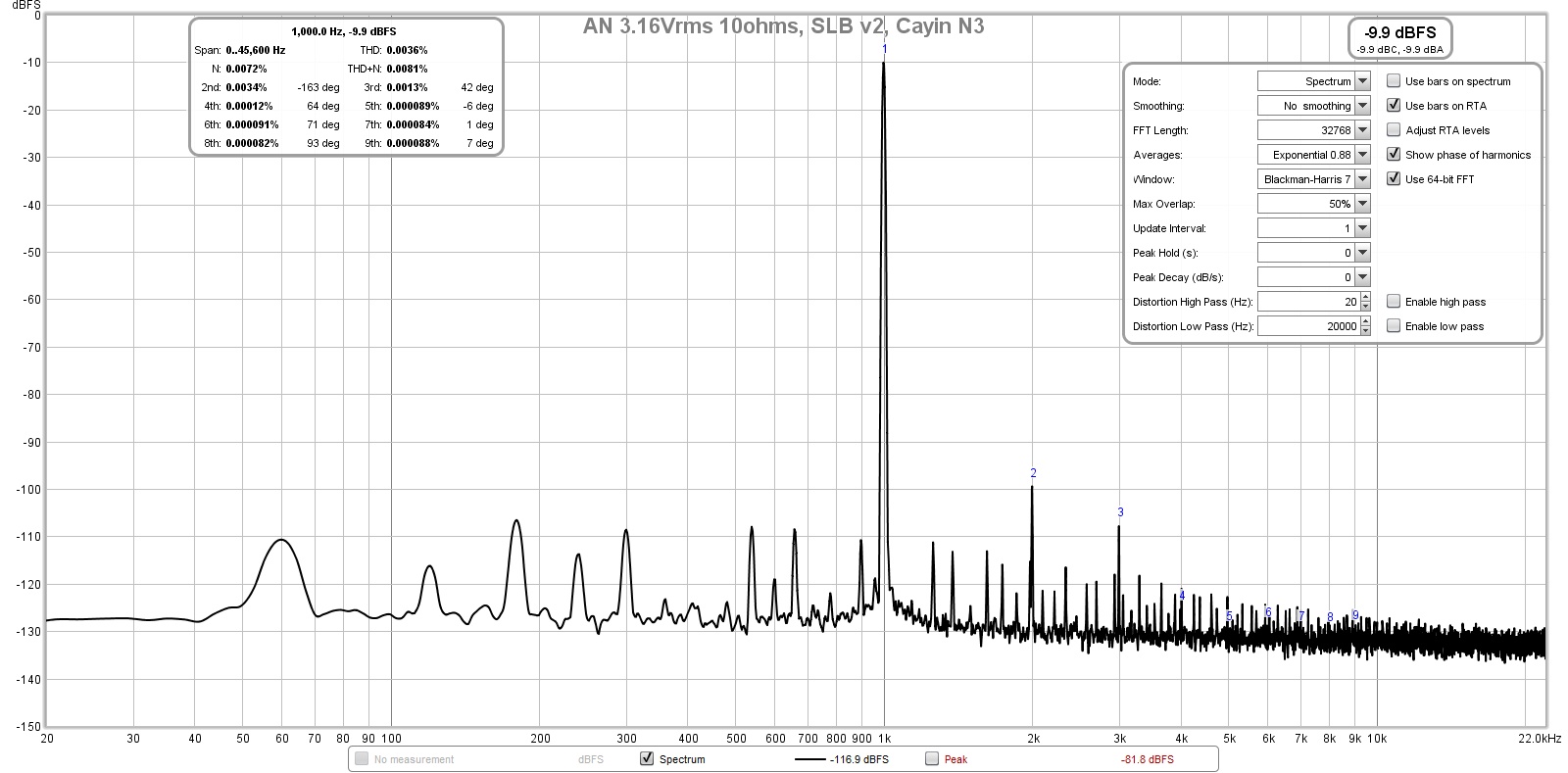

A measurement at 1kHz and 3.16Vrms into 10ohms as before with the Cayin N3 as source reveals that the THD has gone down to 0.0036% and the 60Hz bump is now down by -7dB over the last setup. So overall, there seems to be an improvement.

FFT with 3.16Vrms into 10ohms:

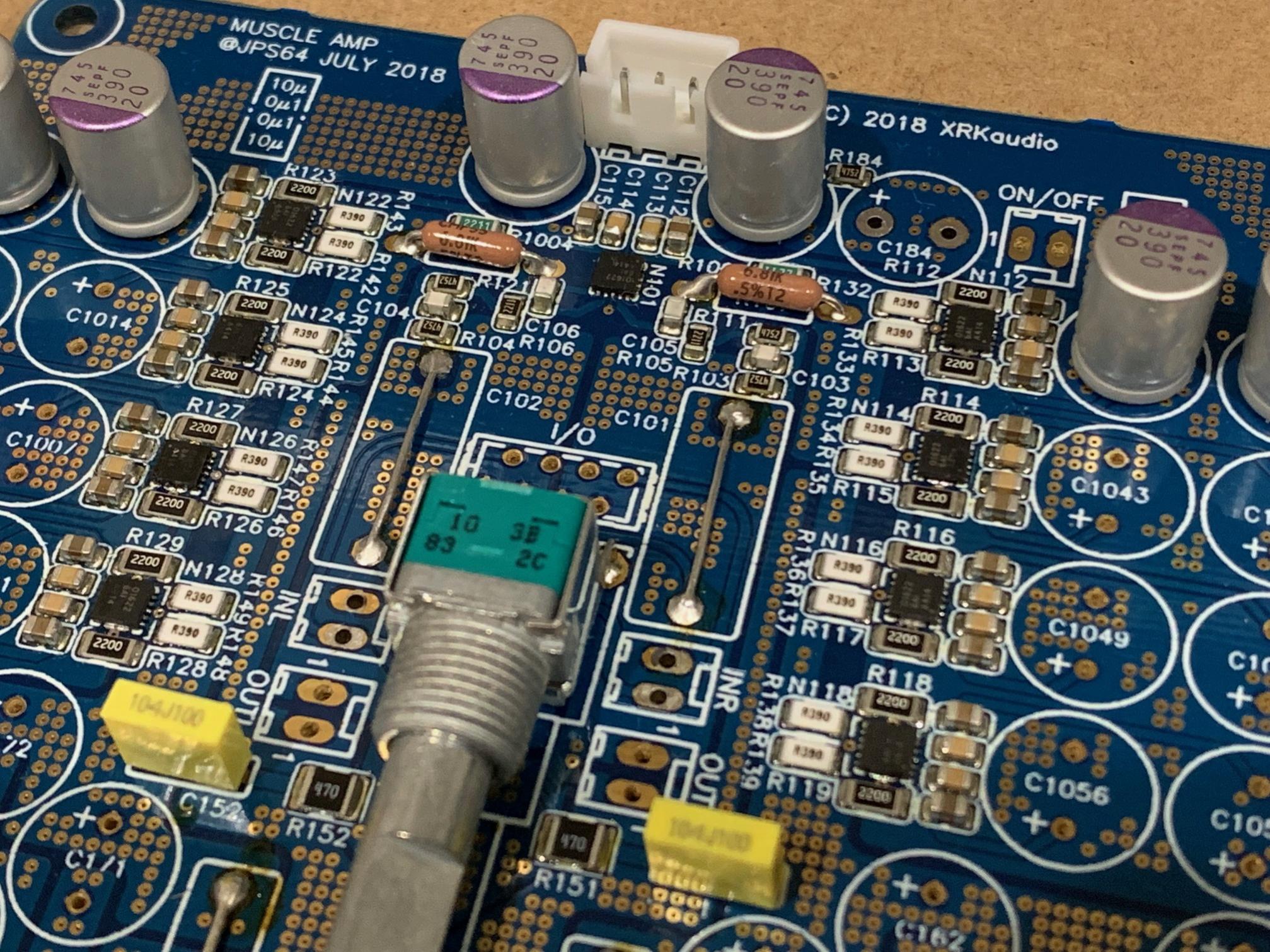

Here is an example of the type of solder joint quality you can achieve using this method. Also, cutting edge components increasingly do not have exposed pins. The “pins” or pads rather, rest under the chip along with the thermal pad (so called VSON format). Here, solder paste and hot air is mandatory. Here is my Muscle Amp 8x parallel OPA1622 headphone amp.
